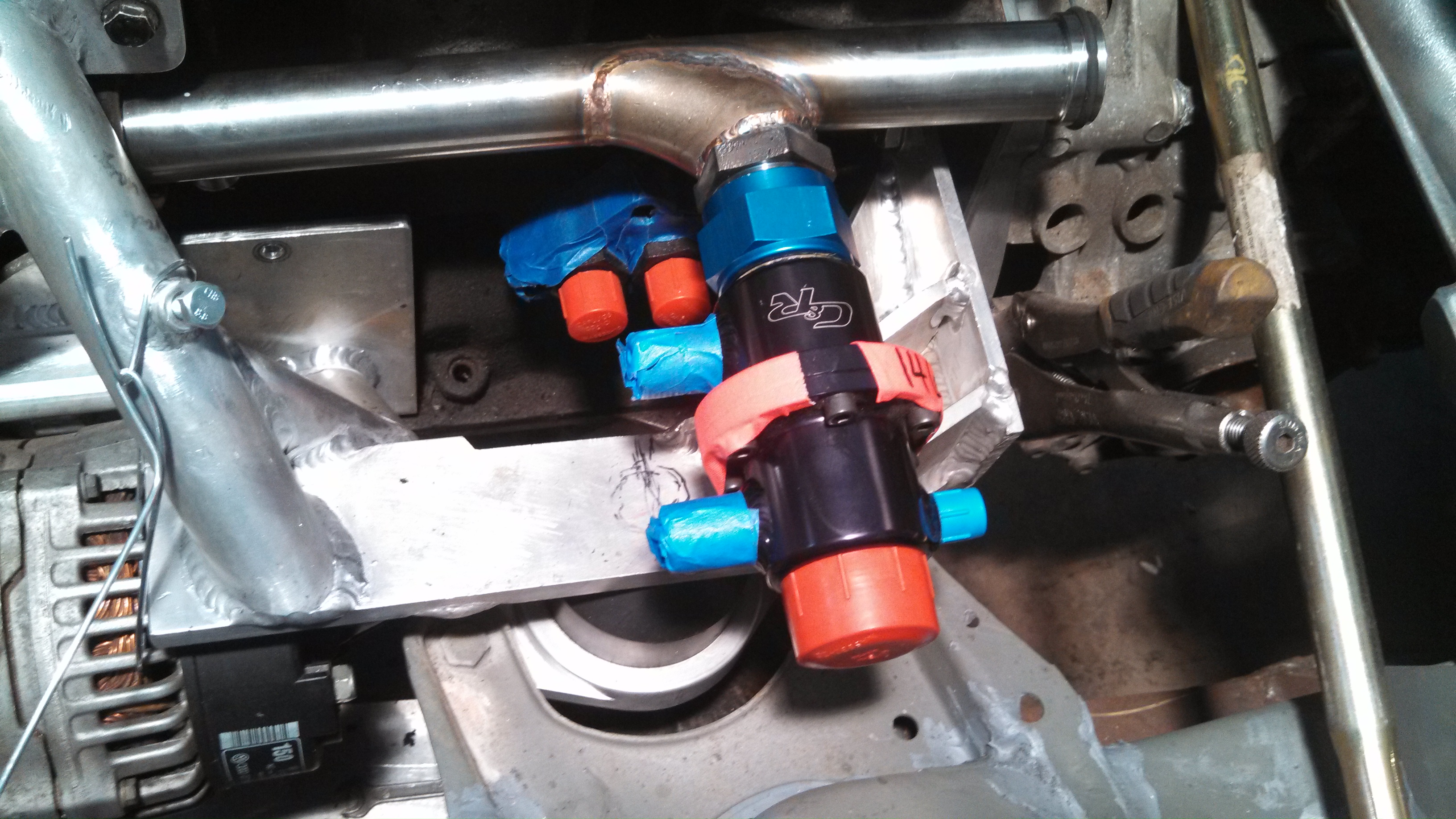

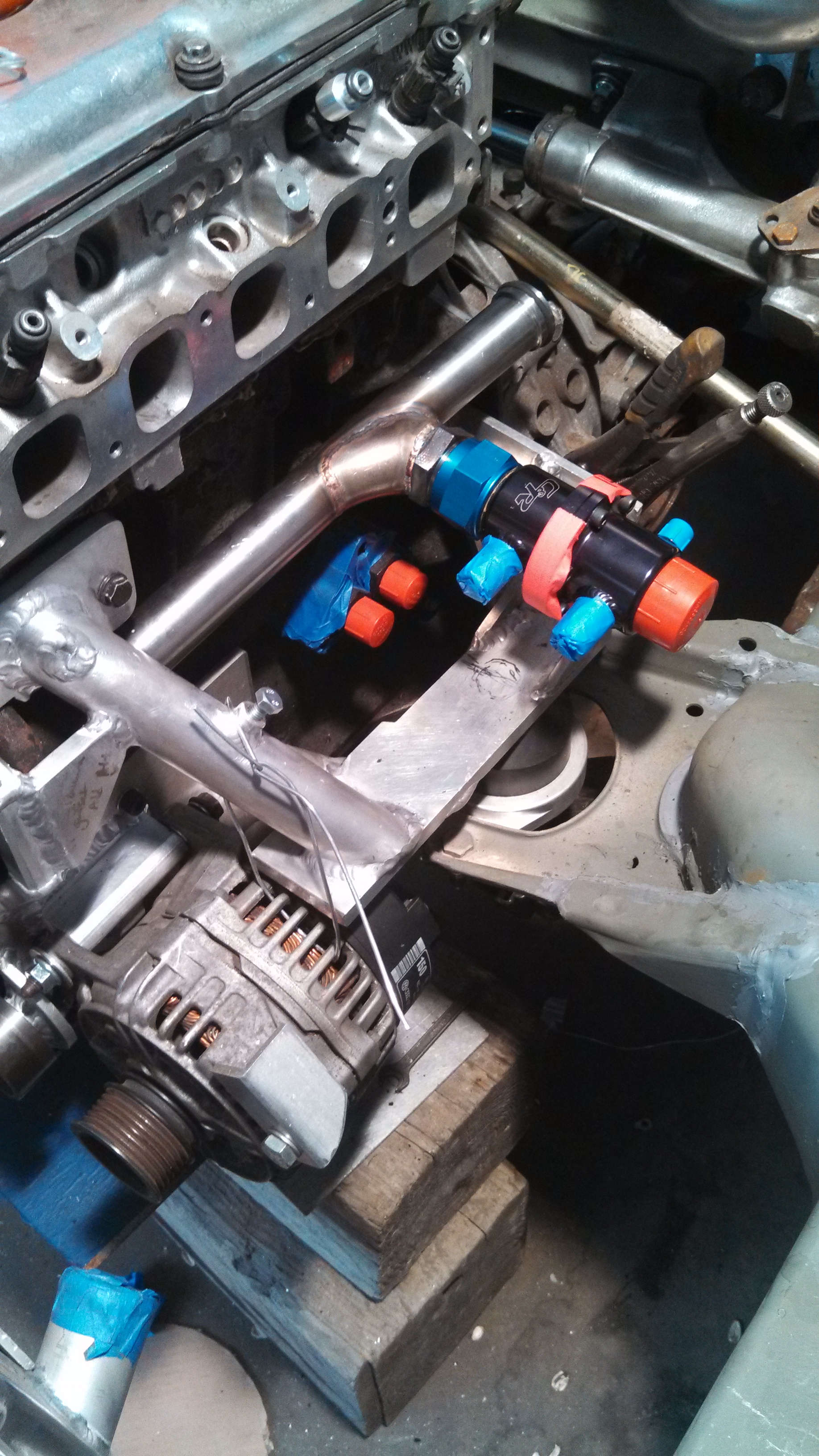

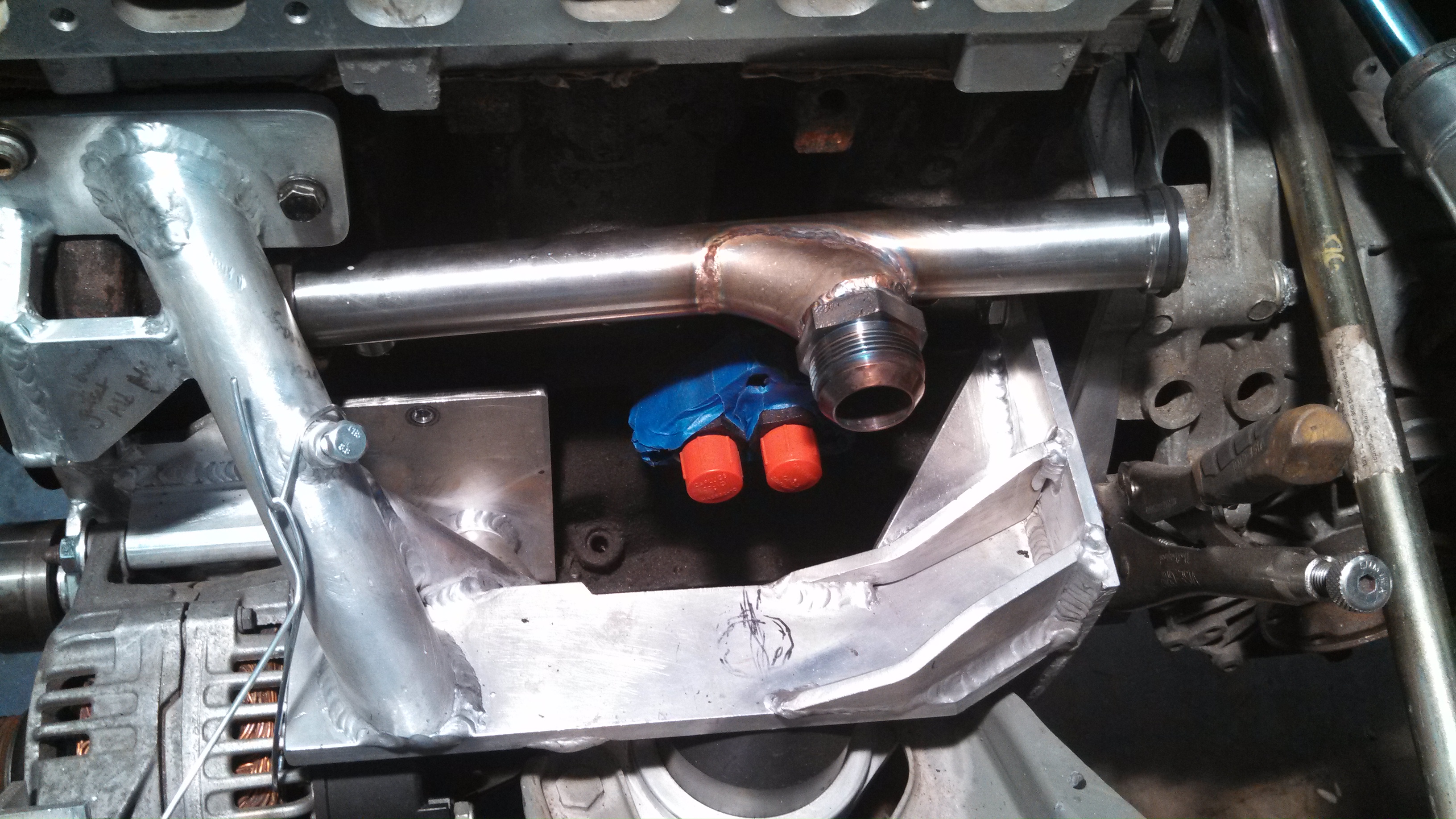

ok, back to the cooling system. I built a nice transition from the crackpipe to the remote thermostat return.
eng mount and crackpipe work.jpg (1.4 MiB) Viewed 52379 times
The remote thermostat will be plumbed in a manner that will get the thermostat itself a good warm water source while still allowing excellent from from the t-stat th the waterpump.
crackpipe to thermostat bung mockup.jpg (1.39 MiB) Viewed 52379 times
crackpipe to thermostat bung mockup2.jpg (1.28 MiB) Viewed 52379 times
Re: 24vVR6T CQ Project: EATSGTR, chassis FAB
Welded
crackpipe bung welded.jpg (1.74 MiB) Viewed 52379 times
crackpipe bung welded upclose.jpg (1.7 MiB) Viewed 52379 times

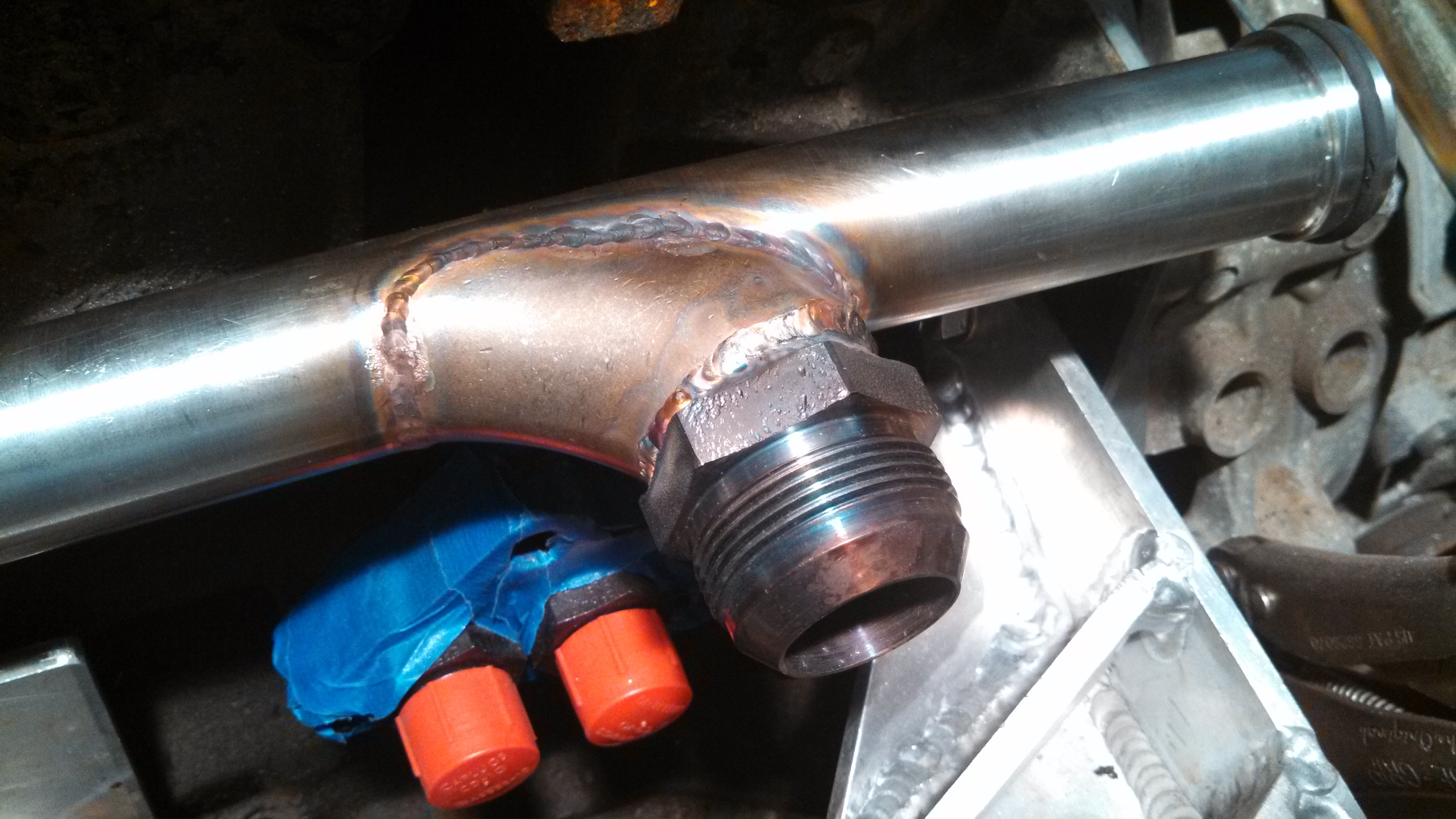

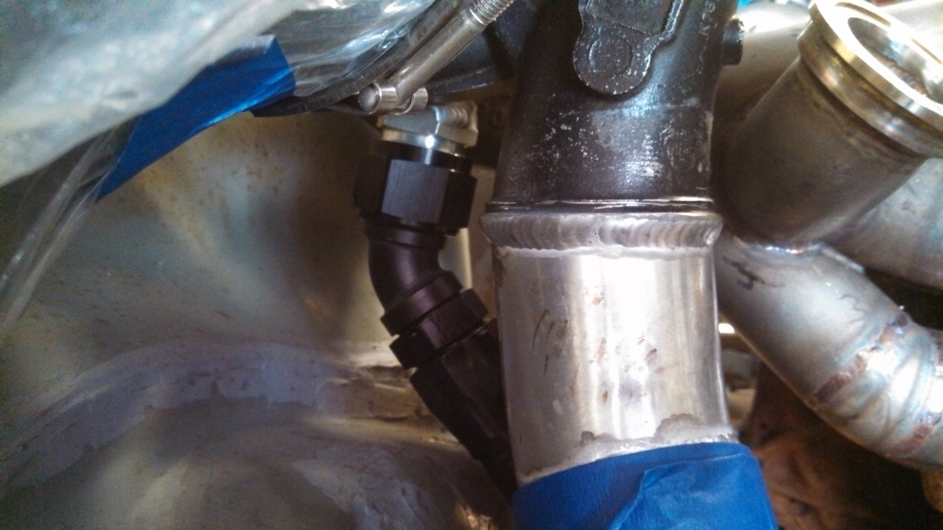

And here is the remote thermo housing installed.
modified crackpipe and remote thermostat.jpg (1.72 MiB) Viewed 52379 times
modified crackpipe and remote thermostat2.jpg (1.87 MiB) Viewed 52379 times
The radiator outlet hose will be a nice easy bend to a 90 deg. fitting from the t-stat housing.
I still need to make some tabs to help support the crackpipe and remote t-stat

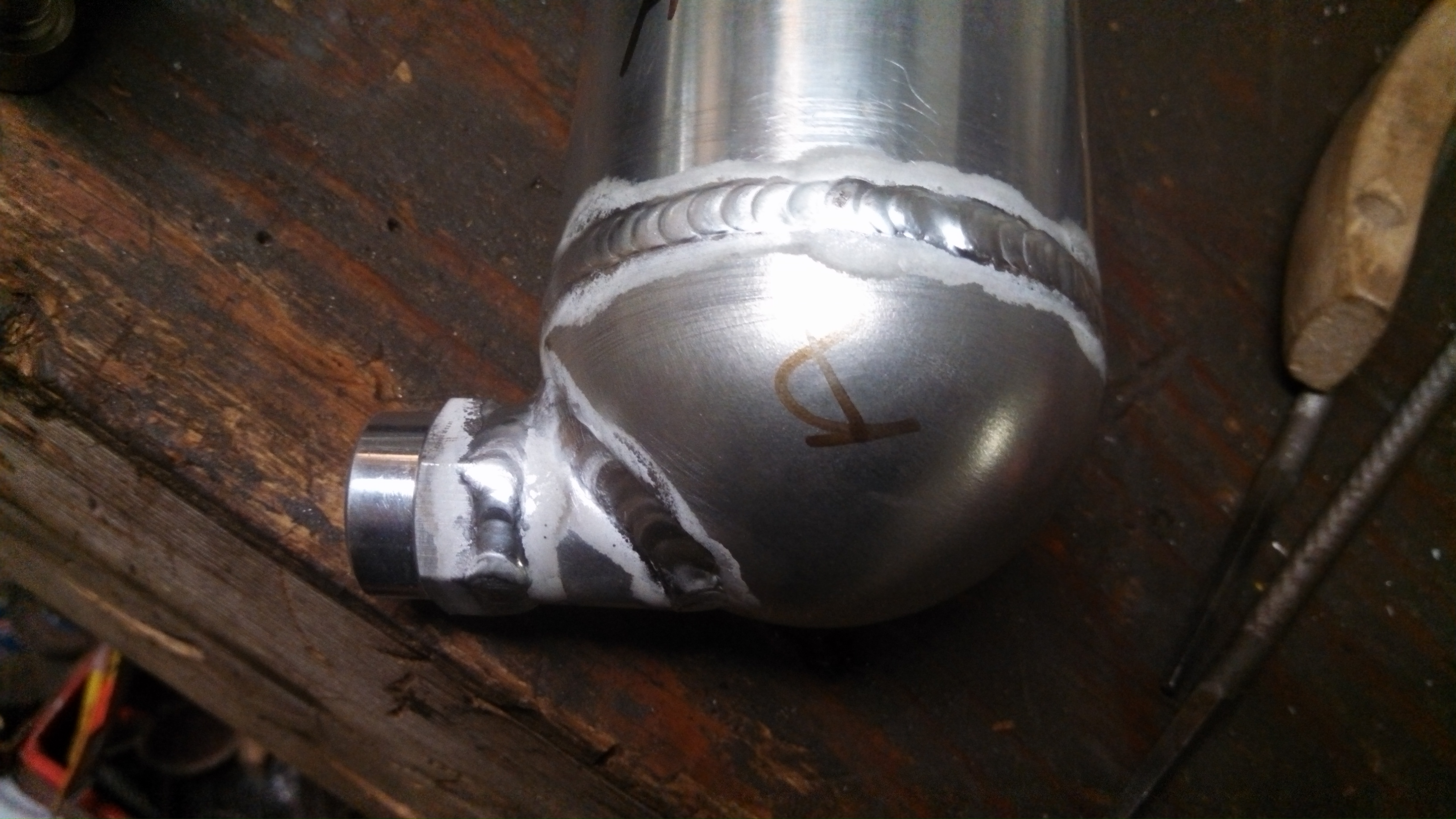

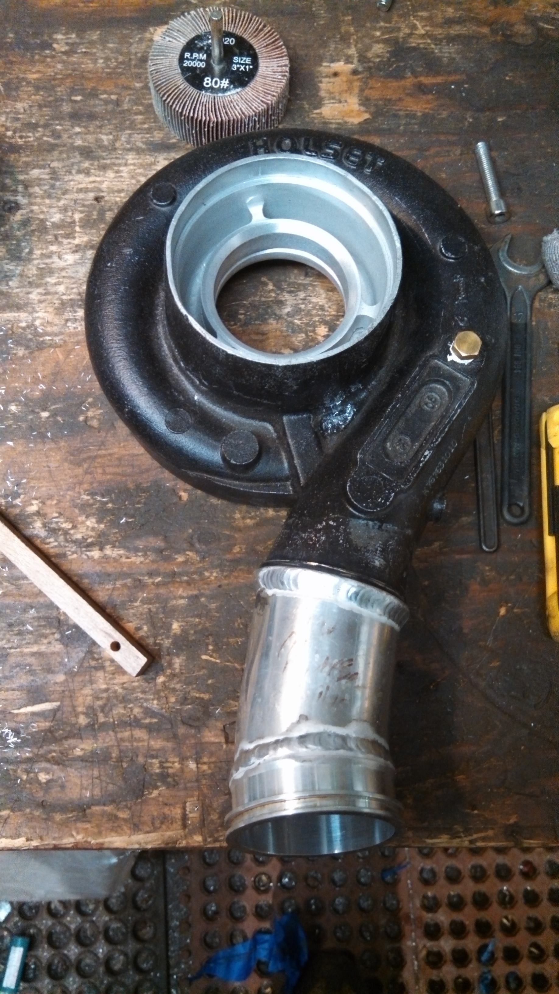

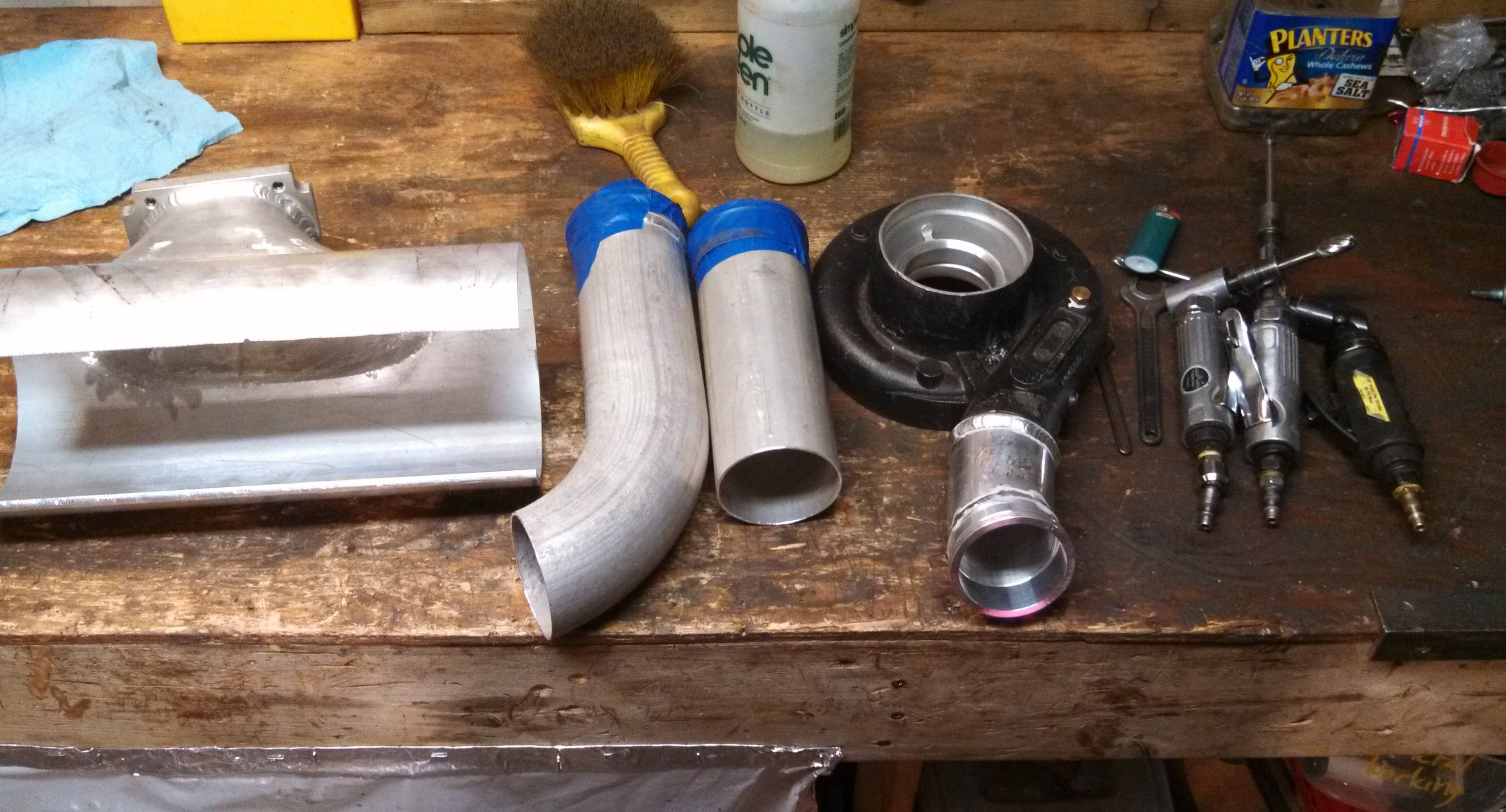

I also got a chance to get back into the AIR plumbing.
making air plumbing.jpg (1.58 MiB) Viewed 52379 times

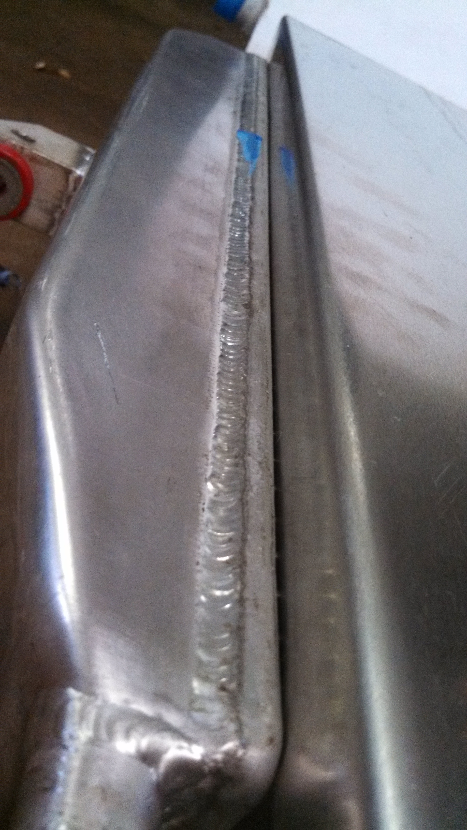

I got a lot of the vanjen flanges welded on, and some of the intake piping done, all the weds came out very clean with little to no, melt through. I went ahead and carbide cleaned and flapper drummed them nice and smooth.
cleaned up tb to vanjen flange.jpg (1.92 MiB) Viewed 52379 times

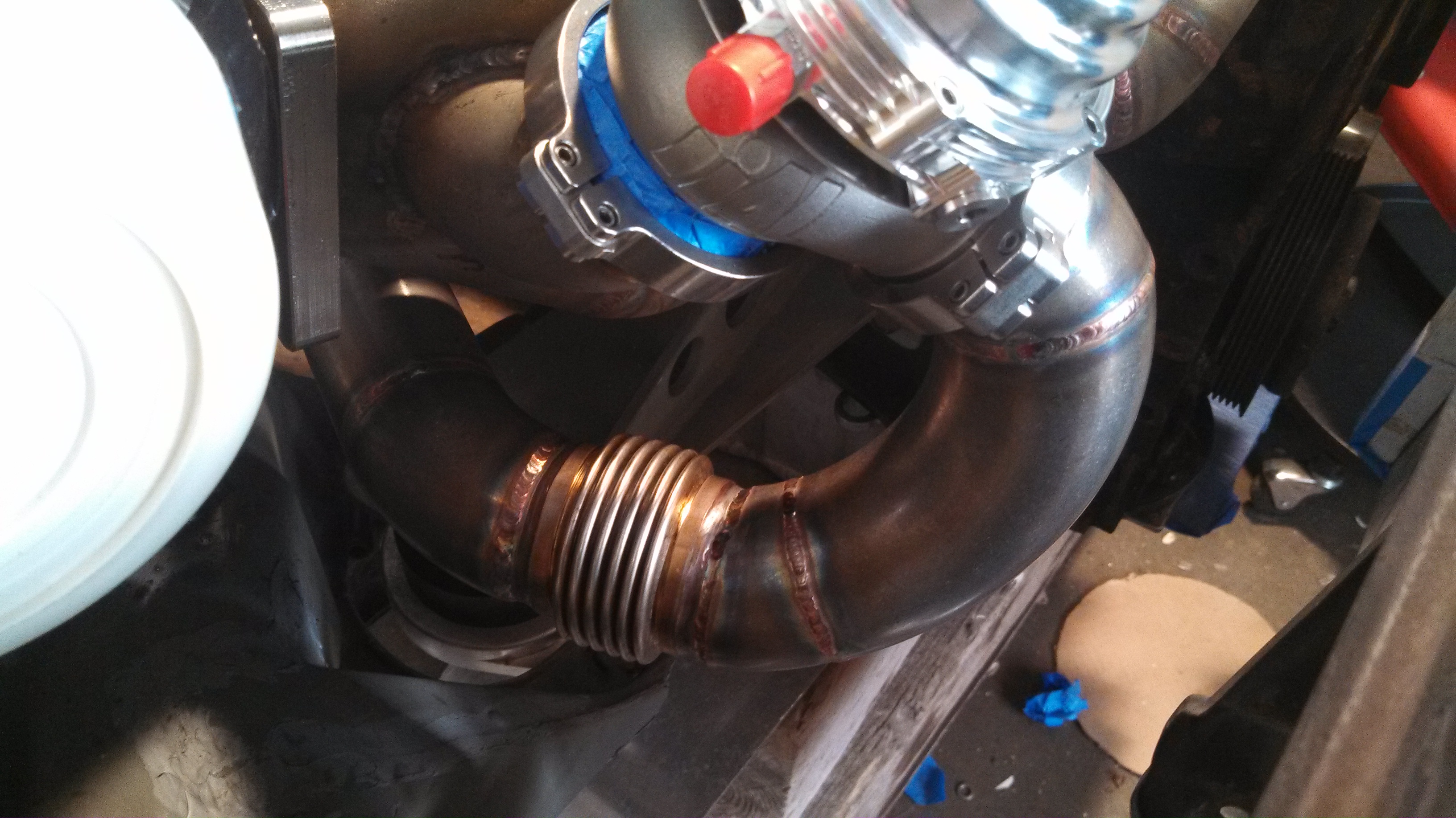

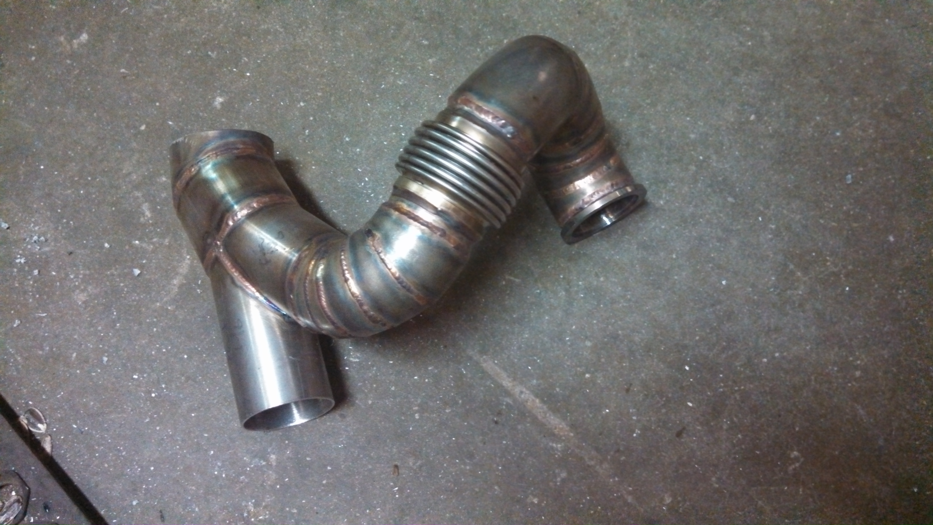

I also added a small extension and bend to the compressor outlet to aid in clearing the hot exhaust manifold and Wastegate dump.
compressor outlet extension and vanjen flange.jpg (1.73 MiB) Viewed 52379 times

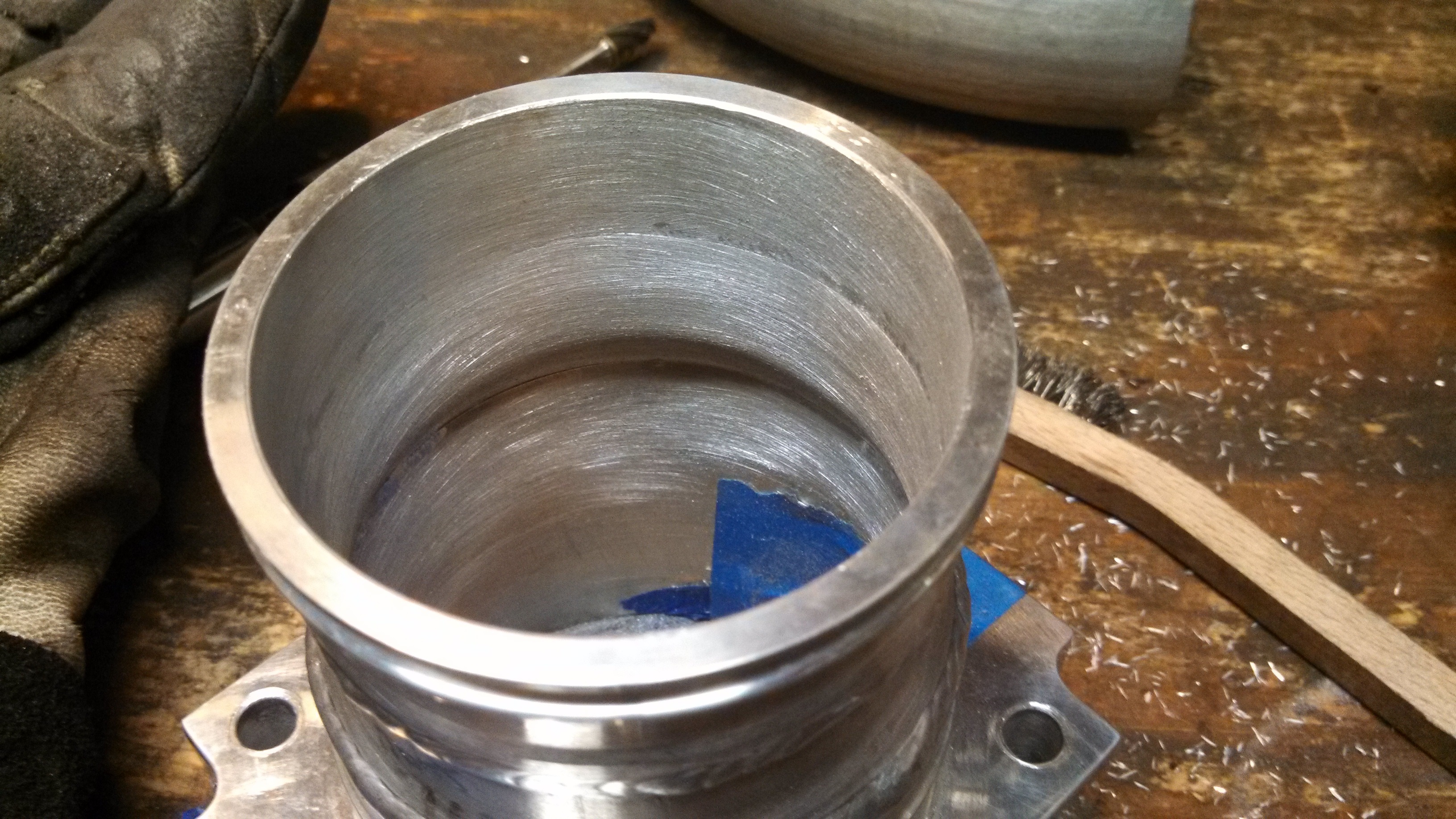

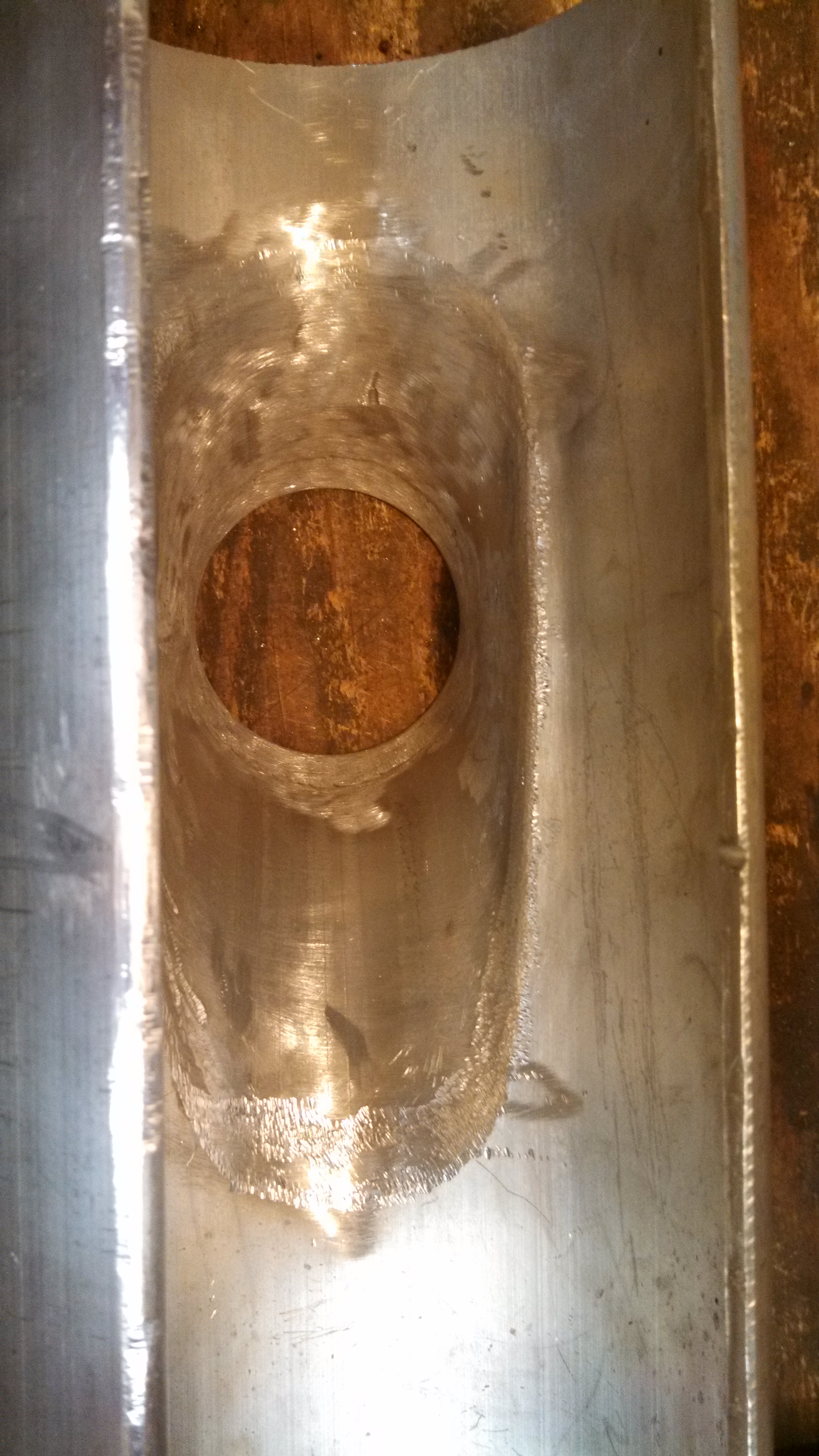

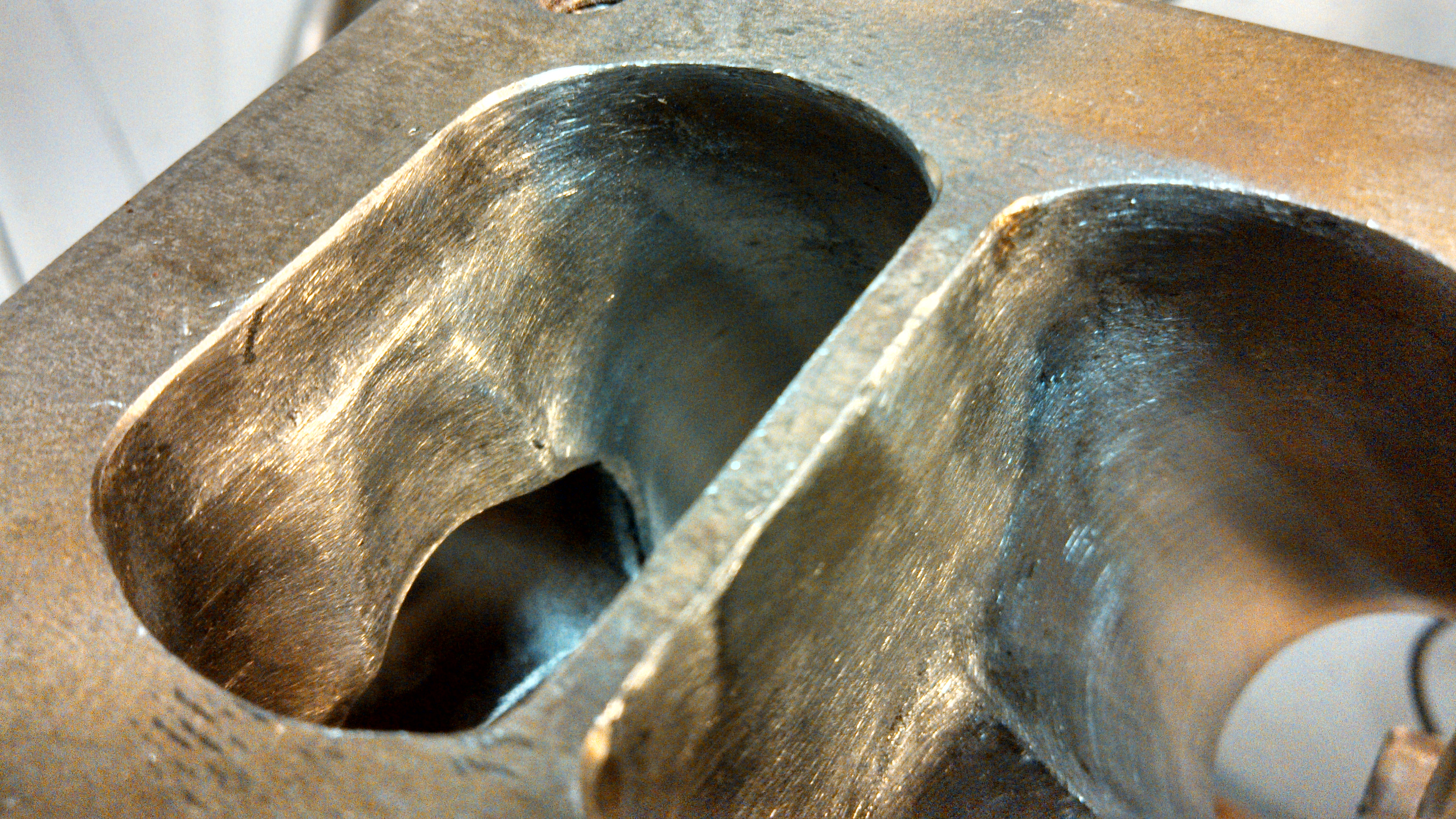

I also cleaned up the inside of the intake manifold plenum feed, with some 60/80 grit flapper drums.
smooth inner plenum transition.jpg (1.95 MiB) Viewed 52379 times
smooth inner plenum transition2.jpg (1.35 MiB) Viewed 52379 times

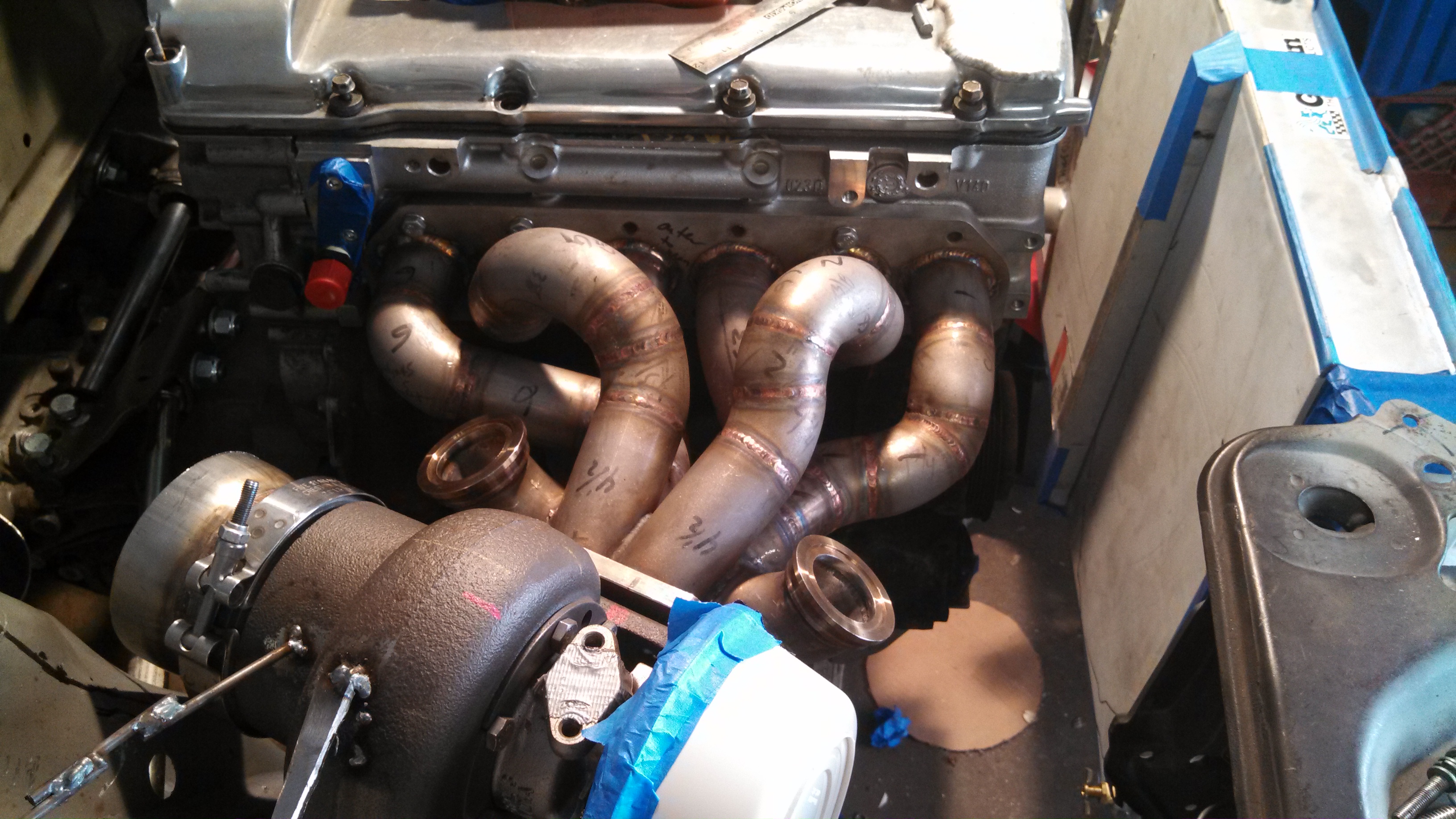

MORE!!!

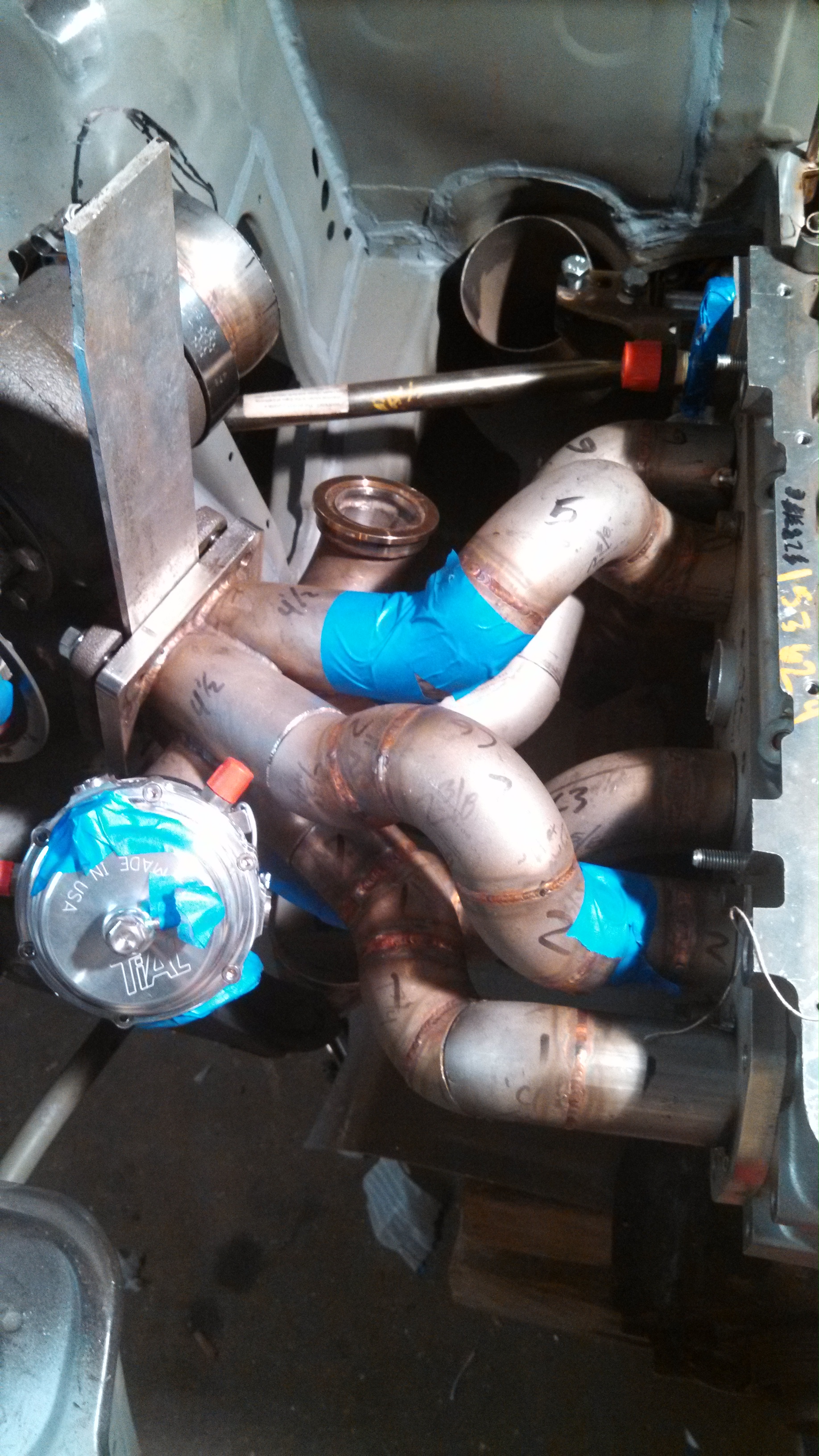

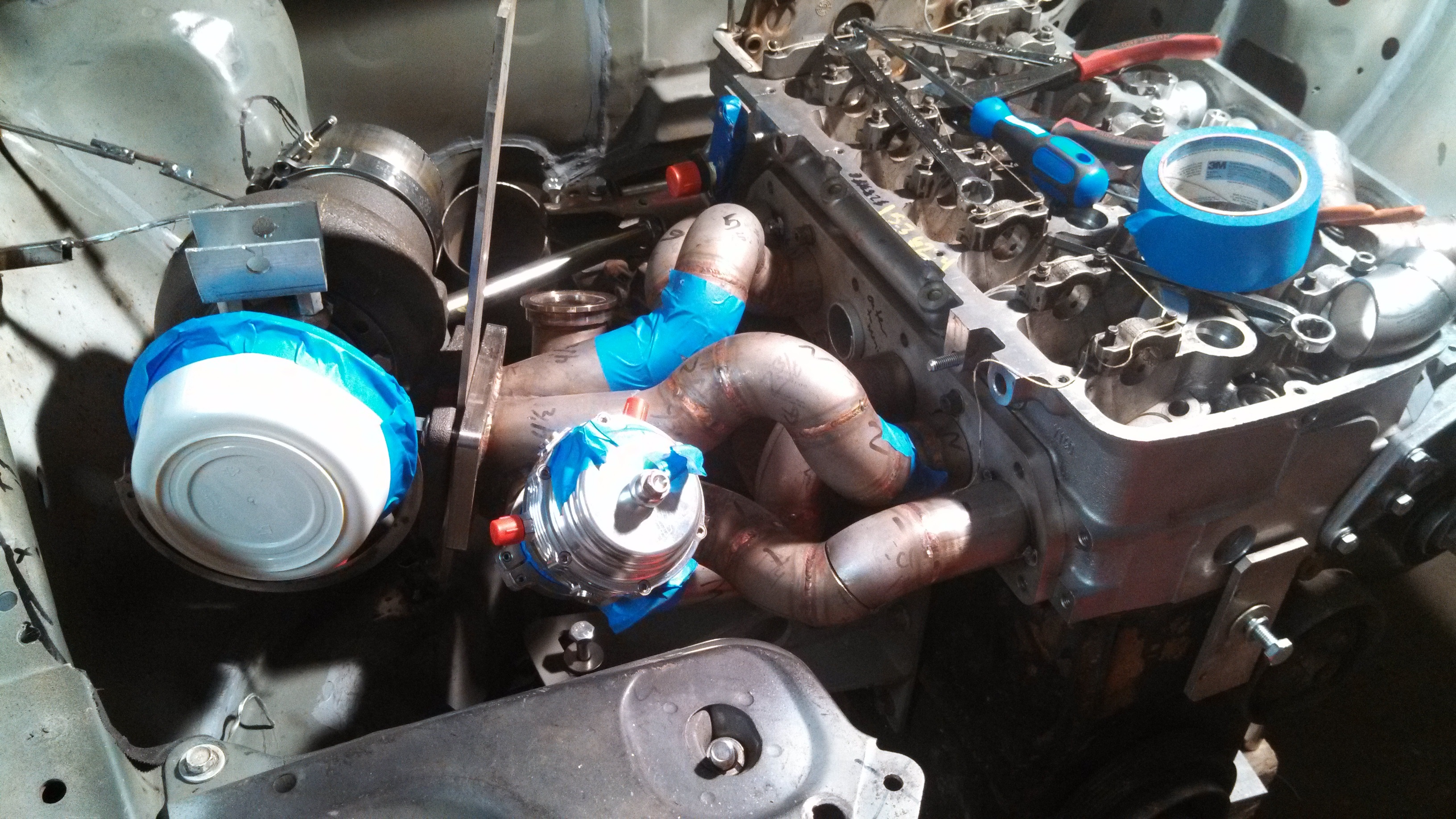

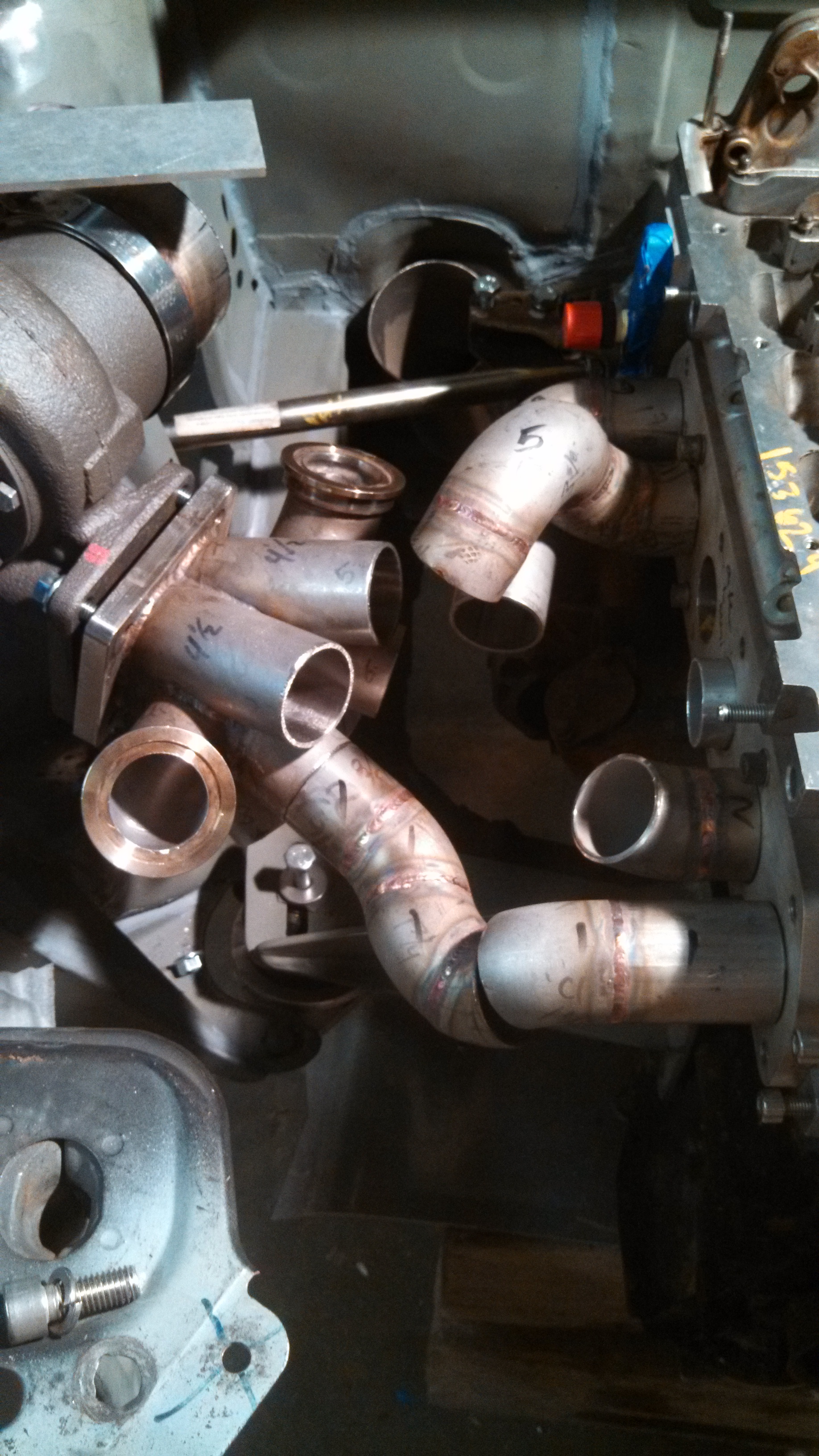

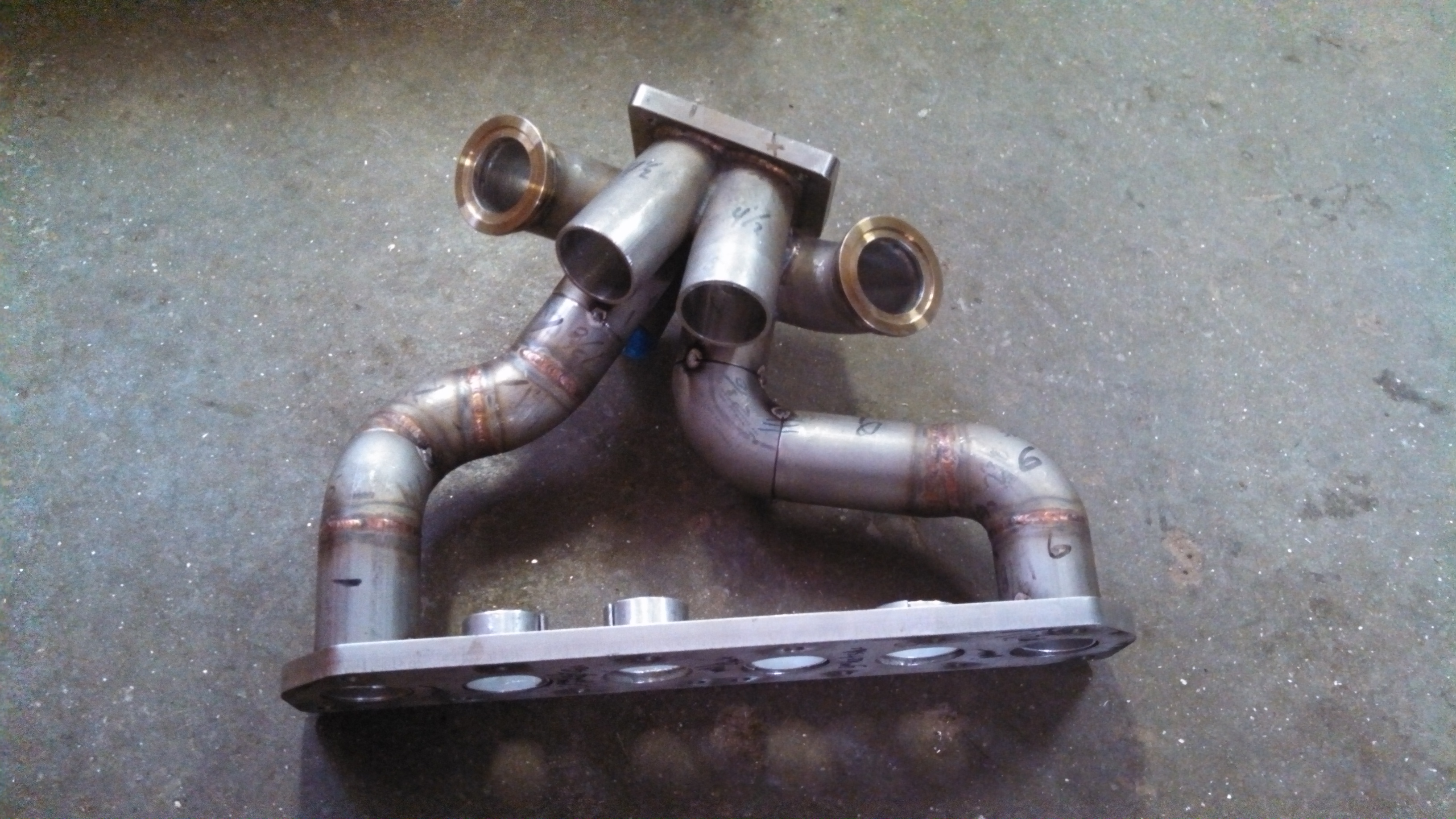

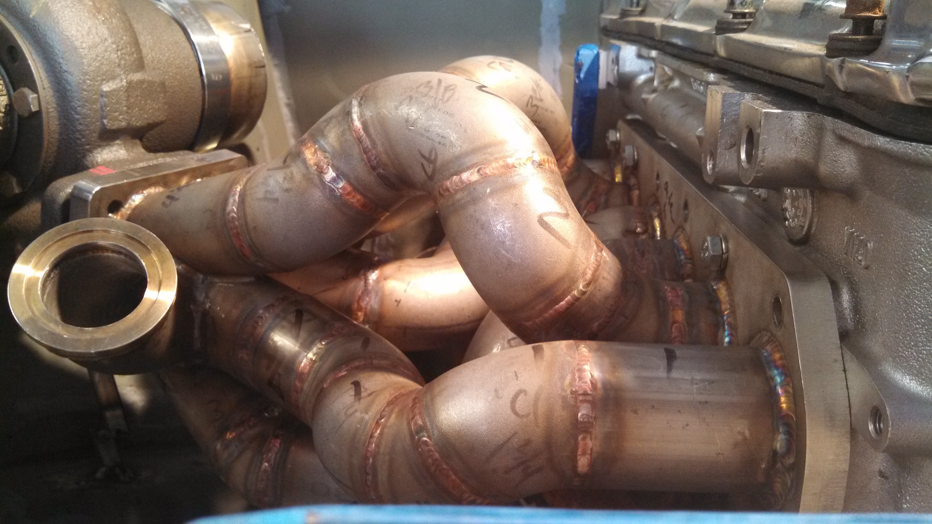

Ok back to this sexy exhaust manifold!!!
I picked up all of the individual runners from ryan. He welded all of the runners together except for the last elbow on the head or collector side, and has not yet welded the runners to the flange or collector. So I brought all of the pieces home and proceeded to reassemble/check fitment.
runner welded now reassemble.jpg (1.82 MiB) Viewed 52385 times
All told each runner shrunk about 1/8”. I know this is exact because the hot-side was welded to the inner fender and obv. would not bolt back together if it’s all tacked back up. So I slid a piece of 1/8” thick alu. between the manifold flange and hot-side flange and tightened it back up. Then it went back together like Legos hahaha.
runners welded reassembly.jpg (1.97 MiB) Viewed 52385 times
runners welded reassembly2.jpg (1.88 MiB) Viewed 52385 times
Ryan had me tack on one runner for either side of the divided collector, to locate everything, but still allow him to assemble it as welded. This gives him good access to all sides of the runners as it comes together.
tacked and ready for ryan.jpg (1.54 MiB) Viewed 52385 times

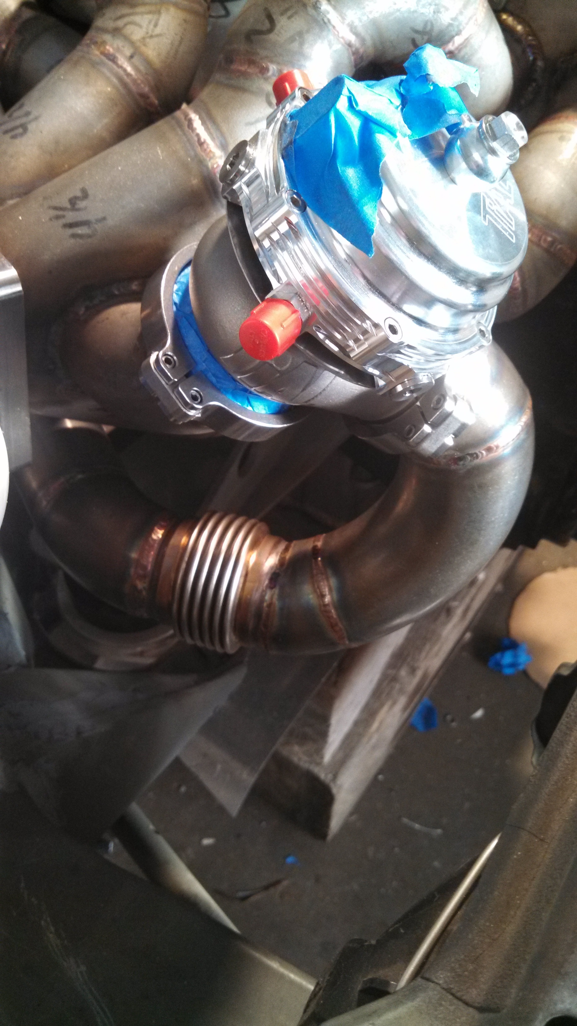

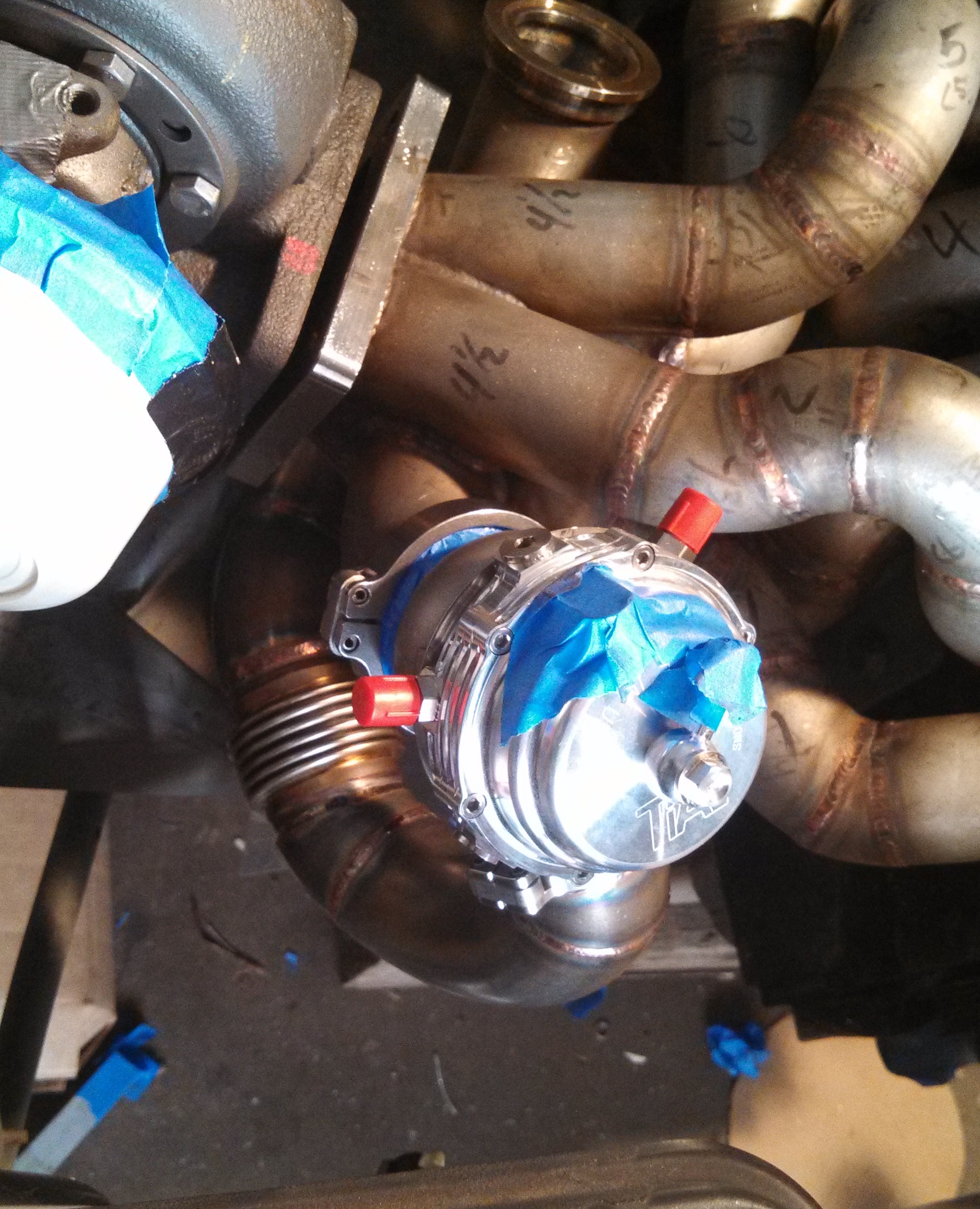

I also got to start the Wastegate dump in the front, once the second WG comes in I can merge the two outlets together and run a short 2.5” section back into the downpipe between the front halfshaft and the steering rods.
WG dumps being built.jpg (1.89 MiB) Viewed 52385 times

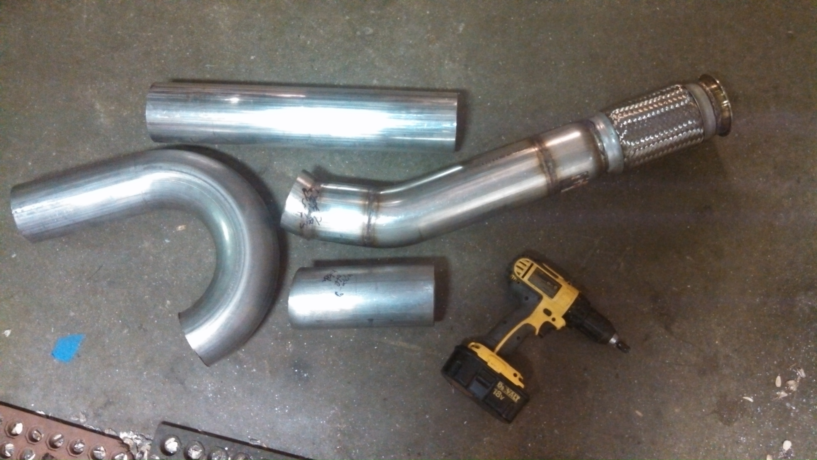

MORE!
AND ITS DONE!!!!!!!! Well sans EGT bungs anyway, but quite close
front of exh mani.jpg (1.87 MiB) Viewed 52382 times
He welded one runner above then one below, and back and forth. END RESULT the head flange is flat to well under 0.01”!!!!!!!!
Dead flat.
And here it is re-installed on the head.
exh manifold reinstalled.jpg (1.55 MiB) Viewed 52382 times
exh manifold reinstalled2.jpg (1.66 MiB) Viewed 52382 times

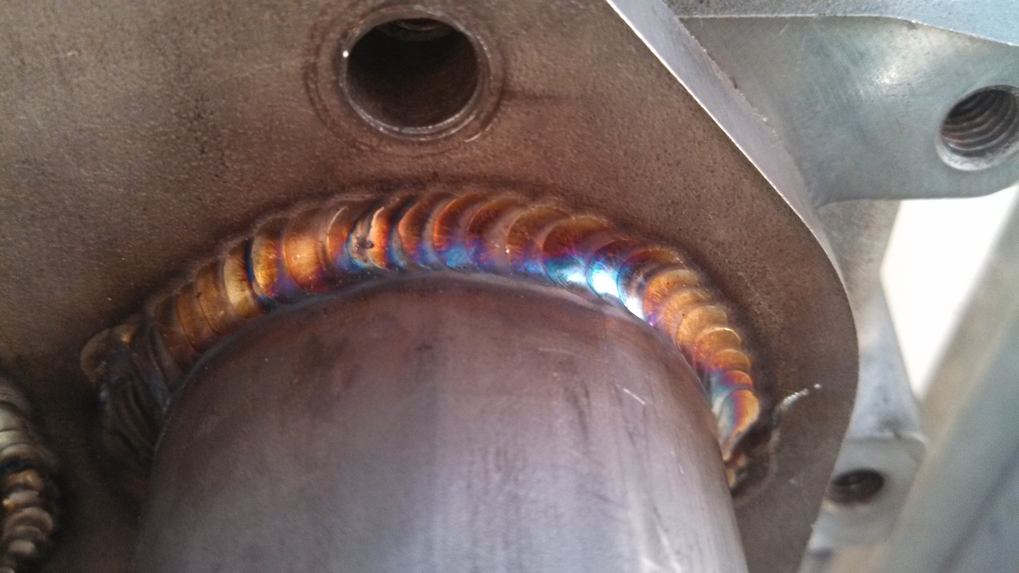

And DANG!! Ryan can put down a pretty sweet bead.
manifold bead2.jpg (1.75 MiB) Viewed 52382 times
manifold bead.jpg (1.86 MiB) Viewed 52382 times

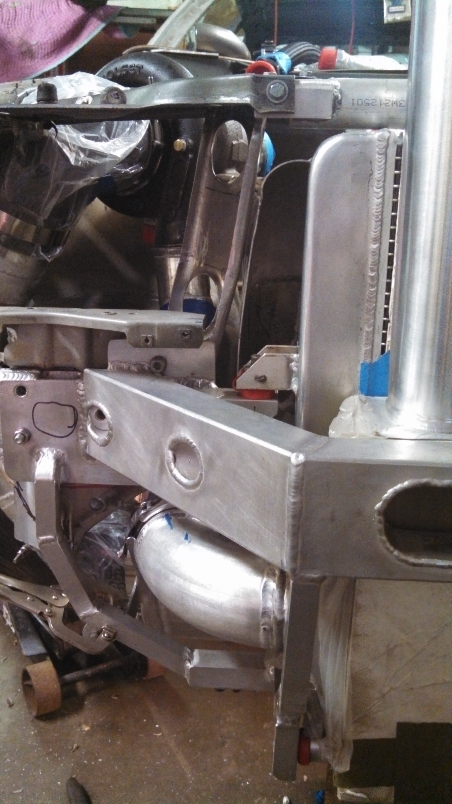

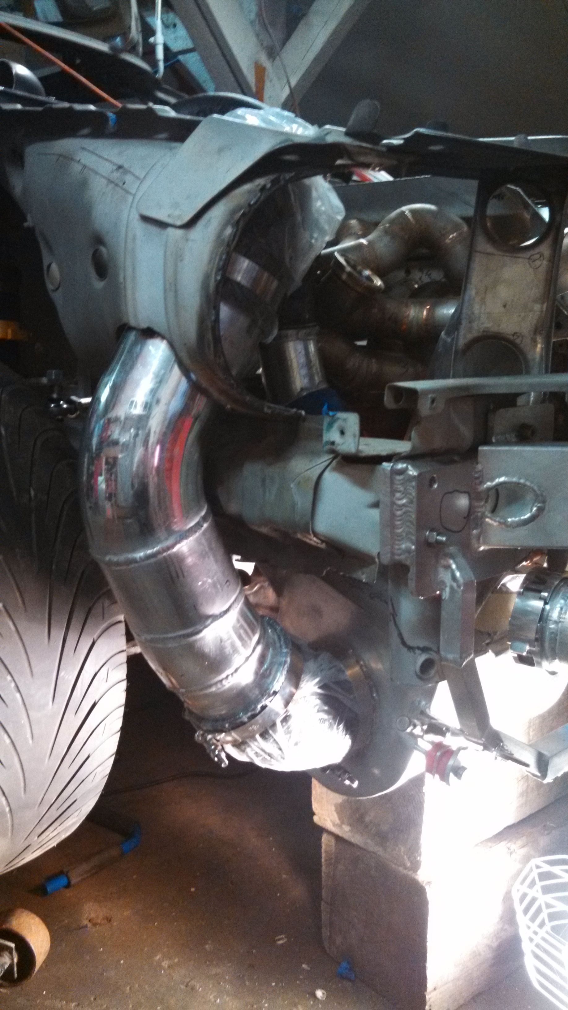

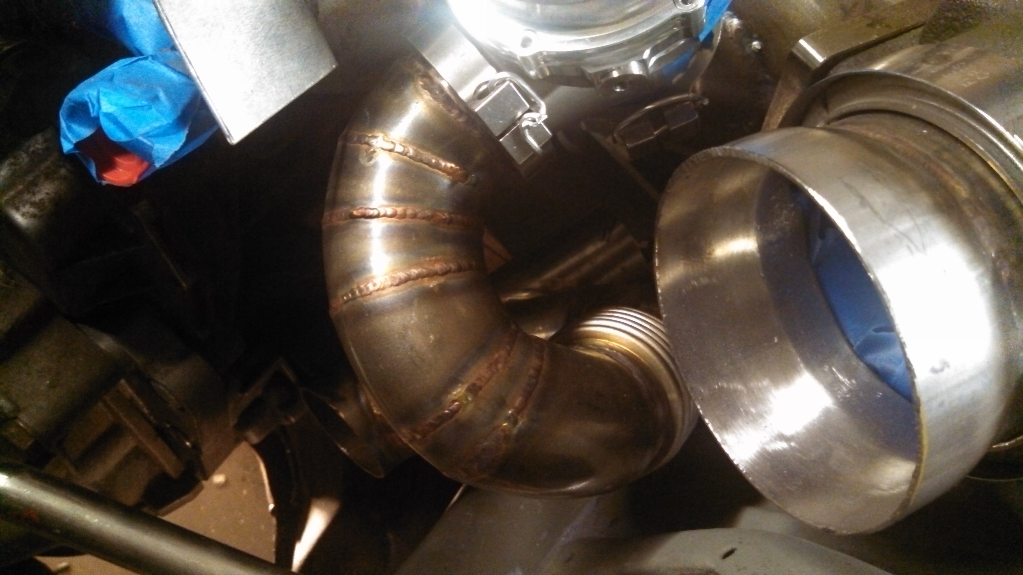

Here is the front Wastegate dump welded up and run back under the collector. The dumps will merge into a single 2.5” and then back into the downpipe
wg outlet front3.jpg (1.22 MiB) Viewed 52380 times
wg outlet front2.jpg (1.63 MiB) Viewed 52380 times
wg outlet front from between headlight and radiator.jpg (1.74 MiB) Viewed 52380 times
wg outlet front.jpg (1.59 MiB) Viewed 52380 times

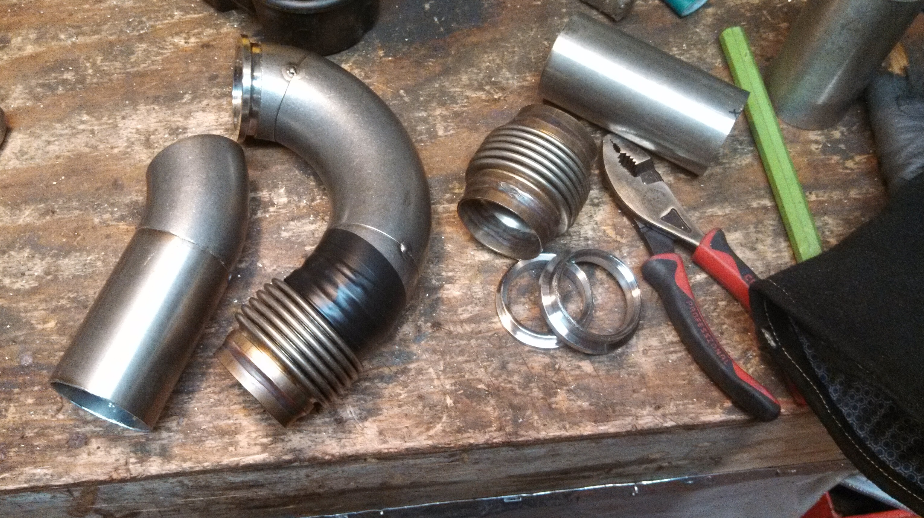

And booya!! 4” 180 bend in 304SS, its downpipe time!!!!

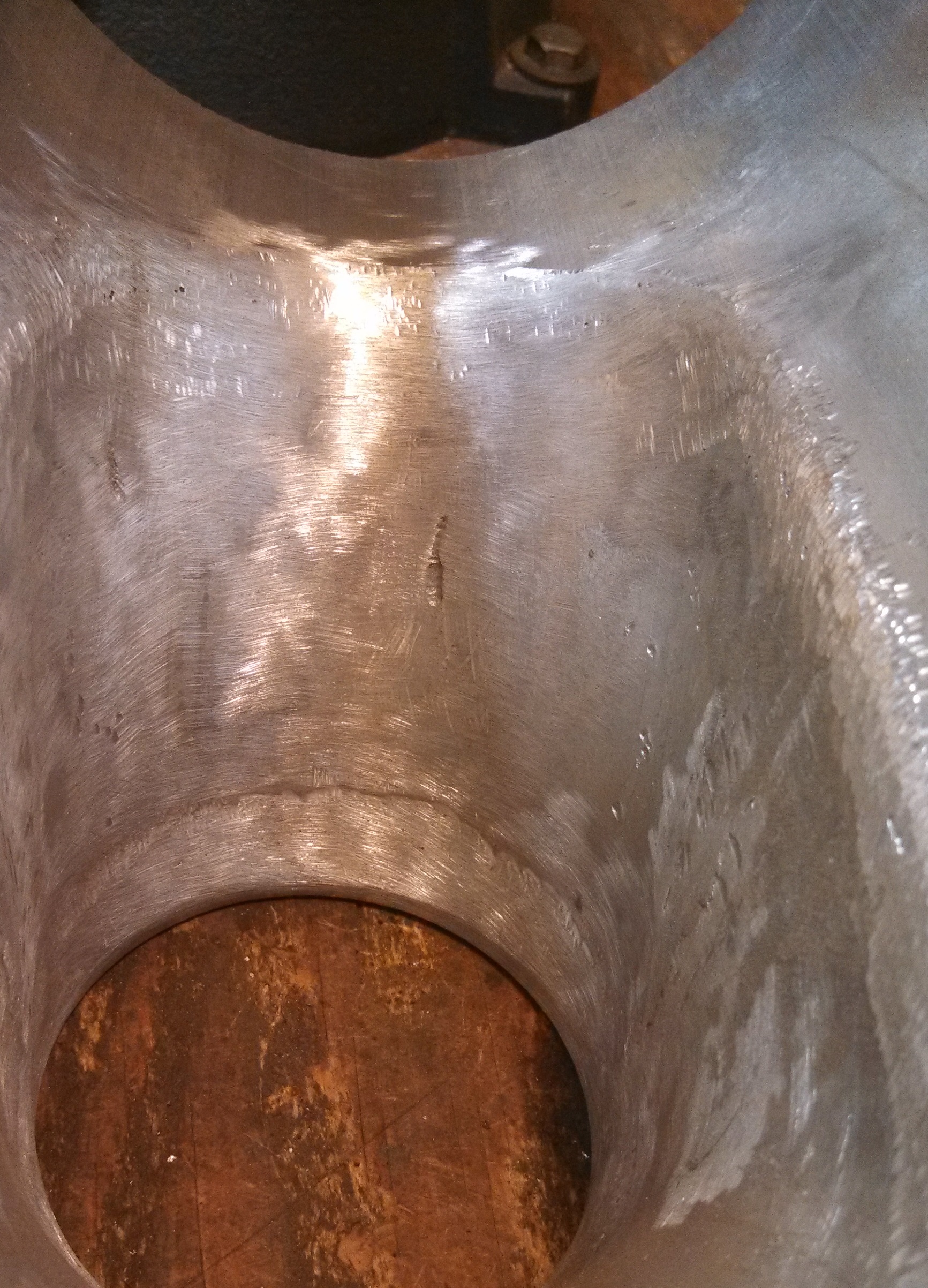

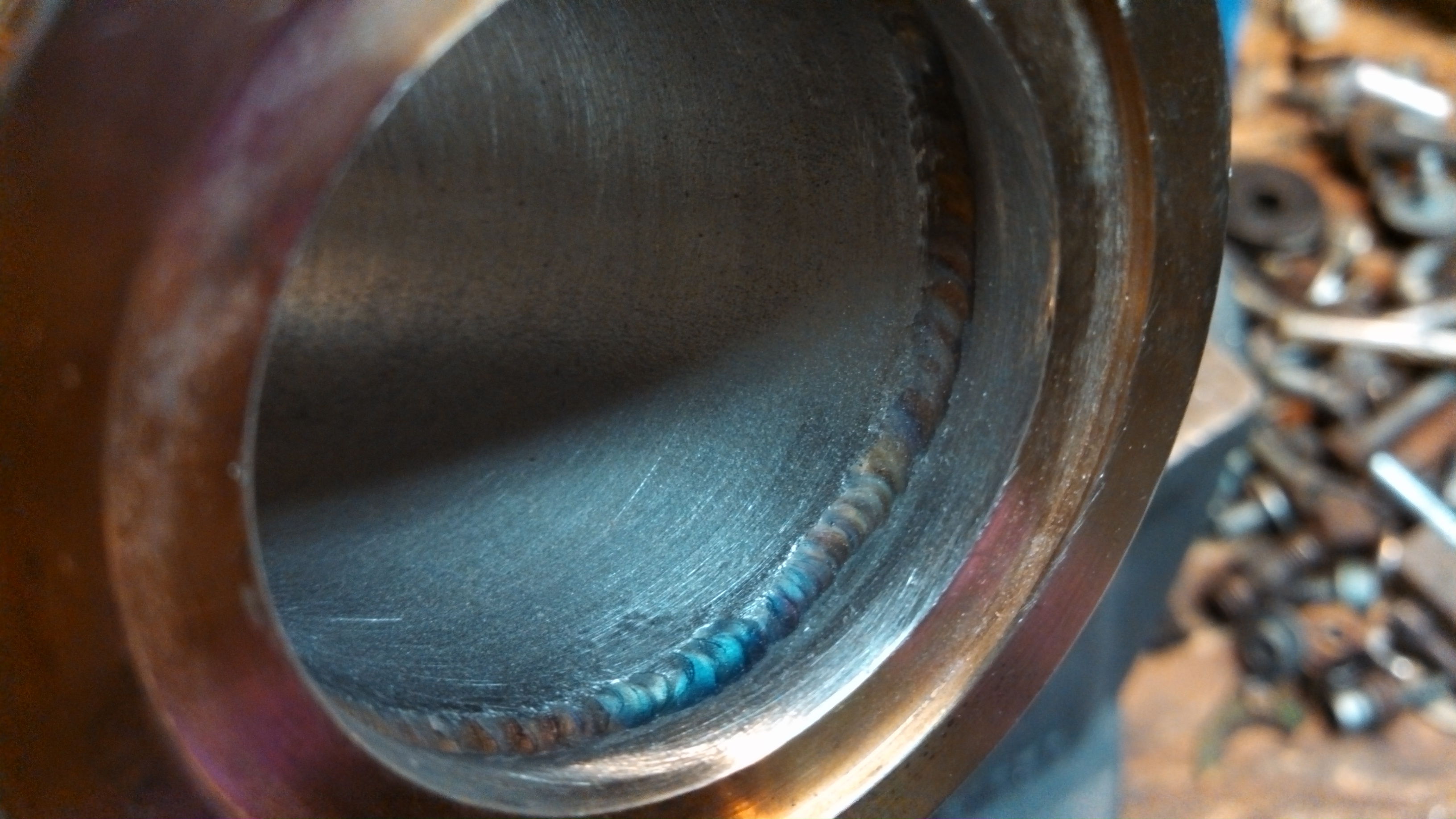

I found a few extra pics of the inside of the collector all cleaned up
inner collector polished1.jpg (3.28 MiB) Viewed 52307 times
inner collector polished2.jpg (3.14 MiB) Viewed 52307 times
inner collector polished3.jpg (1.47 MiB) Viewed 52307 times
inner collector polished4.jpg (2.25 MiB) Viewed 52307 times
inner collector polished5.jpg (1.45 MiB) Viewed 52307 times

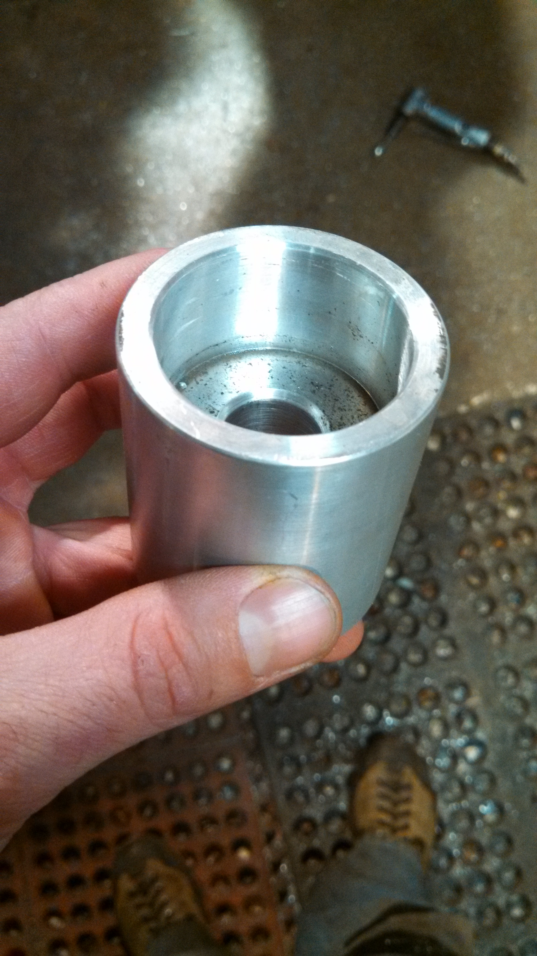

UPDATE!!!

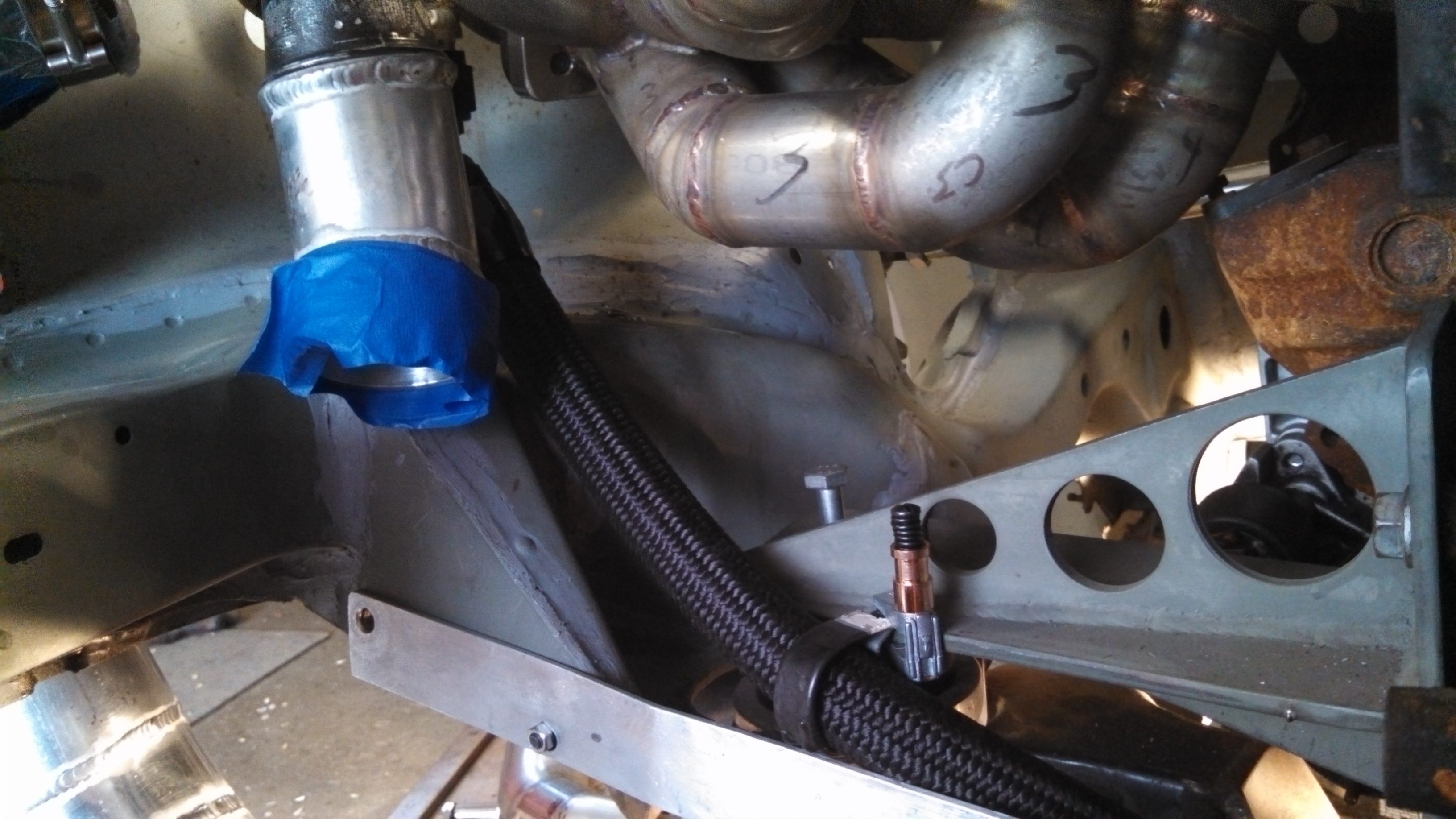

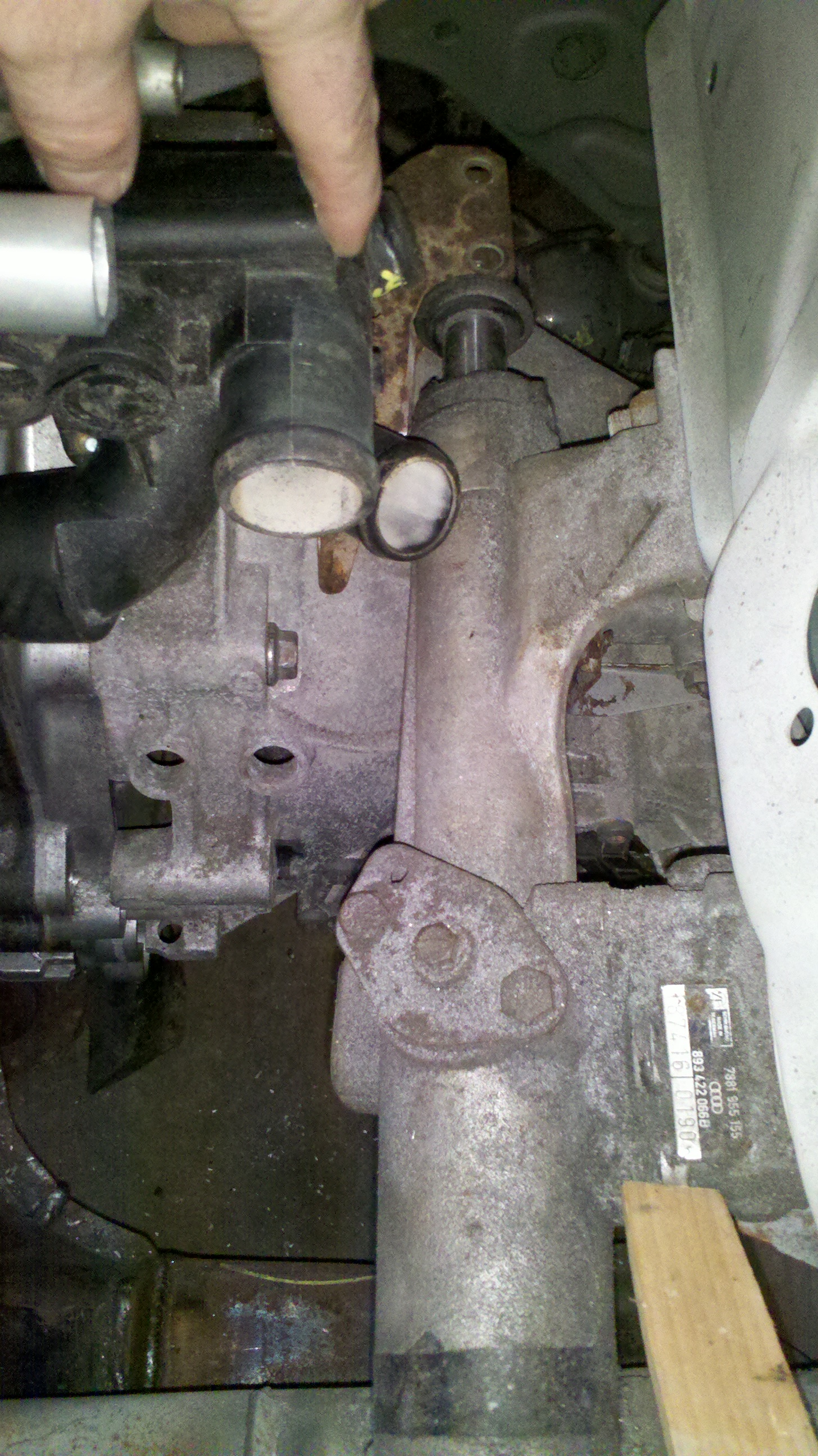

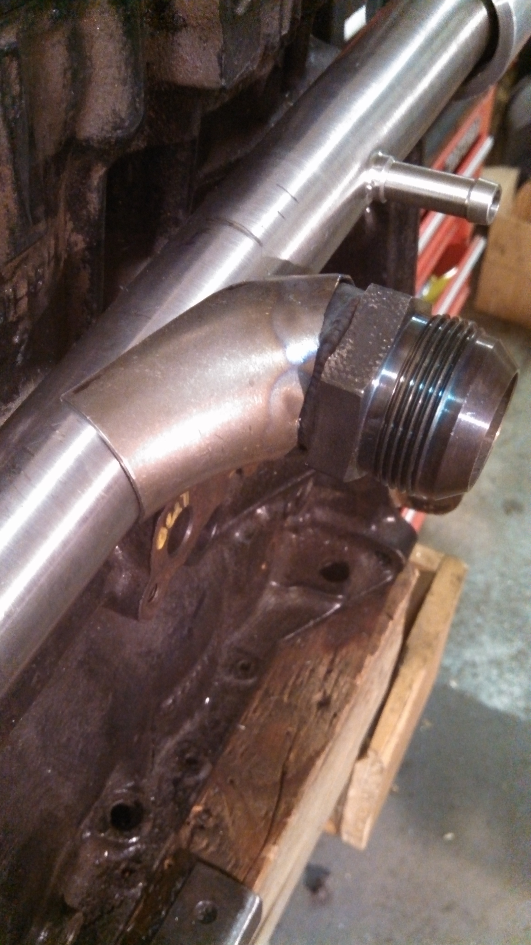

Ok lets get caught up! Theres no way the stock thermostat housing / coolant sensor housing is ever going to fit with the motor pushed back.
bdf coolant outlet at cylinder head.jpg (1.3 MiB) Viewed 51891 times
coolant bung steering rack interference.jpg (1.29 MiB) Viewed 51891 times
I had this coolant “crack” pipe receiver made up to fit to my fabricated coolant outlet on the back of the head.
coolant pipe reciever.jpg (1.97 MiB) Viewed 51891 times

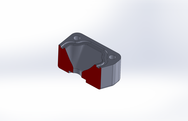

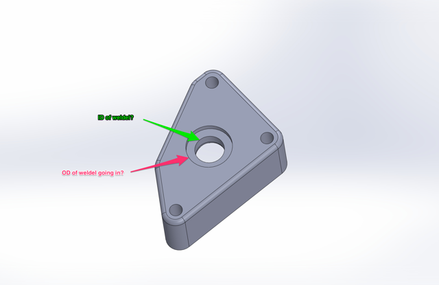

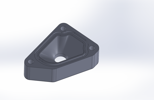

Haydn, drew up this piece and it will be getting machined shortly. It has a machined groove for the factory oring. It also has a nice smooth transition for the weld-els to be welded to.
vr coolant flange v1.png (91.03 KiB) Viewed 51891 times
vr coolant flange v1 2.png (89.18 KiB) Viewed 51891 times
vr coolant flange v1 3.png (71.33 KiB) Viewed 51891 times

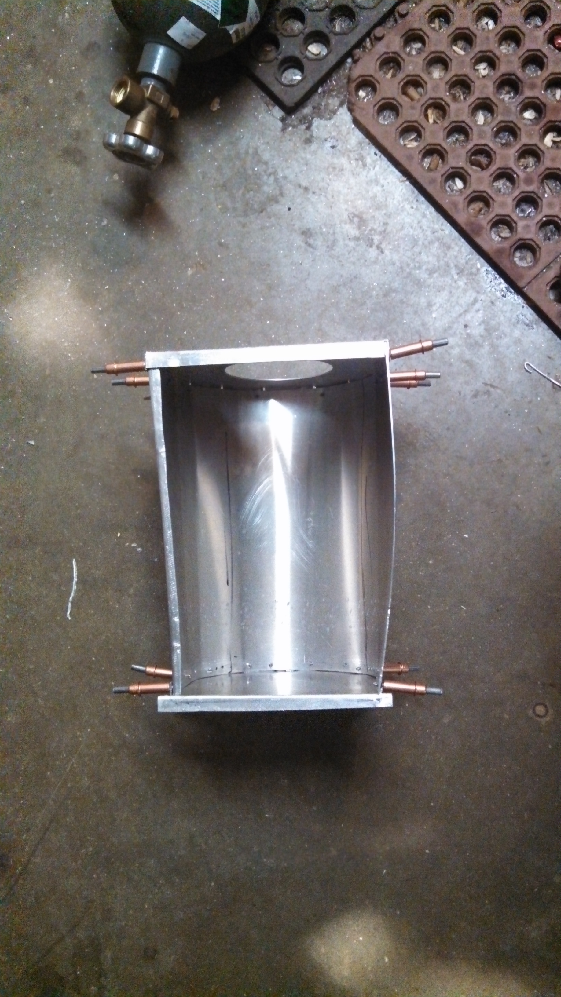

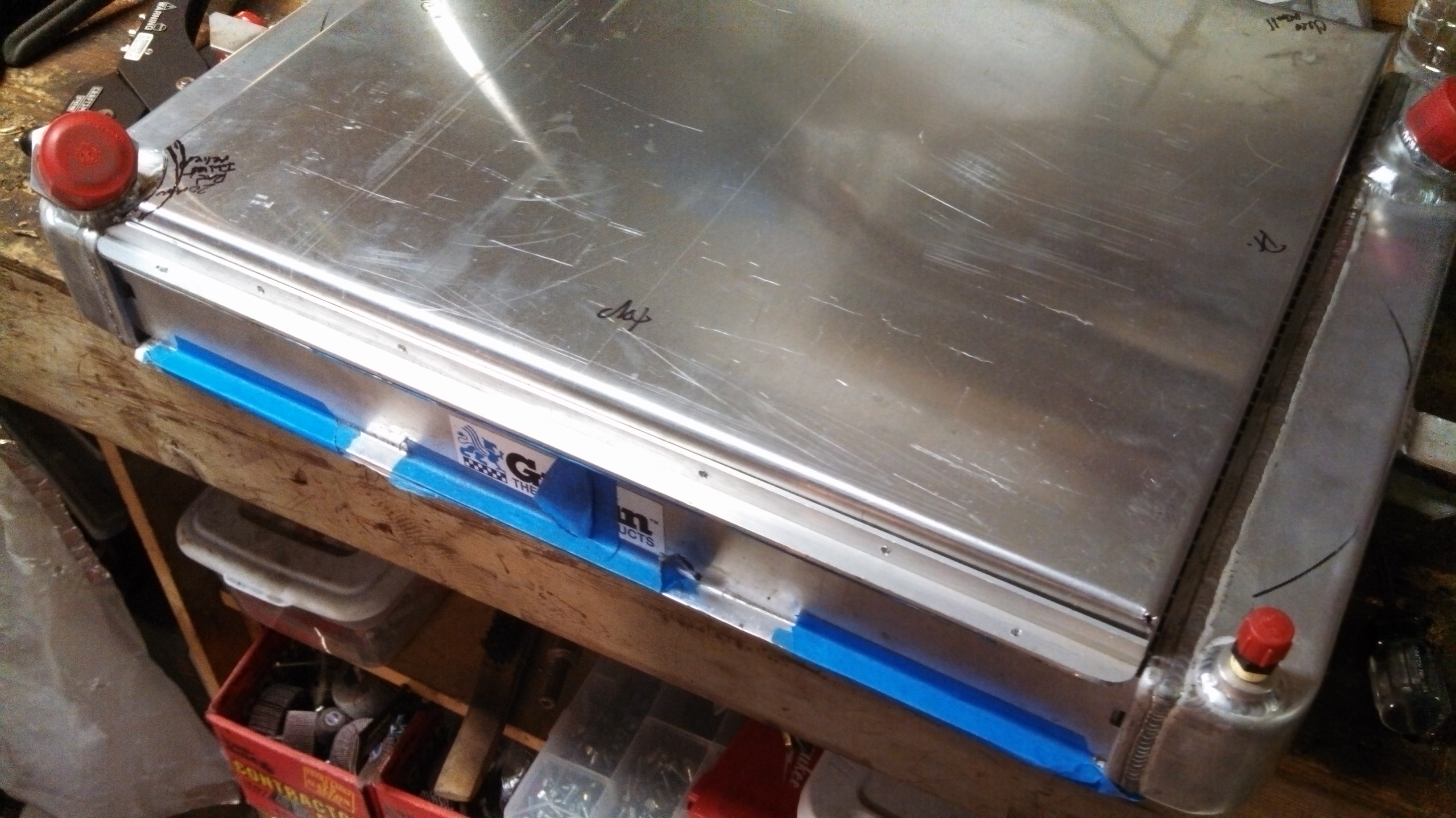

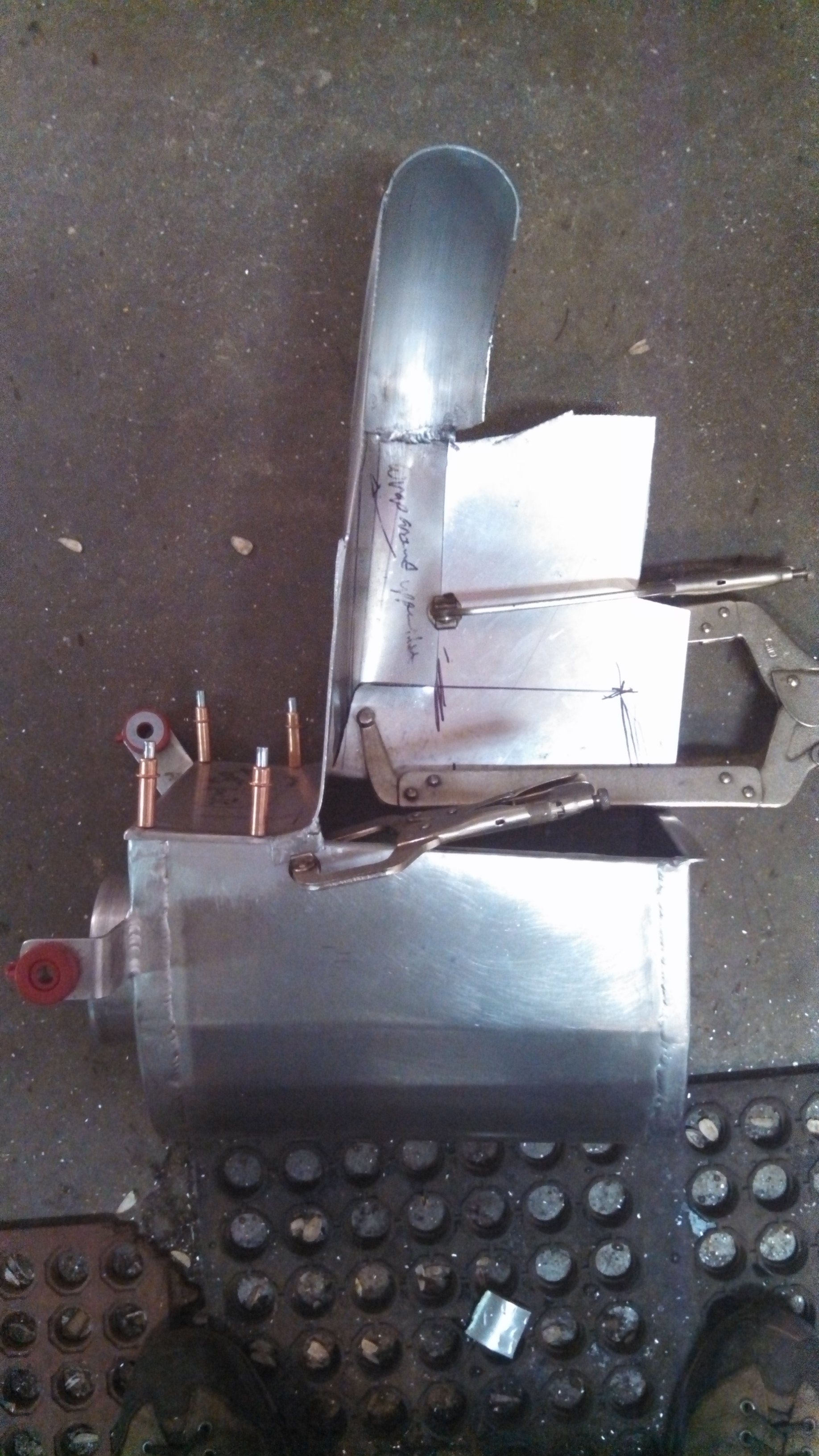

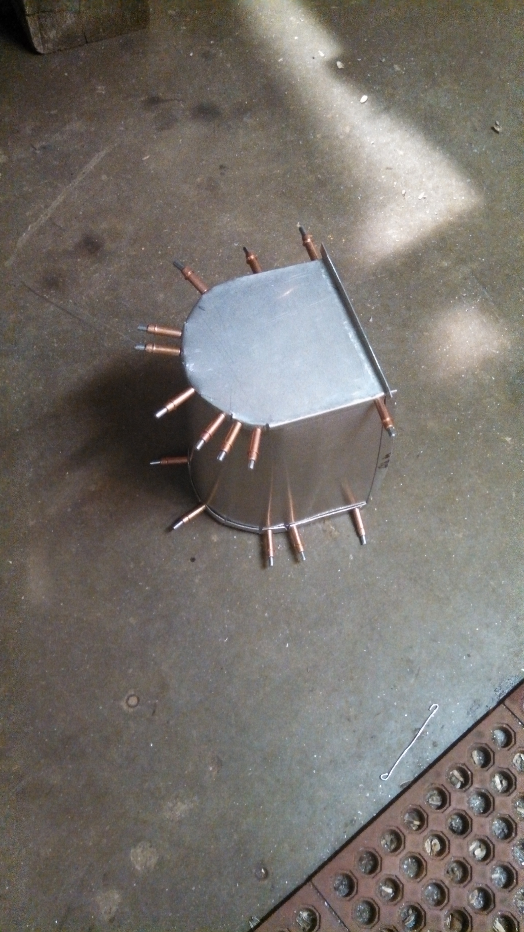

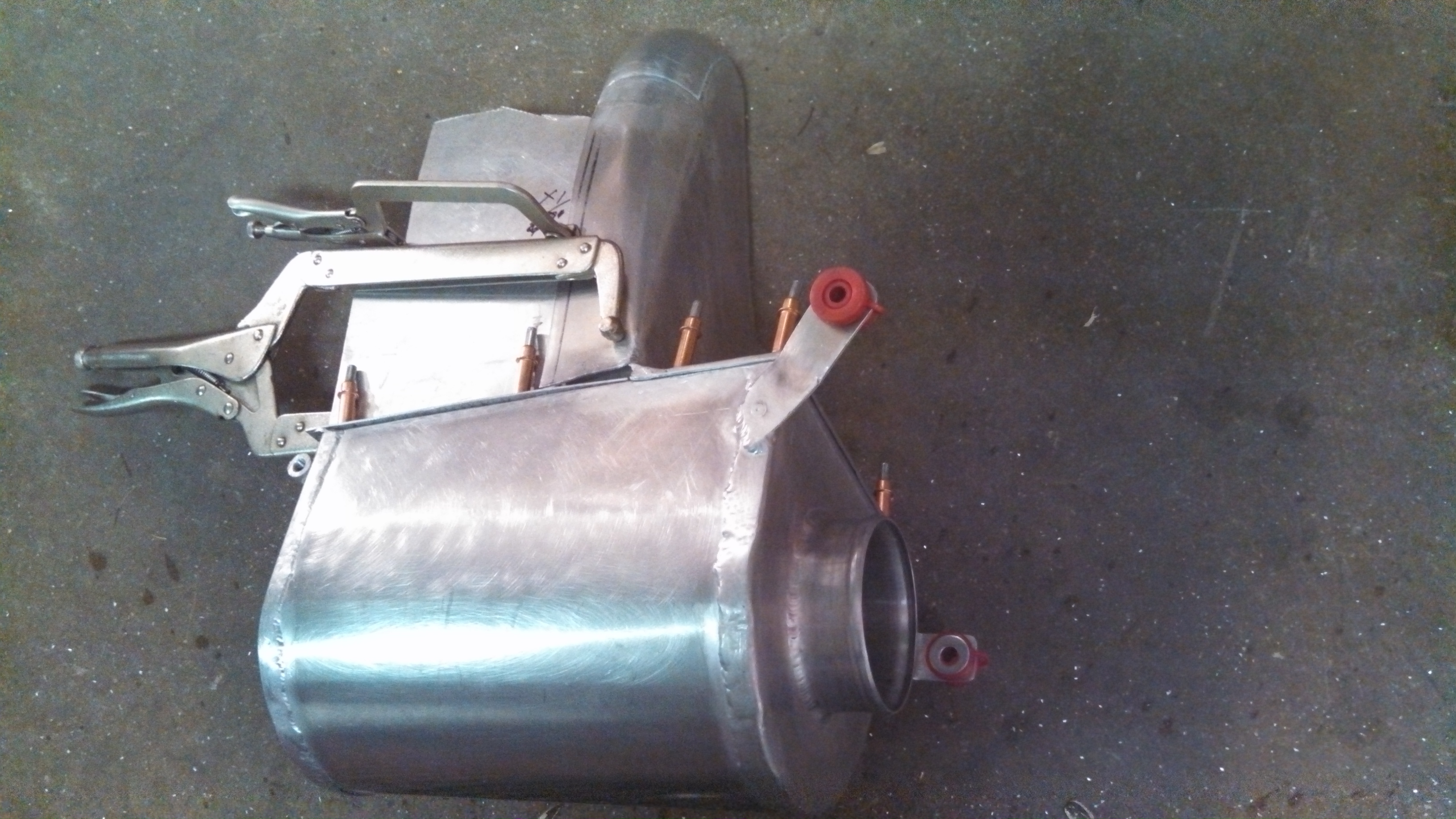

UPDATE!!!

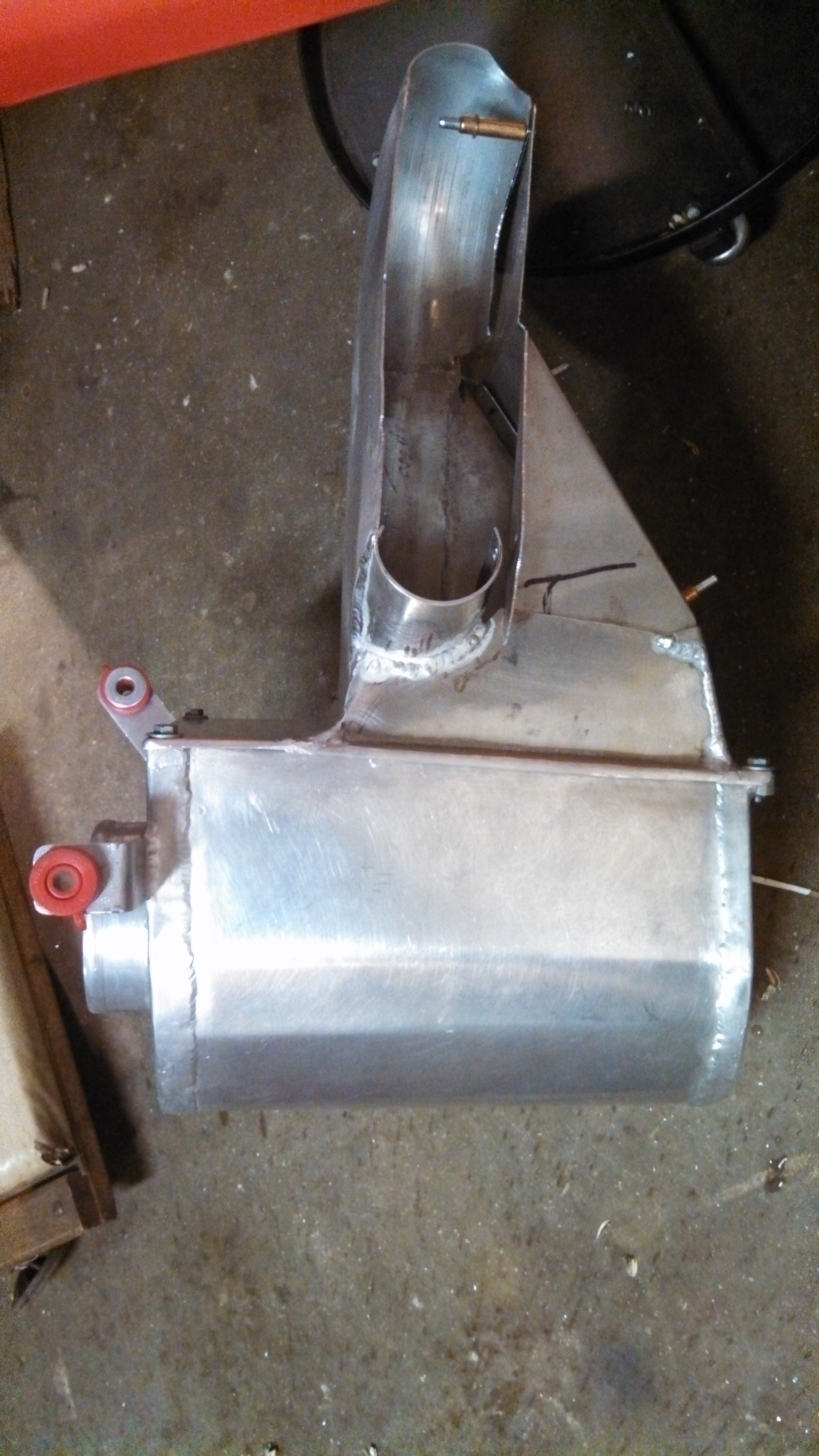

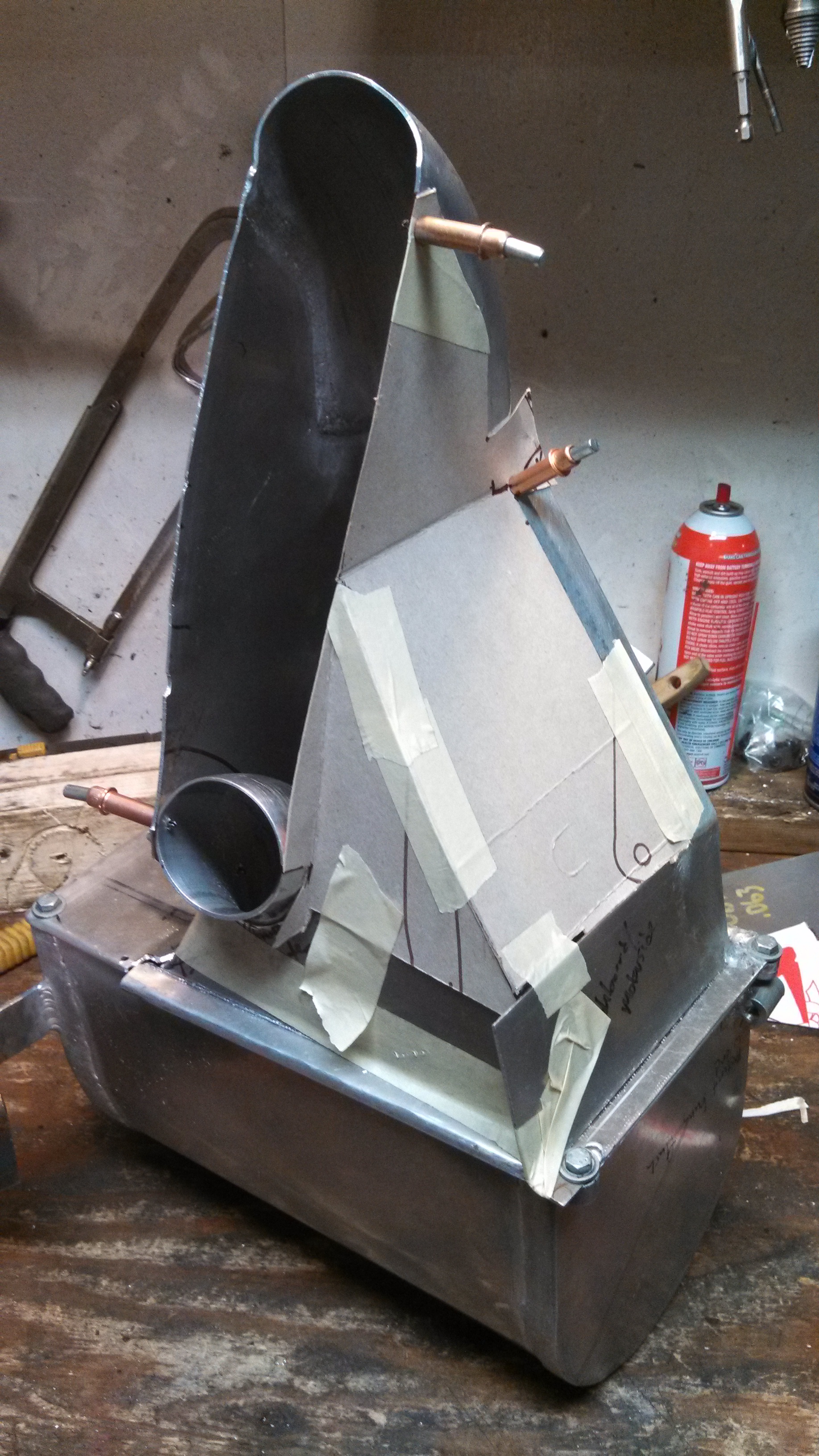

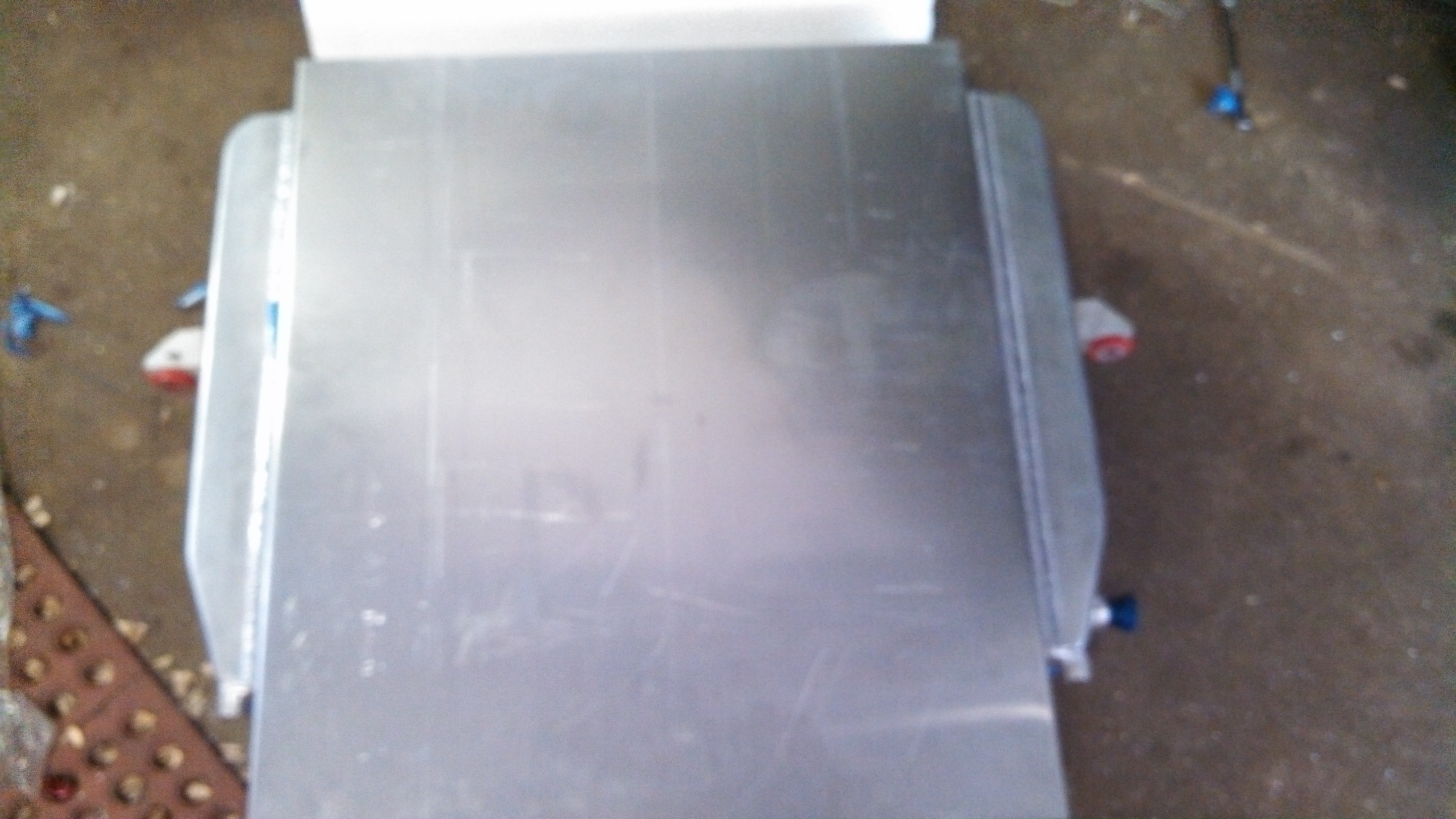

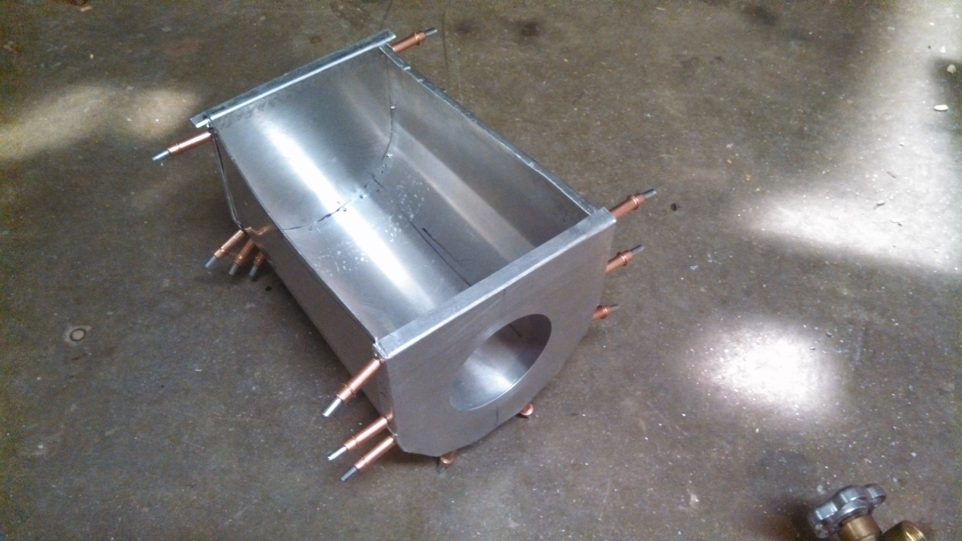

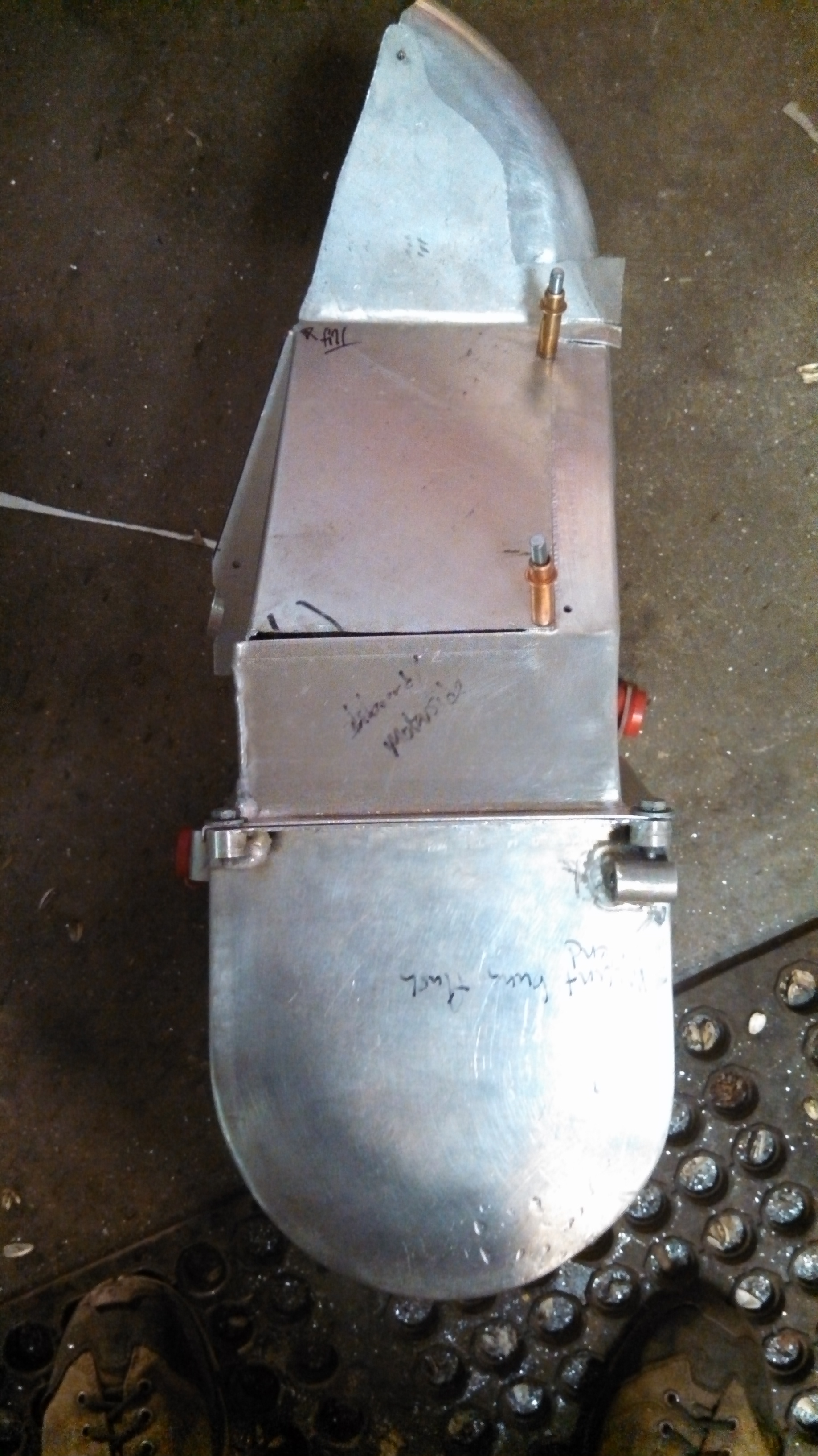

I wanted to make a nice and true, cold air intake for the turbo to draw from. I lost most of the early fabrication pics. The airbox is made from 0.065” 6061. I am running an AEM dryflow filter. It is the largest one they make, ~ 9” long x 6” dia. With a 4” inlet.
making airbox.jpg (1.57 MiB) Viewed 51891 times
making airbox2.jpg (1.55 MiB) Viewed 51891 times
mailbox airbox.jpg (1.65 MiB) Viewed 51891 times
mailbox airbox2.jpg (1.64 MiB) Viewed 51891 times
mailbox airbox3.jpg (1.51 MiB) Viewed 51891 times

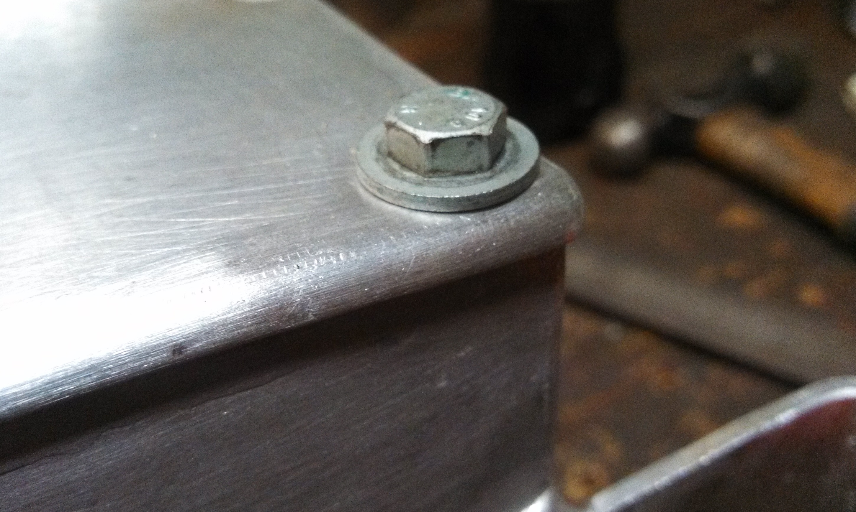

The top is mounted by 4, m6 bolts.
The airbox is completely mounted on jegs silicone snapper grommets.

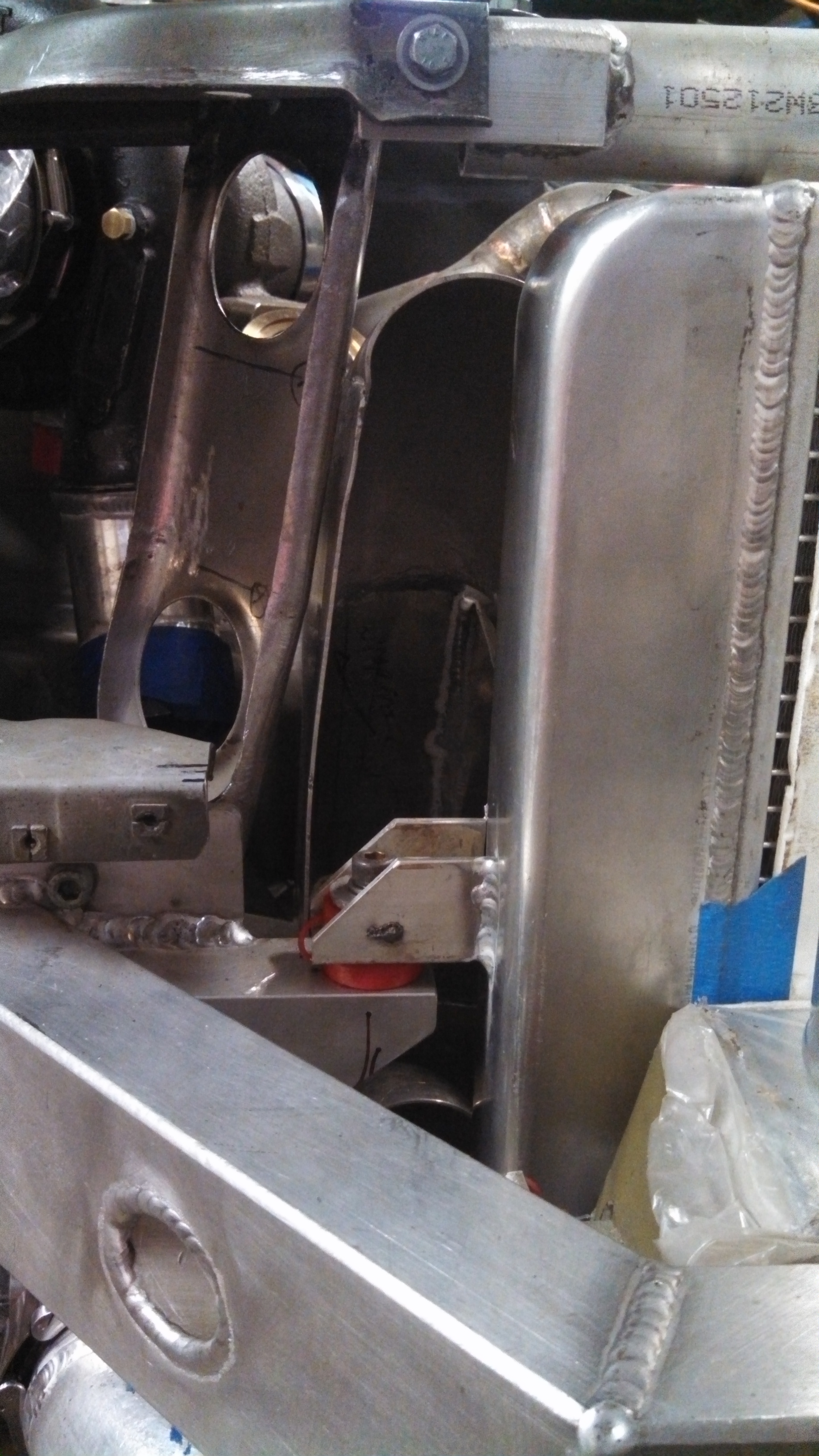

UPDATE!!!

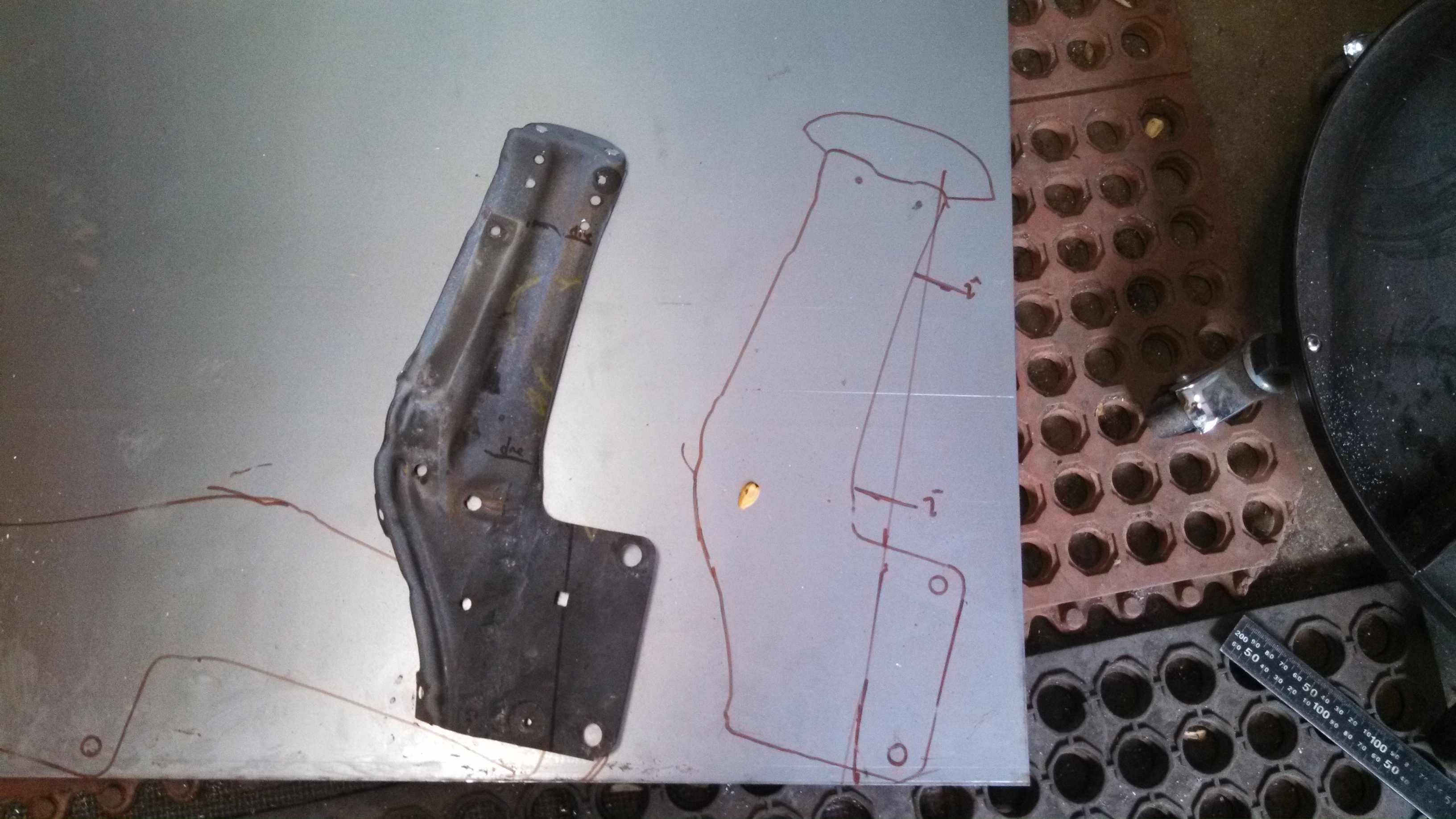

In order to fit the airbox feed right where I wanted, I needed to make a new passenger side headlight bucket. Its fabricated out of 16 gauge mild steel. With some dimple dies and a lot of hammer work. It fits the back of the headlight with ½ - ¾” clearance, I’ll probably have to pop the headlight out to swap the high beam bulb, but that’s not big deal.
headlight bucket template.jpg (1.92 MiB) Viewed 51891 times
headlight bucket underneath.jpg (1.31 MiB) Viewed 51891 times
headlight buket new passenger side.jpg (1.04 MiB) Viewed 51891 times
MORE!!!
I got the turbo drain line in place, I’m going to be changing it a bit to use a straight hose end for better clearance to the frame rail.
turbo drain line.jpg (1.33 MiB) Viewed 51891 times
turbo drain line 2.jpg (1.41 MiB) Viewed 51891 times

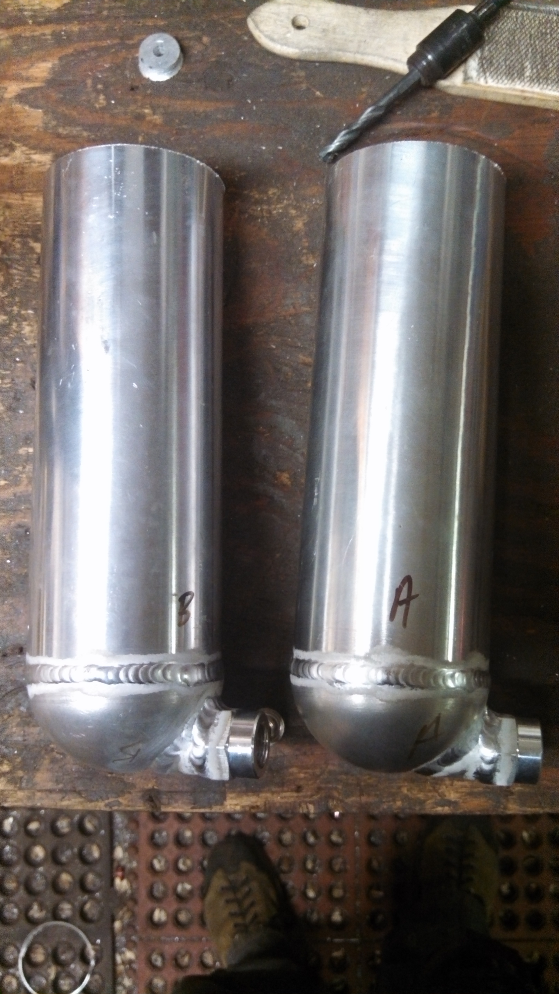

And the start of some breather cans
breather cans.jpg (1.4 MiB) Viewed 51891 times
And the breather cans 3/8” NPT drain bungs
breather can drain detail.jpg (1.31 MiB) Viewed 51891 times

UPDATE!!!
My material finally came in for my radiator shroud, so it was time to get braking.
The shroud is 0.090” 5000 series alu, its soooo much nicer bender the 4-5000 grades of alu vs the 6061
braking rad shroud.jpg (1.36 MiB) Viewed 51891 times
It took a bit of time but I got the sides to fit very close to the sides of the end tanks.
rad shroud tight around the edges.jpg (1.92 MiB) Viewed 51891 times

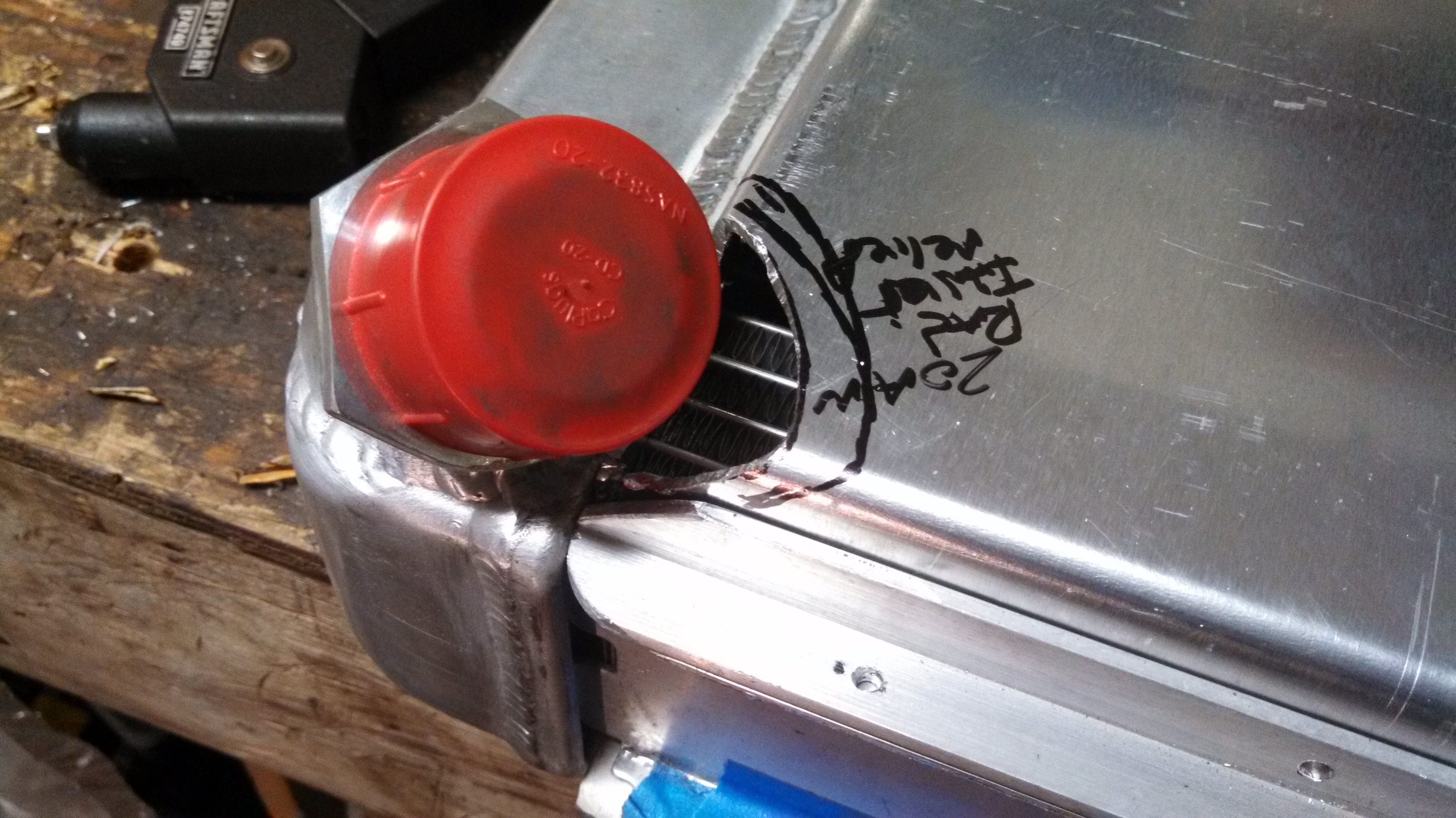

I also had to relieve the shroud for the upper rad hose. And got a small plate welded in there.
rad shroud relief for upper rad hose.jpg (1.99 MiB) Viewed 51891 times
The shroud still needs a bit of weld cleanup and some clip nuts for mounting but its nearly done.
And the 13” fan riveted on for temp fitment, now just waiting on the 8” fan. Then its time to cut out the fan holes and add some clip nuts.
rad shroud fan riveted on.jpg (1.38 MiB) Viewed 51891 times
rad shroud upper return.jpg (1.58 MiB) Viewed 51891 times

I also got back into the Wastegate outlet routing. The rear Wastegate will “loop” down and around to meet up with the front Wastegate outlet under the collector.
rear wastegate outlet.jpg (1.21 MiB) Viewed 51891 times
I got the merge for the outlets finished up and seam welded. This will dump back into the downpipe just above the front/pass CV and bellow the steering rods. I’ve run the steering and suspension through its range of motion and it’ll all clear just fine.
Just waiting on some 2.5” 304SS v-band flanges and a shorty 2.5” ID flex joint.
rear wastegate outlet and merge.jpg (1.49 MiB) Viewed 51891 times
I need to change the front Wastegate outlet just a bit, I wanted better turbo drain line clearance.
And here you can see where the front outlet will meet up with the merge. The front Wastegate will have a second flex bellow and compact Tial clamp right before the merger.
wastegate merger looking forward.jpg (1.07 MiB) Viewed 51891 times
And this pile of stainless will be a completed downpipe later this week! Woohoo
will be a finished DP soon.jpg (1.35 MiB) Viewed 51891 times
