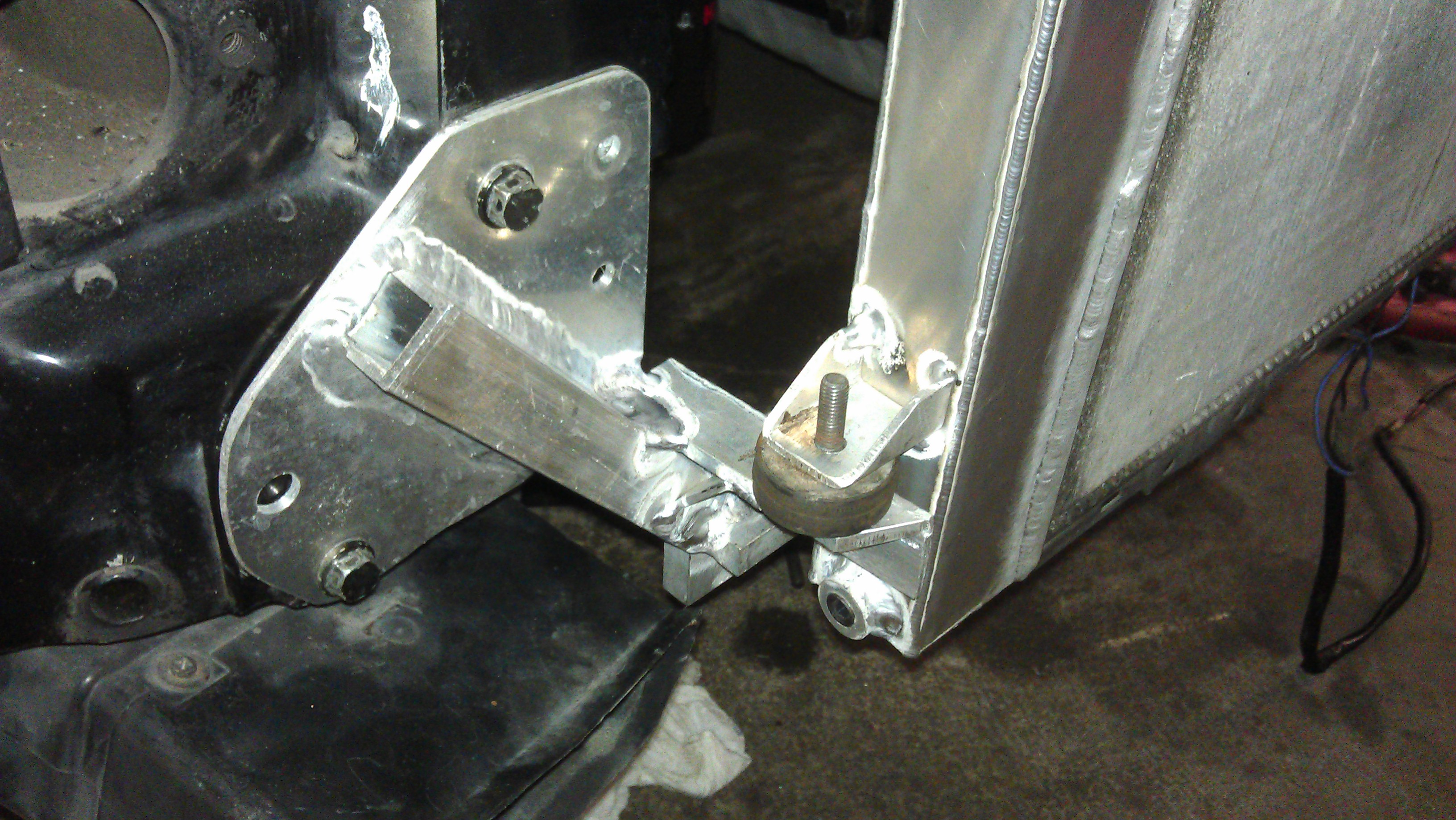

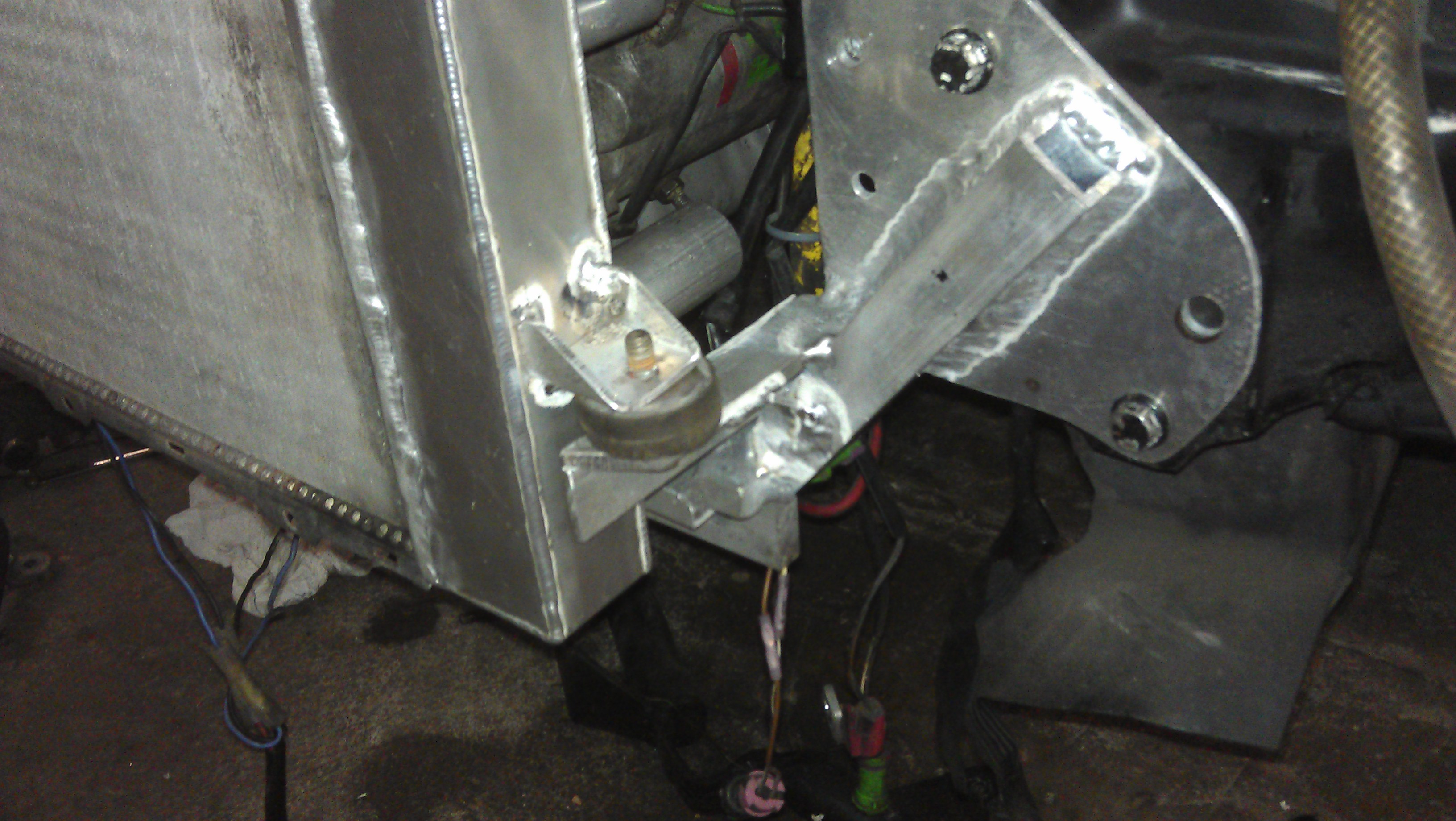

Here it is hangin like it should. There will be some other variation of hanger/ tab for mounting, but this is right where it should be on the xyz.

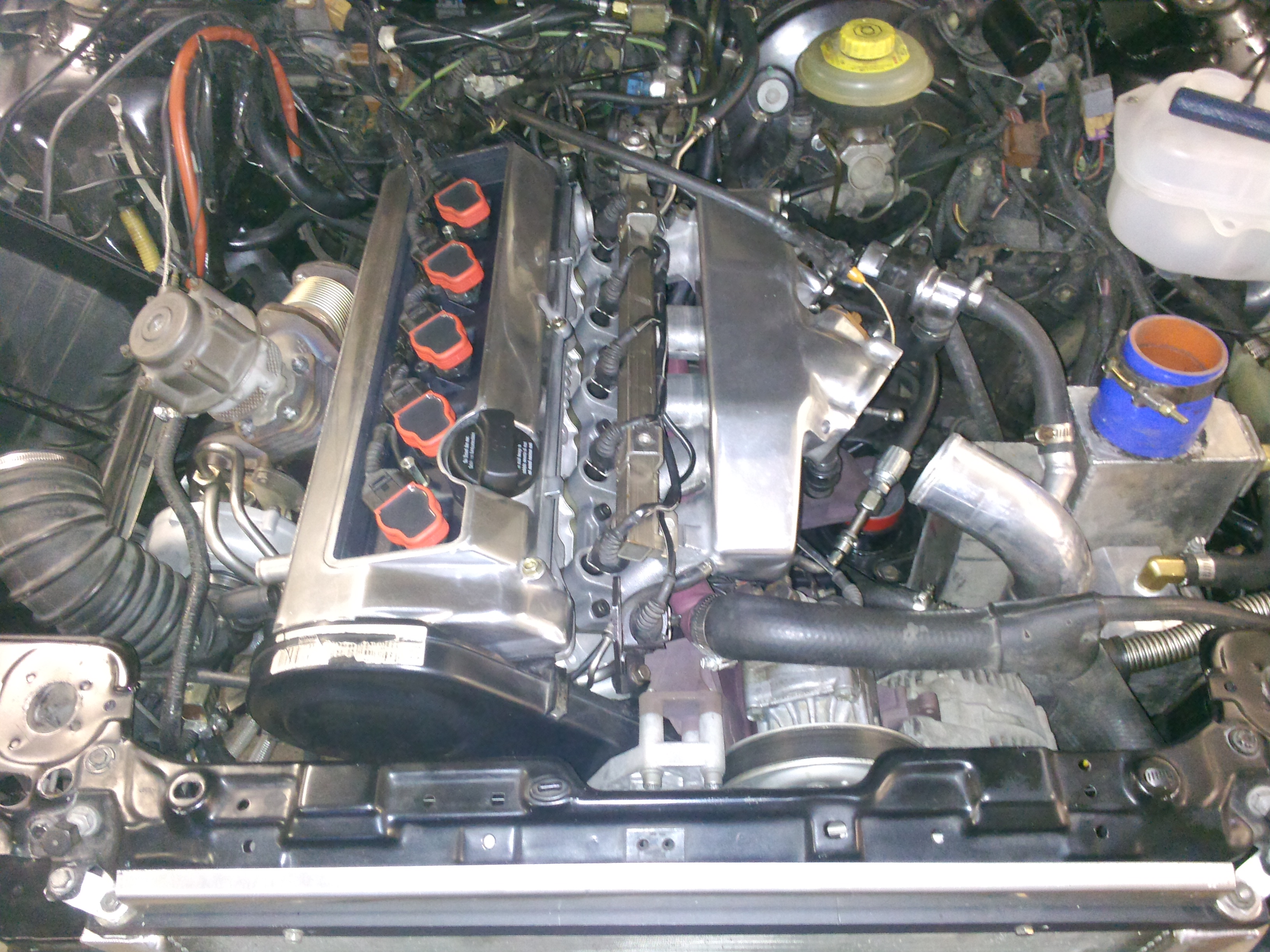

Lots of progress the last couple days. I have the bulk of things needing to be done pretty much ready as it will ever be. Mind you, I have plans that have to be postponed till after the gtg in a week an a half. Its mostly just final touches on a few things, and I will get to them as long as my car makes it there and back without a major incident. They may be finished in the time up to, or put off as I would like to fully break in the engine before I take the trip down.
I may be firing the engine in the next day or two, then time to take a few drives to put on the miles for break in. All this while I still have to work every night till 3am at my real job. Thank dog its only 4 nights a week. I will need to watch the radiator very closely for leakage. It passed a pressure test with about 15ish lbs of compressed air and soapy water sprayed on the original tank seals.
And it looks like I will be able to fully test out Jareds mounts across the board. Engine, trans, diff, subframe. I hope its quiet compared to the previous 03stuff.
More pics to come.

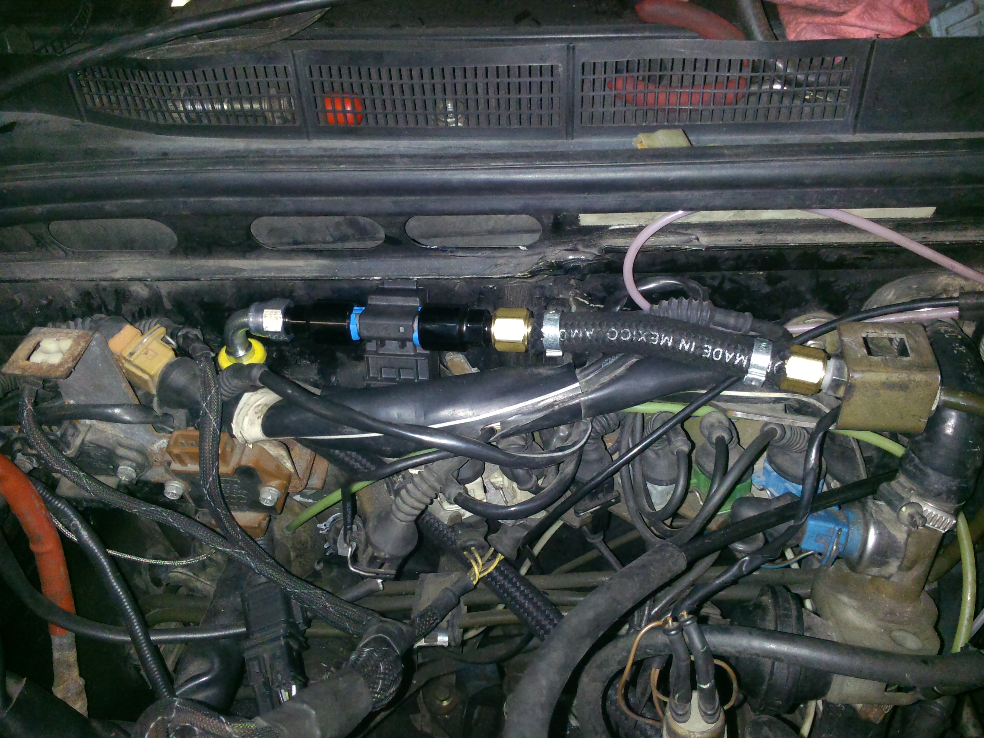

Its now a few hours away from being fired up now. The cooling system is now complete. The air to water is done...for now. I had plans to change to a bigger innercooler, and put the coolant reservoir in the trunk area, but ran out of time. I have installed a flex fuel sensor so I can utilize the versatility of the vems and be able to run 91 or E85 without making mind numbing calculations. The engine is almost complete and wont take much time to finish.
