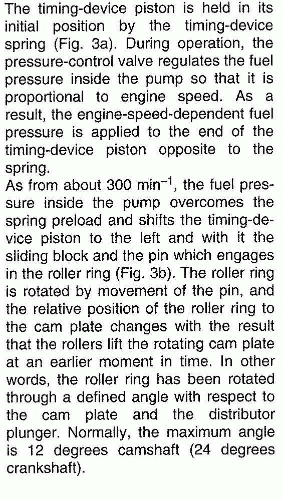

I think, the H-option is one of the best solutions if you use an b4quattro tank.
I think, a pressure regulator wouldn't be a good idea, because you shouldn't have excess pressure on your diesel pump.
If you have excess pressure on your diesel pump, the injection timing wouldn't be correct (because the injection-timing of the diesel-pump is pressure-controlled)
see also:
http://www.dieselbookmarks.com/bombers/VEPump.pdf

Shouldn't need to worry about that, the timing is controlled by internal pump pressure- that is fuel pressure after the high-pressure internal vane pump. Pressure on the front side of the high pressure pump will not hurt anything other than increasing the chance of leaks. Only in situations where fuel delivery has been highly modified will internal pump pressure begin to decline, and in that instance, a lot of pressure and volume on the front side of the pump will help bring timing and therefore internal pressure back up.
