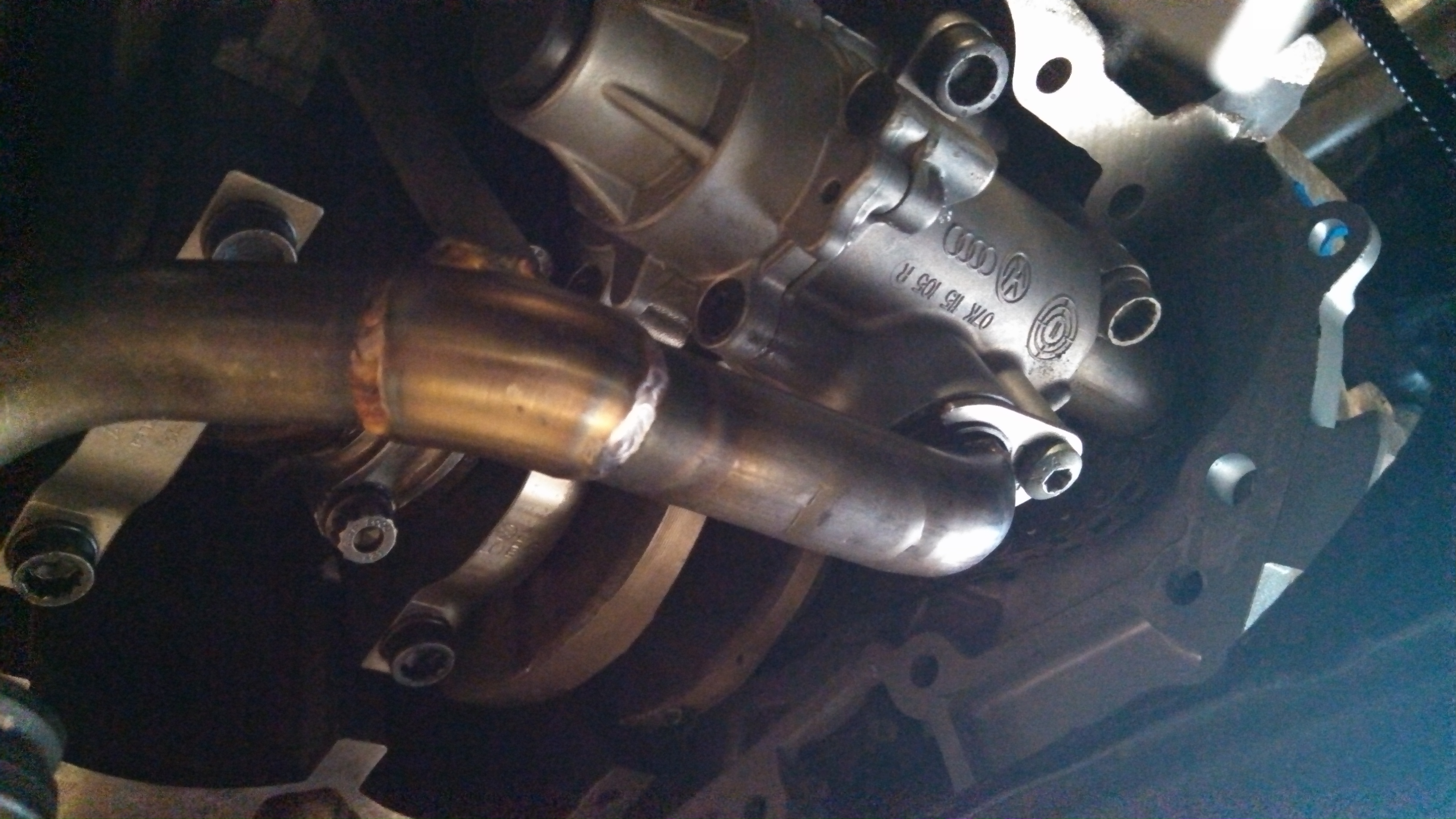

SO 8 days before Carlisle Hank managaed to squeeze in finishing, and shipping my pickup tube between everything else he has for workload.
center pipe 1.jpg (1.34 MiB) Viewed 26085 times

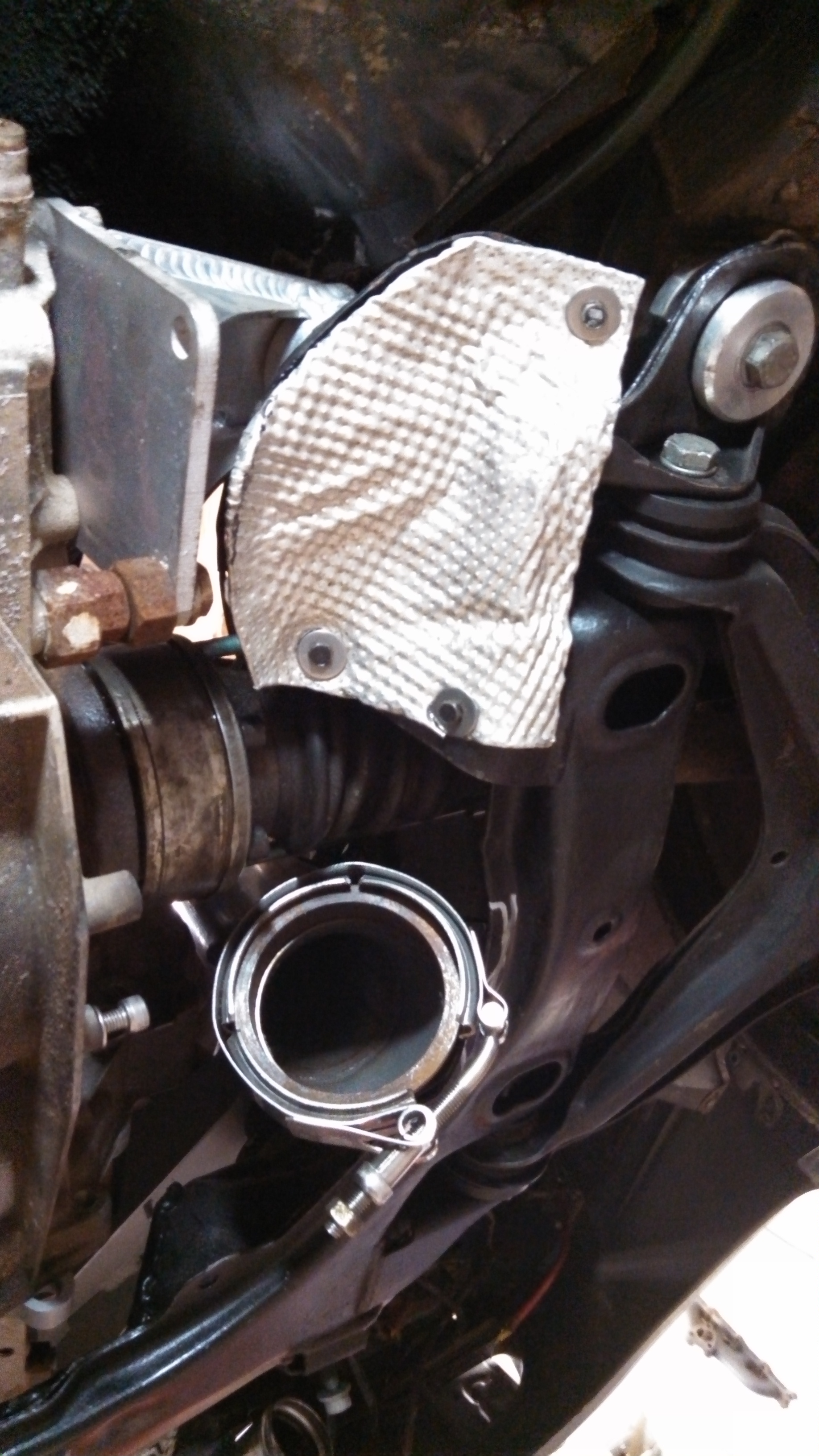

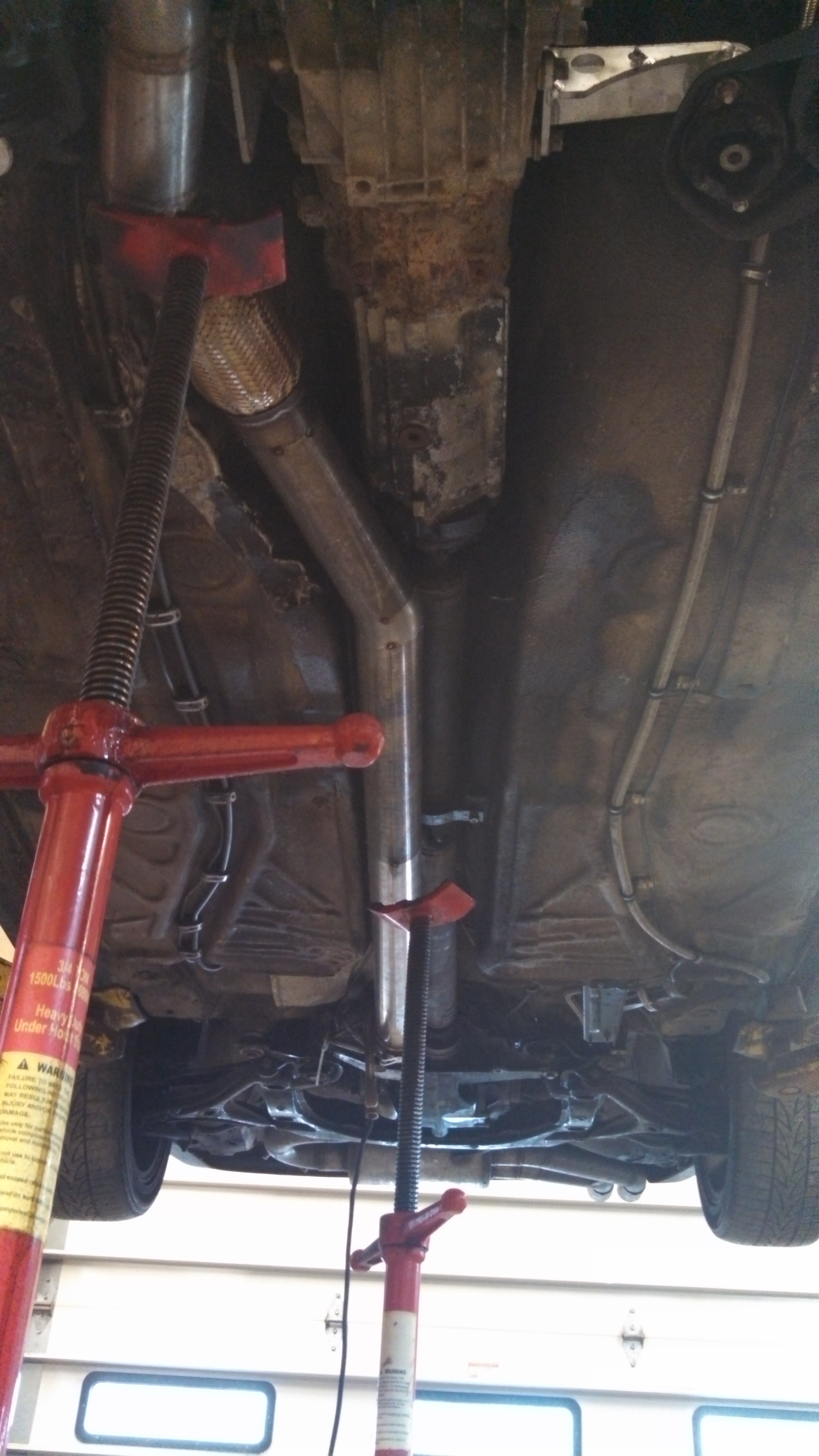

There was a 3~ foot section of exhaust we hadn't finished yet, here is that. The car is 3" turbo back with the smallest unchambered 3" in and dual 2 out. Dont recall the part number.
center pipe 4.jpg (1.24 MiB) Viewed 26085 times
heat shield.jpg (1.26 MiB) Viewed 26085 times

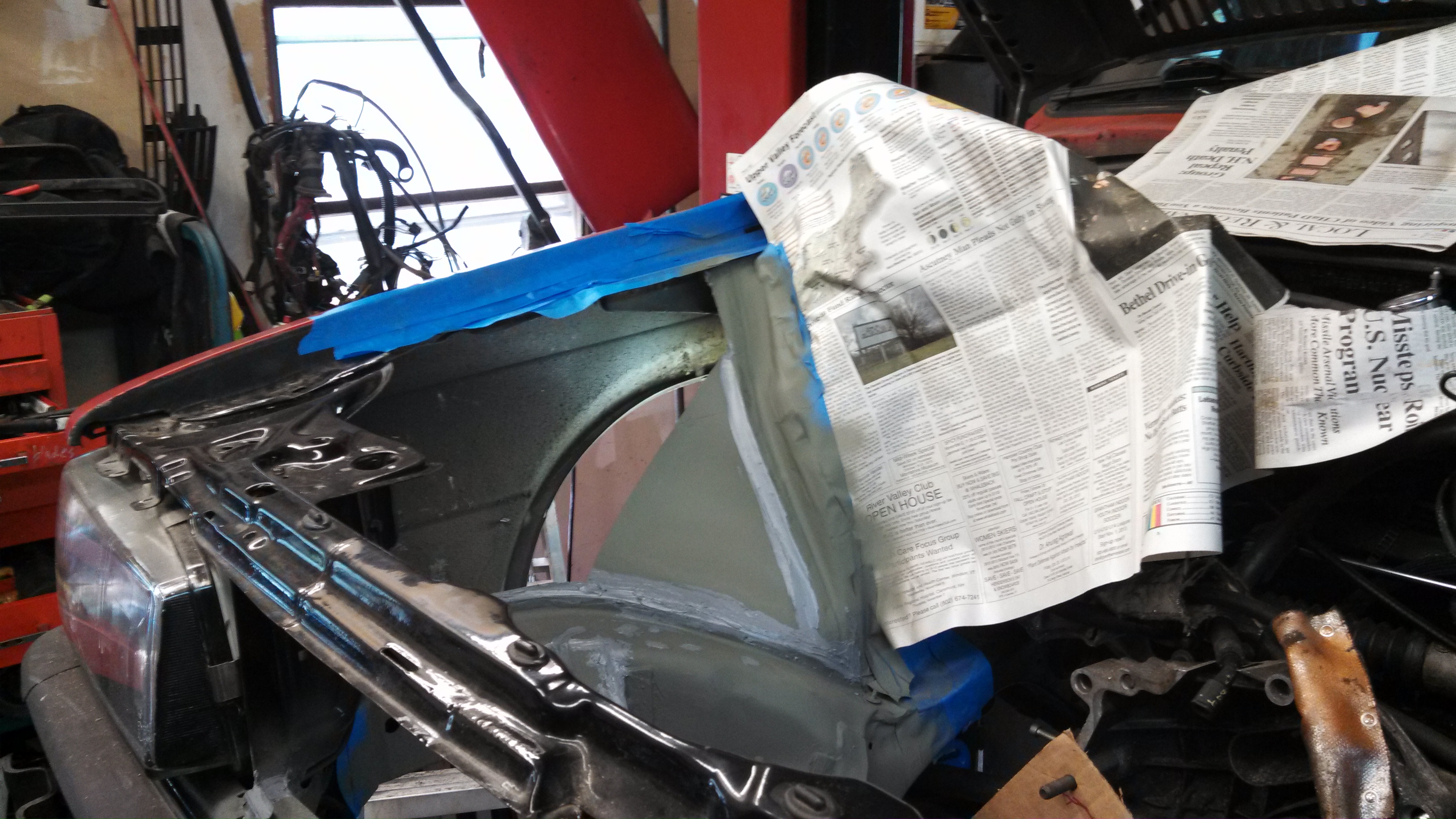

had to patch back in a bit of sheet metal on the inner fender
fender patch.jpg (1.7 MiB) Viewed 26085 times

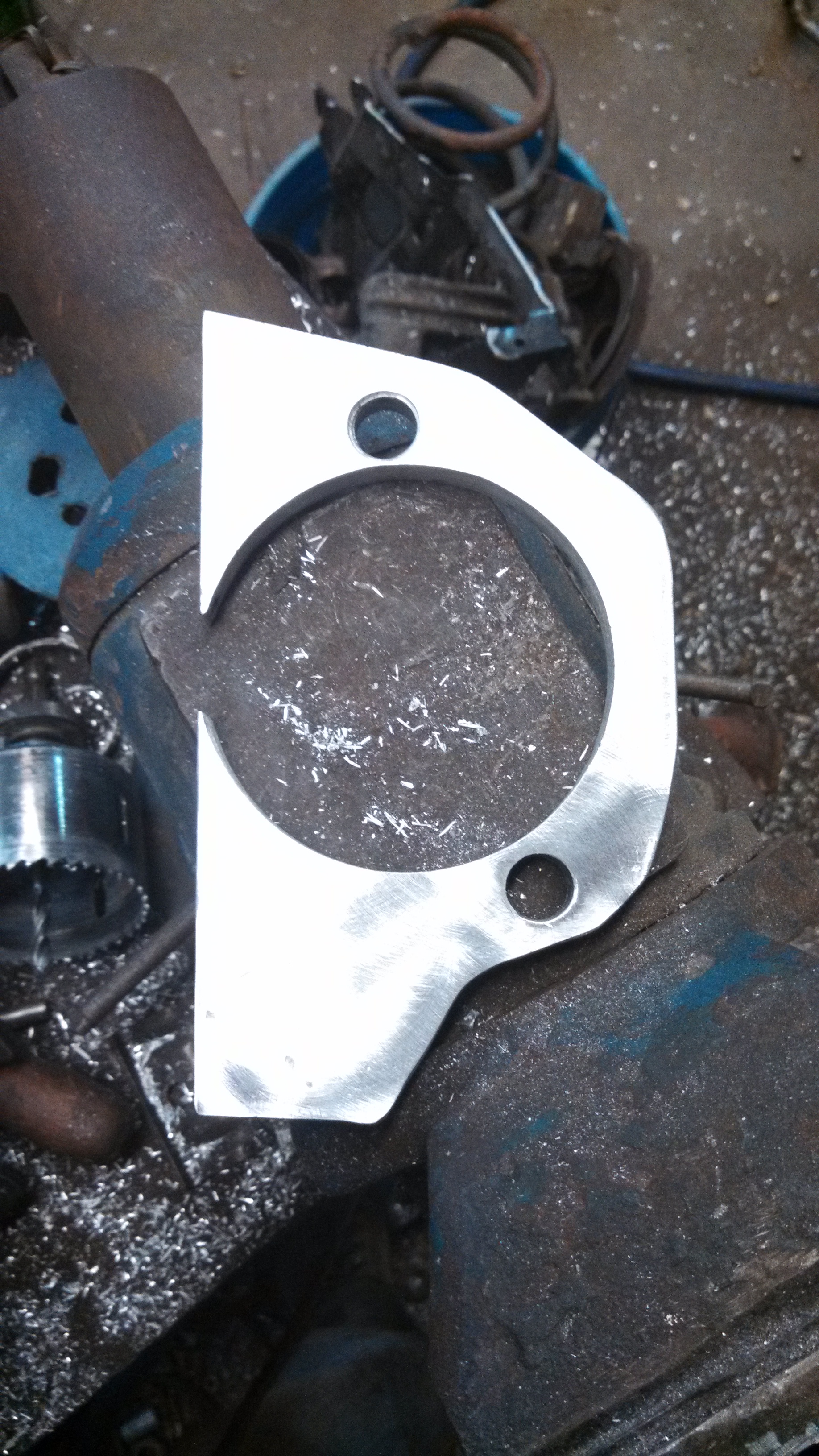

and a raw start of the starter adapter. I dont want to give dimension of anything til Im happy with it for a while. We also have serious time into that stupid hunk of aluminum and I know hank did too! It def had a bunch of cranking tim between at Carlisle, at my place, and Marcs.
starter adapter raw.jpg (1.99 MiB) Viewed 26085 times
