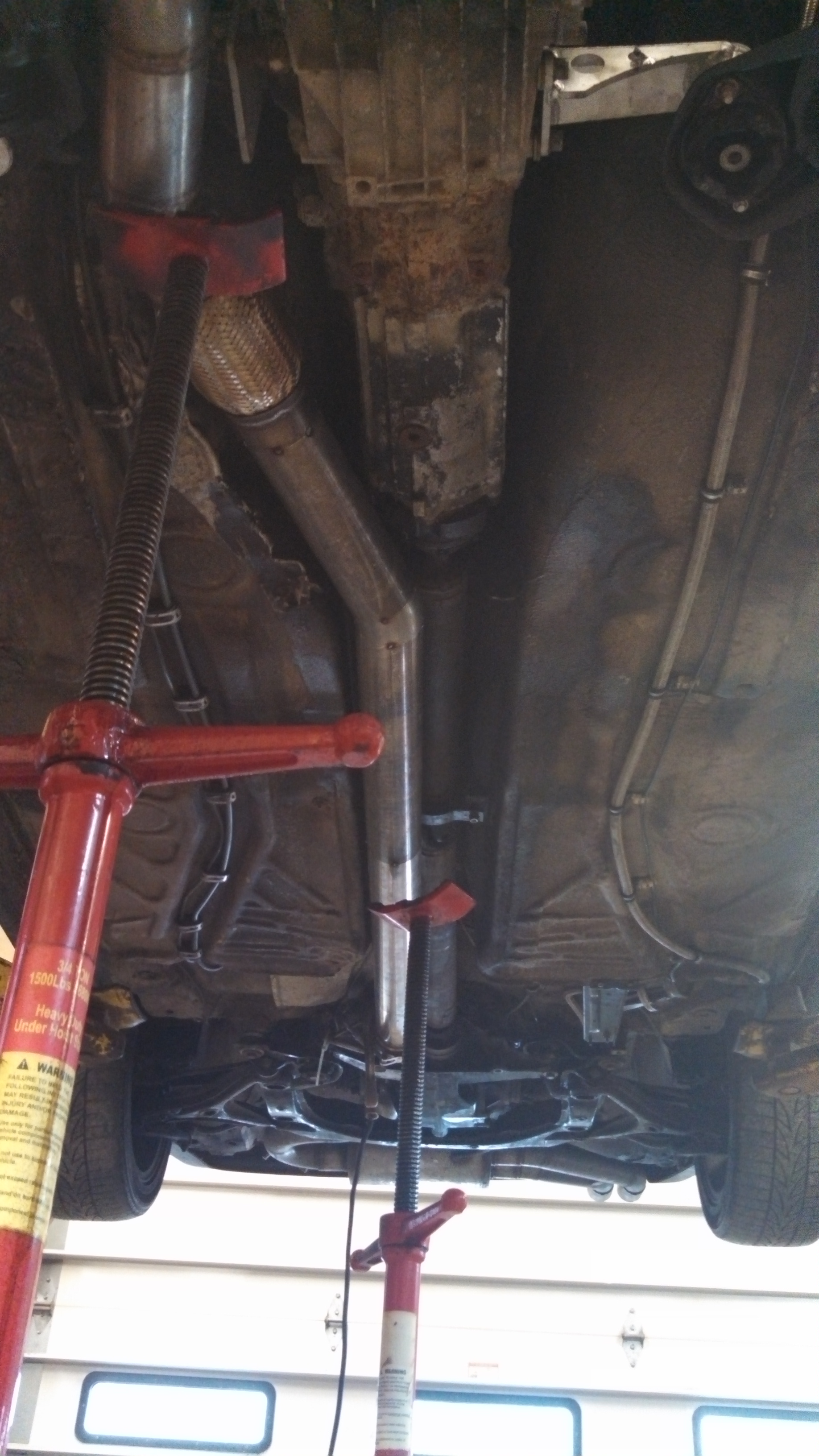

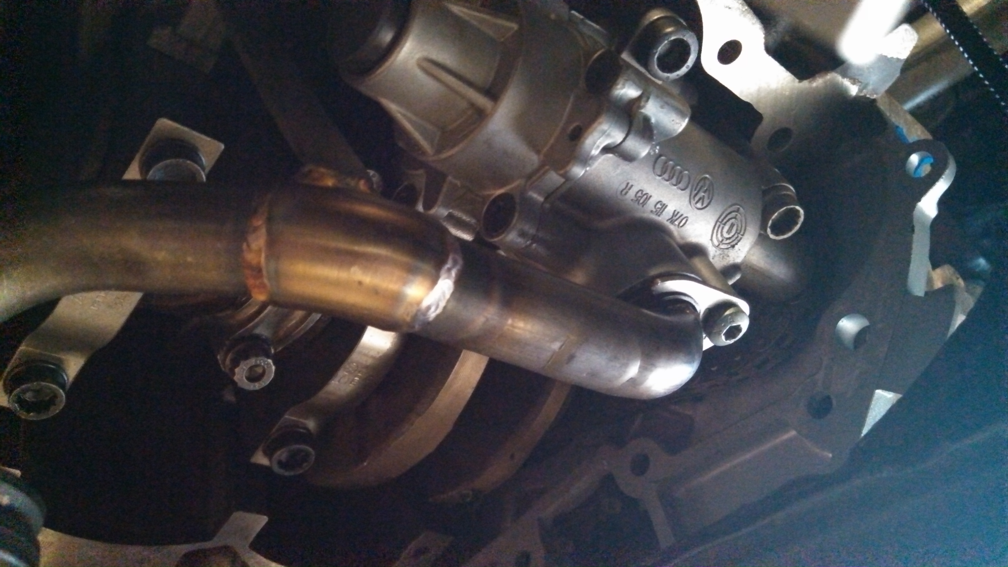

SO 8 days before Carlisle Hank managaed to squeeze in finishing, and shipping my pickup tube between everything else he has for workload. SO i could seal the pan on. That was the kick in the pants i needed to finish this thing so Tim(my2000apb) and I started a marthon of sorts. Between RedBull, Pizza, and sleep depravation we did pretty well with the time we had. We treated it slightly differently in effort to make the bay at least presentable for a car show. Its the most important area to me anyway.
So we had a slightly bigger list than i anticipated when we started and of course as you go....The list gets longer
There was a 3~ foot section of exhaust we hadn't finished yet, here is that. The car is 3" turbo back with the smallest unchambered 3" in and dual 2 out. Dont recall the part number.

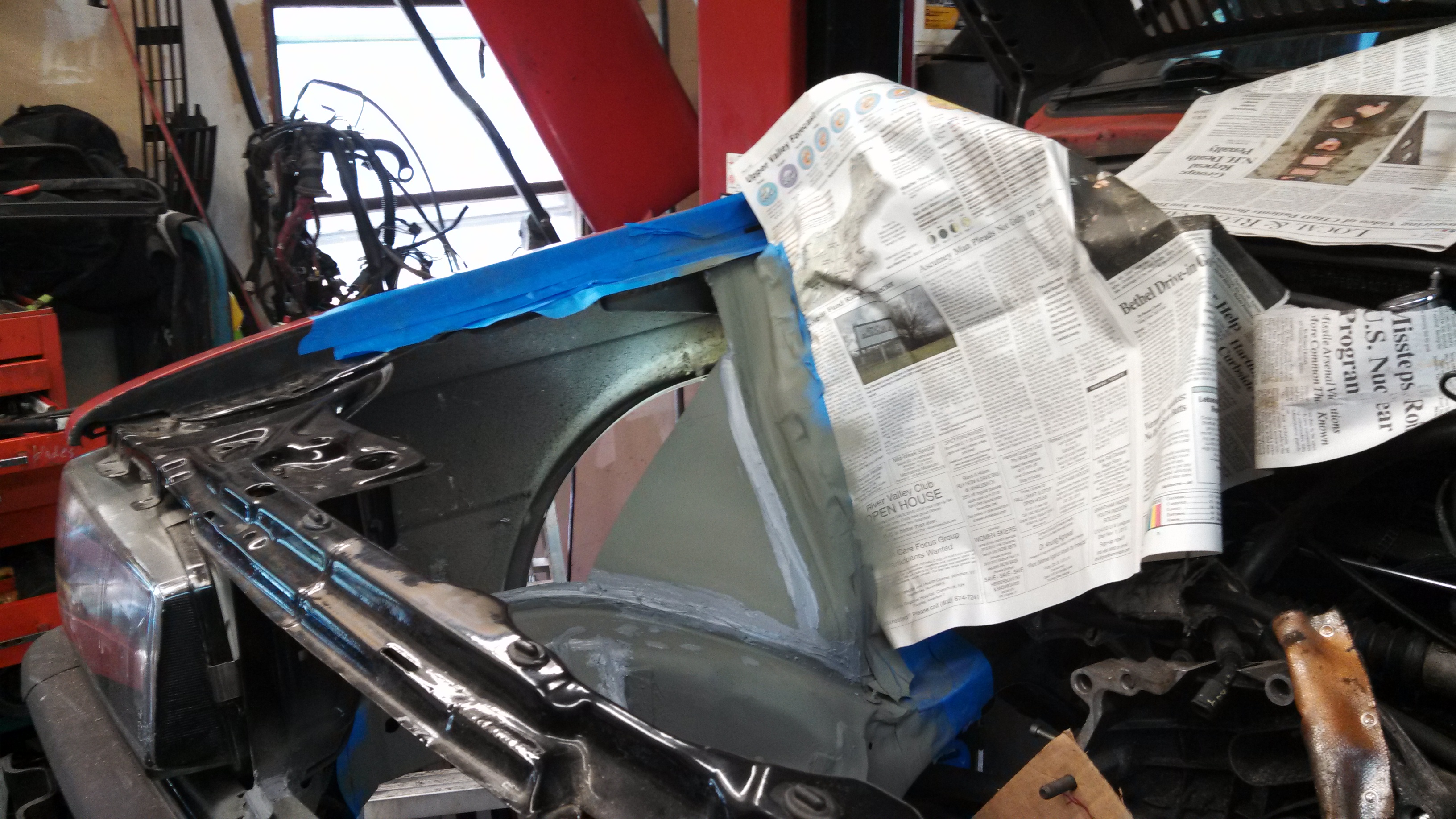

had to patch back in a bit of sheet metal on the inner fender

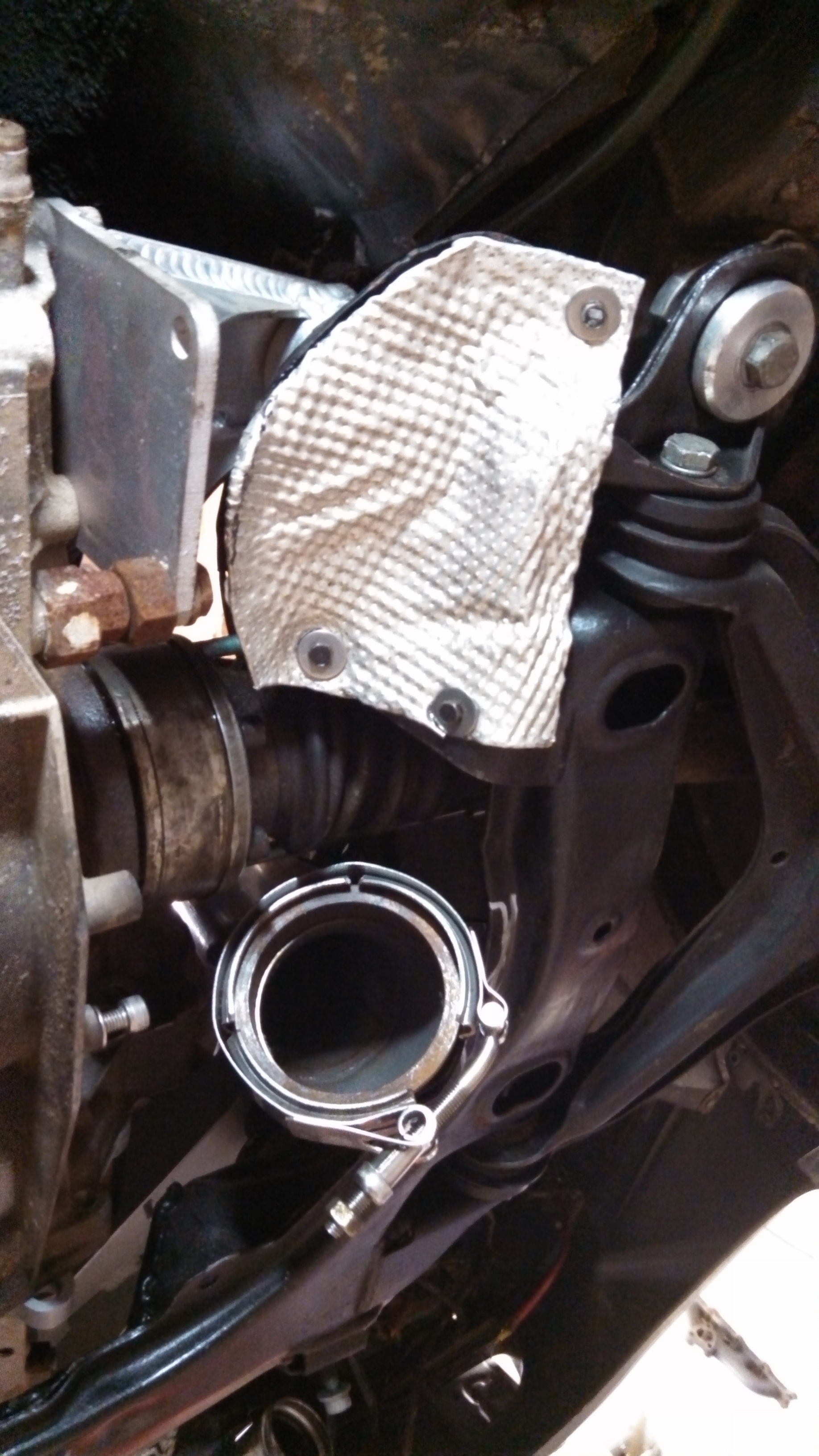

and a raw start of the starter adapter. I dont want to give dimension of anything til Im happy with it for a while. We also have serious time into that stupid hunk of aluminum and I know hank did too! It def had a bunch of cranking tim between at Carlisle, at my place, and Marcs.
