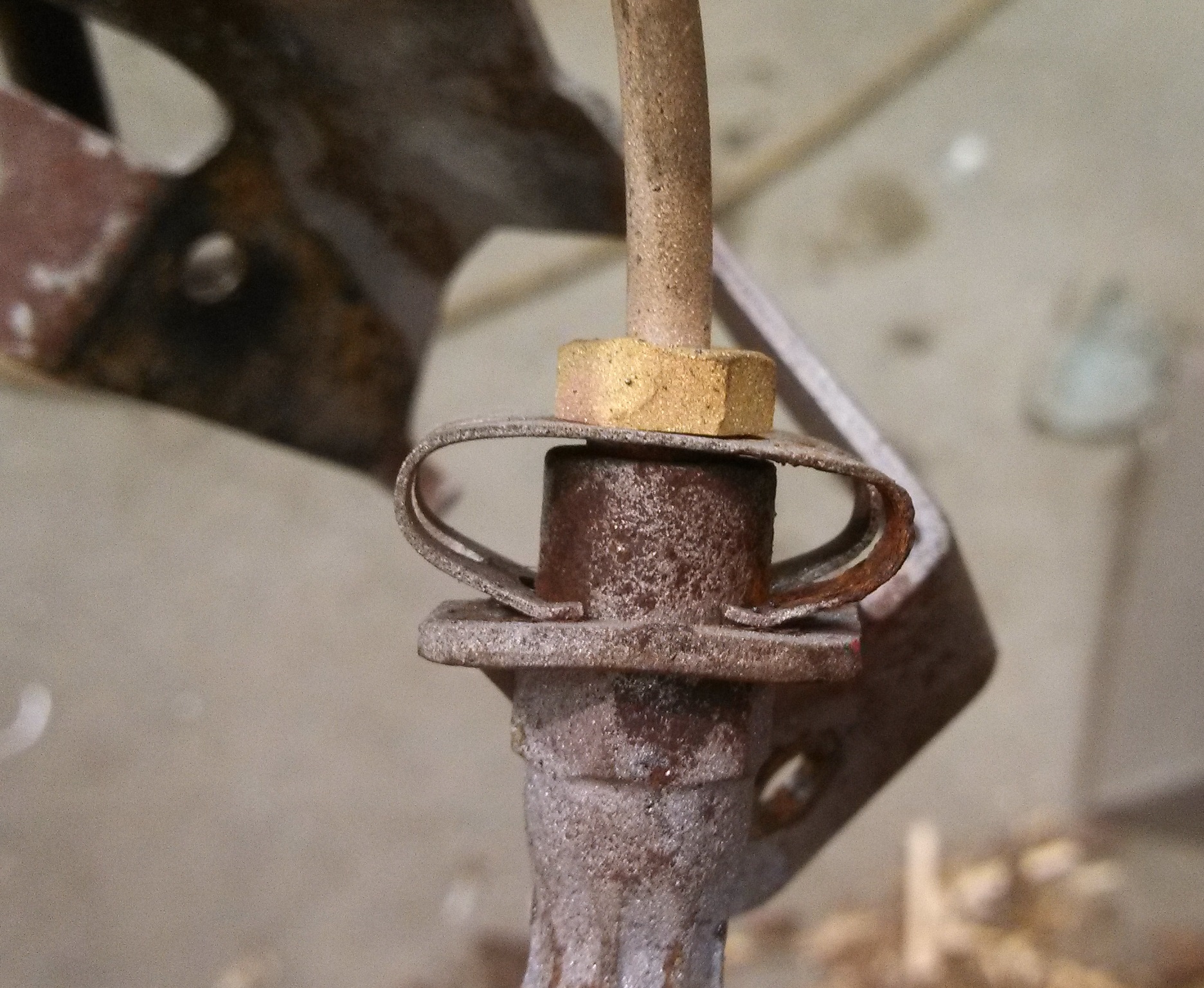

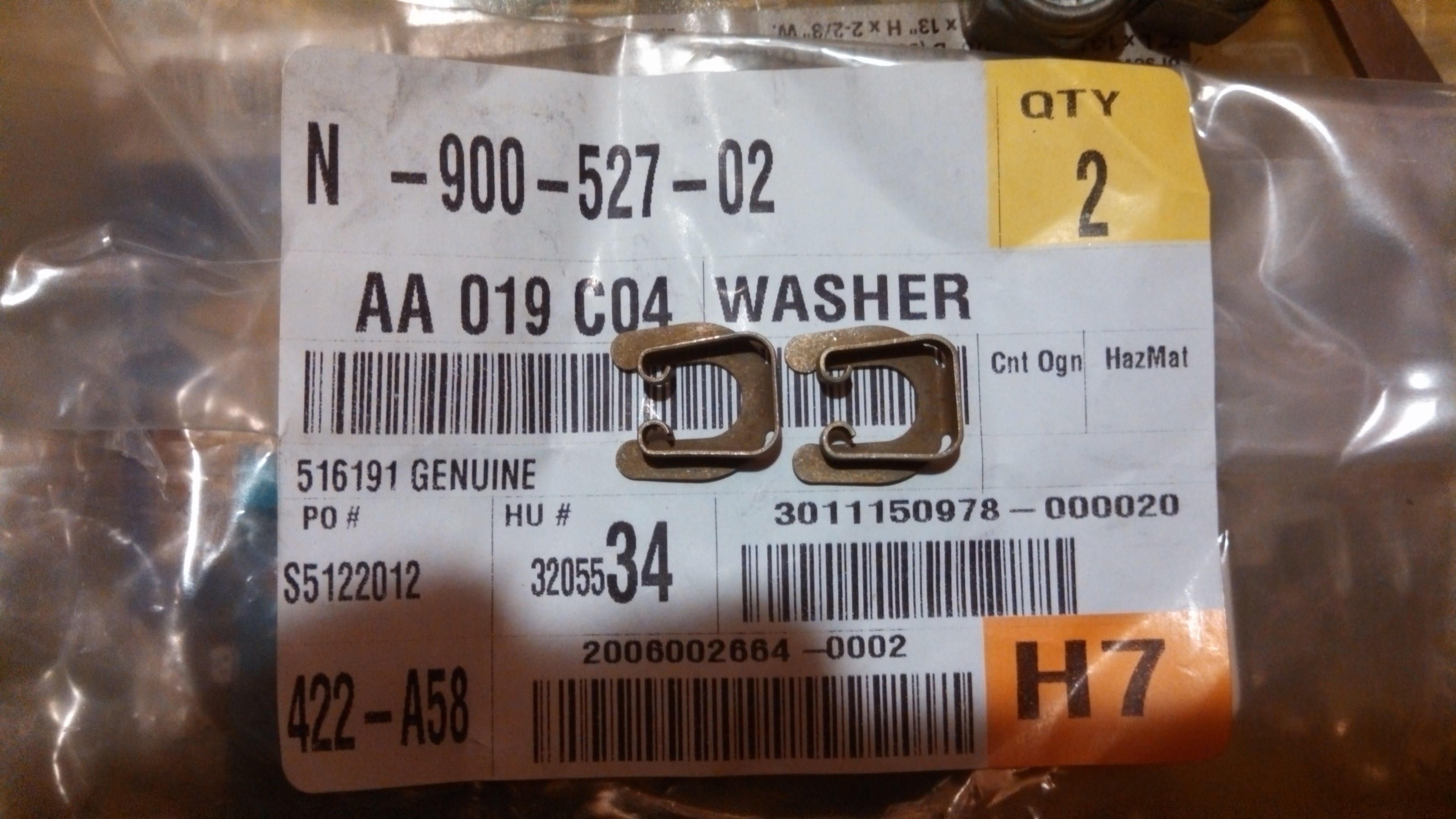

more
ebrake cable clips.jpg (977.54 KiB) Viewed 29104 times

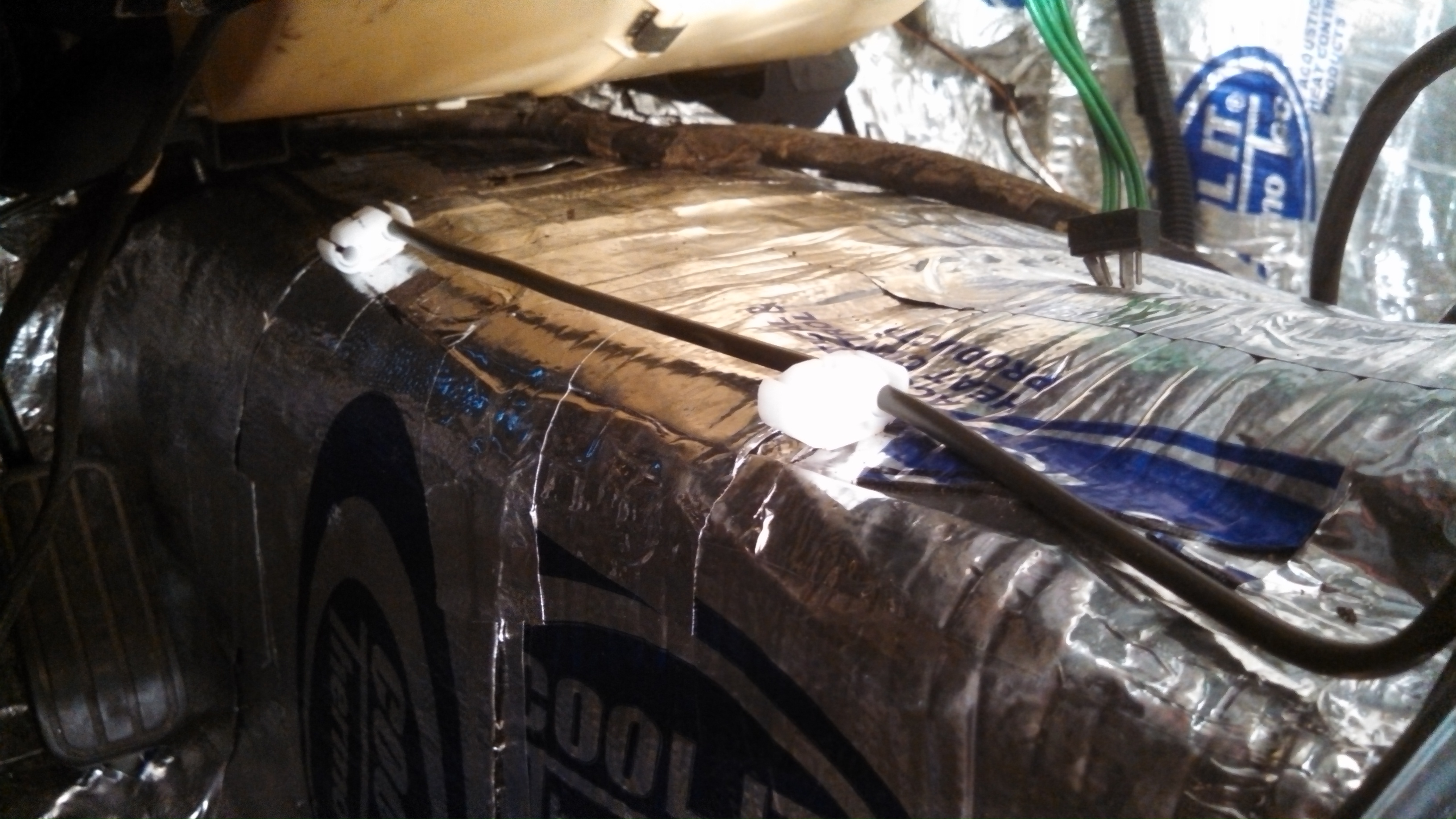

brake line grommets.jpg (1.54 MiB) Viewed 29104 times
brake line correct.jpg (938.36 KiB) Viewed 29104 times

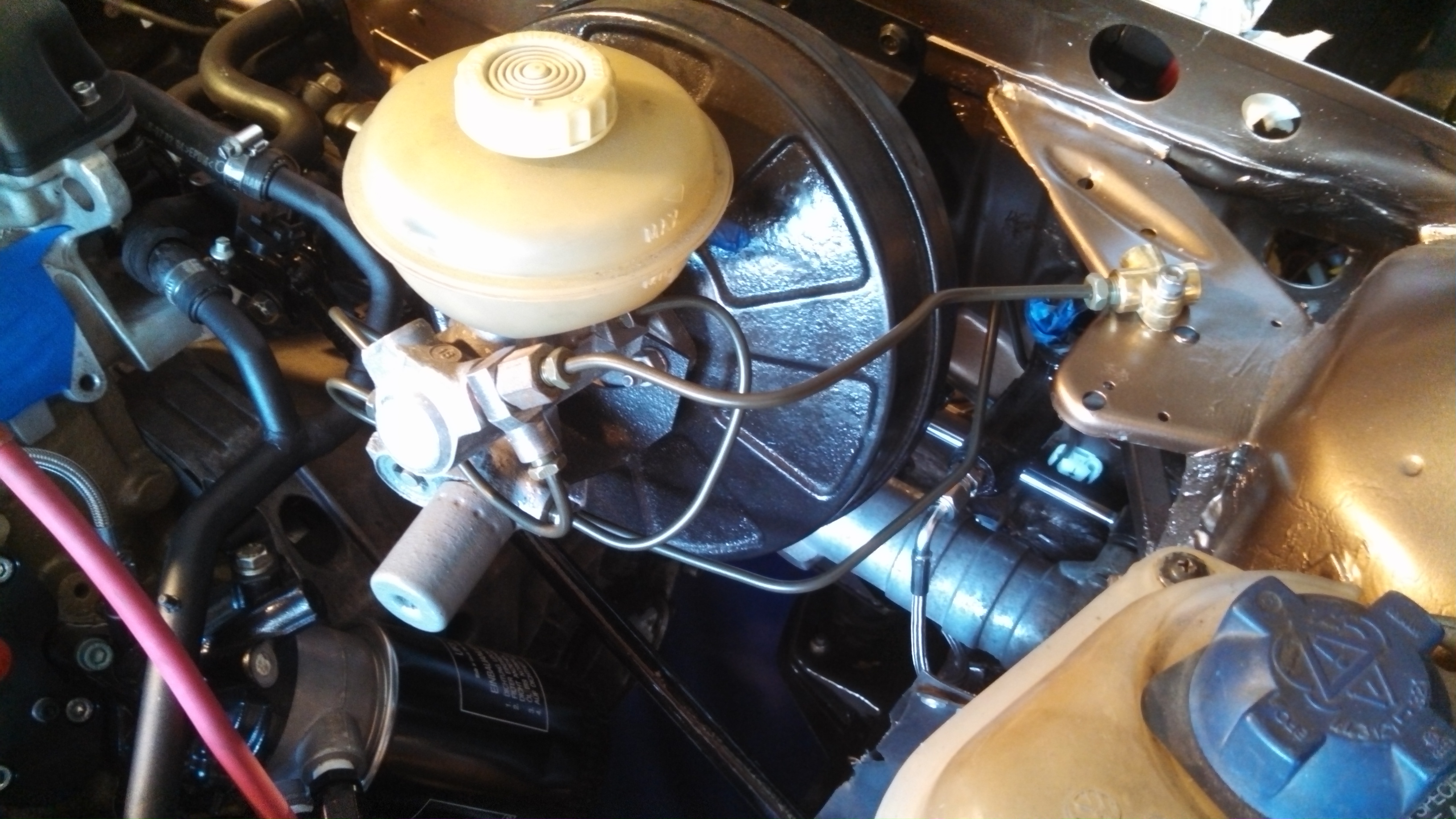

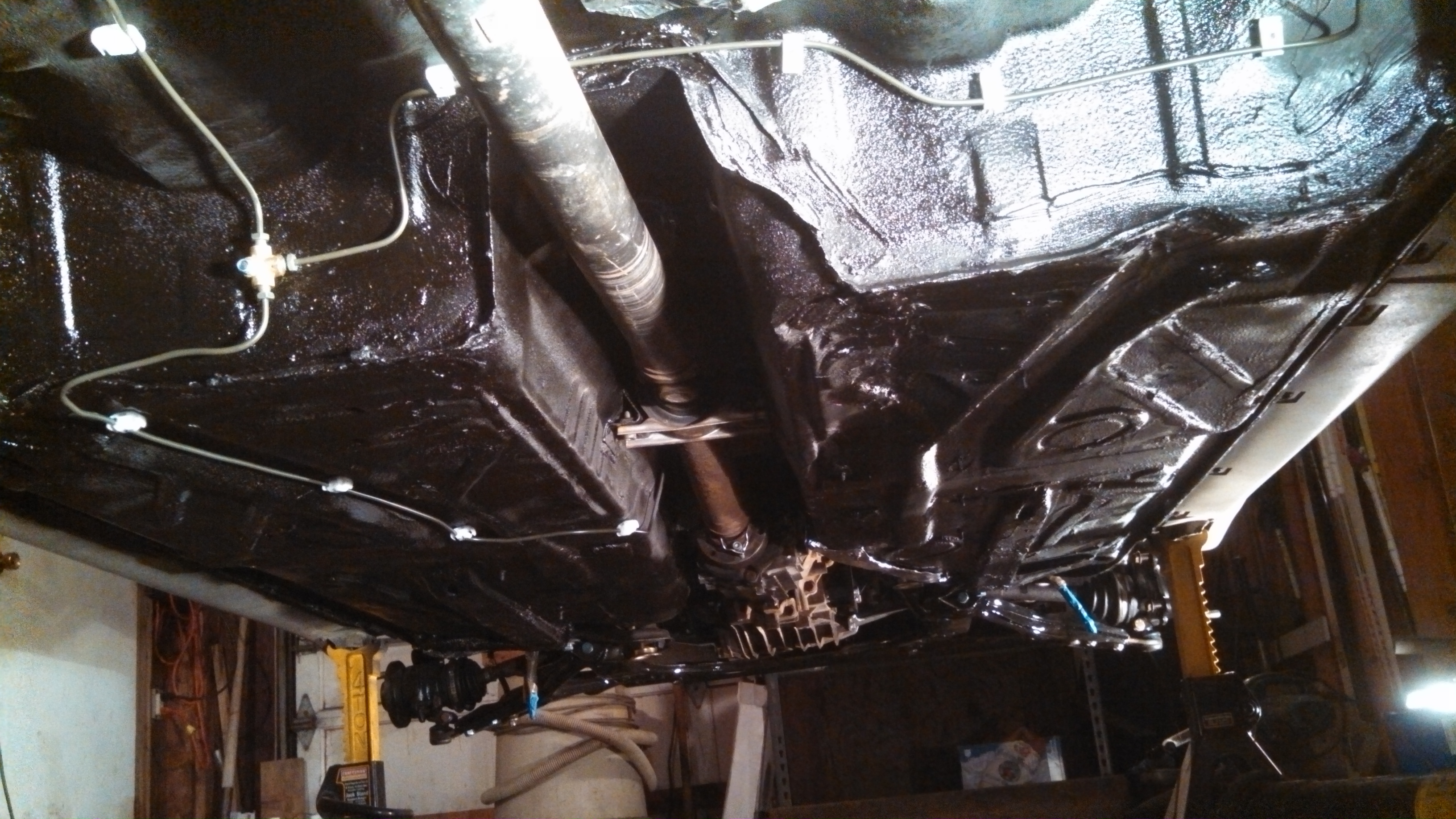

Re: Tim's '86 BLAZE 4kq uploading pics +update
MORE!

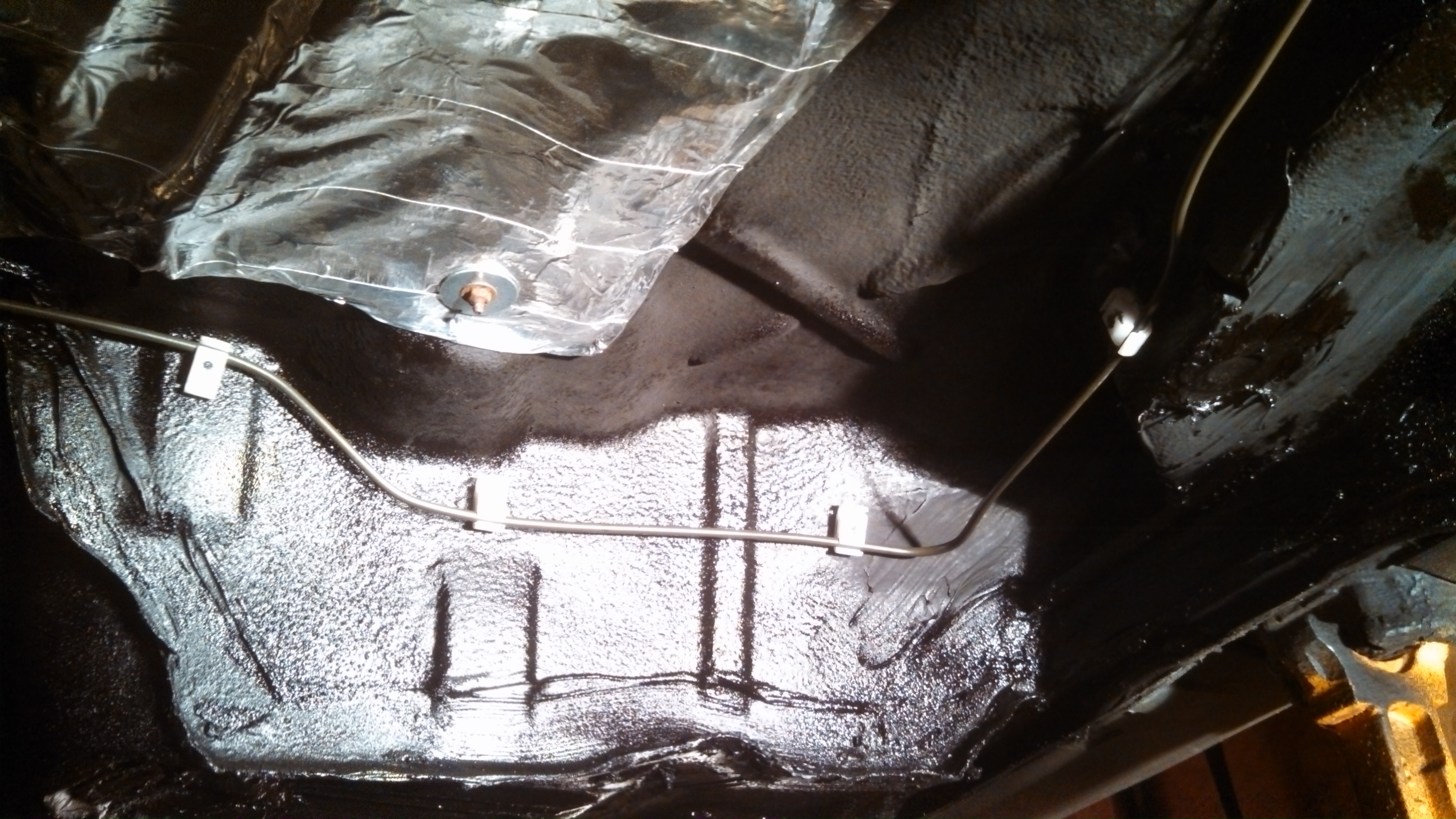

Nothing too interesting here other than im running a ’91 200 20vtq brake master cylinder. The port arrangement is a bit different than the 4kq, but as I was making all new lines, it was a non-issue.
Pics!

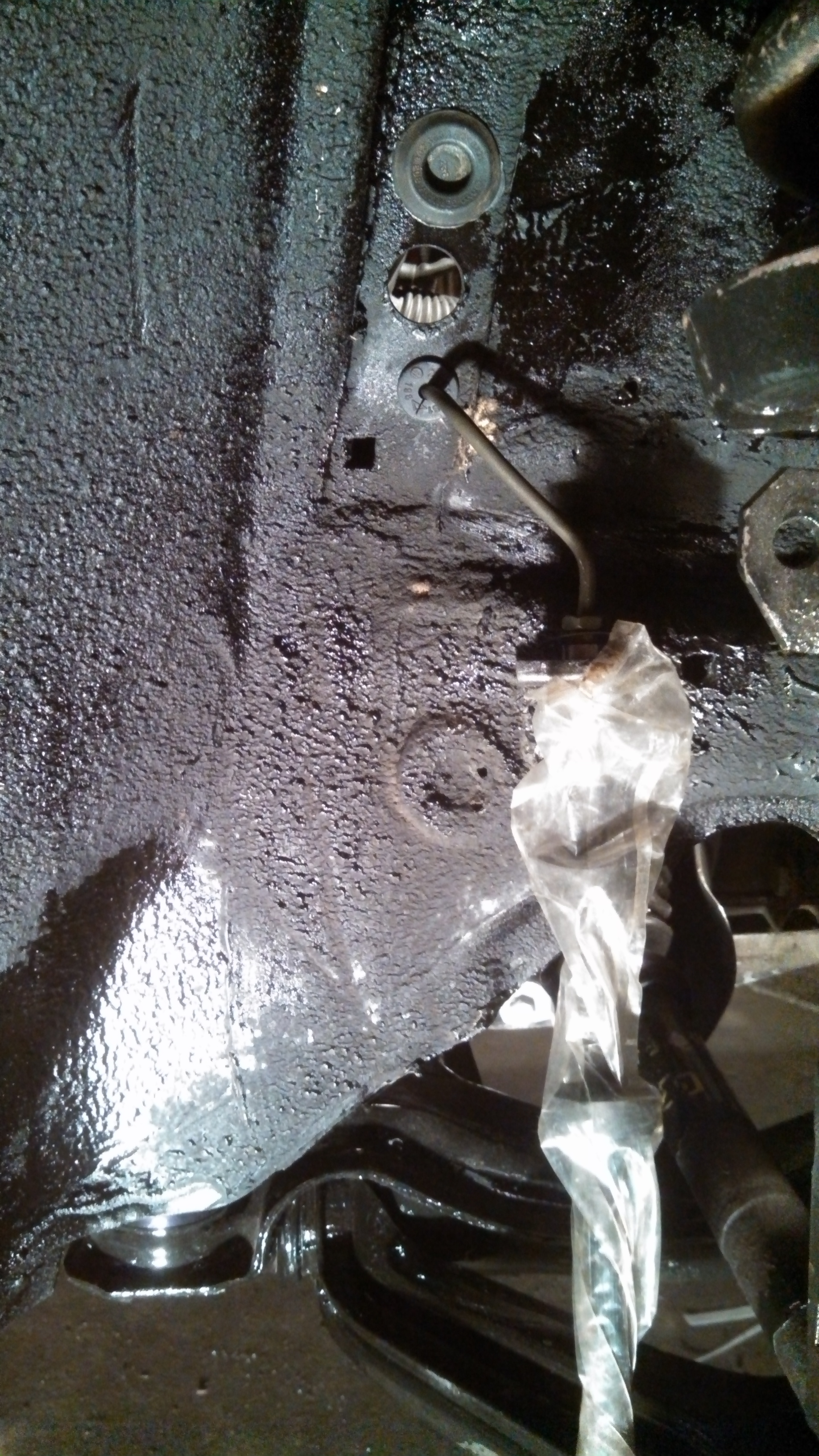

plumbing new brake lines.jpg (1.37 MiB) Viewed 29104 times
handbrake hardline to new T and ind. rears.jpg (1.75 MiB) Viewed 29104 times
new rear pass. hardline.jpg (1.7 MiB) Viewed 29104 times
Note: the hardline coming down and out of the trans tunnel. That’s from the hydraulic handbrake mounted near the shifter!!!

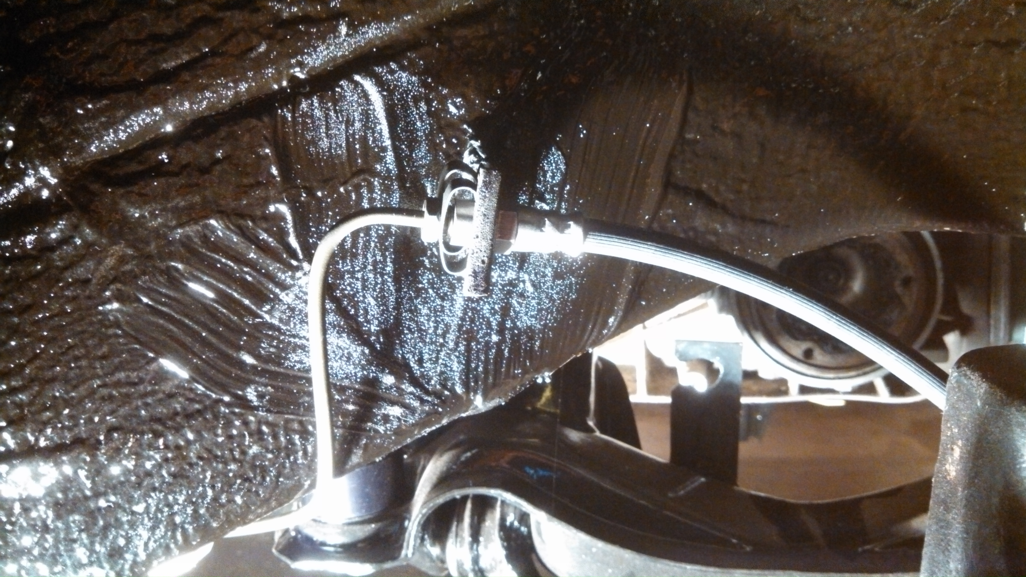

All the rear lines are done, flared, attached and with new clips and softlines! Wooot!
all new hard and softlines with clips.jpg (1.92 MiB) Viewed 29104 times
all new hard and softlines with clips2.jpg (1.8 MiB) Viewed 29104 times

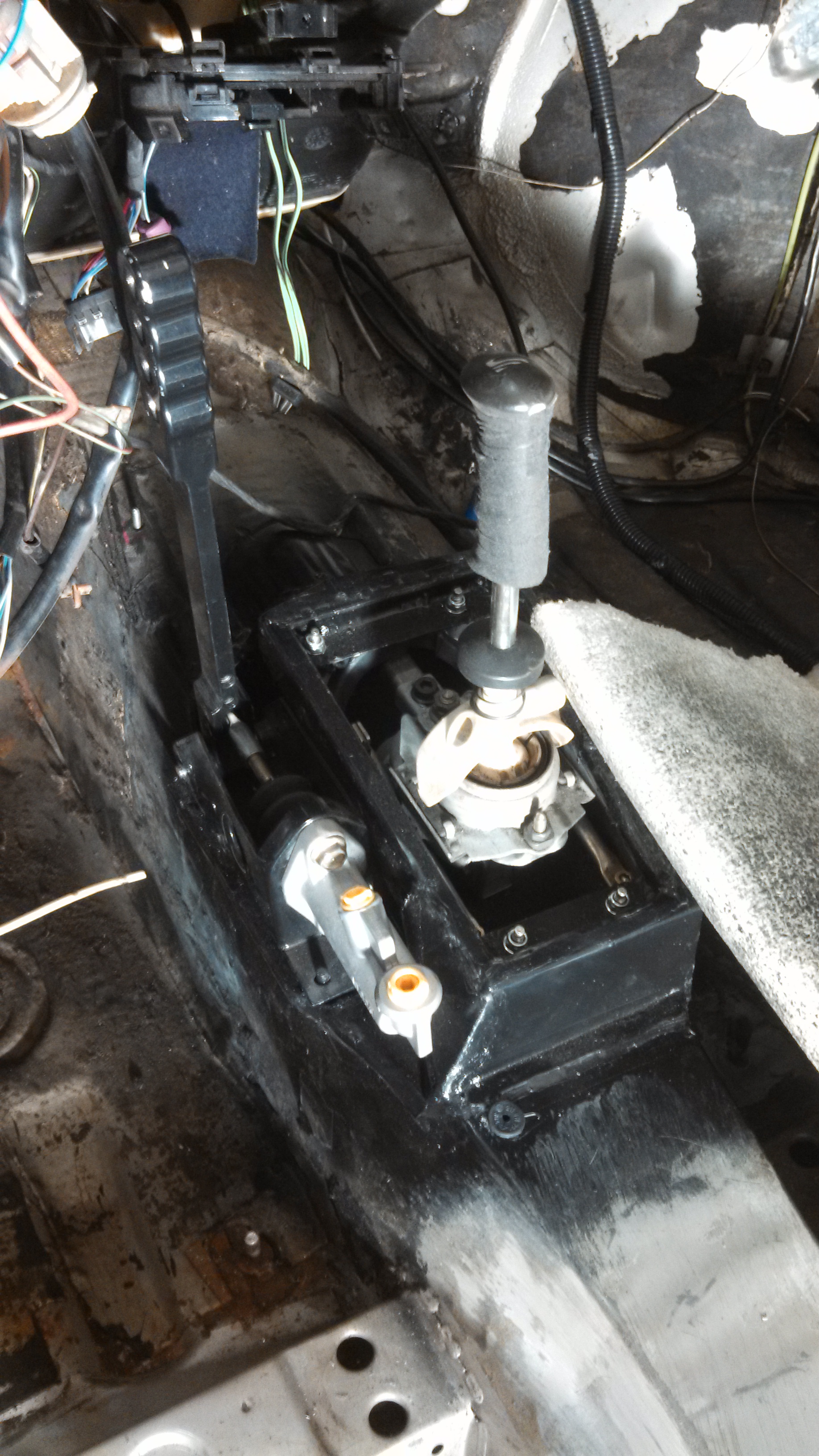

MORE!!

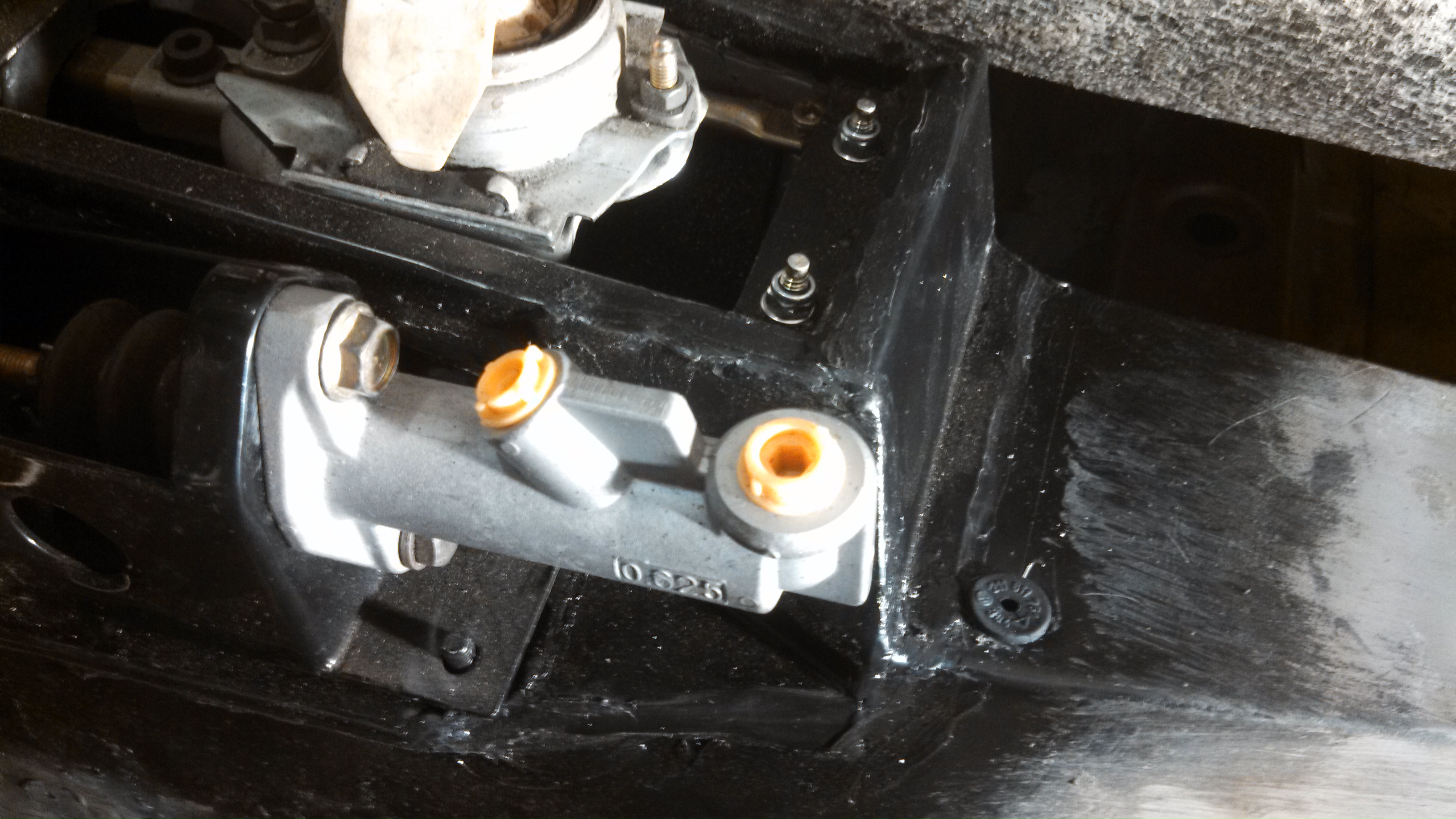

Here is the hydraulic Comp-Brake vertical handbrake inplace with the b5 s4 shifter box. It’s nice and close to the steering wheel and shifter.
handbrake and new shifter.jpg (1.63 MiB) Viewed 29104 times
handbrake mounted next to new shifter.jpg (1.49 MiB) Viewed 29104 times

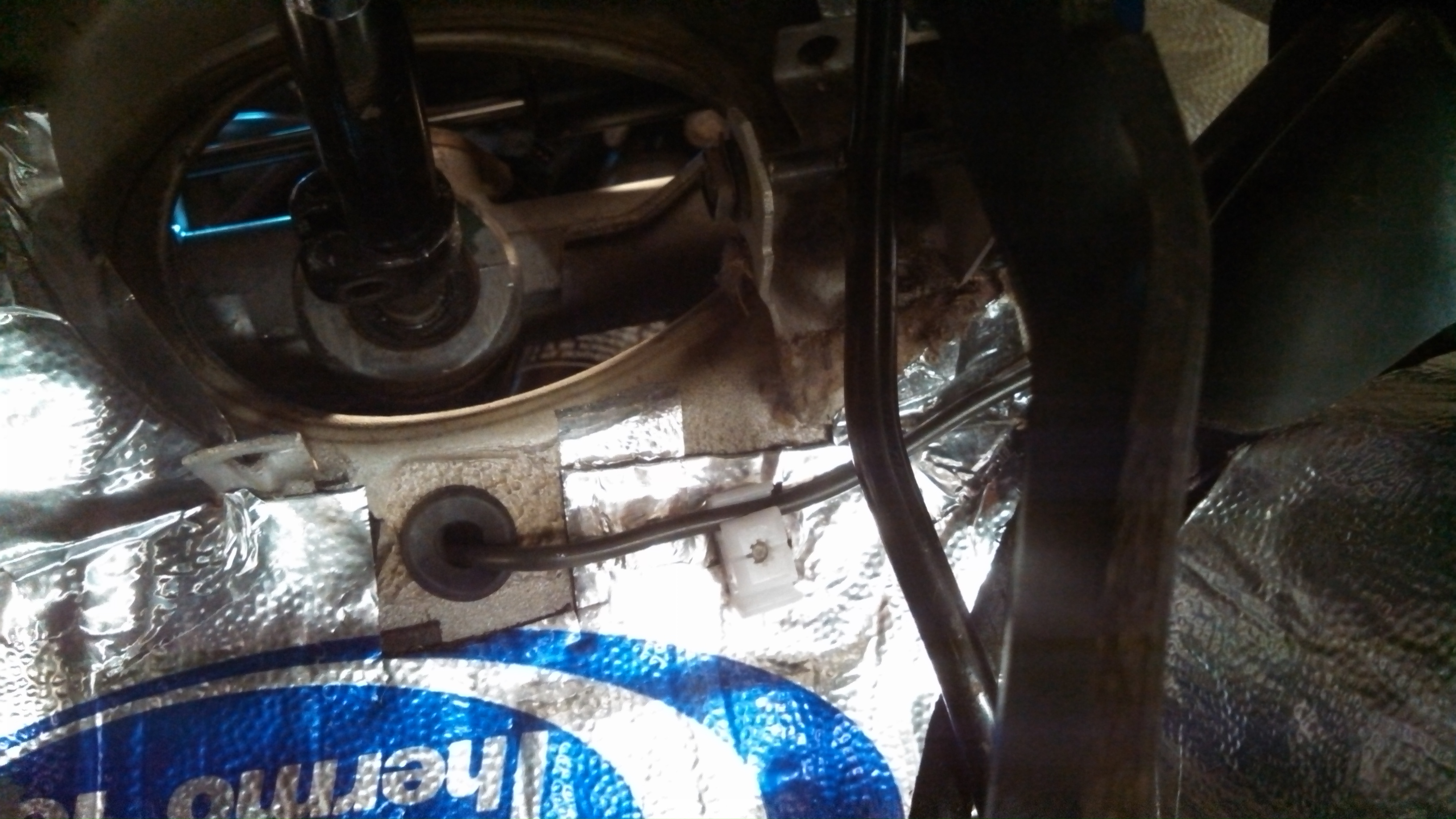

Hardlines coming through firewall and rearward on trans. tunnel
handbrake hardline from MC.jpg (1.23 MiB) Viewed 29104 times
handbrake hardline from MC along tunnel.jpg (1.31 MiB) Viewed 29104 times

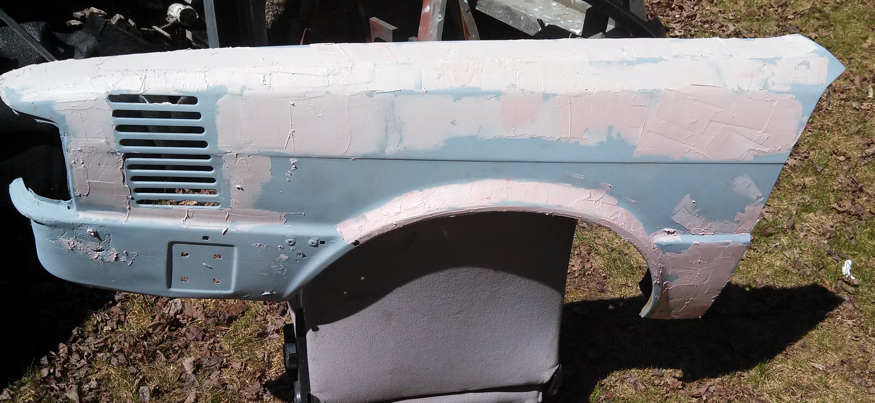

MORE!!

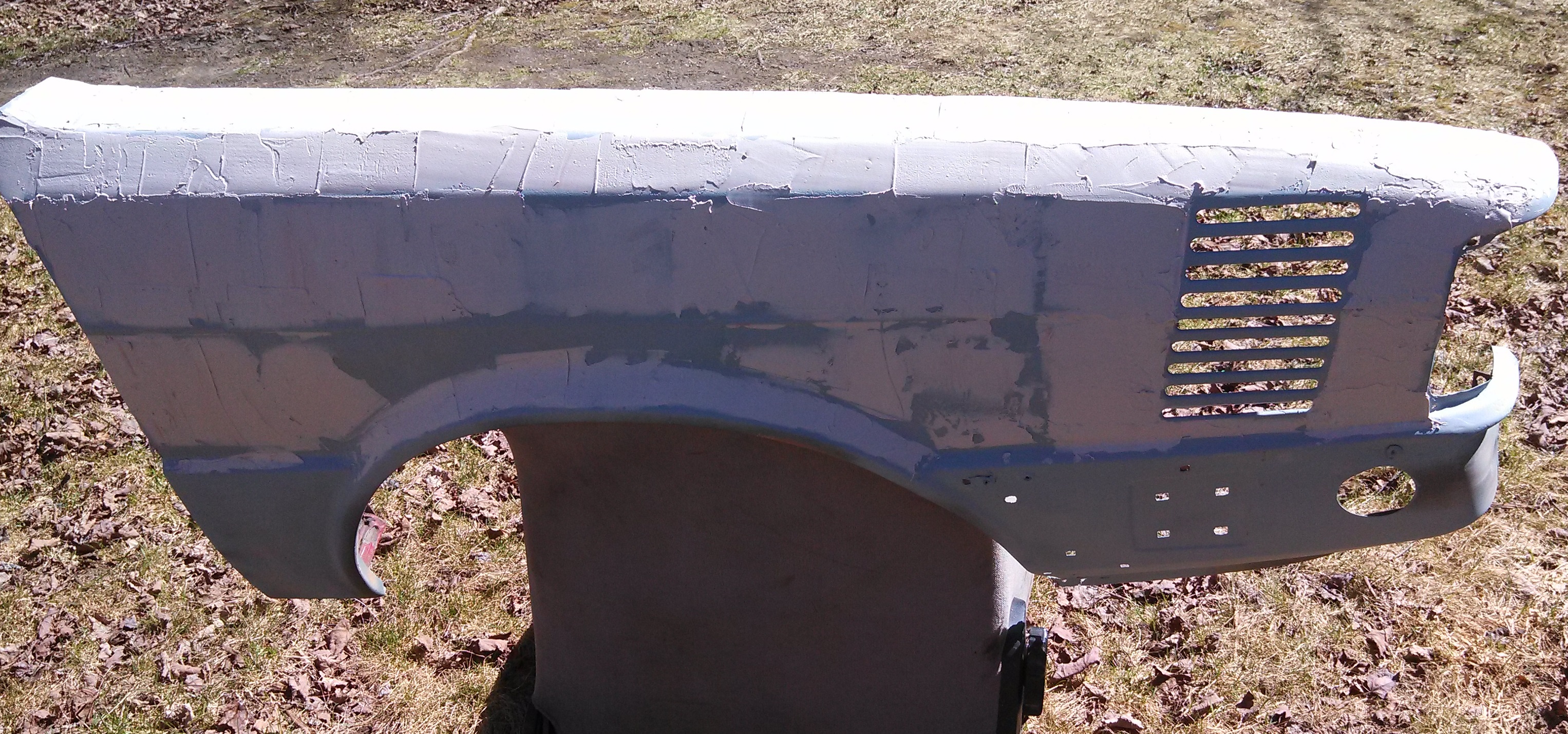

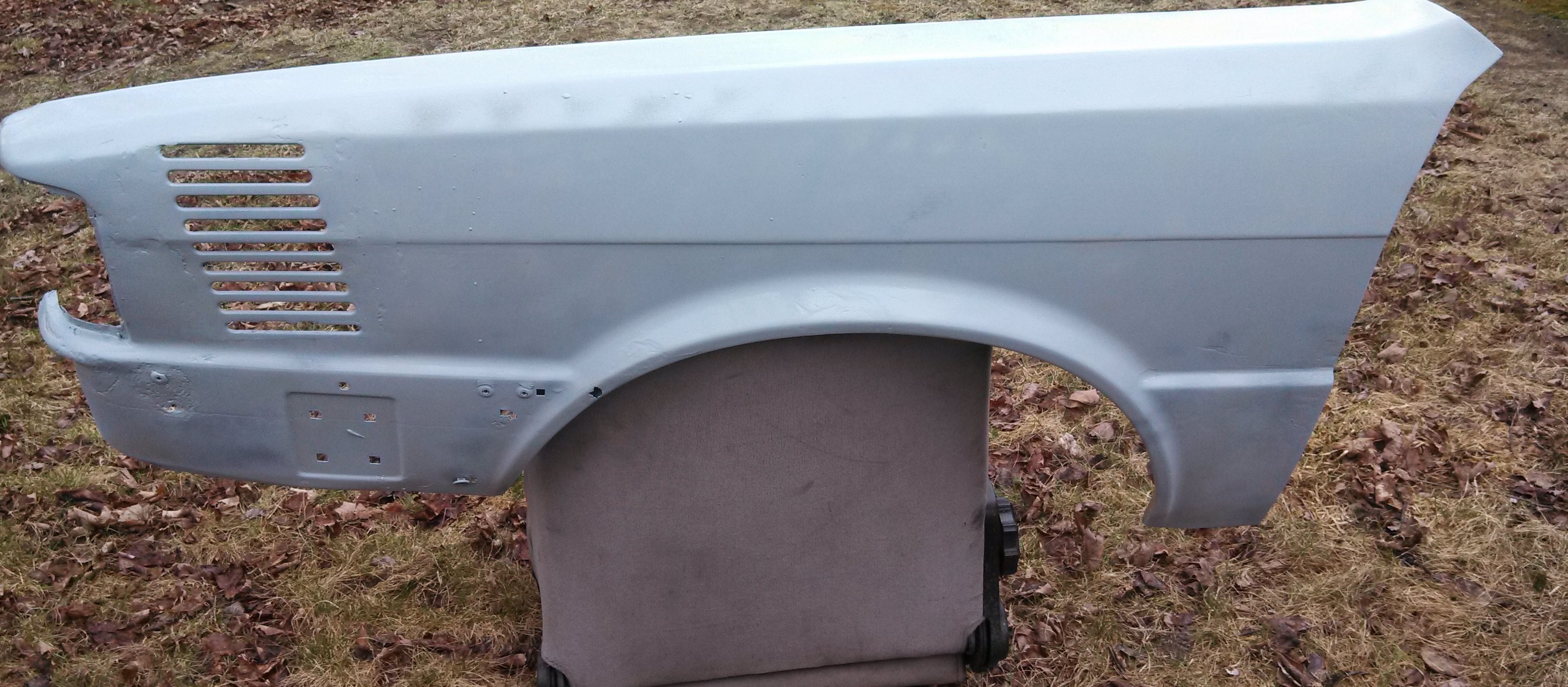

Fenders got their major dose of bondo smoothing, I just need to do one more skim on a few spots and they will be ready for paint!
more bondoage.jpg (1.72 MiB) Viewed 29103 times
more bondoage 2.jpg (1.35 MiB) Viewed 29103 times

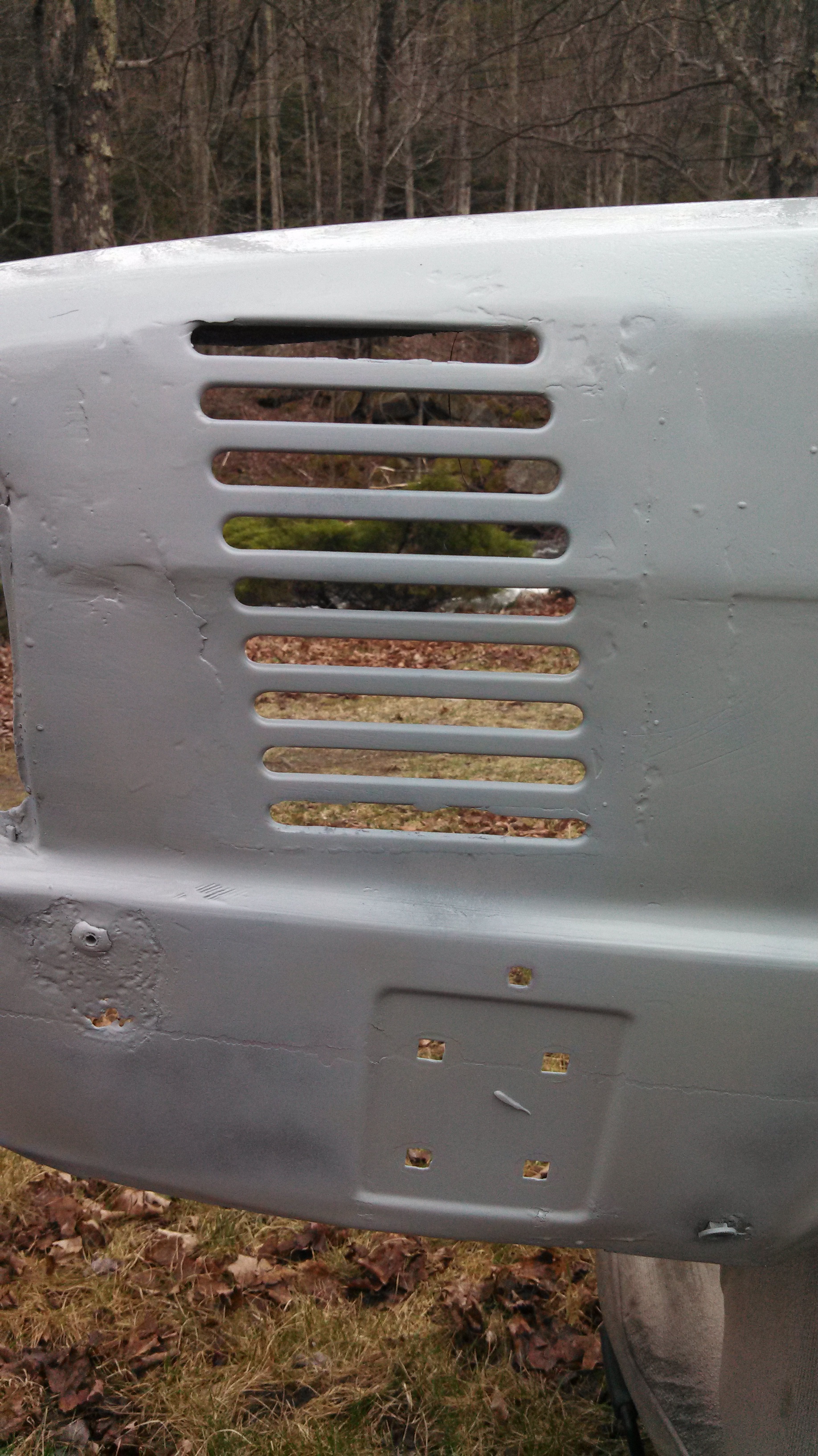

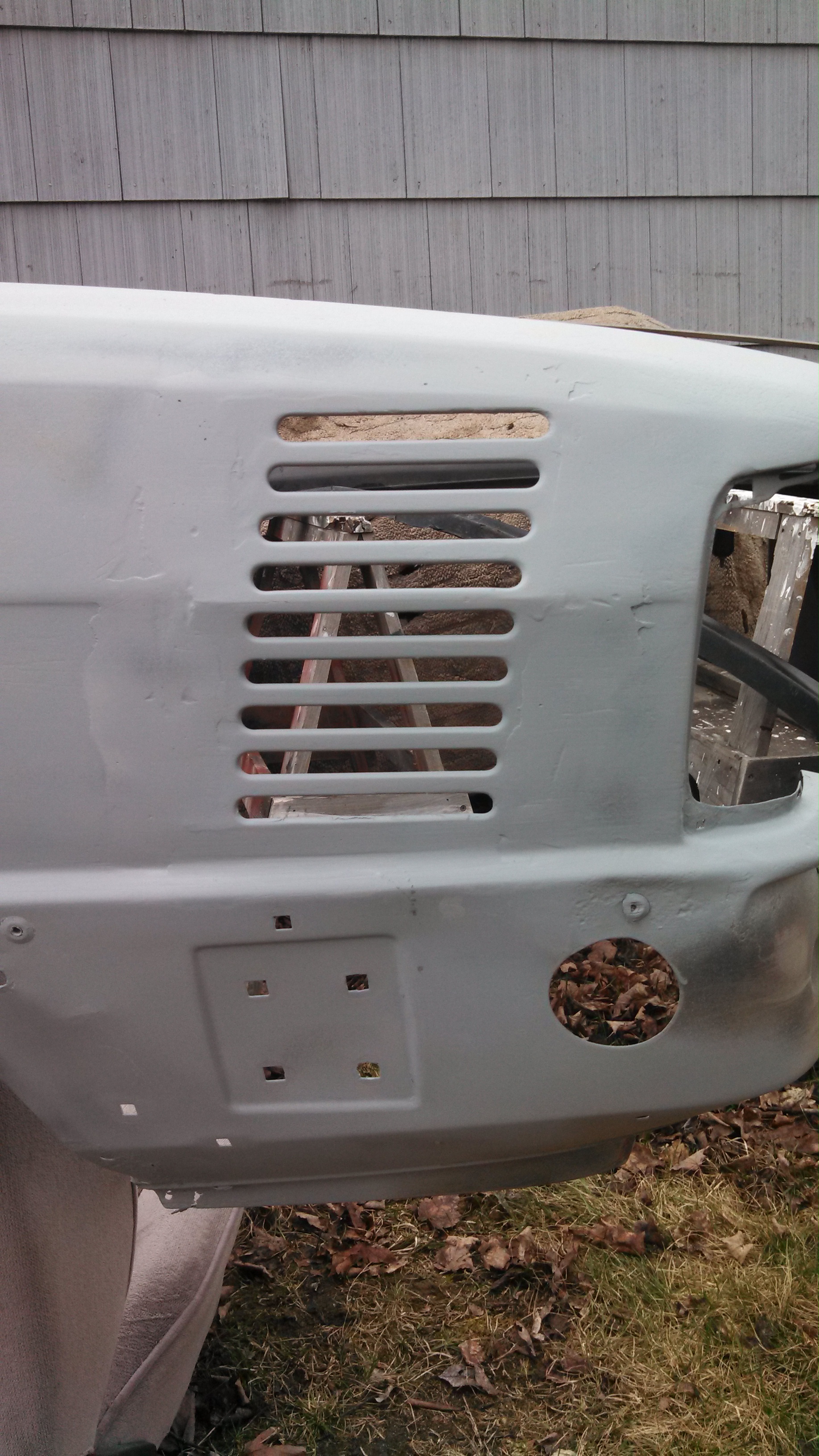

more
drv fender vent.jpg (1.42 MiB) Viewed 29103 times
drv fender vent detail.jpg (1.87 MiB) Viewed 29103 times
pass fender vent.jpg (1.4 MiB) Viewed 29103 times
pass fender vent detail.jpg (1.7 MiB) Viewed 29103 times

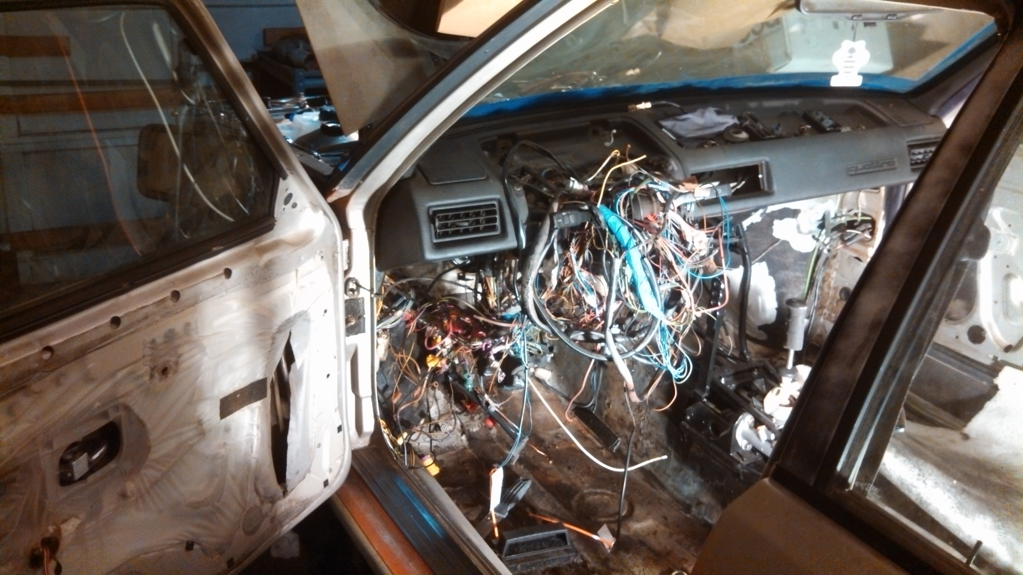

Wiring to go through, ugh
wiring to sort through.jpg (1.61 MiB) Viewed 29102 times

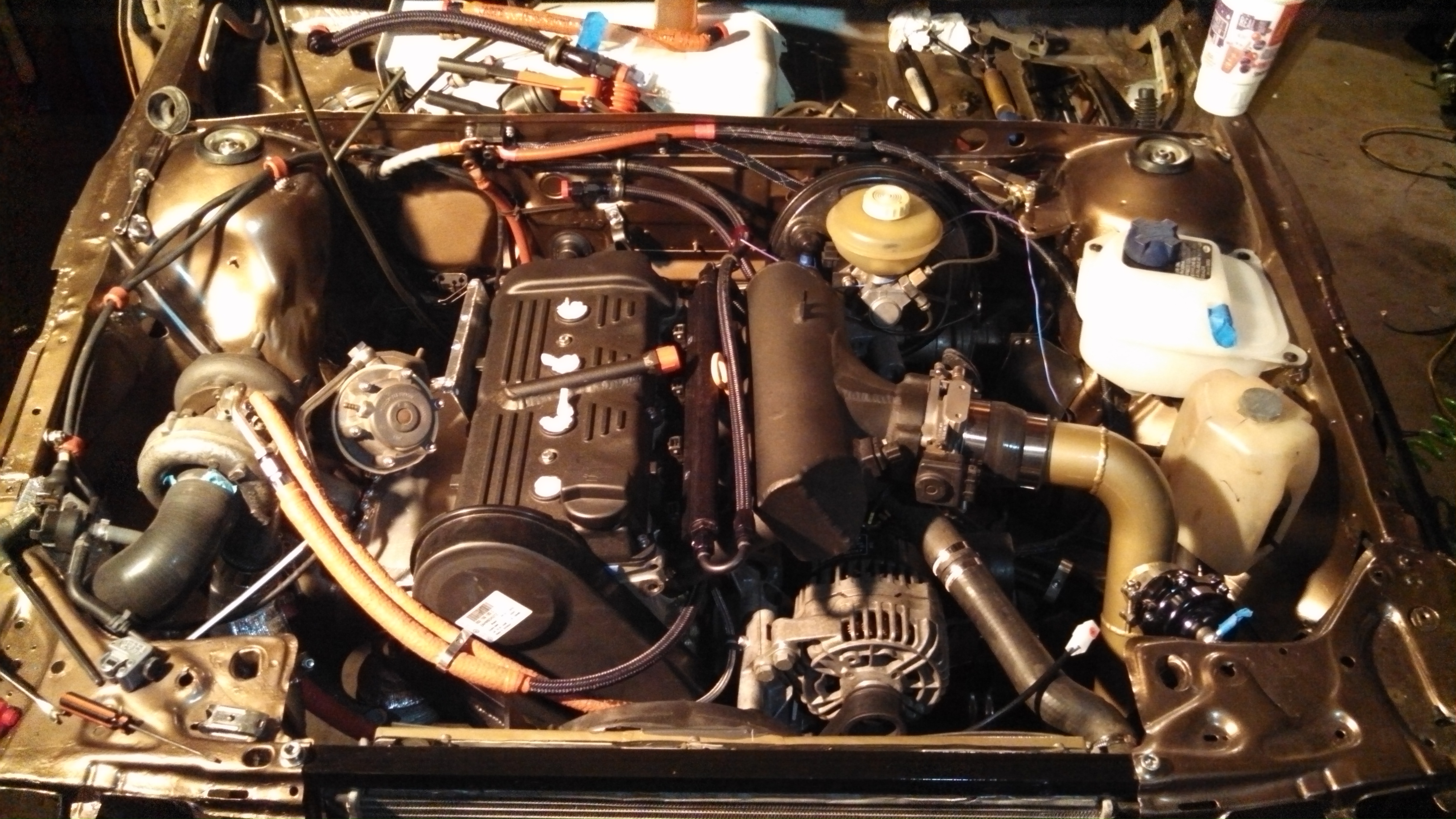

Here’s a pic of the engine bay just prior to wrapping it all up
most recent bay shot.jpg (1.73 MiB) Viewed 29102 times

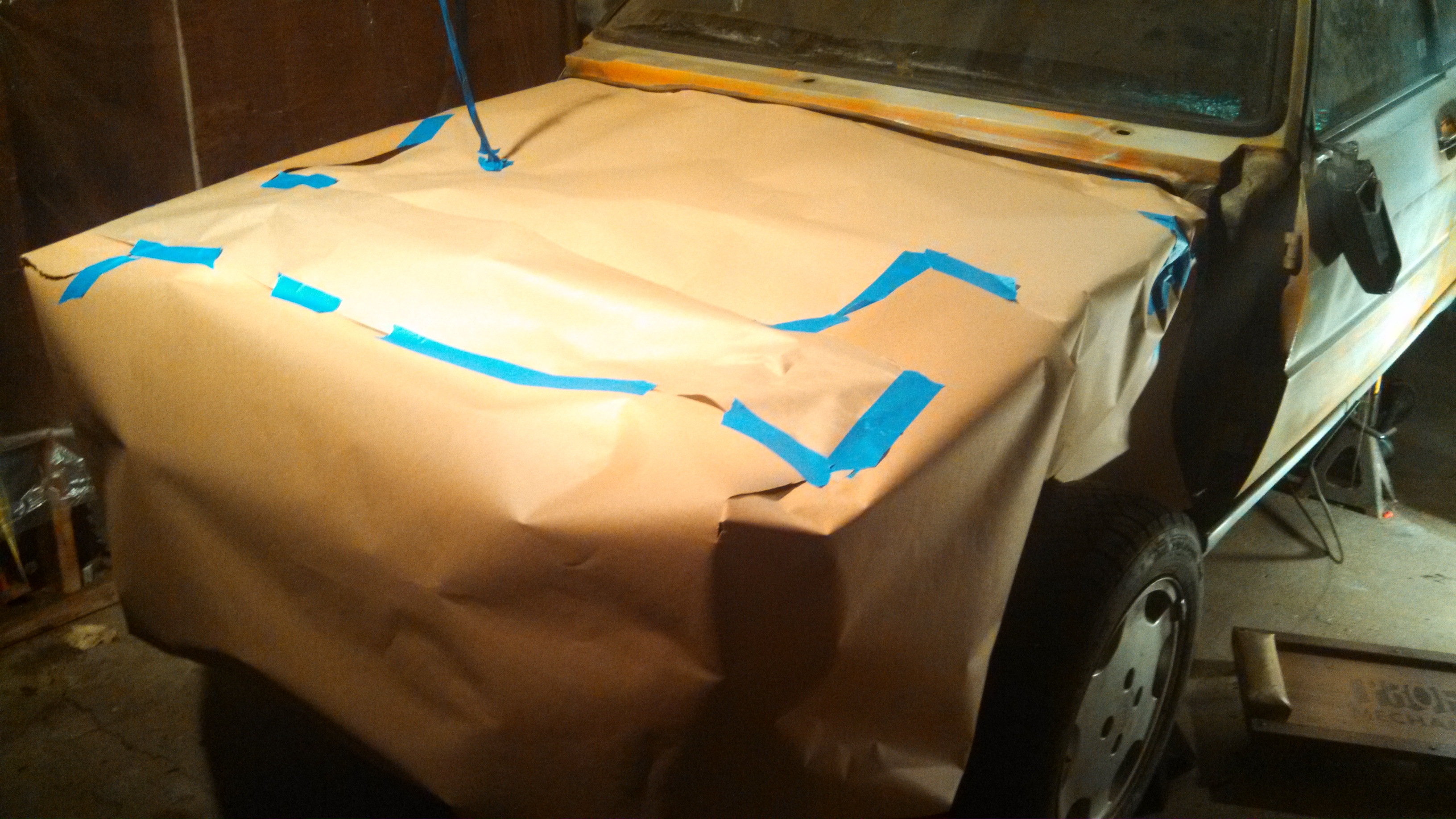

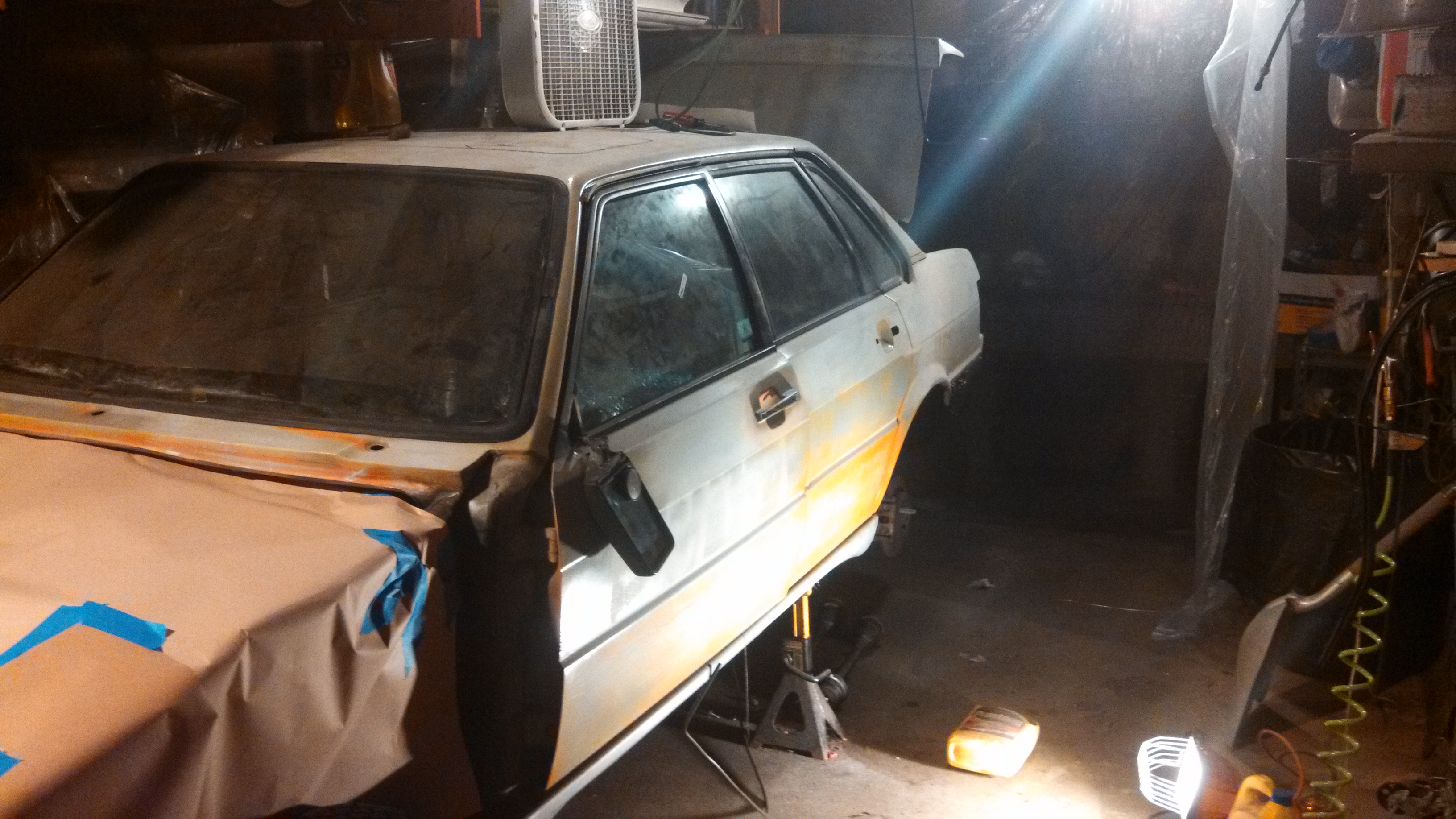

All taped off awaiting paint.
engine bay all sealed up for paint protection.jpg (1.81 MiB) Viewed 29102 times
paint prep.jpg (1.15 MiB) Viewed 29102 times

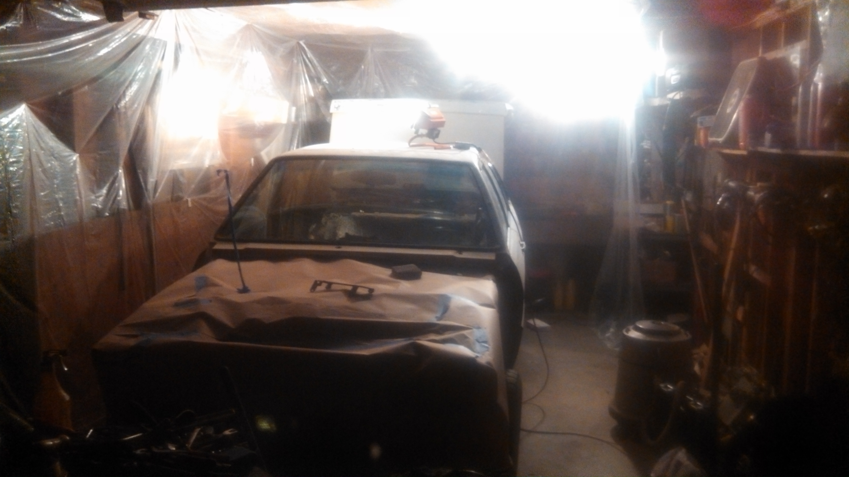

Garage prepped for sanding, sanding, sanding then PAINT!!!!
needs paint.jpg (1.85 MiB) Viewed 29102 times

ermahgawd those wires
Re: Tim's '86 BLAZE 4kq EPIC PROGESS!!!!
AngryTaco wrote:ermahgawd those wires
whatchou talkin bout!!!
AngryTaco
Posts: 2657
Location: Hayden Lake, Idaho
Post by AngryTaco »
I thought the wiring on my 4k 20vt was bad. That right there is nuts
AngryTaco wrote:I thought the wiring on my 4k 20vt was bad. That right there is nuts
youre crazy
a vems 4 cyl intergration ito a 4kq isn't bad!!!
