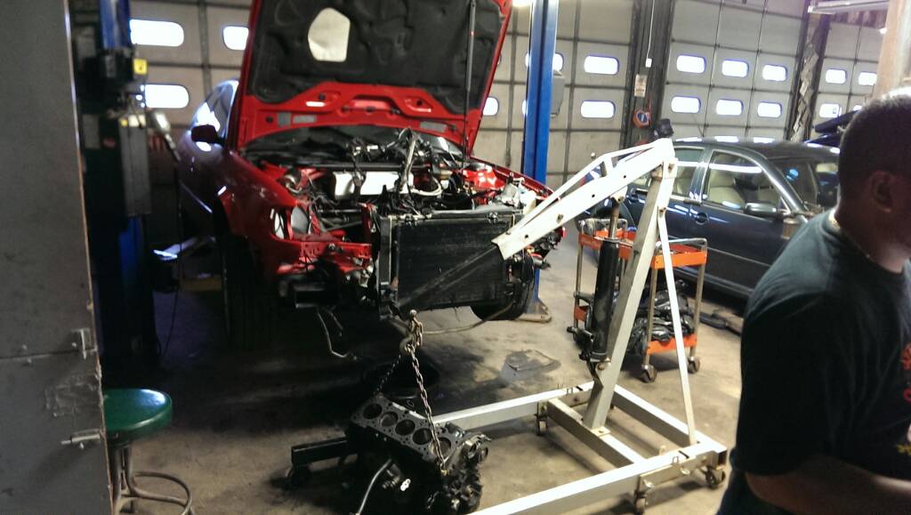

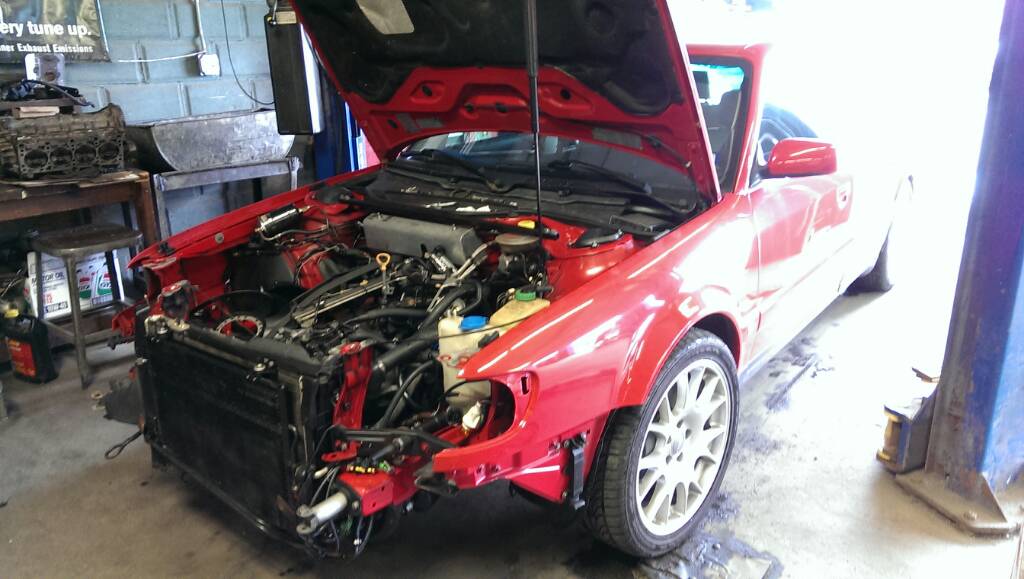

Posted: Wed Jun 26, 2013 6:33 pm
by EDIGREG

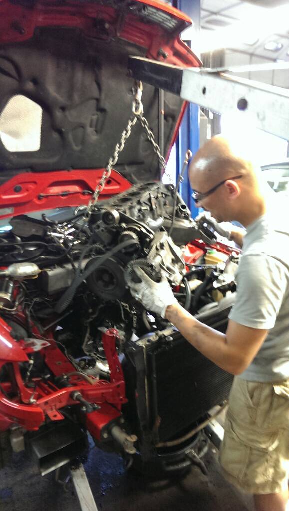

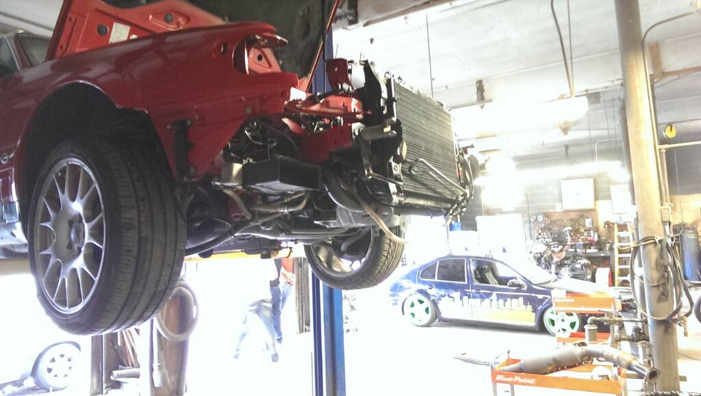

Dude, pull the radiator and AC condenser! Takes 10 minutes and makes things sooo much easier!

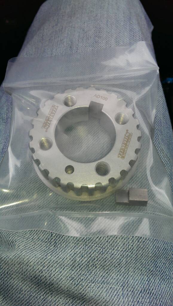

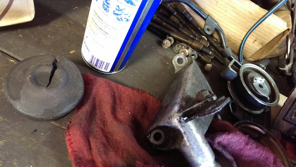

After 2 failed attempts to remove the used ones crack free... Had to pick this up.

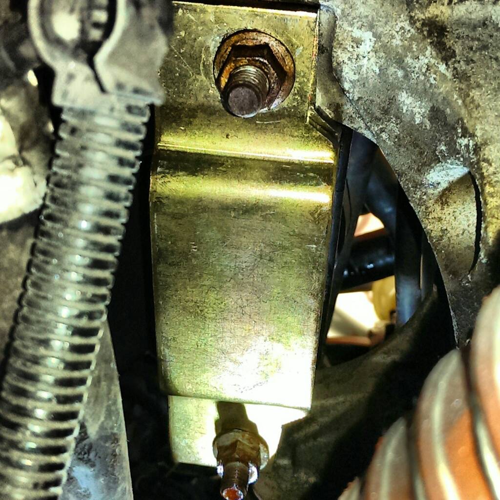

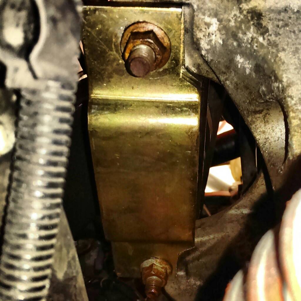

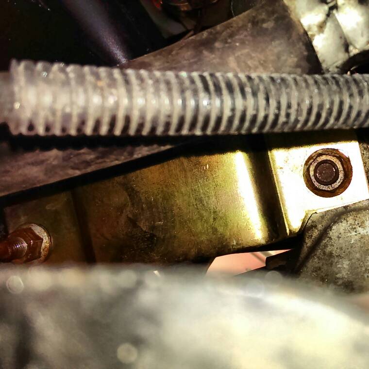

Edigreg here's the Driver side

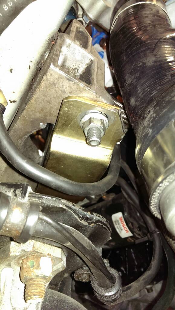

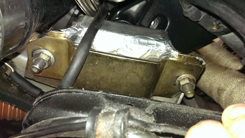

by mushasho
And passenger side

Re: A tale of Rubí... New hardware w/PICS
Posted: Fri Jun 28, 2013 9:19 pm
by EDIGREG
The bottom bracket is installed wrong in the photos. It should point upwards to support the mount
Posted: Fri Jun 28, 2013 9:24 pm
by mushasho
EDIGREG wrote:The bottom bracket is installed wrong in the photos. It should point upwards to support the mount
Really? I actually had 2 people specifically point this out as the proper placement. I was under the same impression as I thought it should go in the notch... How'd you figure it the other way?
Posted: Fri Jun 28, 2013 11:29 pm
by EDIGREG
It's obvious. The plate provides no support to the mount if it is upside down.
Google photos of the mount if you don't trust me :)
