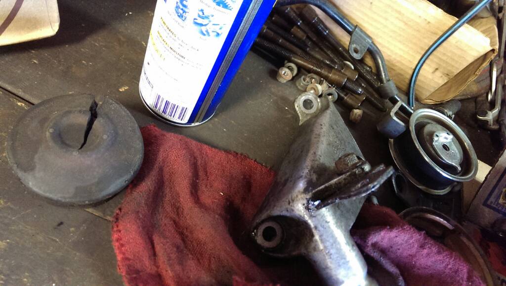

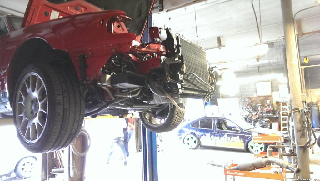

Of course I'm looking for someone on the east coast that stocks a poly snub that can ship it out today...
Re: A tale of Rubí... On lift w/PICS
OBI- If you want a free new reinforced Rubber snubber I ordered one for my 200 and when I went to put it in I realized I had a new one in already.
Free for you my friend - it's sitting in the 200's door pocket.
Out

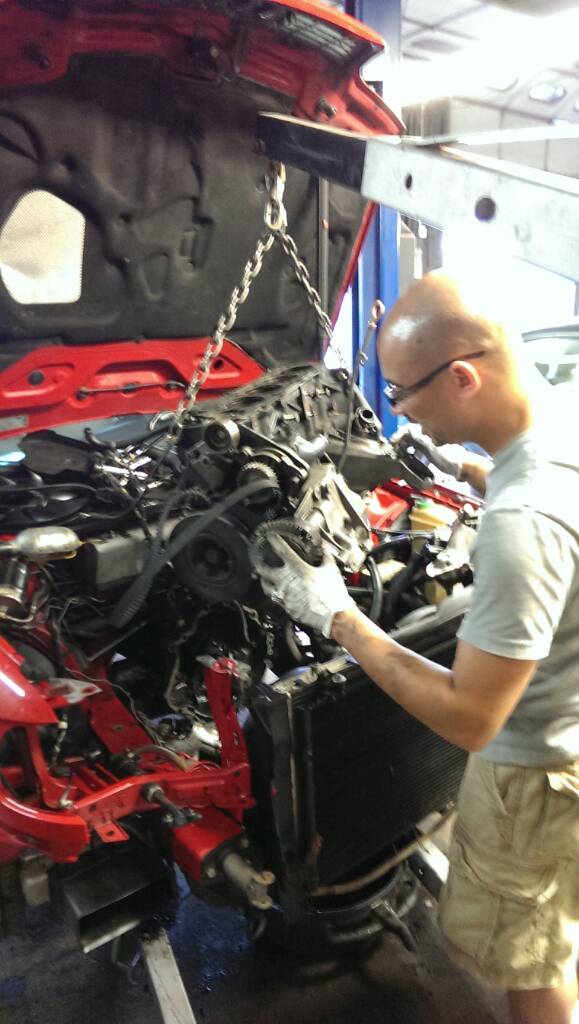

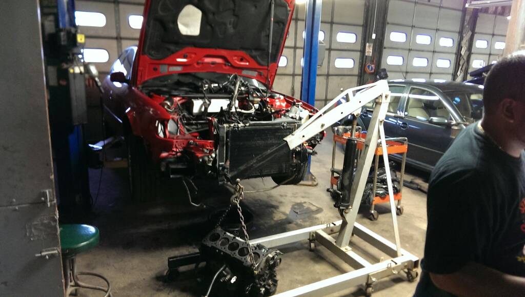

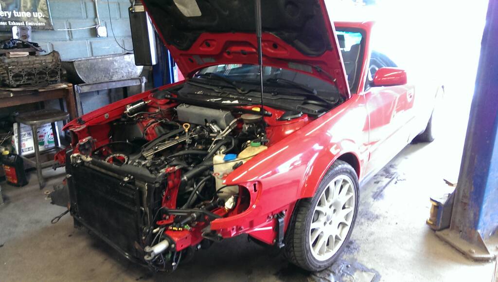

Dude, pull the radiator and AC condenser! Takes 10 minutes and makes things sooo much easier!

Re: A tale of Rubí... New hardware w/PICS
That looks *okay*

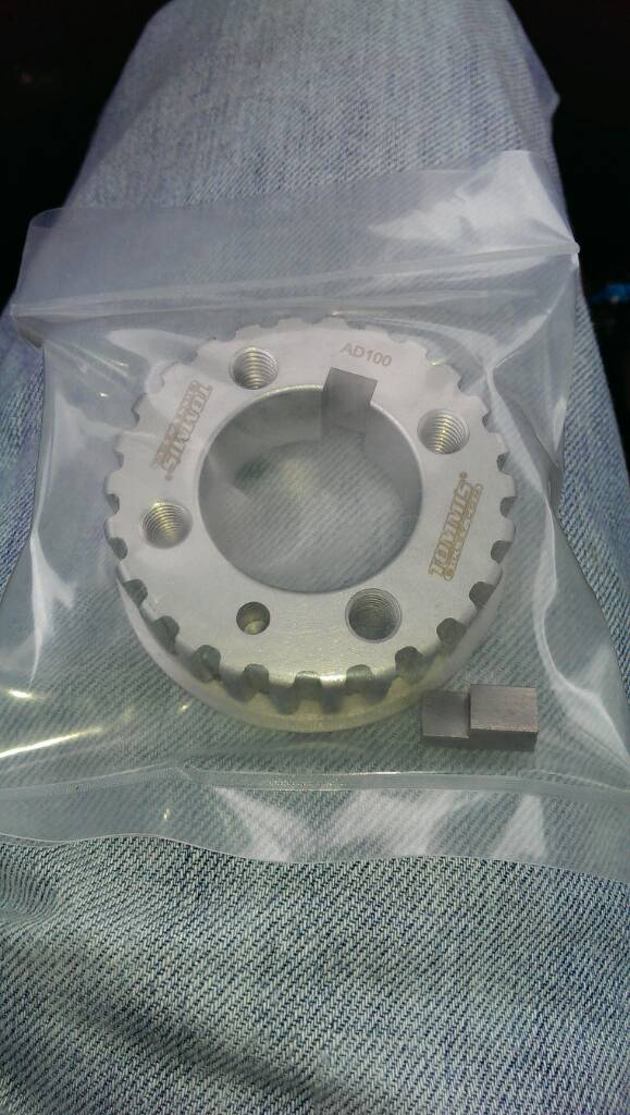

After 2 failed attempts to remove the used ones crack free... Had to pick this up.

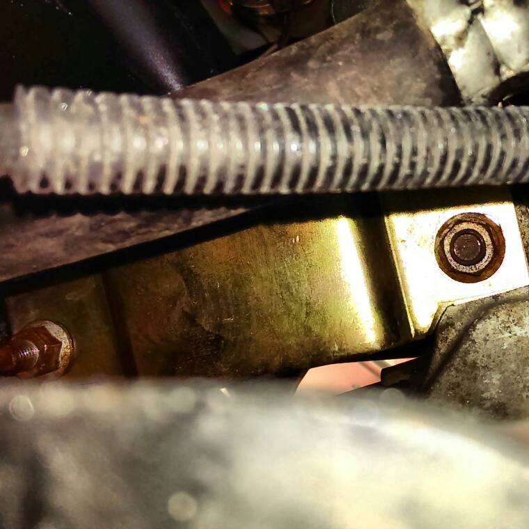

Edigreg here's the Driver side

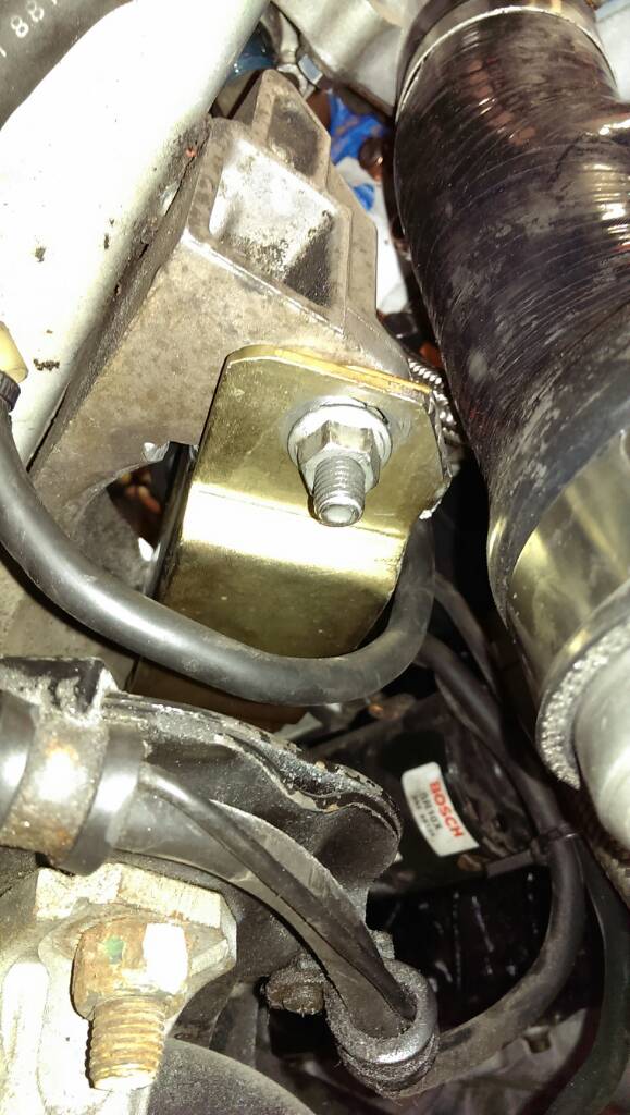

And passenger side
From this car

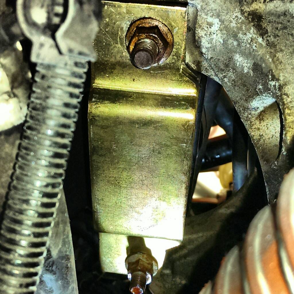

The bottom bracket is installed wrong in the photos. It should point upwards to support the mount
EDIGREG wrote:The bottom bracket is installed wrong in the photos. It should point upwards to support the mount
Really? I actually had 2 people specifically point this out as the proper placement. I was under the same impression as I thought it should go in the notch... How'd you figure it the other way?
It's obvious. The plate provides no support to the mount if it is upside down.
Google photos of the mount if you don't trust me :)
