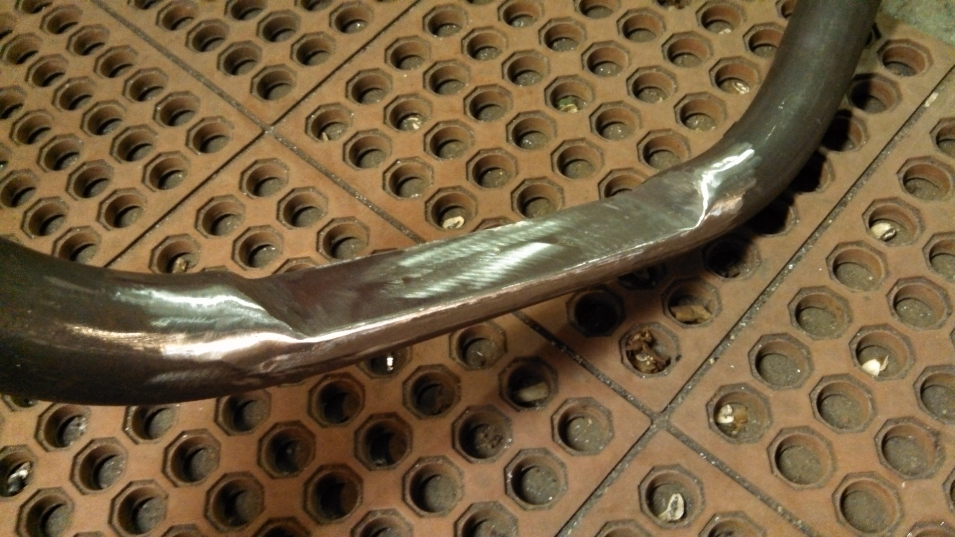

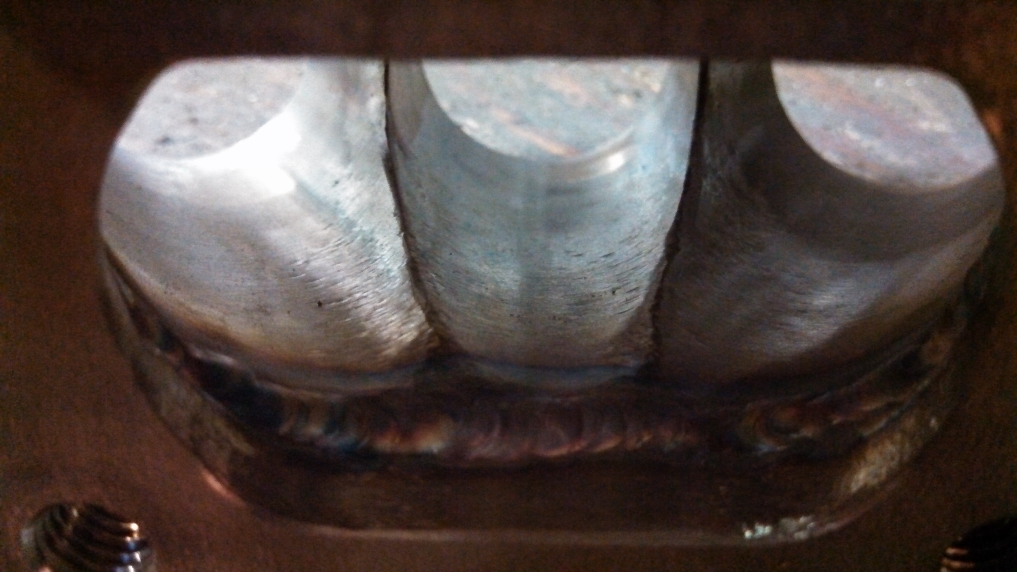

Here is the front transverse member of the front subframe, finished welded and reinstalled.
- front sf front transverse member.jpg (1.2 MiB) Viewed 45754 times
- front sf front transverse member2.jpg (1.19 MiB) Viewed 45754 times

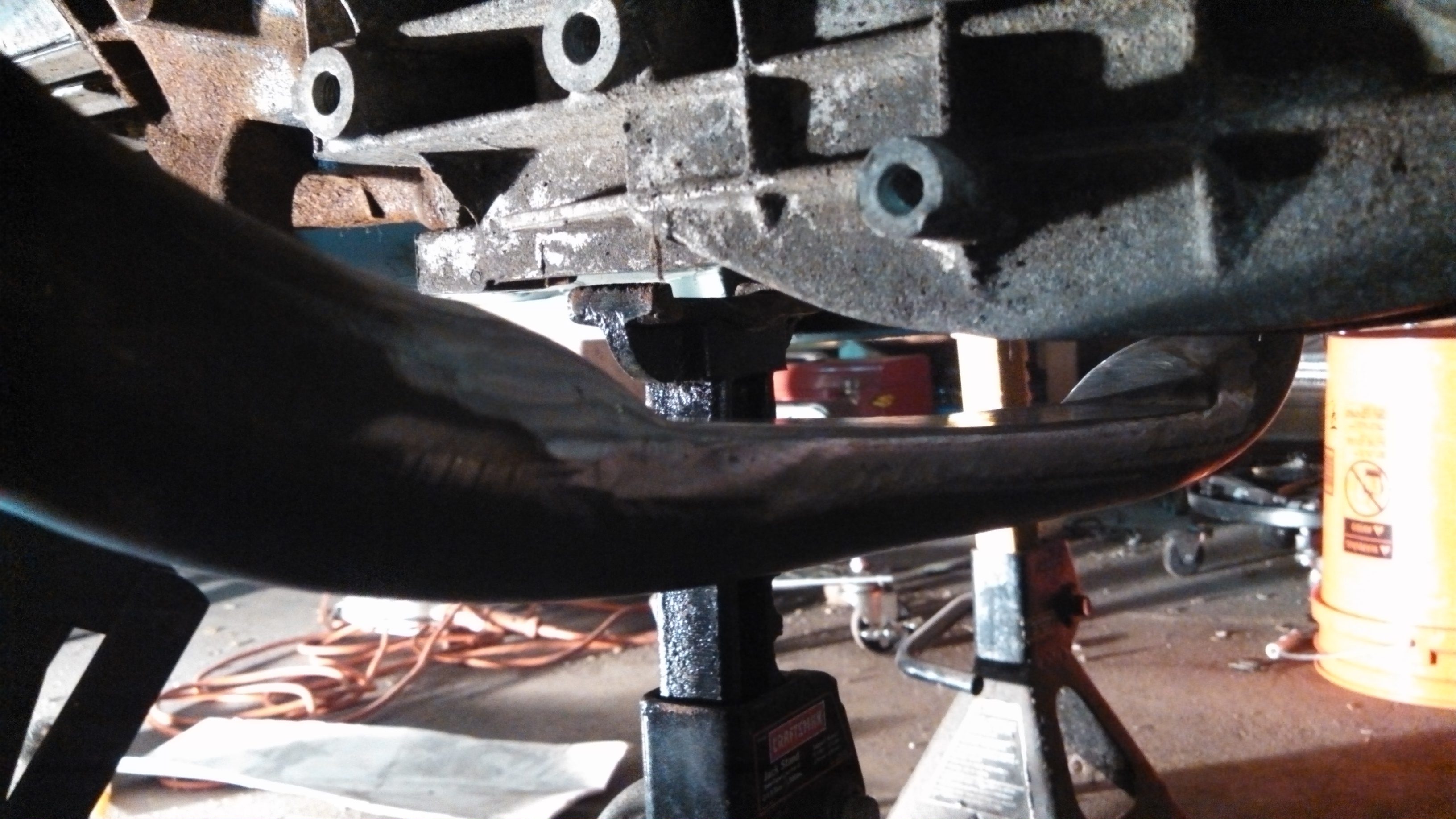

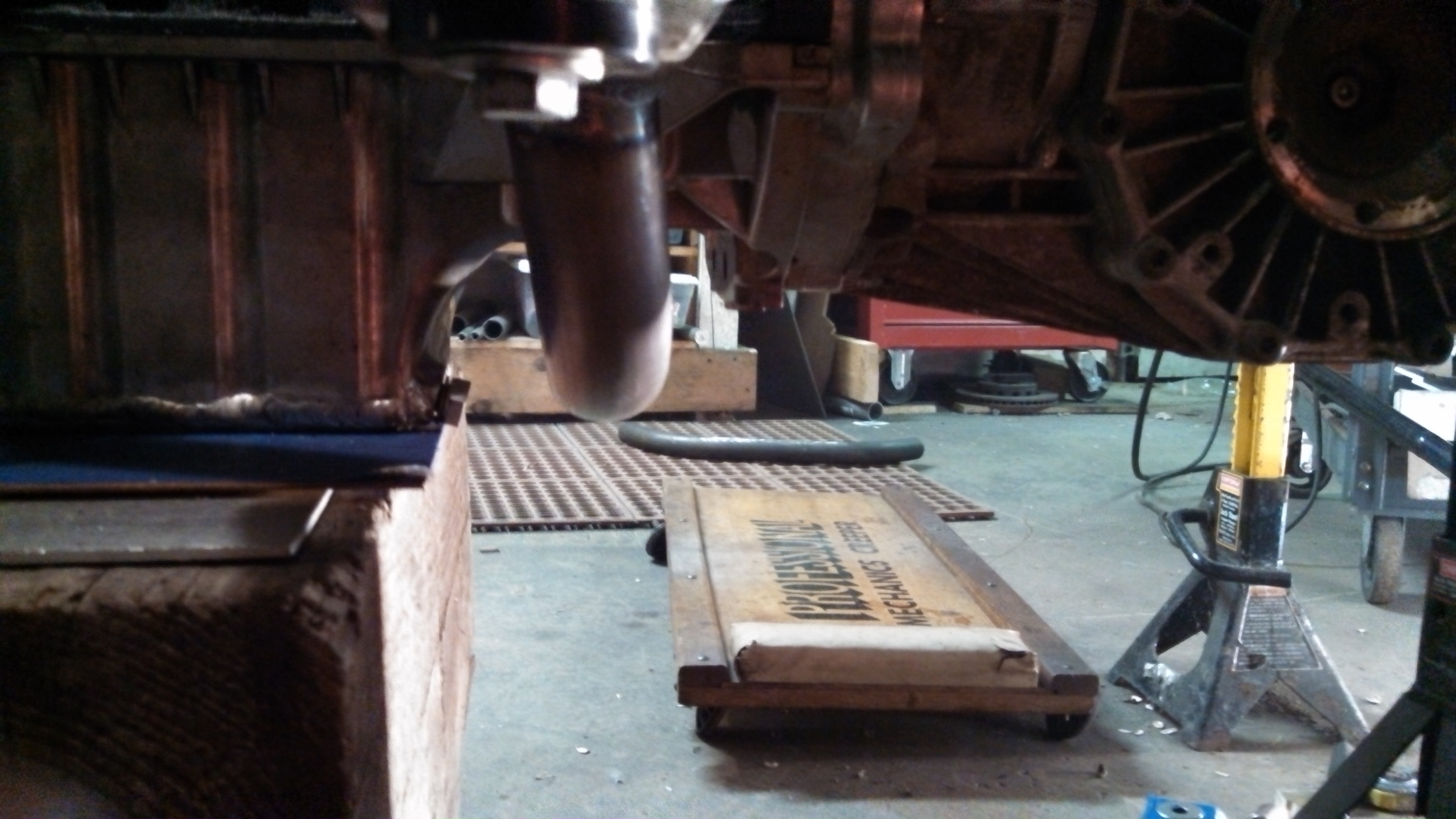

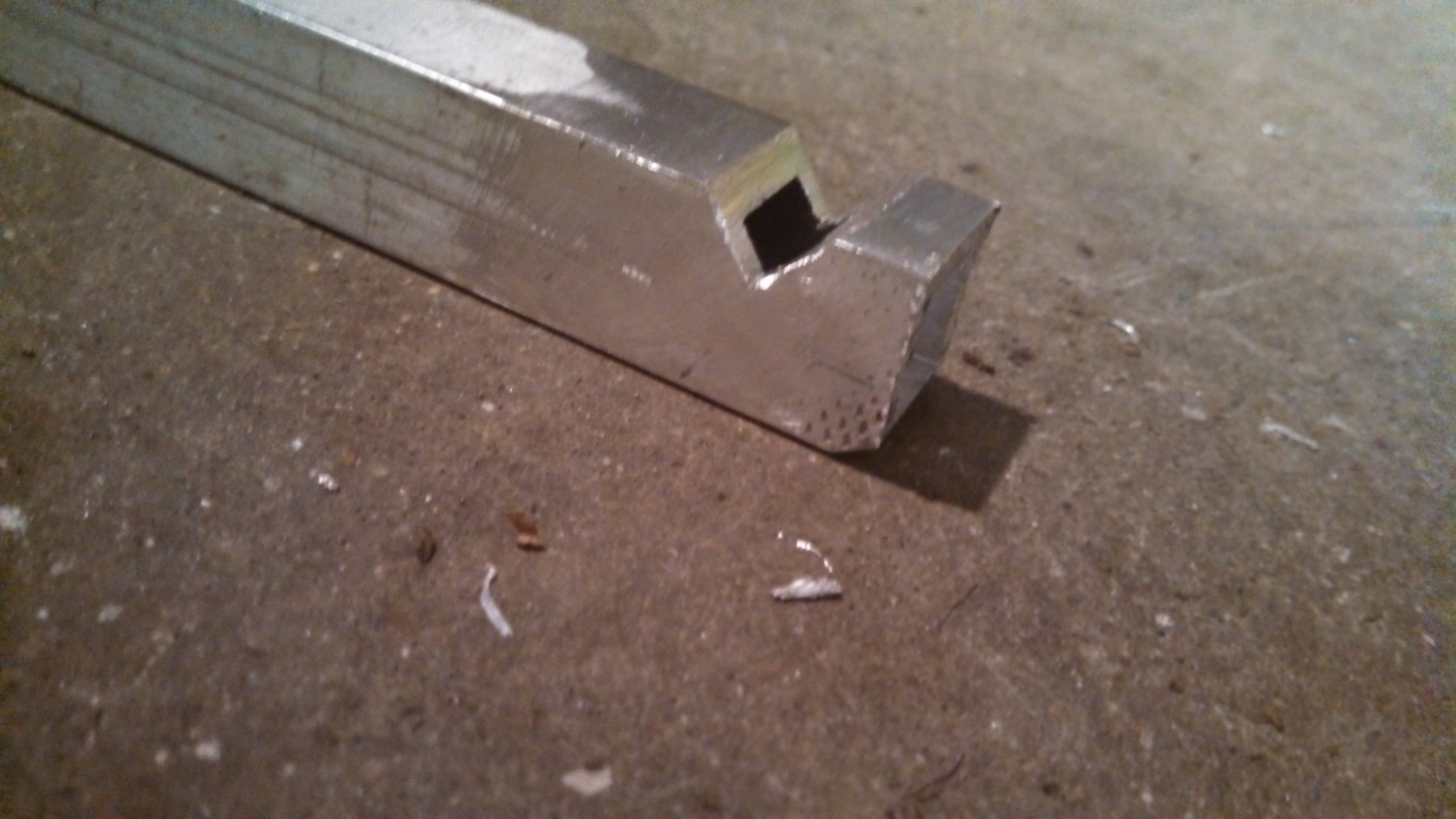

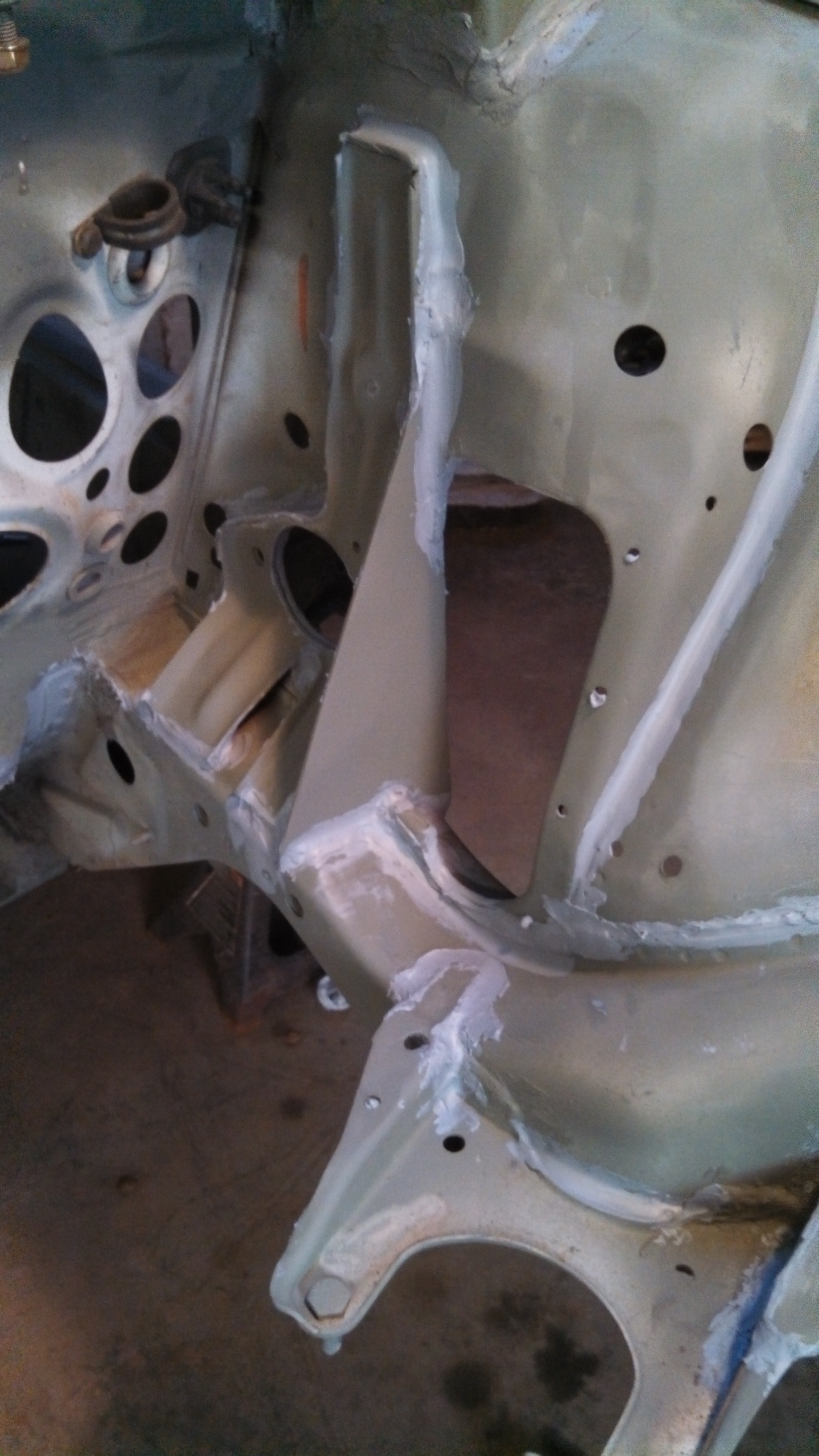

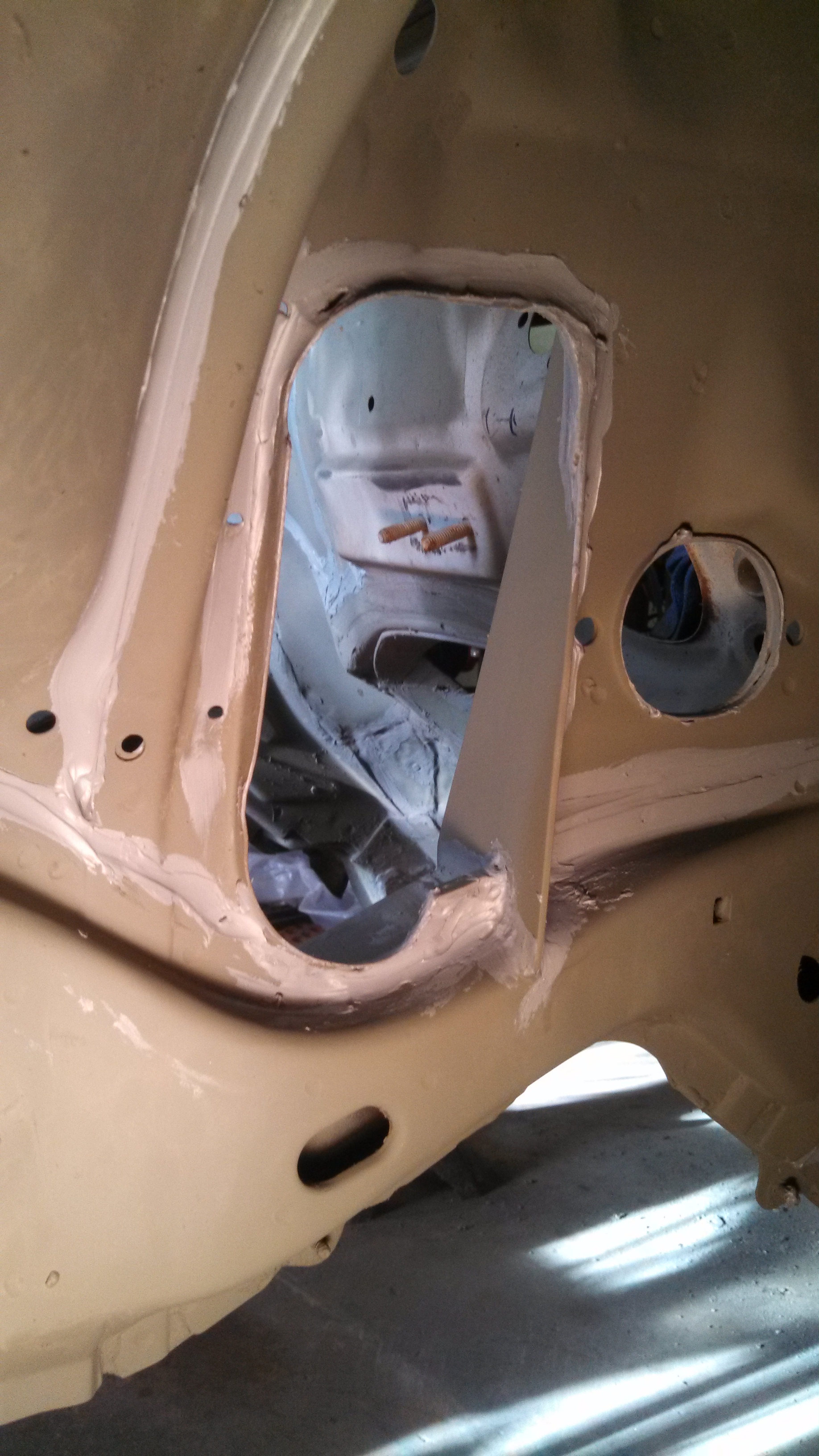

And here is the tranverse member that will go under the bellhousing. The trans is mounted pretty low, so I relieved the tubing and used a thick plate and some endcaps, welded it up and flappered it reasonably smooth. I’m just holding it in the pic, and might trim the bottom of the bellhousing fins down a bit.
- front sf under trans relief.jpg (1.5 MiB) Viewed 45754 times
- front sf under trans relief to be mounted.jpg (1.41 MiB) Viewed 45754 times

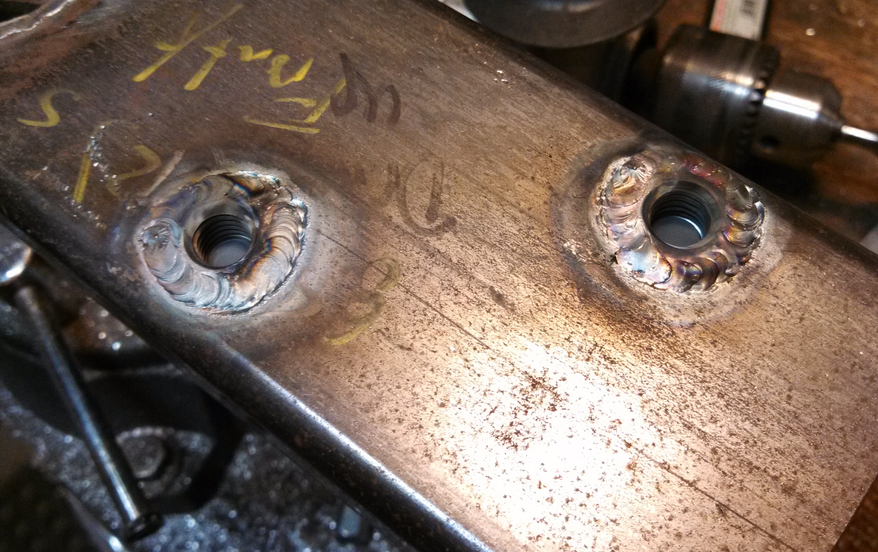

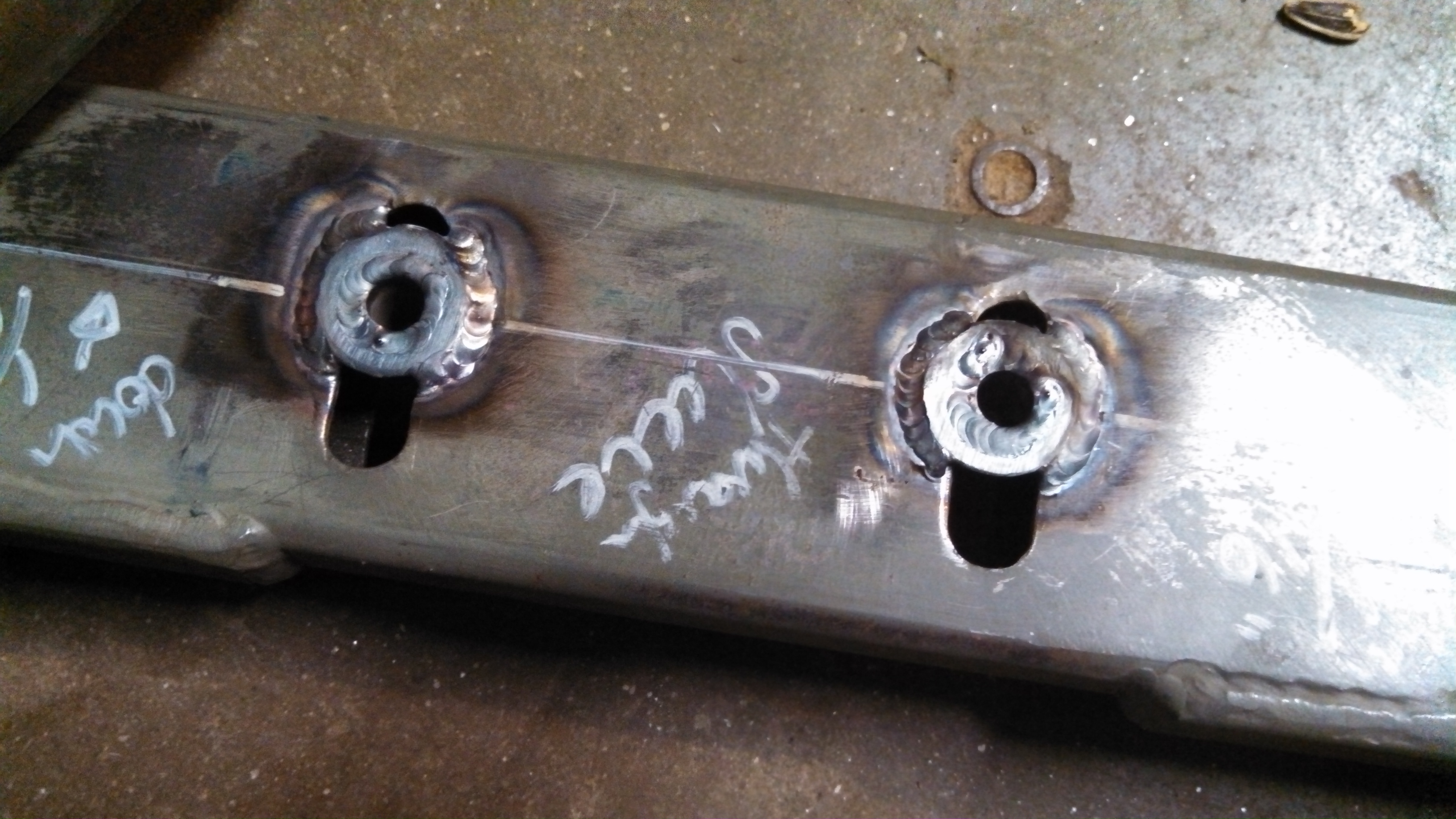

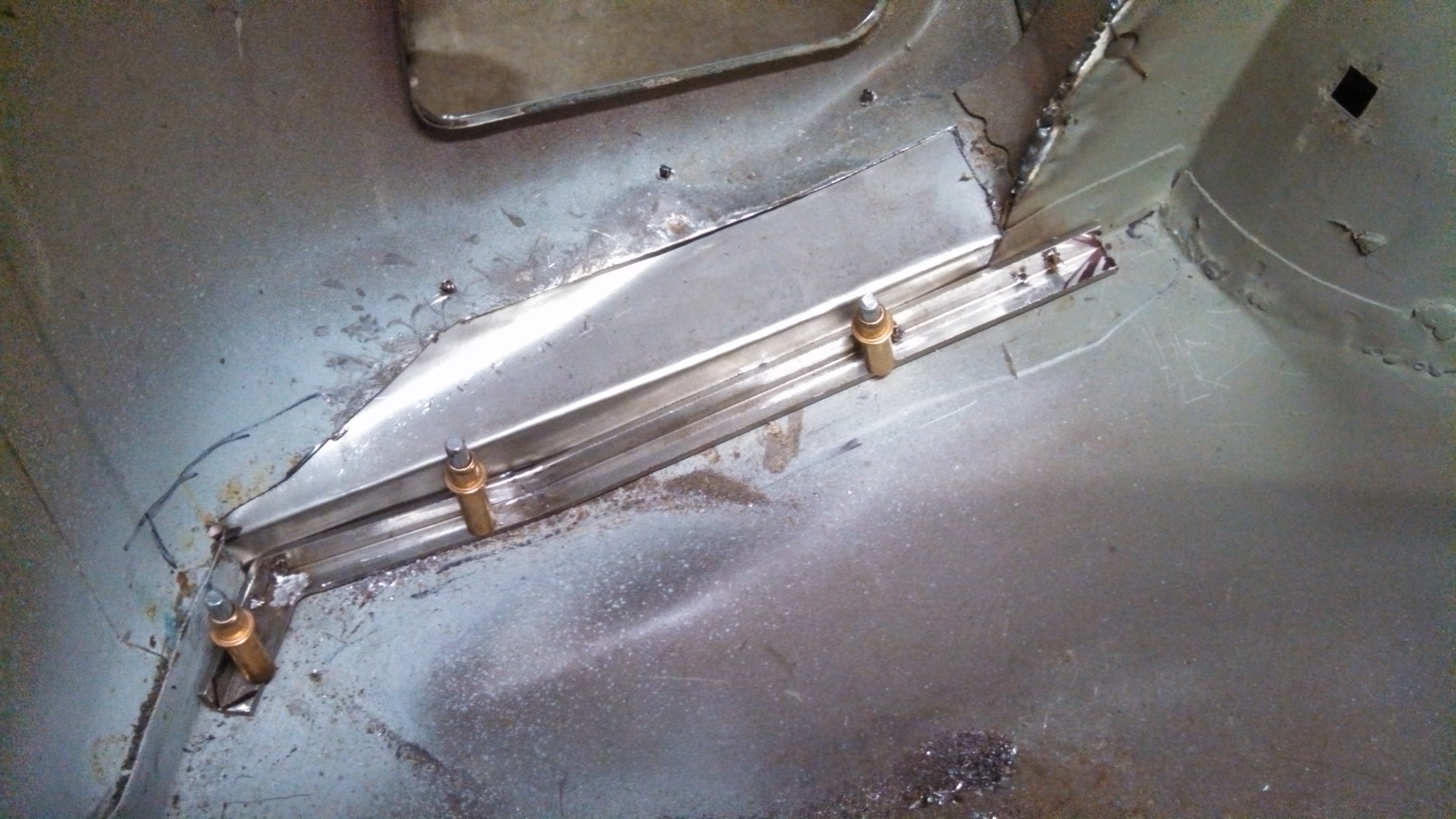

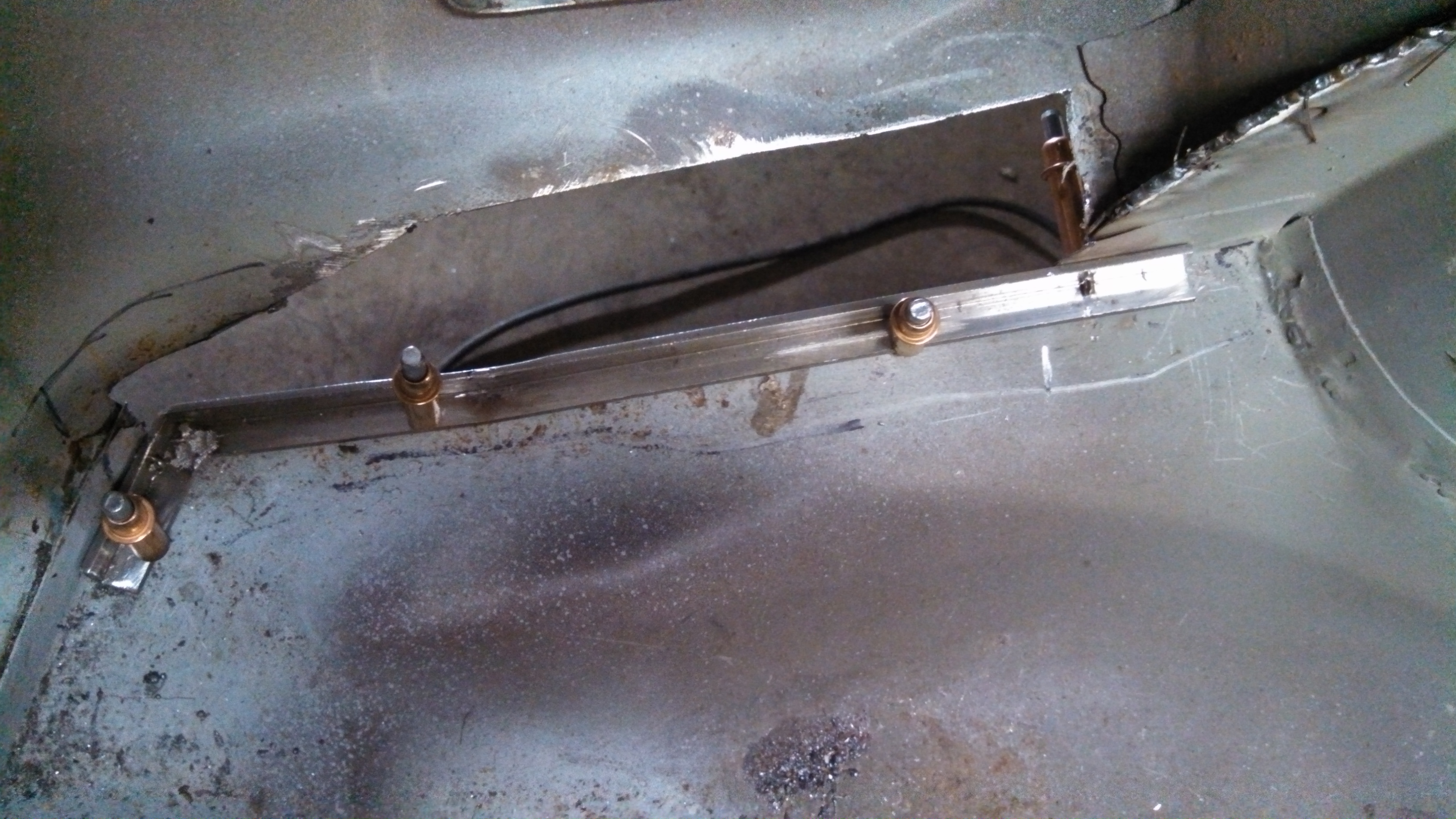

And lastly a pic of the top of the coupler nuts that were trimmed and welded into the rear subframe to mount the removable piece.
- rear sf removable nuts welded.jpg (1.83 MiB) Viewed 45754 times
