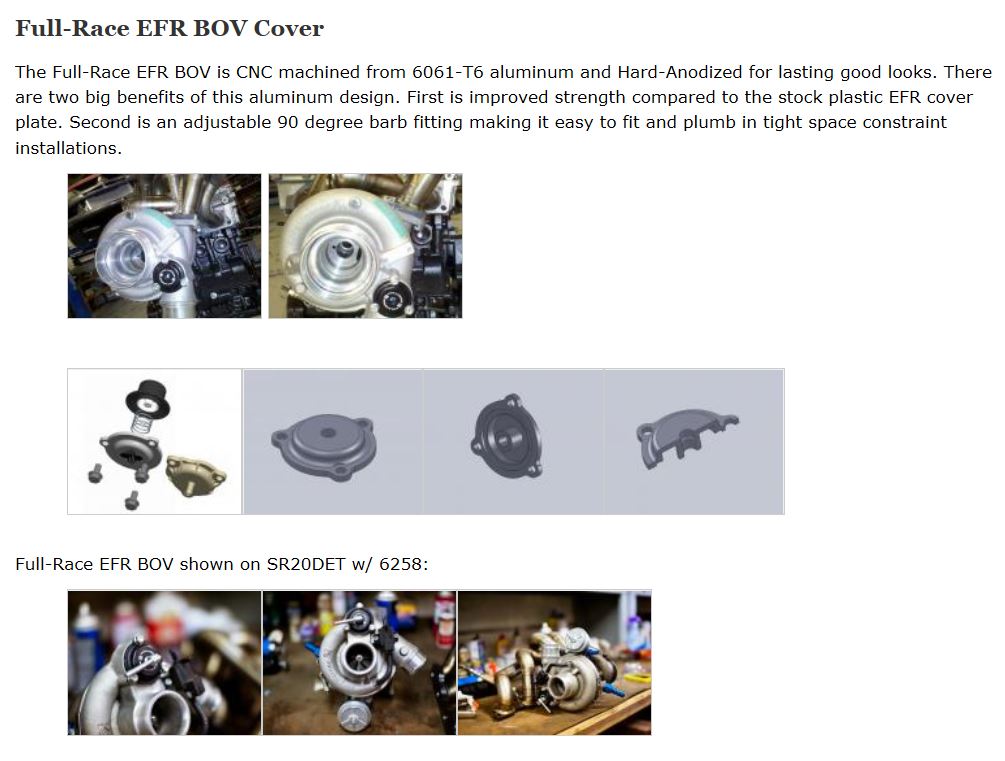

Two new do dads and gadgets for the turbo heading to Las Vegas...

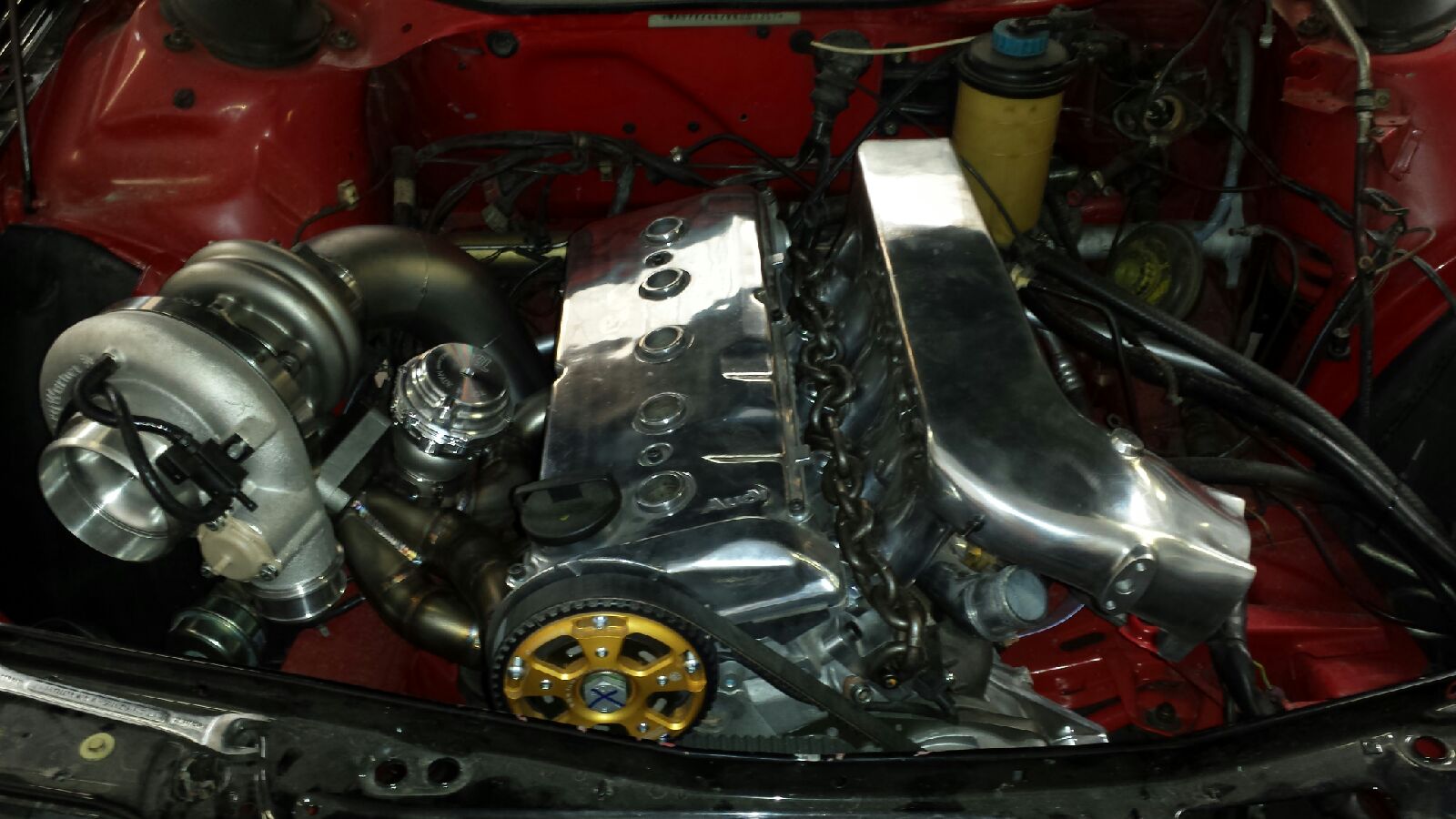

Using an RS2 intake? So you'll keep the conventional routing of the intake behind the head? Was curious to see how the Wagner would interact with the radiator.

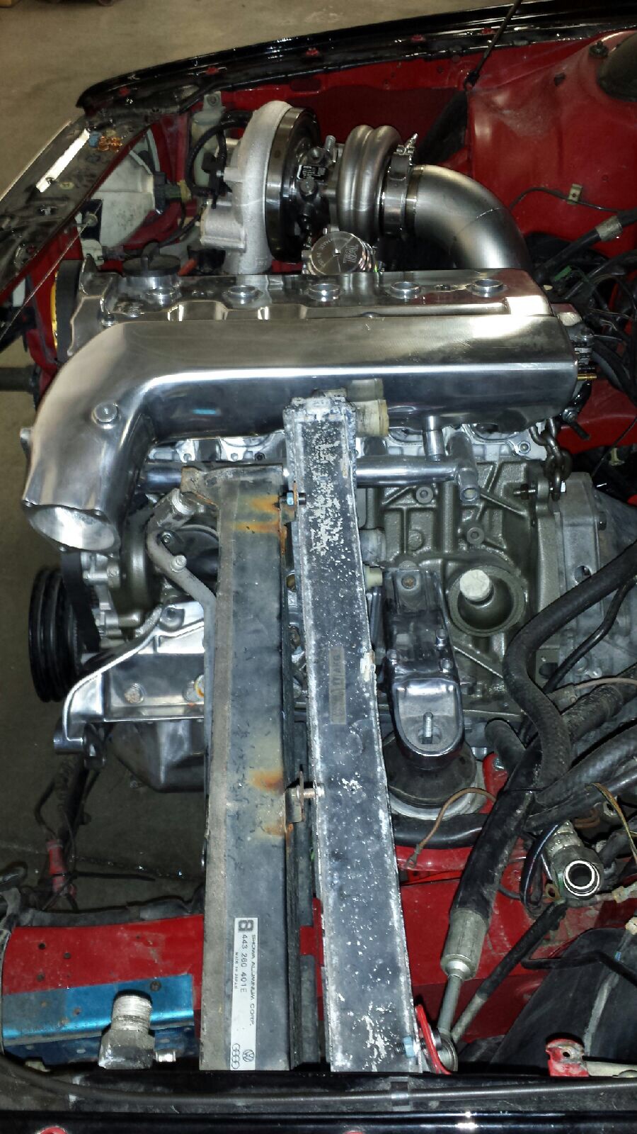

Keeping the Wagner intake. Moving the radiator and a.c. condensor just behind the throttle body, using a RS2 water manifold

I don't have the ABS in the way, the bomb, and I did a vacuum booster conversion so there is more room now. A picture can describe it better. This will give you an idea of how it will be but just with the old radiator. I like not having to route the intake behind the motor. I figured the farther it stays in the front of the bay, the cooler and the shorter the route, the better.

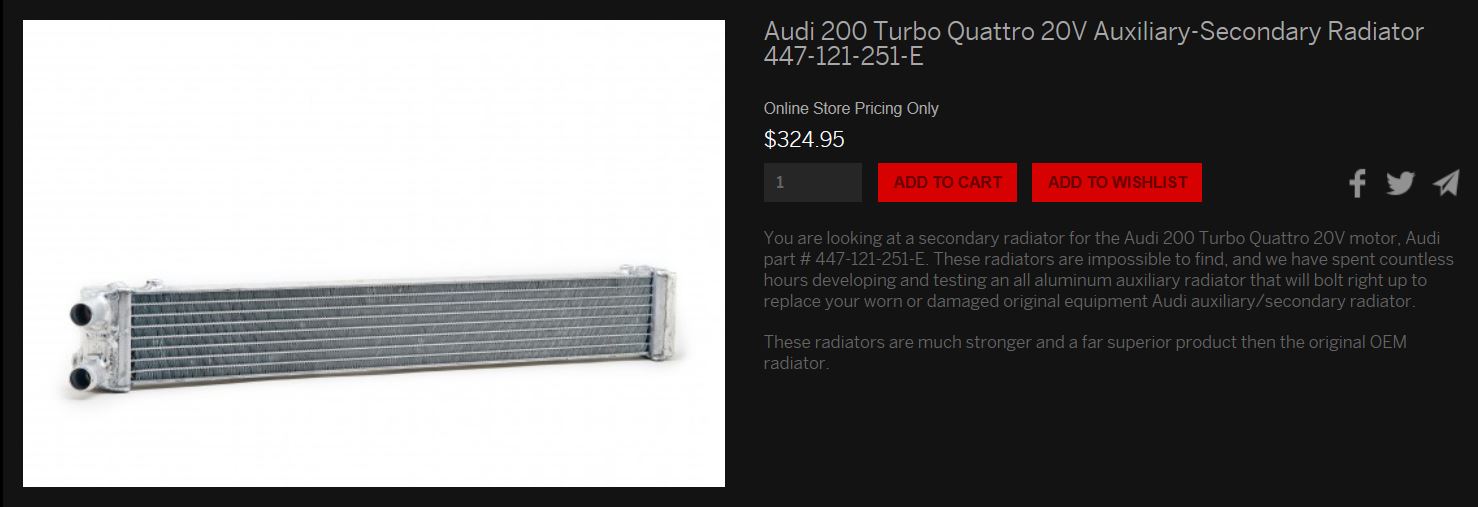

Got this for extra insurance while stuck in stop in go traffic with the A.C. running on a hot Texas day. Supposedly it looks better in the picture than in person. Oh well, as long as it does it's job. Zero3motorsport said they quit making them several years ago and I happened to get the last one that was forgotten in their warehouse.

2.5TYPE44 wrote:Got this for extra insurance while stuck in stop in go traffic with the A.C. running on a hot Texas day. Supposedly it looks better in the picture than in person. Oh well, as long as it does it's job. Zero3motorsport said they quit making them several years ago and I happened to get the last one that was forgotten in their warehouse.
Definitely took mine off this past fall and have it laying in the basement along with all the mounting hardware that you could've had....

Thanks for the offer. I thought about using a used one for about a week or so but after running into a radiator problem with one of my other cars, I decided new is the way to go. I have been trying to hold strong on not taking any shortcuts or using used parts. I don't want any issues popping up. I have a V8 quattro that has a good looking radiator but has about 10 holes in it. It appears that the aluminum oxidized and turned to mush over time. Some spots are really soft and some are brittle. Most of these factory aux radiators are probably close to twenty years old now.
