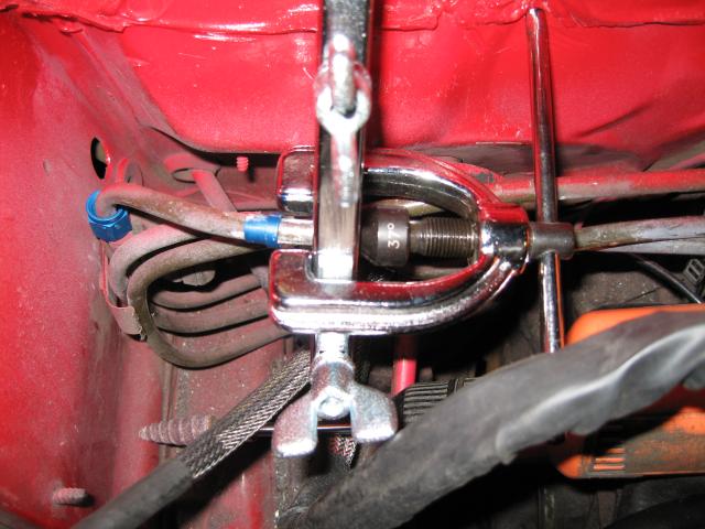

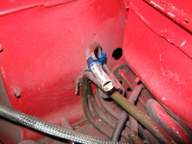

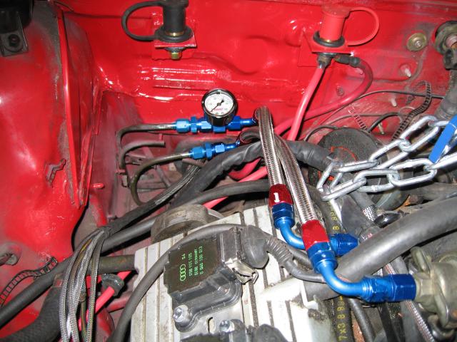

flaring the fuel lines
complete fuel line assemblies:

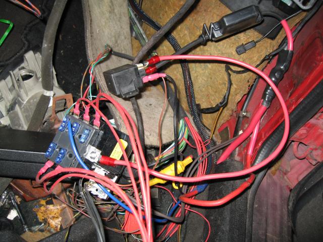

The two wires out of the 'b' harnesses needed to run to the ecu (fuel pump and ignition power):

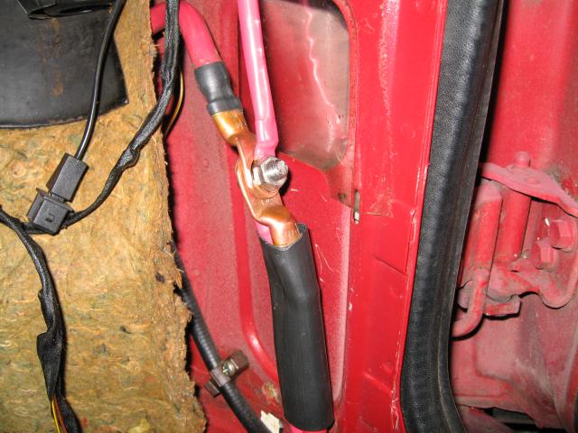

Big bad battery wire splice to junction for fusebox power and power to the 034 relay board:
All the basic components of the wiring setup. 75A relay to switch igntion power to an 8 gauge battery wire that runs my 034 relay board and other stuff. Whaddya know, turned the key and everything lit up, injectors click, etc. Yeeha!

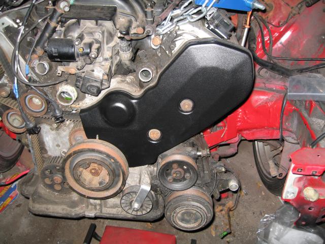

Decided on wrinkle black for the timing belt covers. Puuurrdy:

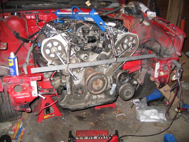

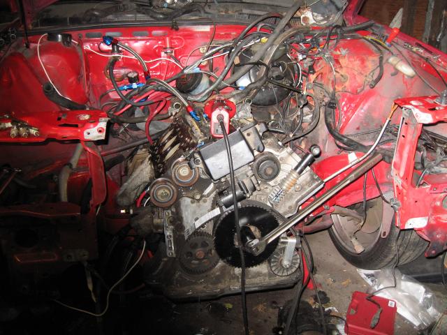

So the day started off ok, I bought some v8 timing belt tools so I could install the 60-2 wheel supplied by 034. Turns out neither of the cam locking tools I got fit the v8 so I.. improvised ;)
Coupla wrenches tied to the cam bolts seemed to do the trick nicely.

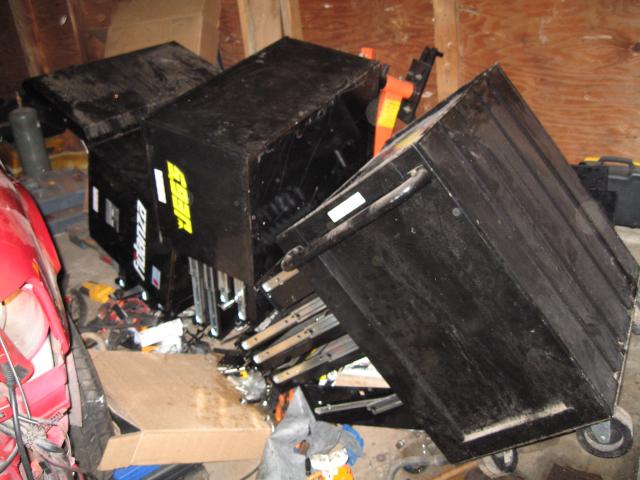

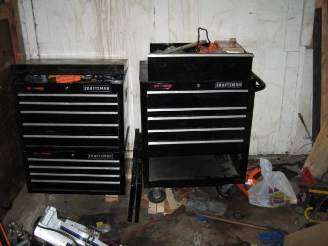

So in the middle of the job I went to go grab a sharpie out of my toolbox to mark the camshafts when I saw something moving in the corner of my eye as I started walking back toward the front of the car....
:curses: :frustrated: :curses: :curses: :curses: :frustrated:
Yah.. that would be my toolbox falling over.. Its what I get for using cardboard to compensate for the slope in the concrete. Theres been a lot of rain in this area recently and some water got into the garage, soaked the cardboard.. whamo! All in all I got away pretty lucky. The fender on the car got scratched up pretty bad and the bottom drawer of the toolbox is fubar but it coulda been worse..
So now the boxes sit more like this...
So anyway, back to this car project thingy.. I installed the pulley, hooked up the oil cooler, then realized I had removed the starter solenoid wire with the engine harness. oops.

Ronald G Wainwright+
Post by Ronald G Wainwright+ »
Hey Marc as I'm sure your awair "it could have been worse".
But let me guess...you got the cam lockers for the A8 motor?
& you have balls of steel to have that setup. Looks like vise grips holding those wrenches? At least the belt is still on. Nice in a way reminds of something you may have consulted Huw Powell on :)
looking good though, sept that tool box.

a4kquattro wrote:Turns out neither of the cam locking tools I got fit the v8 so I.. improvised ;)
Not quite sure what those do for ya?? Those bolts/pulleys must come off in a timing belt job, otherwise you'll end up with slight cam errors relative to both the crank, and the other bank. You've gotta lock the cams from the rear distributor locations, then pop both front pulleys so they freely rotate on the cams, then tension the belt with everything locked, then tighten the cam pulleys down. :wink:
Eh? I dont see how I could have messed up on this. The cams did not move, nor did the crank during this procedure. Belt off, belt on, nothing moved.

a4kquattro wrote:So in the middle of the job I went to go grab a sharpie out of my toolbox to mark the camshafts when I saw something moving in the corner of my eye as I started walking back toward the front of the car....
Sh*tty my tool boxes are a bit wobbly too. :D

In other news, anybody got a set of v8 timing belt covers for sale? Long story.. but I f'd up the passenger side cover (I'll blame it on the falling toolbox, yah, thats it...)
Oh Marc I just gave away (literaly) the pass side cover 2 days ago. But I do still have a driver side. It's yours if you need it.

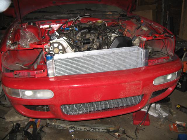

Meanwhile, I tried test fitting the radiator and bumpers, looks like I gots the wrong radiator :-/
Its very close to the one Nate ran but slightly wider, wide enough so that I'd almost have to hammer it between the headlight slats to make it fit. I ordered up one of these instead, which is narrower by about 2.5", but otherwise the same dimensions:
Summit PN SUM-380328 (27x19.5x2.25)

Alright, interesting happenings today. Here are some radiator test-fit pics from last weekend when I figured out the one I ordered is a little too wide

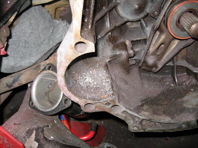

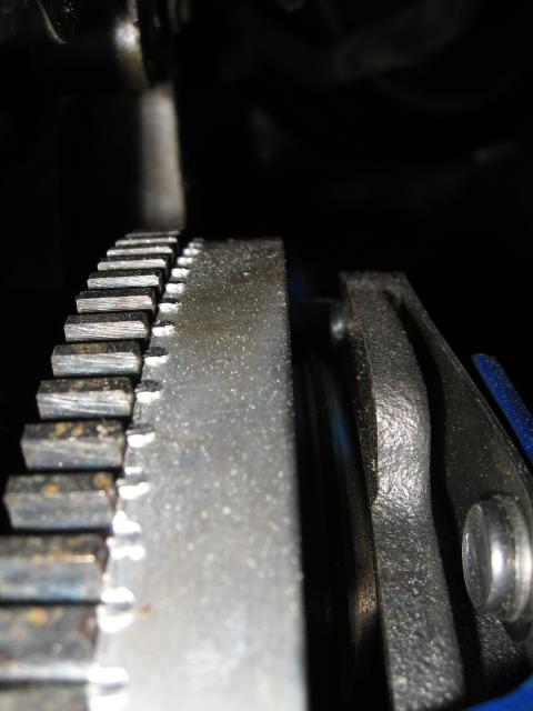

Fast forward to today. I really wanted to get the car started today but ran into an interesting snag. I noticed that the starter was working harder than it should have been. I at first attributed this to a dead battery so I borrowed a friend's 150amp starting cart while I got the VR sensor dialed in. Problem was, the starter was STILL slow even when cranked up to the starter cart. I started to panic when I noticed that the crank was REALLY hard to turn over (I measured 160 ft lbs to just turn the engine over). I pulled the plugs and the effort of rotating the crank was the same. feck I'm thinking, I bent the valves (this is after I had pulled the crank pulley to install the 60-2 wheel, and I discovered I didn't follow the right procedure for maintaining valve timing). So the next logical step was to try to peek at the intake valves with the manifold off to see if any of them were bent. So I pulled the manifold, they all looked fine.

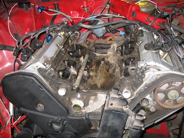

So next up, I pulled the heads to take a closer look:
All the valves are fine (phew!) but the crank is still WAY too hard to turn. :wtf:
So at this point, I pulled the motor figuring there had to be some kind of problem on the flywheel end. Hmm, what's that in the bell housing there?
Metal shavings in the starter hole? hmm..
All making sense now. It appears that my brand new starter motor in the fully extended position extends past the steel flywheel teeth. That normally wouldn't be a problem, except that the v8 aluminum flywheel isn't machined so that the teeth can pass harmlessly by. What was happening was the starter was sticking in the extended position making it very difficult to crank the motor by hand (basically fighting the windings on the starter). Not sure if I'll have the flywheel milled down or if I'll just make up a spacer for the starter motor so it doesn't extend quite so far out yet.
Sooo, the fact that I've now had to pull the heads on this car makes for a change in plans. Yo J, we need to talk turbos, stat ;)

Doh! Damn Marc, you don't mess around! Very odd, haven't seen this on the flywheels yet, any idea what dimention could be off? Look like you could throw the FW in a lathe and remove some of that material to clear the teeth, or a small spacer to move things out, interesting.

JShadzi wrote:Doh! Damn Marc, you don't mess around! Very odd, haven't seen this on the flywheels yet, any idea what dimention could be off? Look like you could throw the FW in a lathe and remove some of that material to clear the teeth, or a small spacer to move things out, interesting.
The teeth either need to be 'longer', or the flywheel should be machined down so that the valley on the flywheel teeth extends a bit further, about an extra 1/4" or so.
Since I dont have a lathe handy I'm probably going to go for option #2. No biggie, but figured you guys should know for the next run of flywheels.

Geez Marc, you know how to make a guys hart jump a beat or two. Even though it's not my motor anymore I still feel it an extended part of the familey. I started to feel faint but glad to have kept going & read that the motor was OK(you should add a Phew emoticon).
But let me see if I can understand. So the starter teeth were extending past the flywheel teeth & binding obviousley on the top of the flywheel & couldn't return cause of the binding?
?, if you make up a spacer for the starter will you need longer starter bolts?
& why did this happen?
