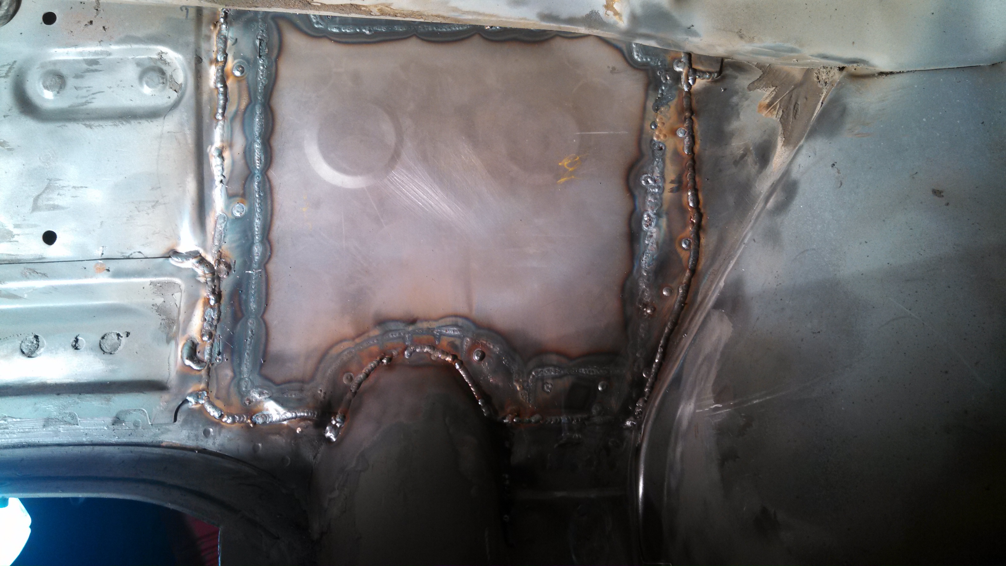

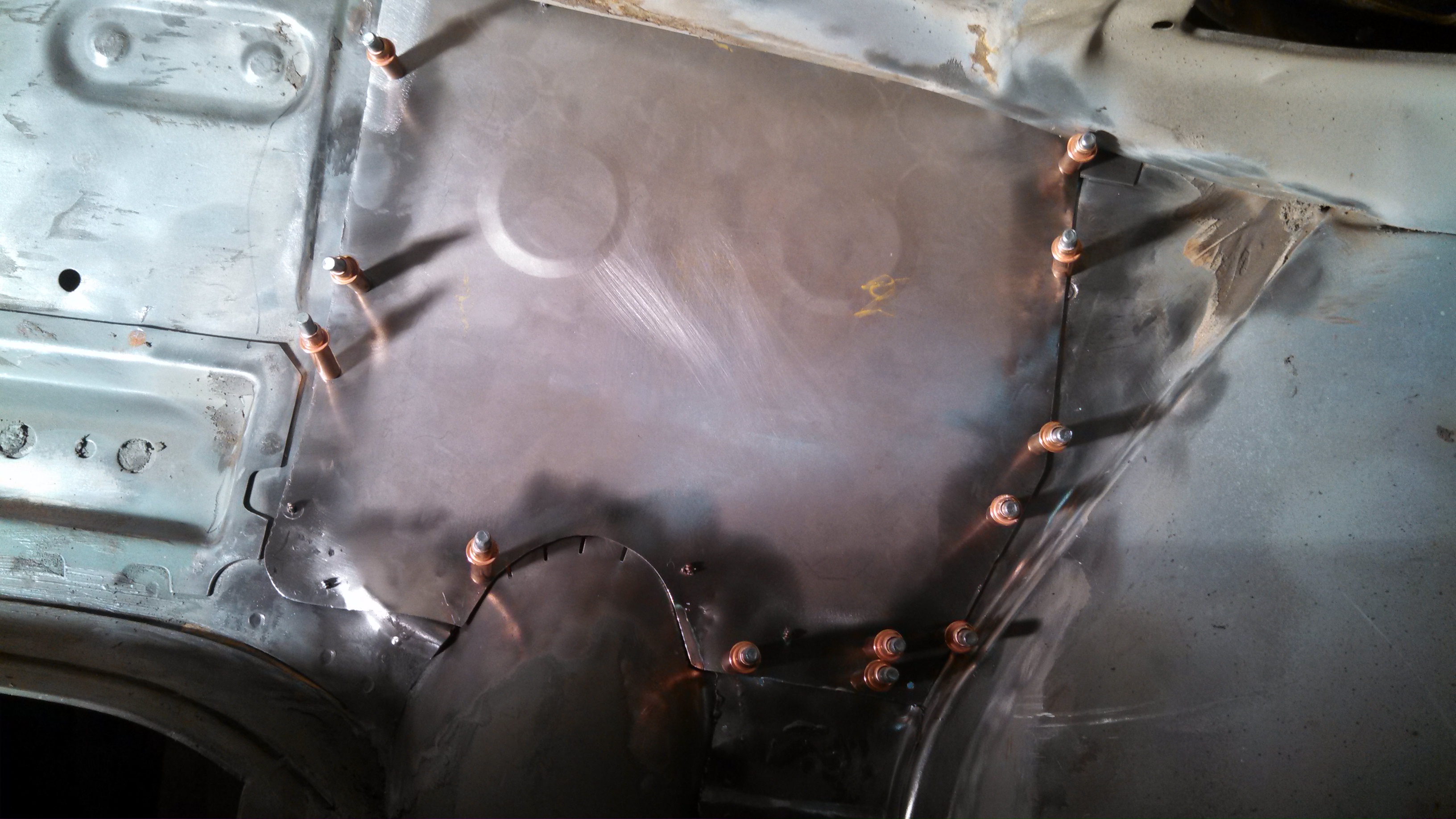

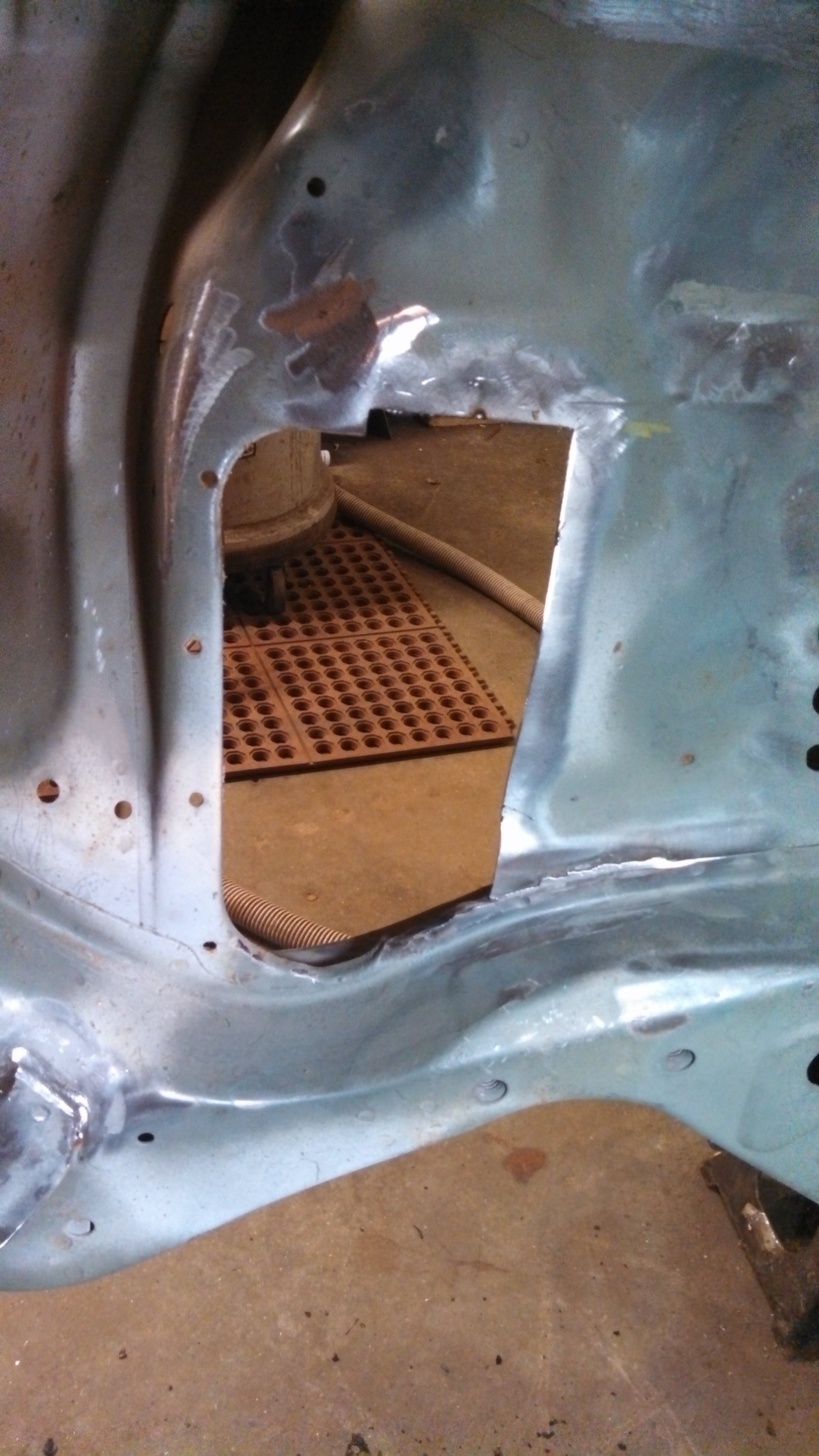

UPDATE!!!!

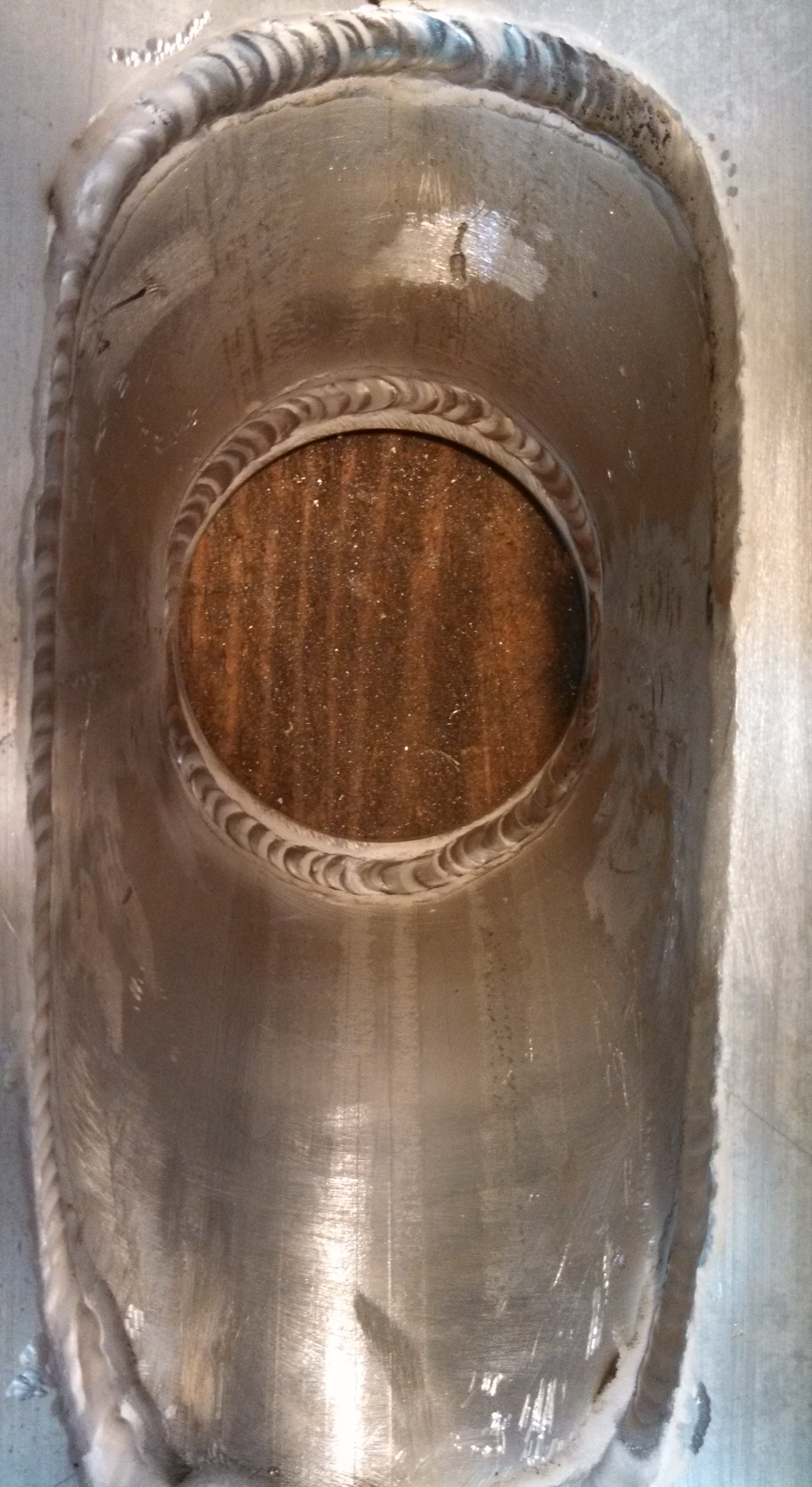

I got the DP relief area cut out and prepped for welding
DP relief area to be filled.jpg (1.61 MiB) Viewed 39016 times
DP relief area to be filled2.jpg (1.88 MiB) Viewed 39016 times
dp relief ready for final prep.jpg (1.38 MiB) Viewed 39016 times

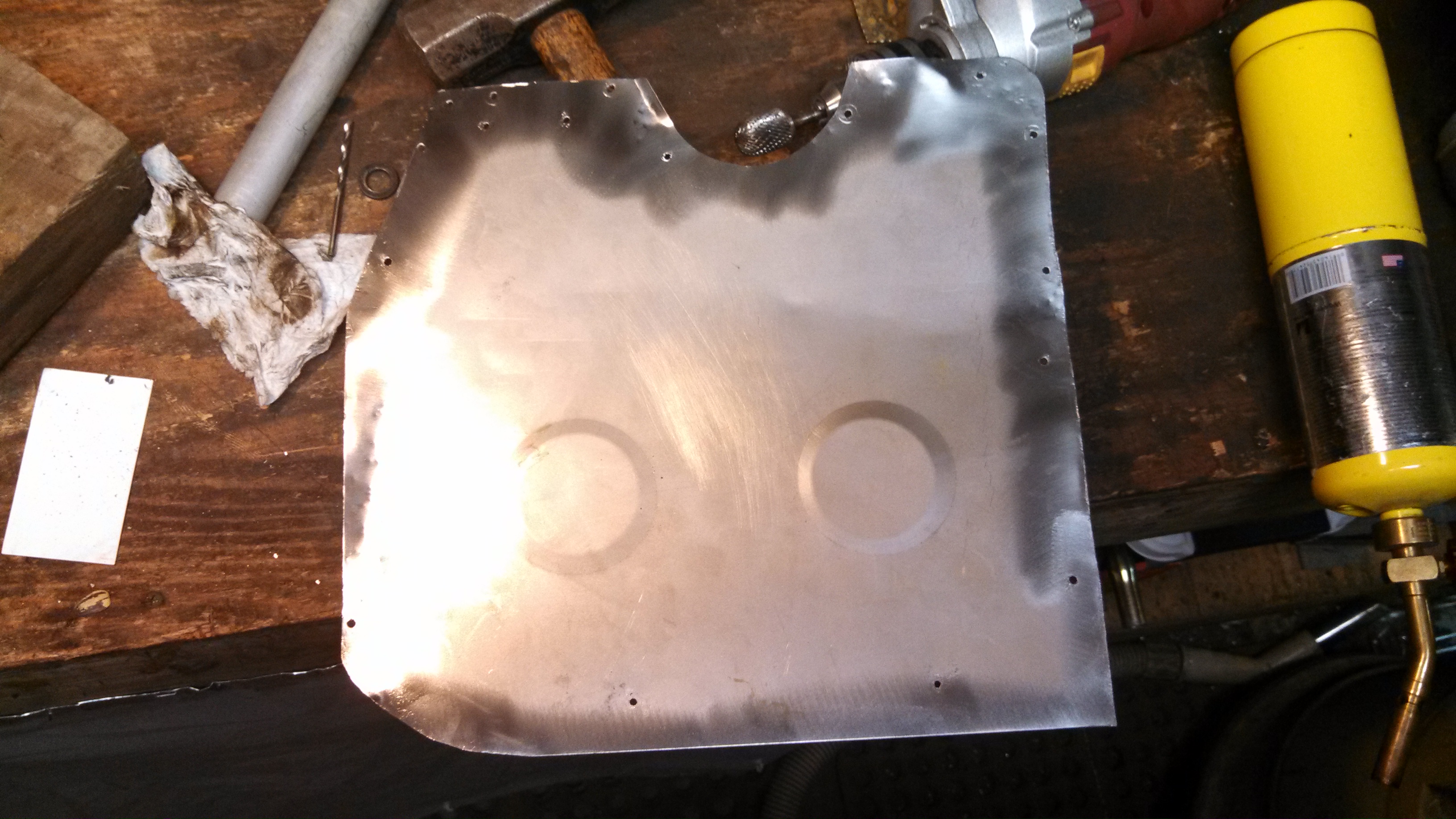

I put a pair of simples in the sheet to help strengthen it.
DP relief dimpled.jpg (1.64 MiB) Viewed 39016 times
Here it is all prepped and ready for welding.
DP relief ready to weld bayside.jpg (1.21 MiB) Viewed 39016 times
Re: 24vVR6T CQ Project: EATSGTR, chassis FAB
more
DP relief ready to weld inside.jpg (1.44 MiB) Viewed 39016 times

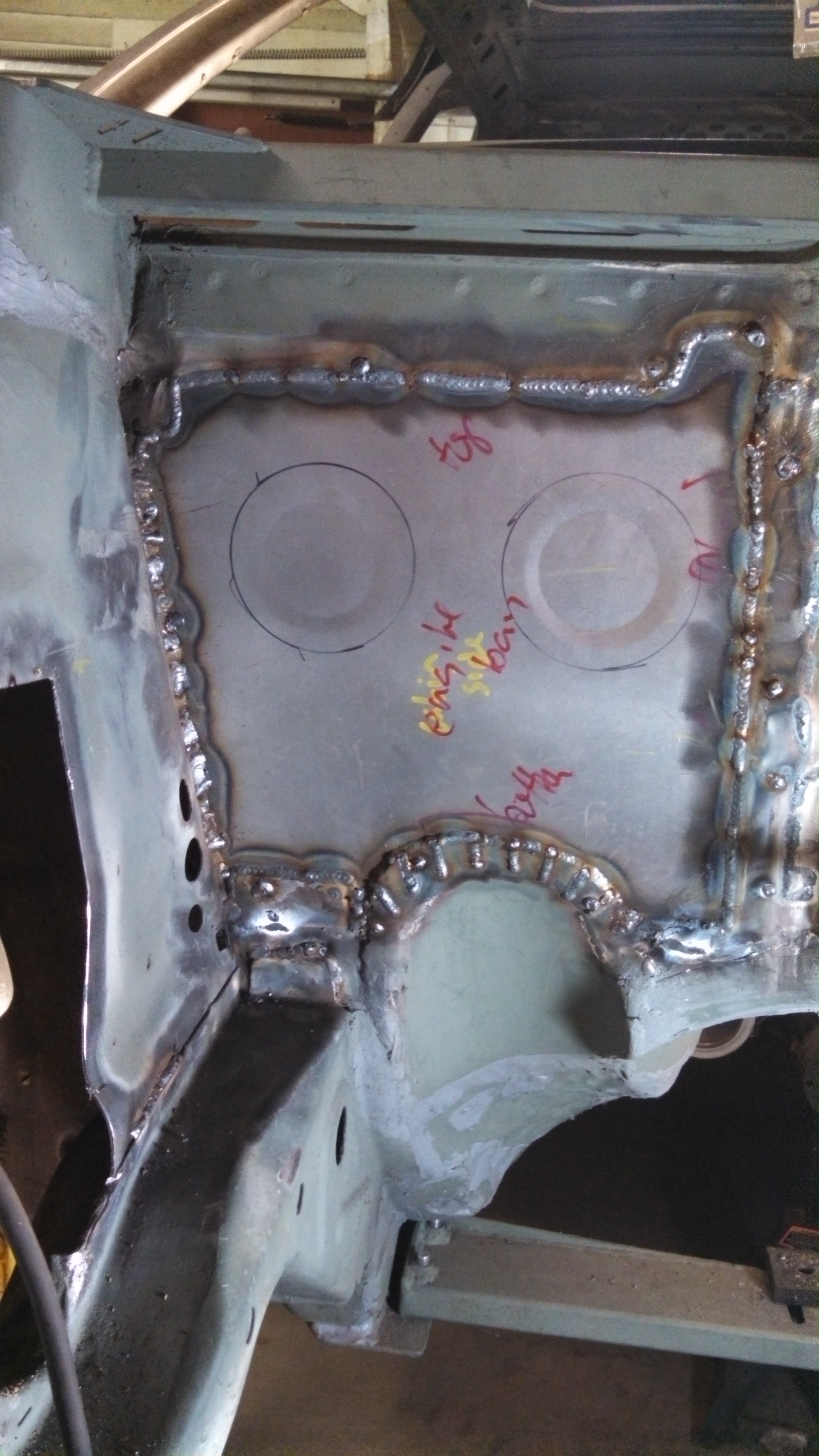

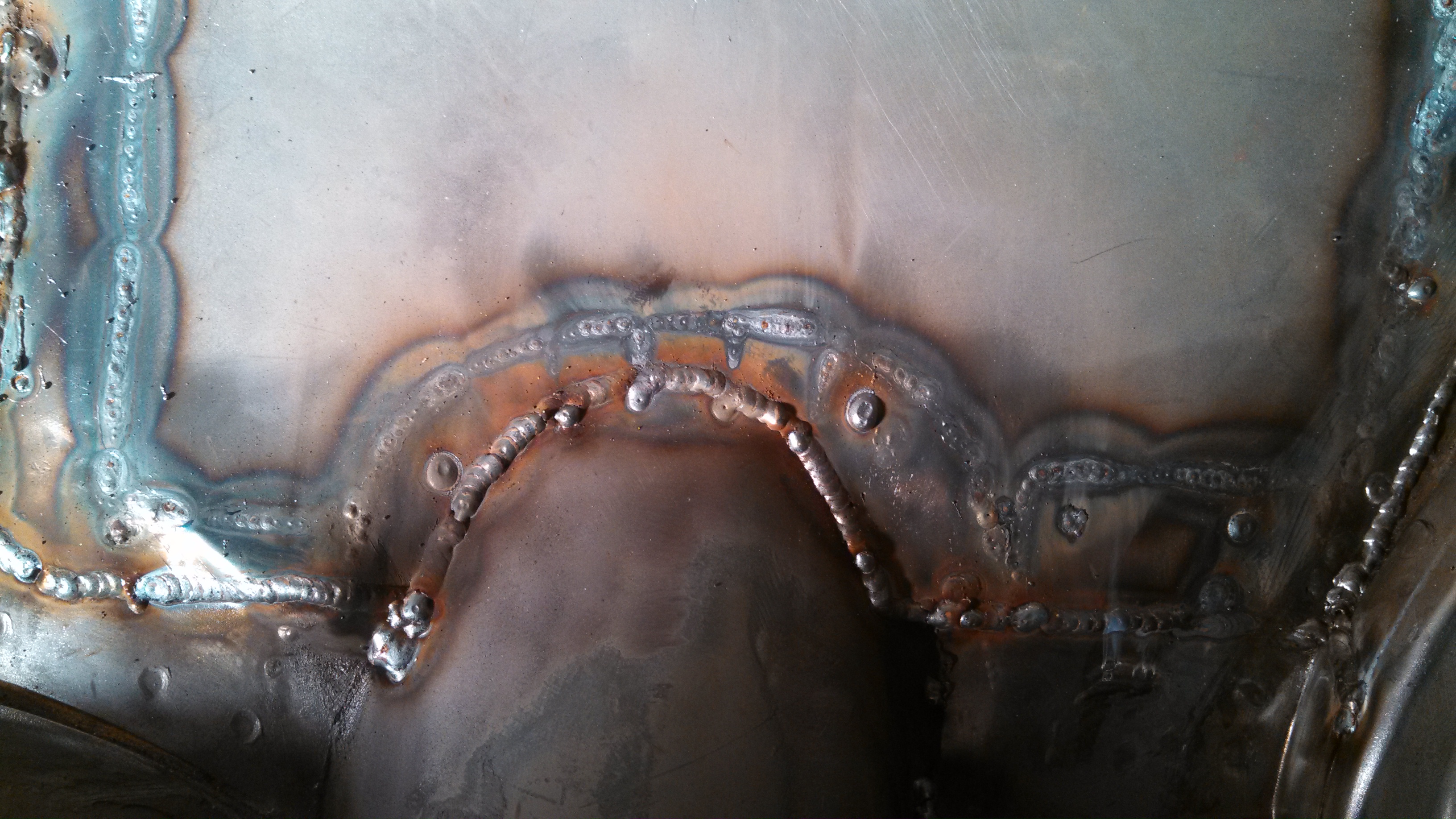

All welded up, getting a lot better with sheet metal.
DP relief welded engine bay side.jpg (1.49 MiB) Viewed 39016 times
DP relief welded engine bay side upclose.jpg (1.57 MiB) Viewed 39016 times
DP relief welded inside cabin.jpg (1.45 MiB) Viewed 39016 times
DP relief welded inside cabin upclose.jpg (1.74 MiB) Viewed 39016 times

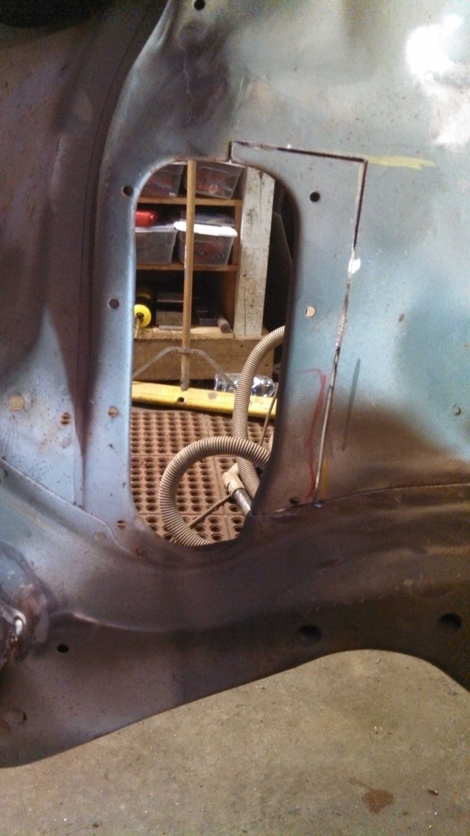

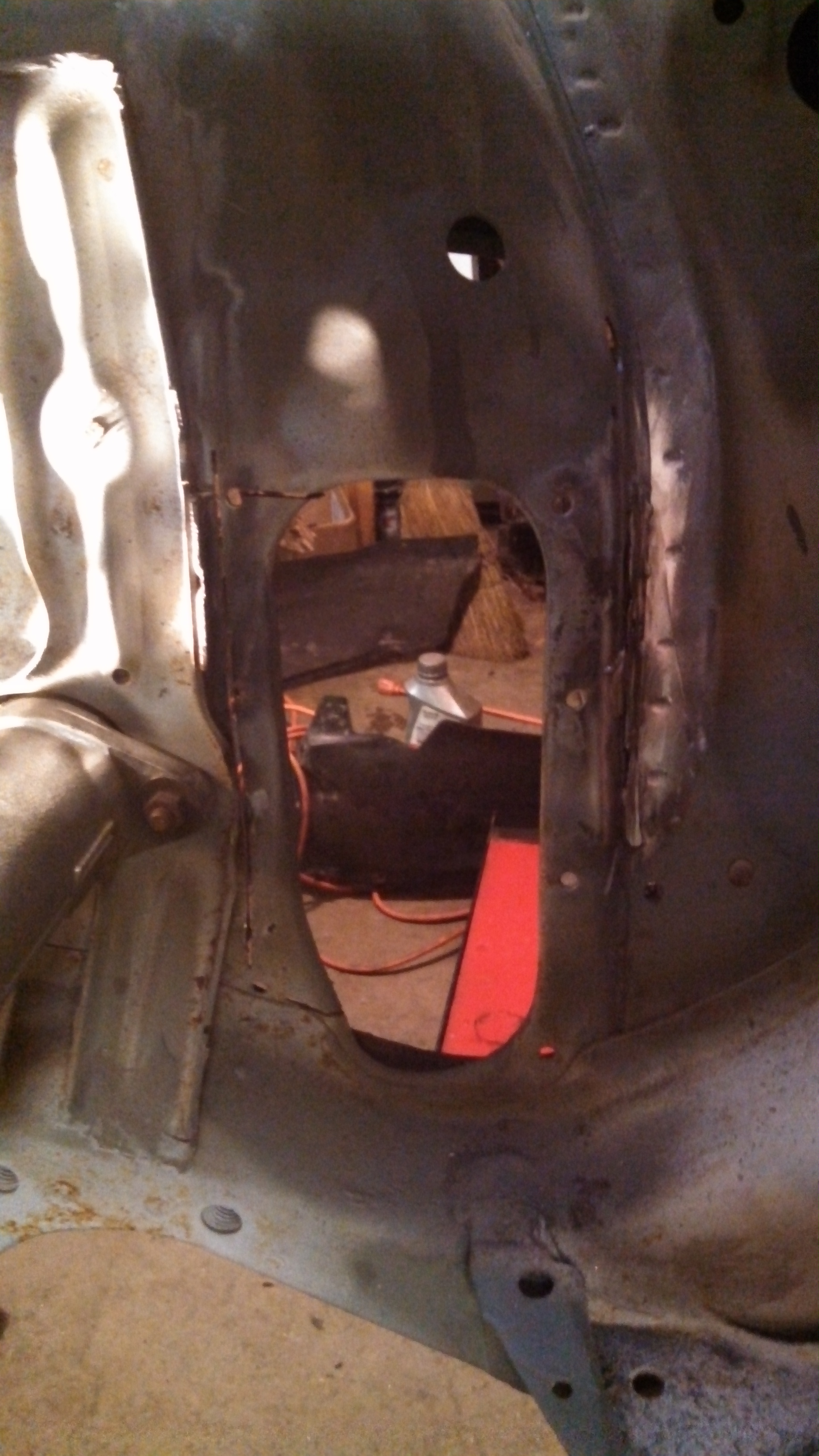

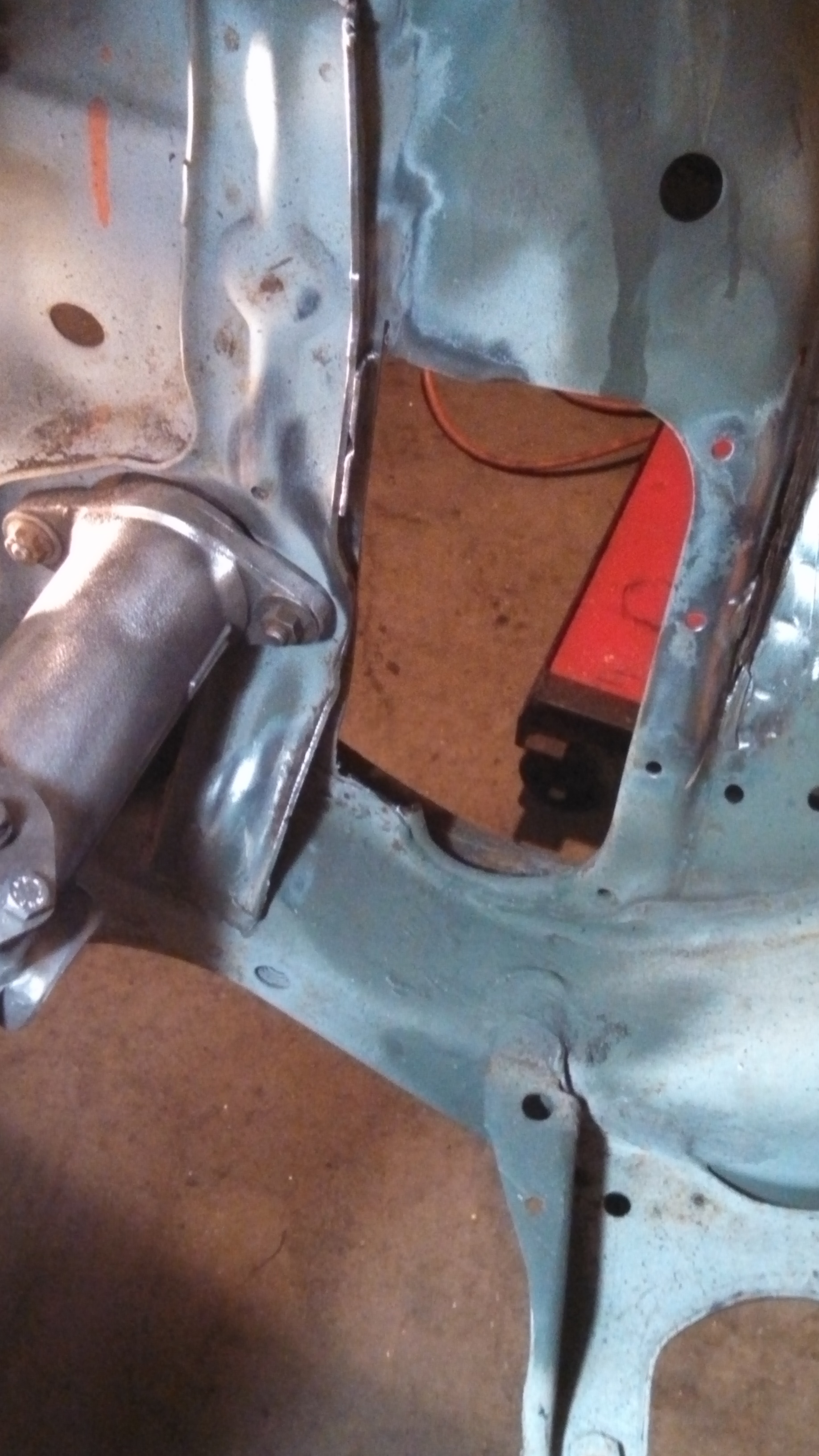

UPDATE!!
Since I’m running HT Motorsport steering arms on my uprights, the steering rods themselves have several different setup positions. In order to be able to utilize the full range of adjustment, I needed to open up my steering arm holes in the chassis, and move the rearward a bit.
Cutting them out.
cutting out Drivers steering arm hole.jpg (1.24 MiB) Viewed 39016 times
cutting out pass steering arm hole.jpg (1.39 MiB) Viewed 39016 times
Here they are, now in larger format ahah
drivers side steering arm hole cutout.jpg (1.09 MiB) Viewed 39016 times
pass side steering arm hole cutout.jpg (1.41 MiB) Viewed 39016 times
And here are the pieces that will get cleaned up, and welded back on a bit further rearward.
steering arm holes surrounds cut out.jpg (1.77 MiB) Viewed 39016 times

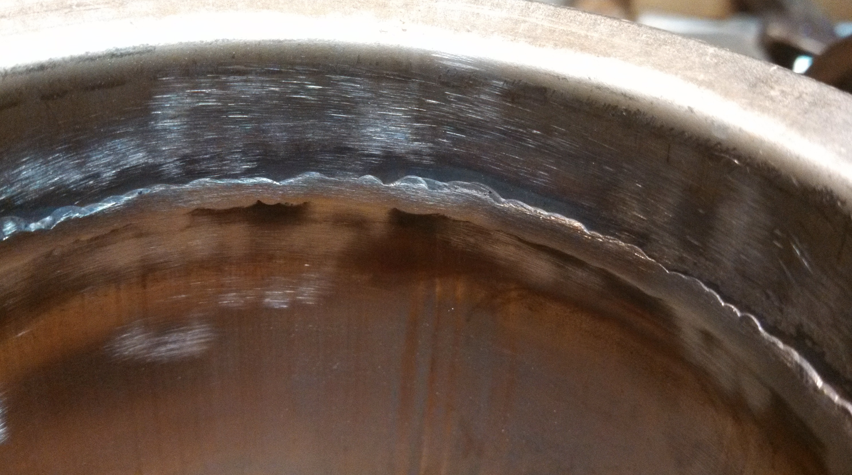

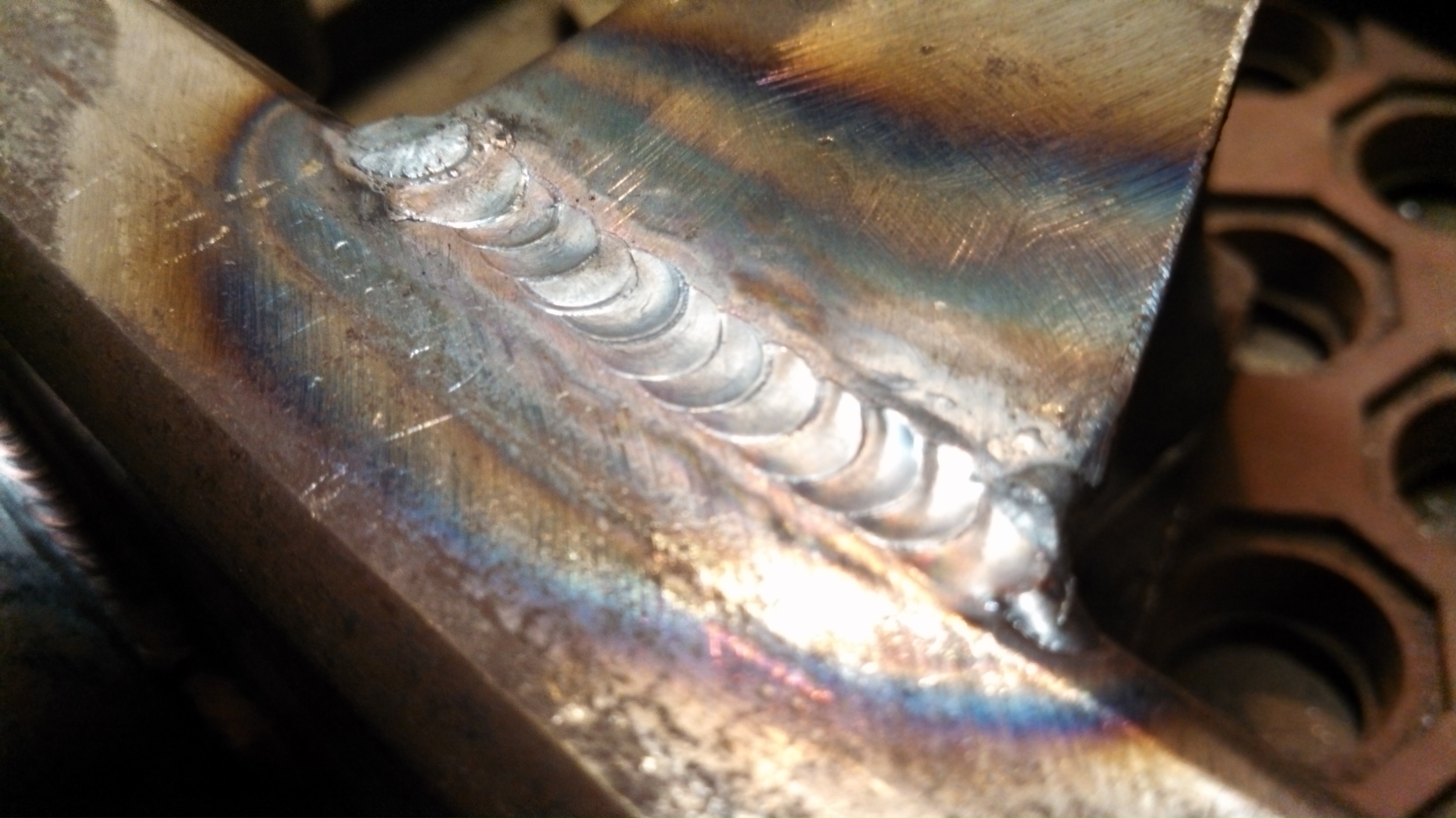

I had Ryan seam weld the inner and outer where the DP meets its v-band. I hit the inside with a carbide bit and then flappered it to clean it up a bit, all in the name of FLOW!!
dp inner cleaned up.jpg (1.62 MiB) Viewed 39016 times
dp inner cleaned up detail.jpg (1.58 MiB) Viewed 39016 times

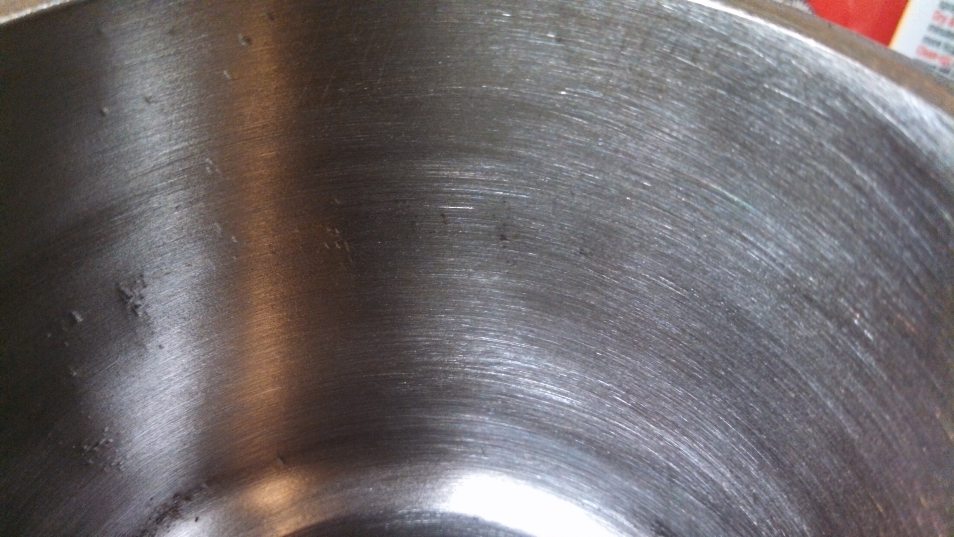

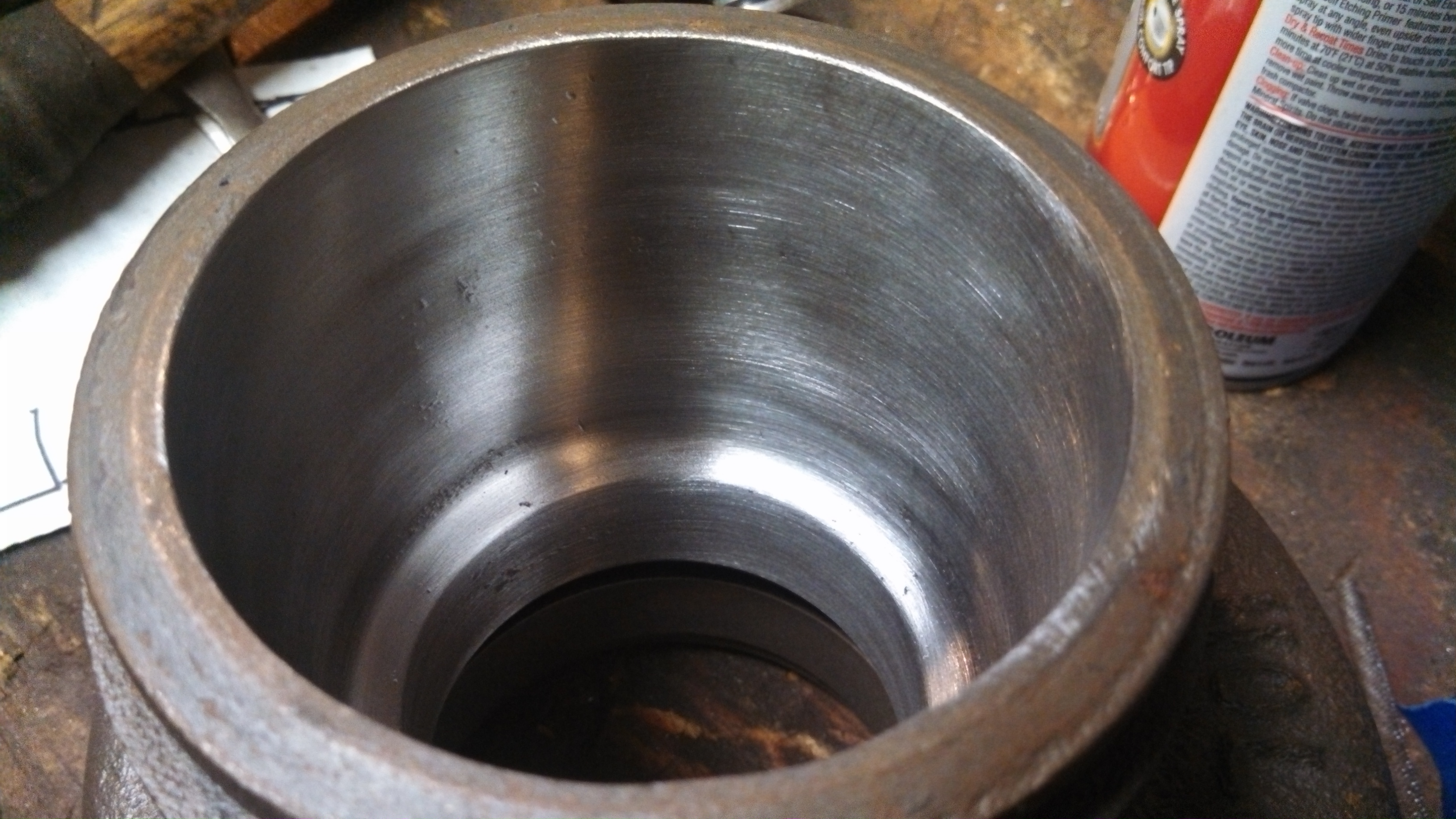

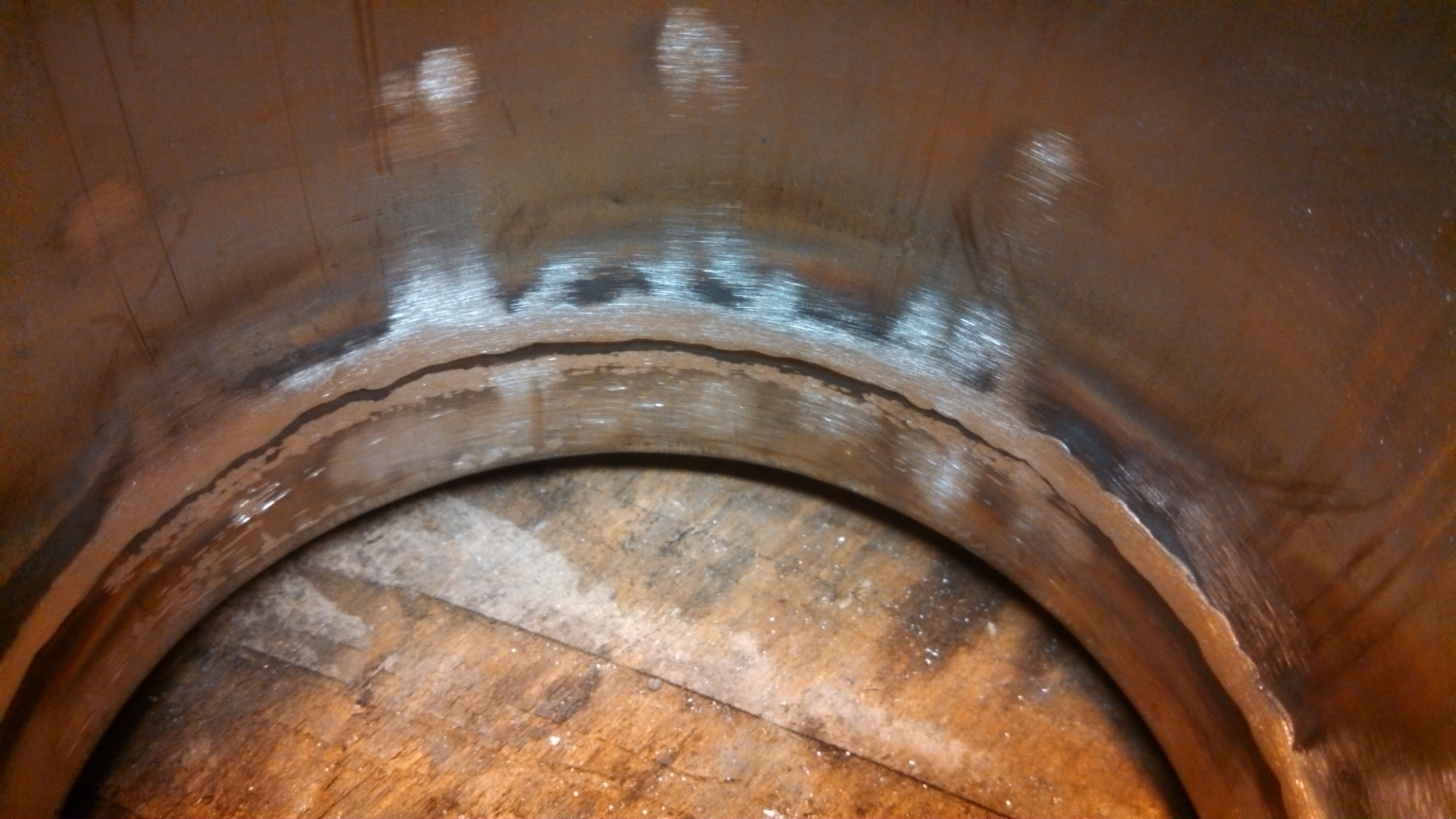

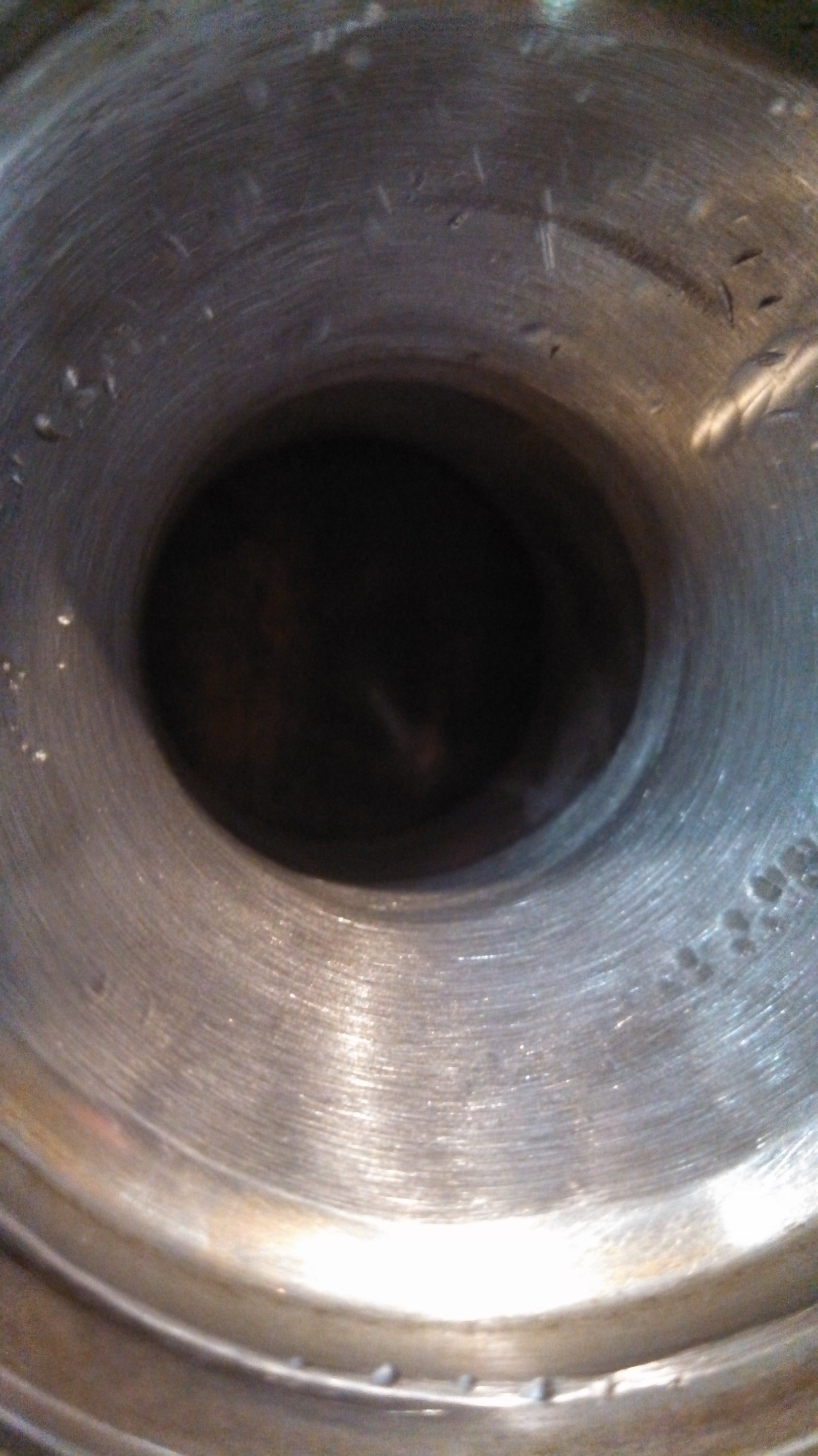

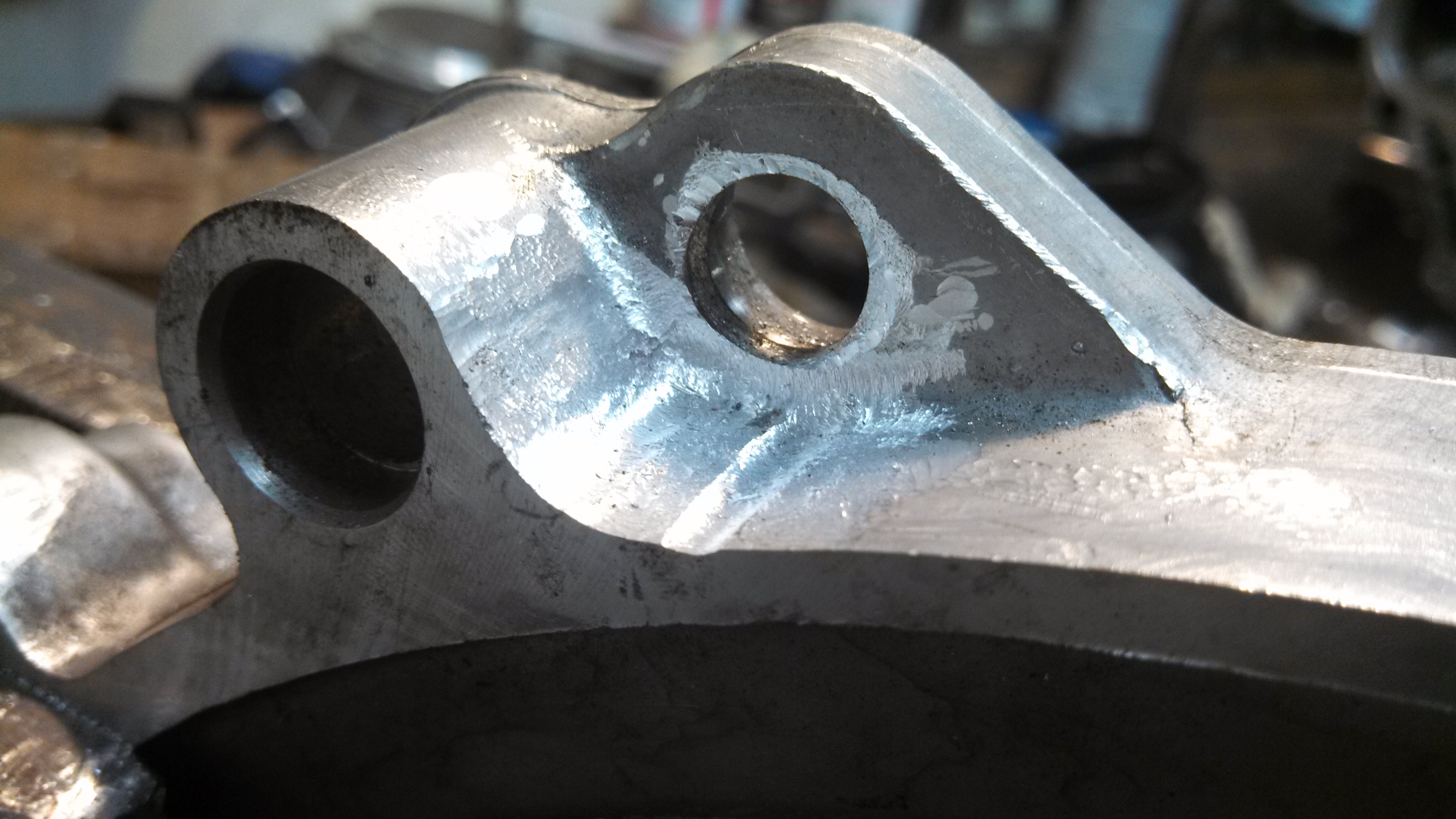

I also removed all the casting marks and cleaned up the inside of the Holset hotside. It’s now all nice and shiny, needs a bit more polishing but its 95% there
hotside cleaned up.jpg (1.53 MiB) Viewed 39016 times
hotside casting cleaned up detail.jpg (1.51 MiB) Viewed 39016 times

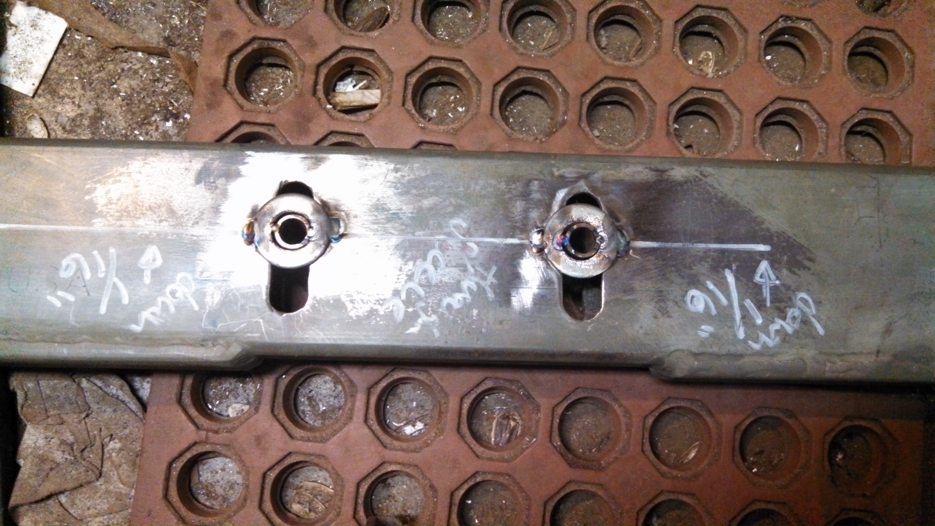

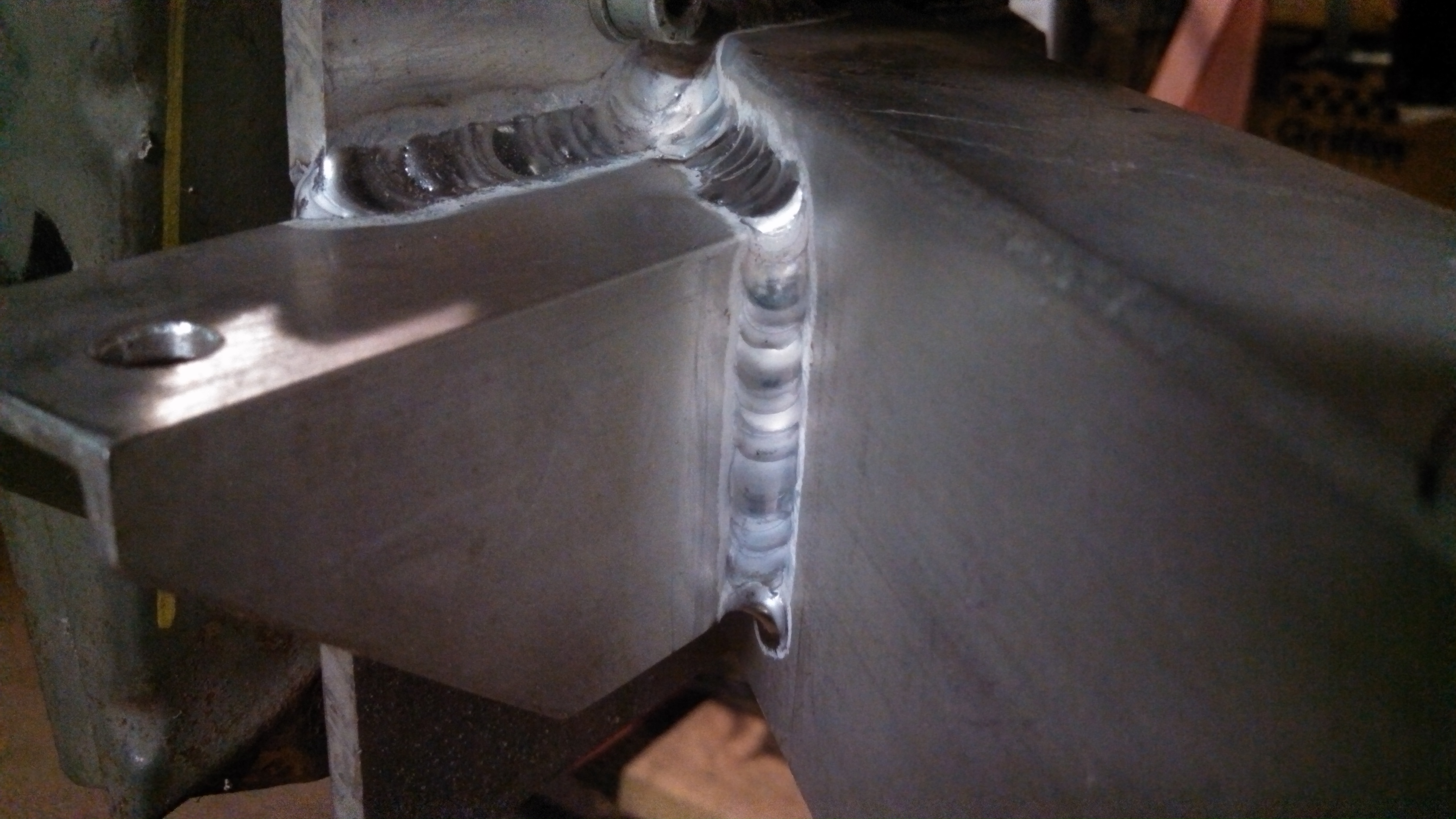

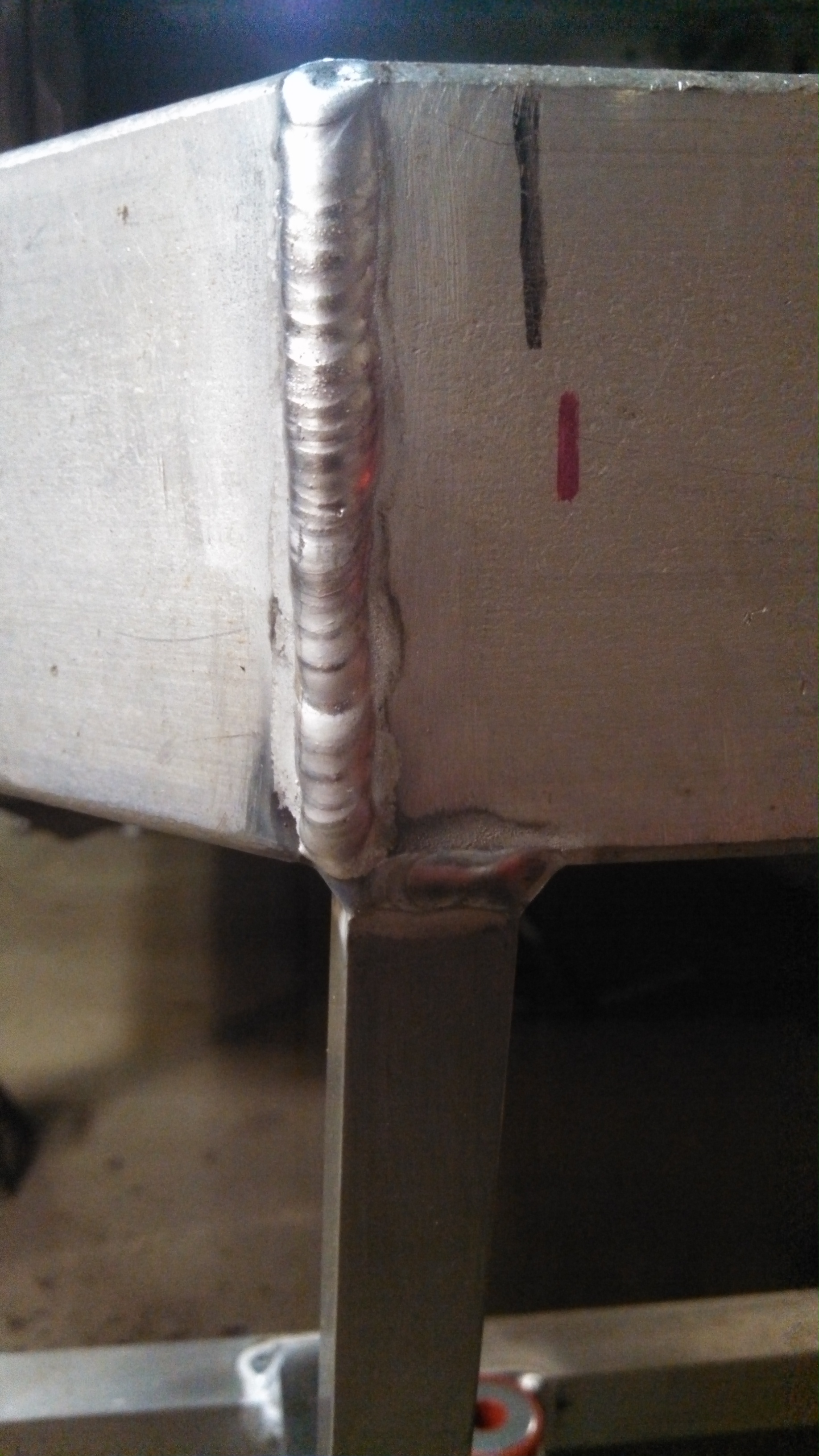

I got my front x-member back from Ryan after having the majority of the tacks seam welded. I also got the vertical pieces on that will support the lower IC. Radiator mounts are fully welded as well.
Main bar ad IC supports weld detail.jpg (1.3 MiB) Viewed 39007 times
radiator mounts and ic support bar.jpg (1.15 MiB) Viewed 39007 times
radiator mounts and ic support bar2.jpg (1.48 MiB) Viewed 39007 times
I still need to do some verticals for the far sides of the lower tie bar and some lower IC mount tabs. And lastly carbide out the through holes for upper IC mounting so they can be sleeved and welded.
Radiator mount weld detail.jpg (1.27 MiB) Viewed 39007 times
radiator mount weld detail2.jpg (1.23 MiB) Viewed 39007 times

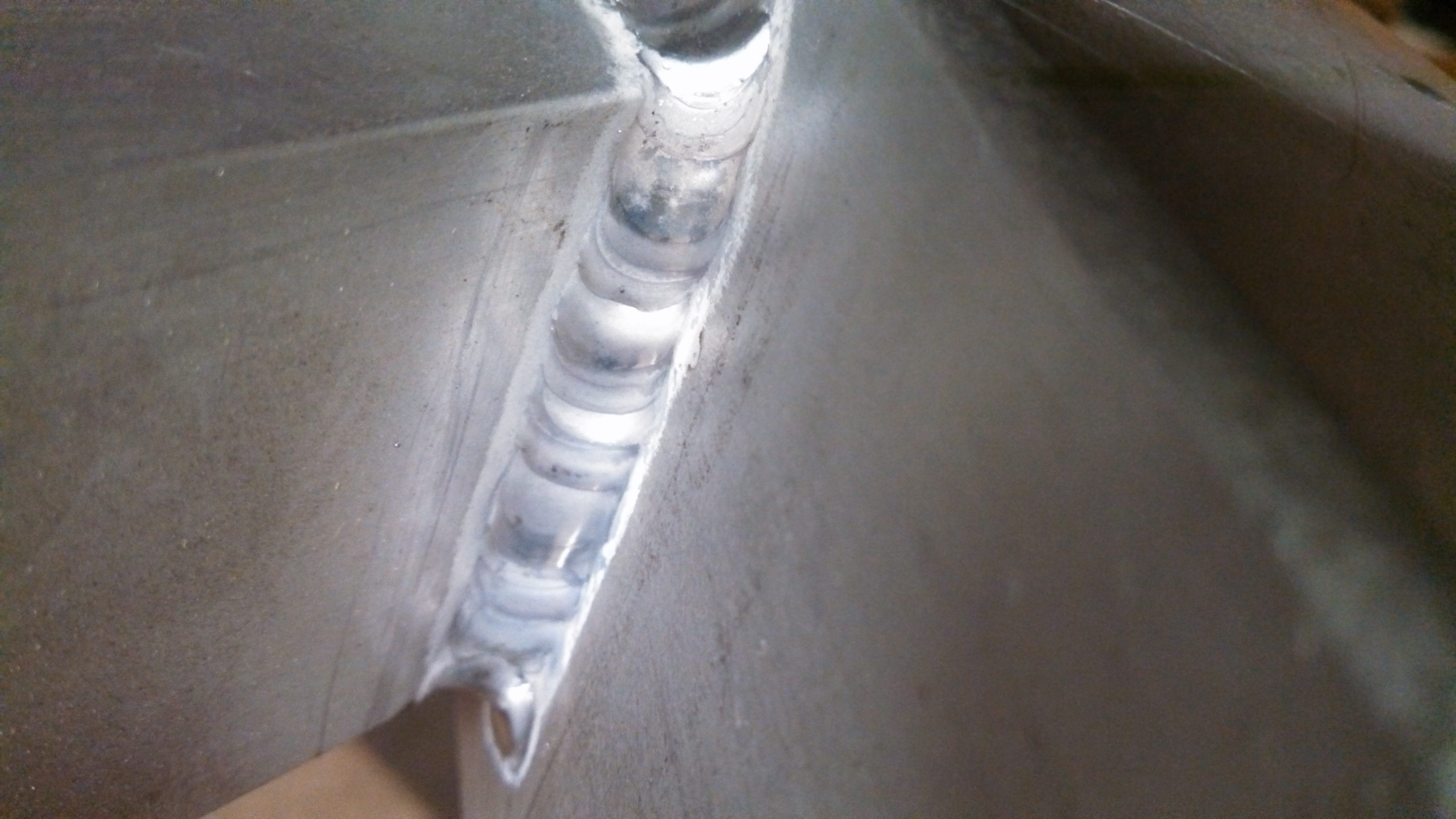

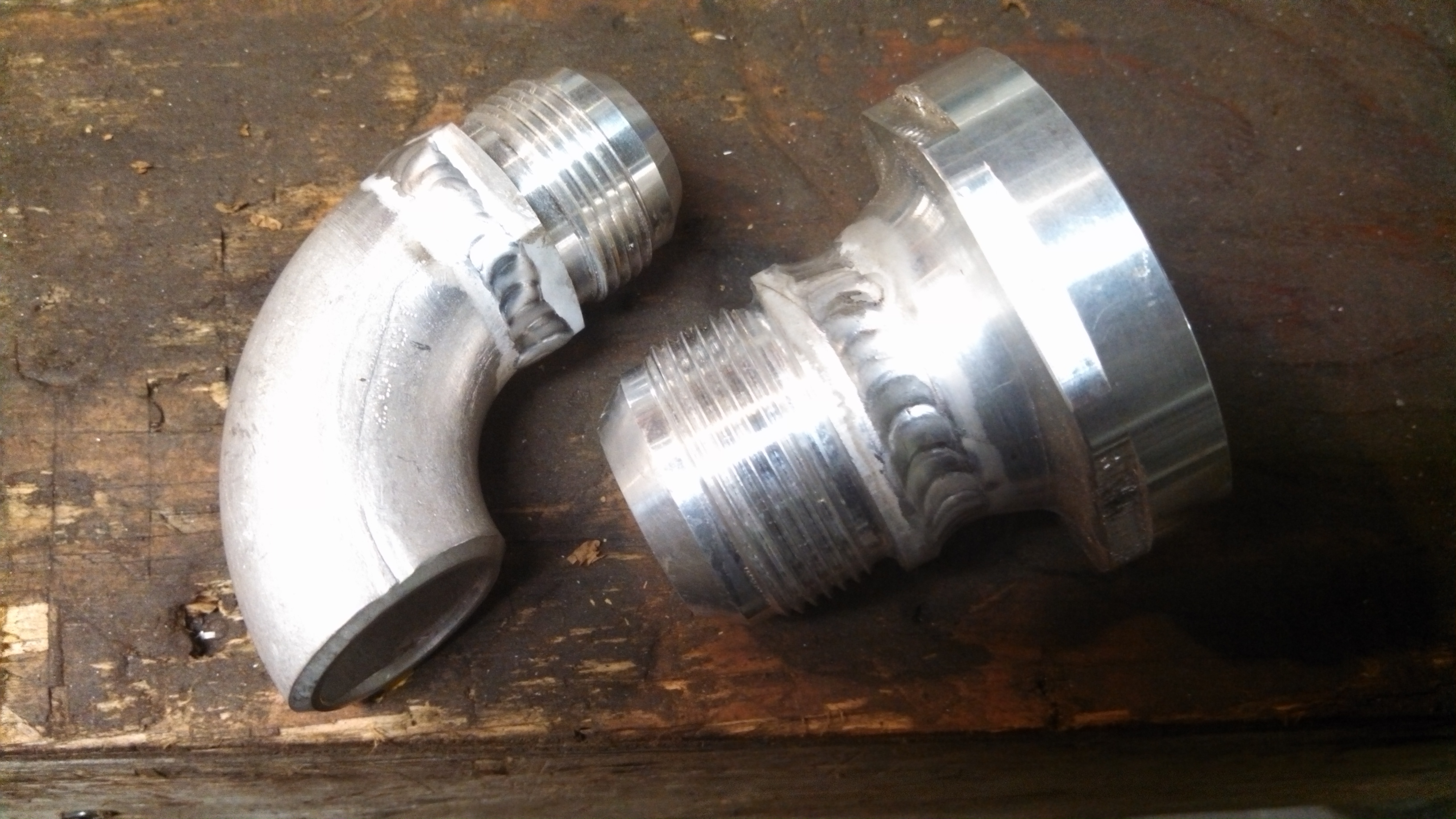

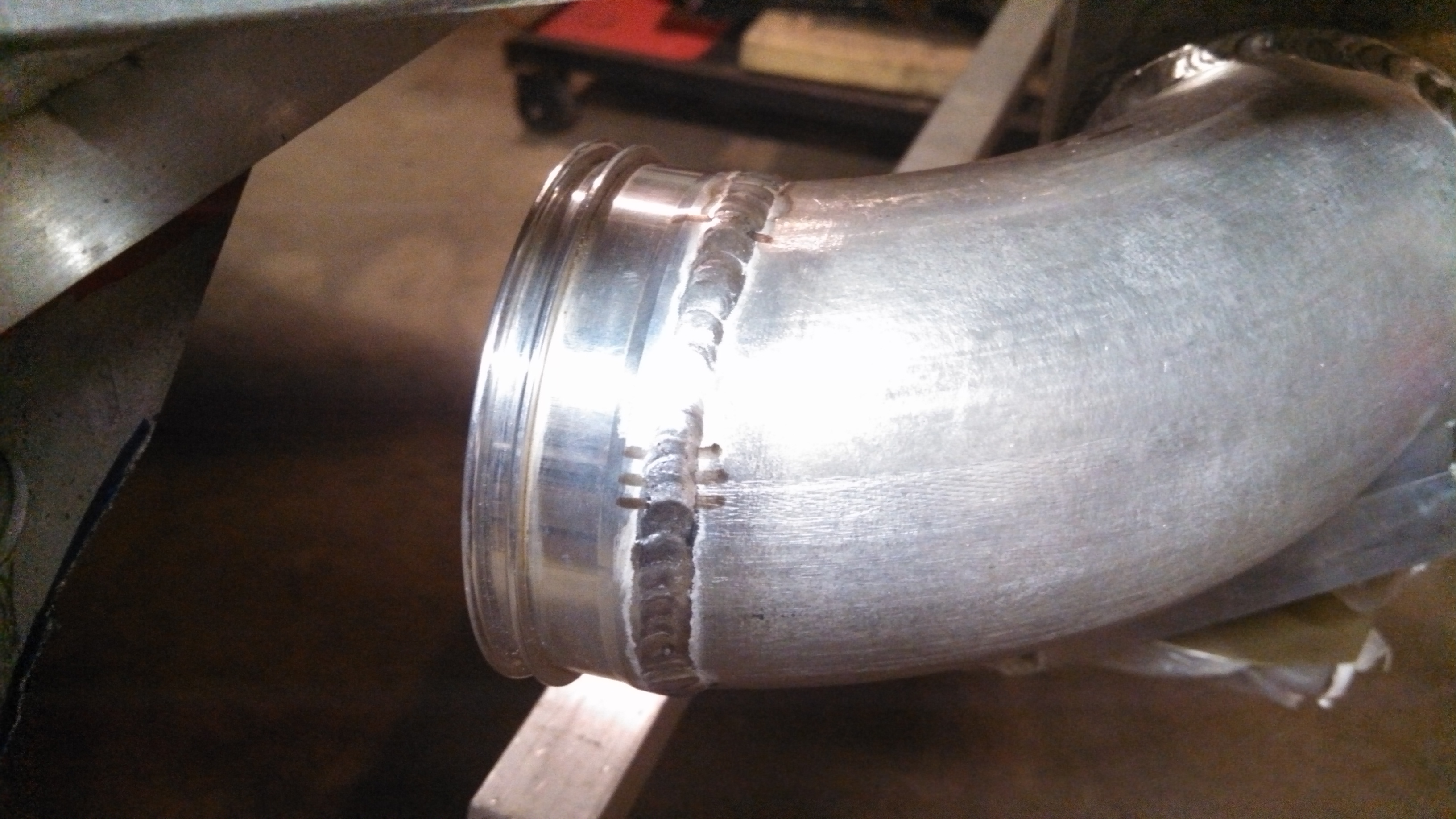

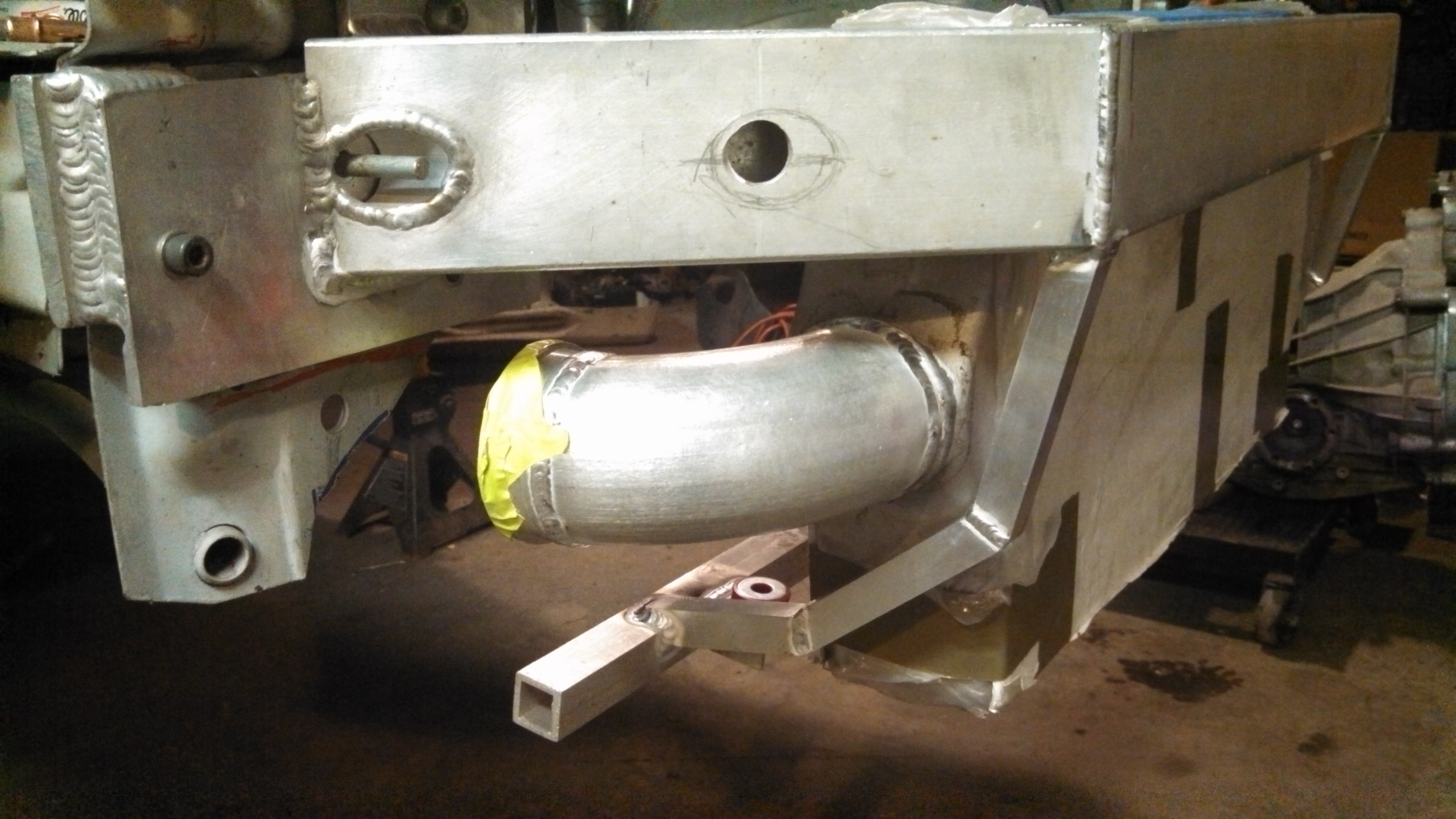

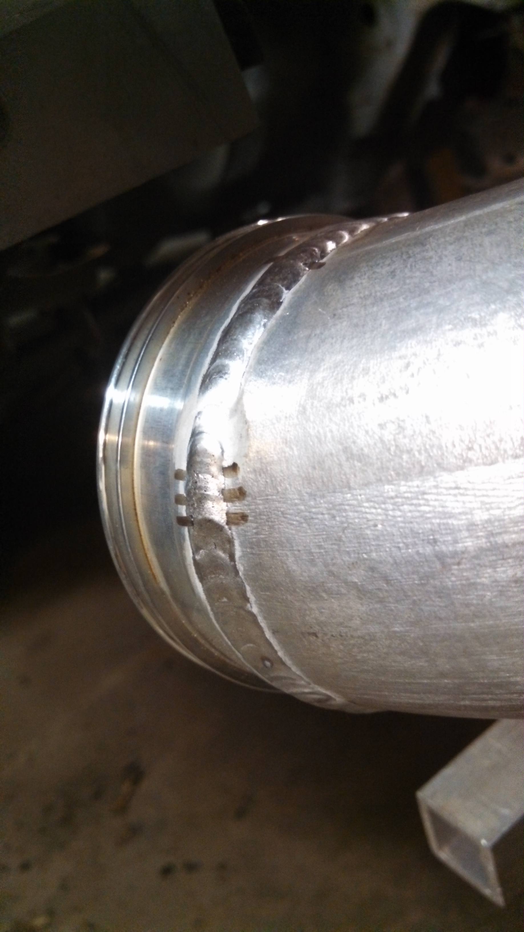

I also got the Vanjen ferrules welded to the inlet and outlet of the IC. The inlet and outlet also have small extensions/bends as well to keep things located where they are easy to get to, and more so to allow the joints to have some movement in the proper directions.
IC inlet and support bar.jpg (1.37 MiB) Viewed 39007 times
IC inlet vanjened.jpg (1.31 MiB) Viewed 39007 times
IC outlet vanjened.jpg (1.08 MiB) Viewed 39007 times
vanjen clamp weld detail.jpg (1.23 MiB) Viewed 39007 times
vanjen clamp weld detail2.jpg (1.35 MiB) Viewed 39007 times

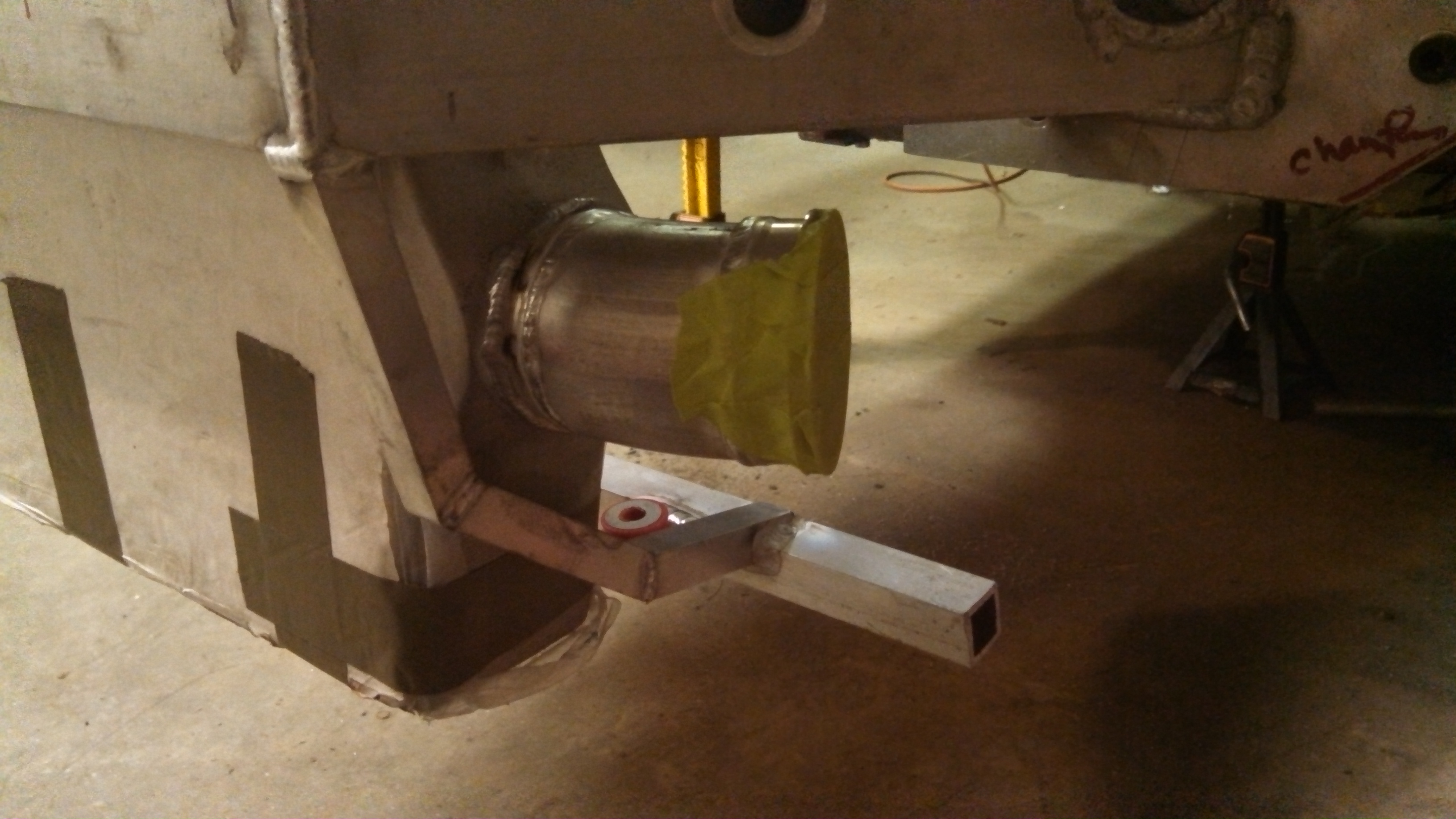

MORE!!

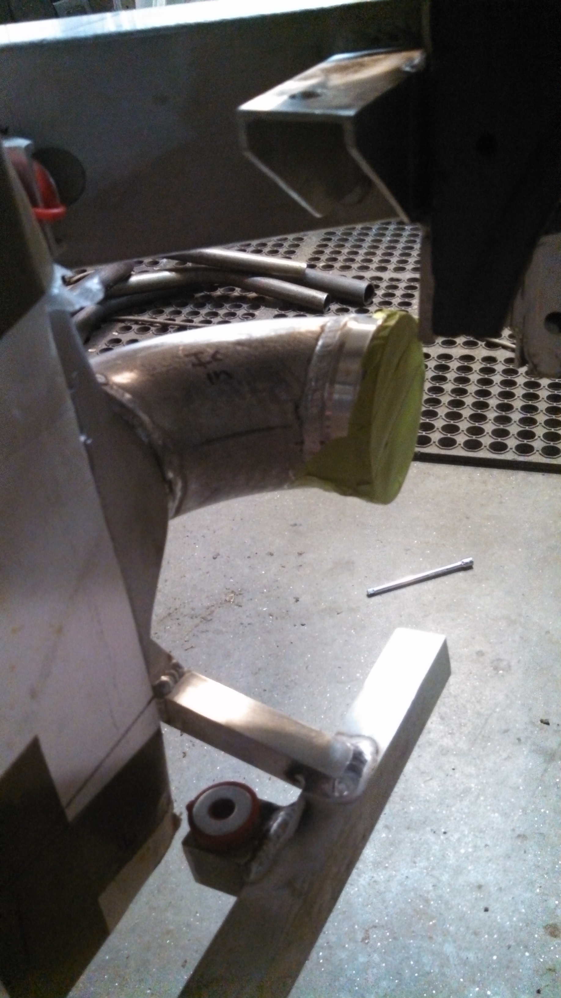

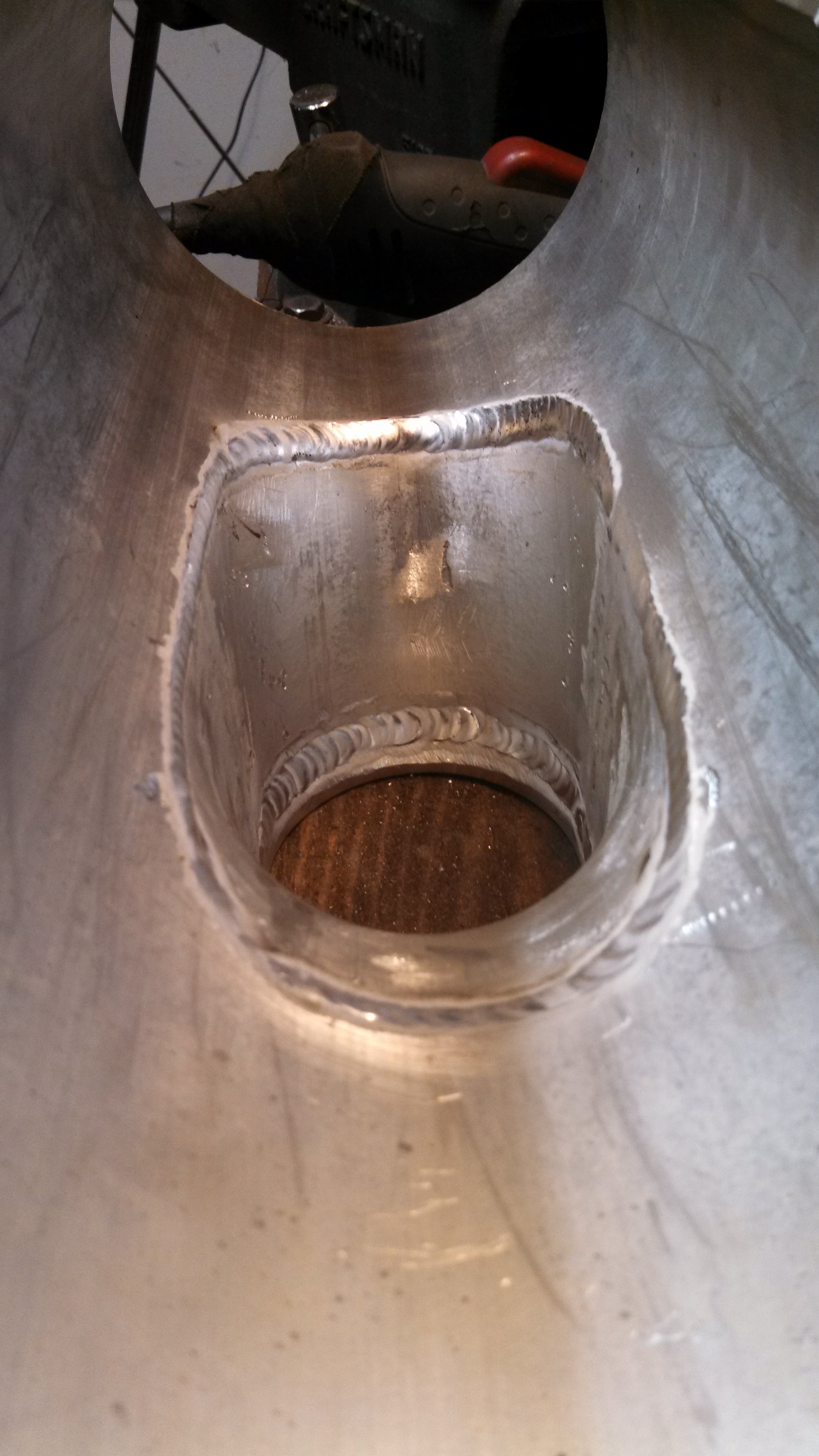

Turbo oil drain to oil pan return got the 16AN bung welded on. I’m not going to finalize the drain location in the pan until the exhaust manifold is done.
turbo oil drain to pan and radiator hot inlet.jpg (1.46 MiB) Viewed 39006 times
The radiator will be a 20AN hot-side/inlet and a 24AN cold-side/outlet. Here is the inlet welded to its 20AN bung. It just needs to be turned down a bit to get the outer threads off, and it can be welded to the radiator.
radiator 20an hotside.jpg (1.53 MiB) Viewed 39006 times
radiator 20an inside transition.jpg (1.31 MiB) Viewed 39006 times

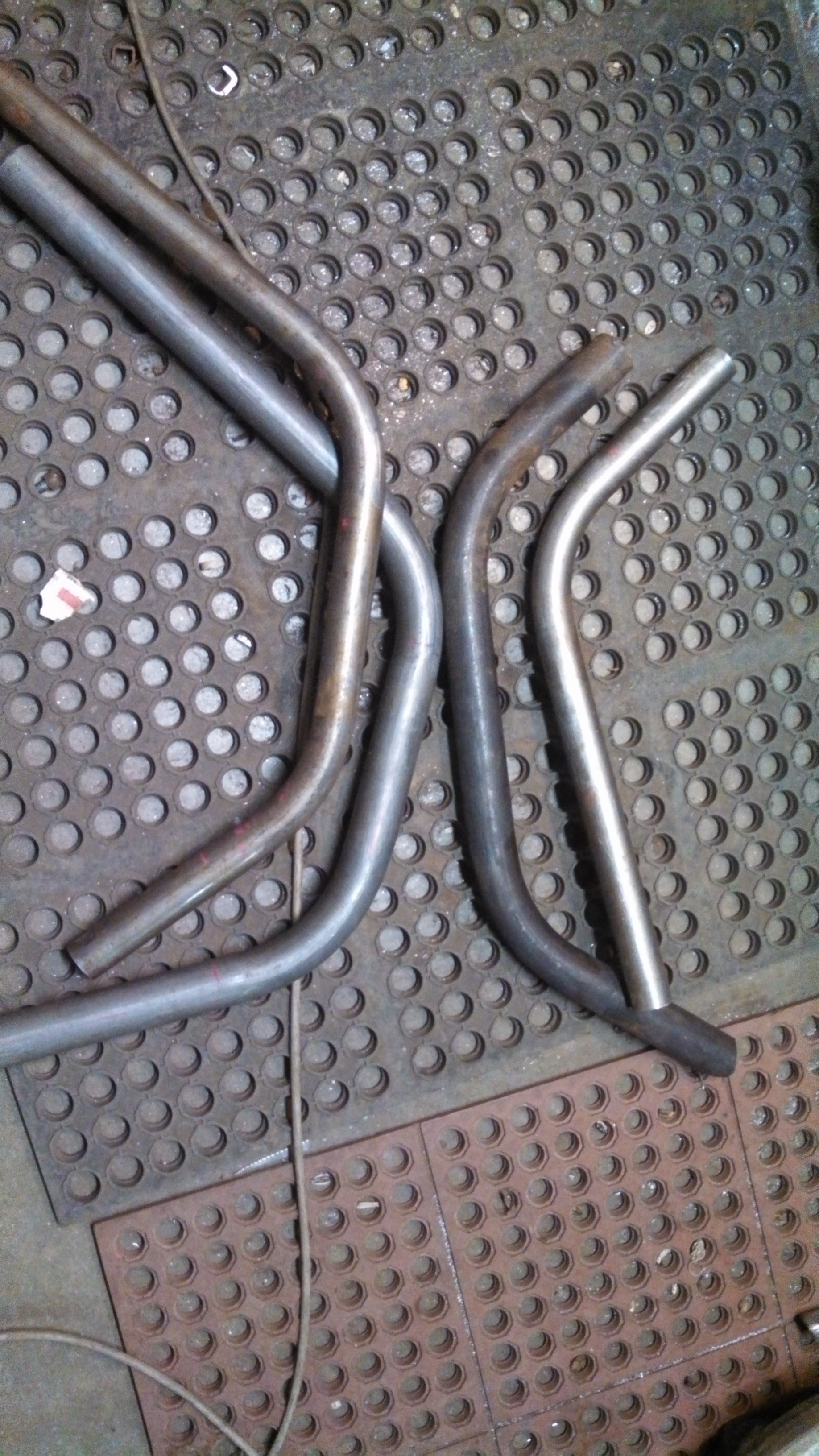

I also got a change to get down to Haydn’s to get my subframe transverse connector pieces bent up. Yes, I know, the bends aren’t the same on both sides. This is to allow the 4” downpipe and 3.5” exhaust to have good clearances. I wanted to be able to drop exhaust without having to touch the sub-frames.
bent tubing for subframe transverse members.jpg (1.92 MiB) Viewed 39006 times

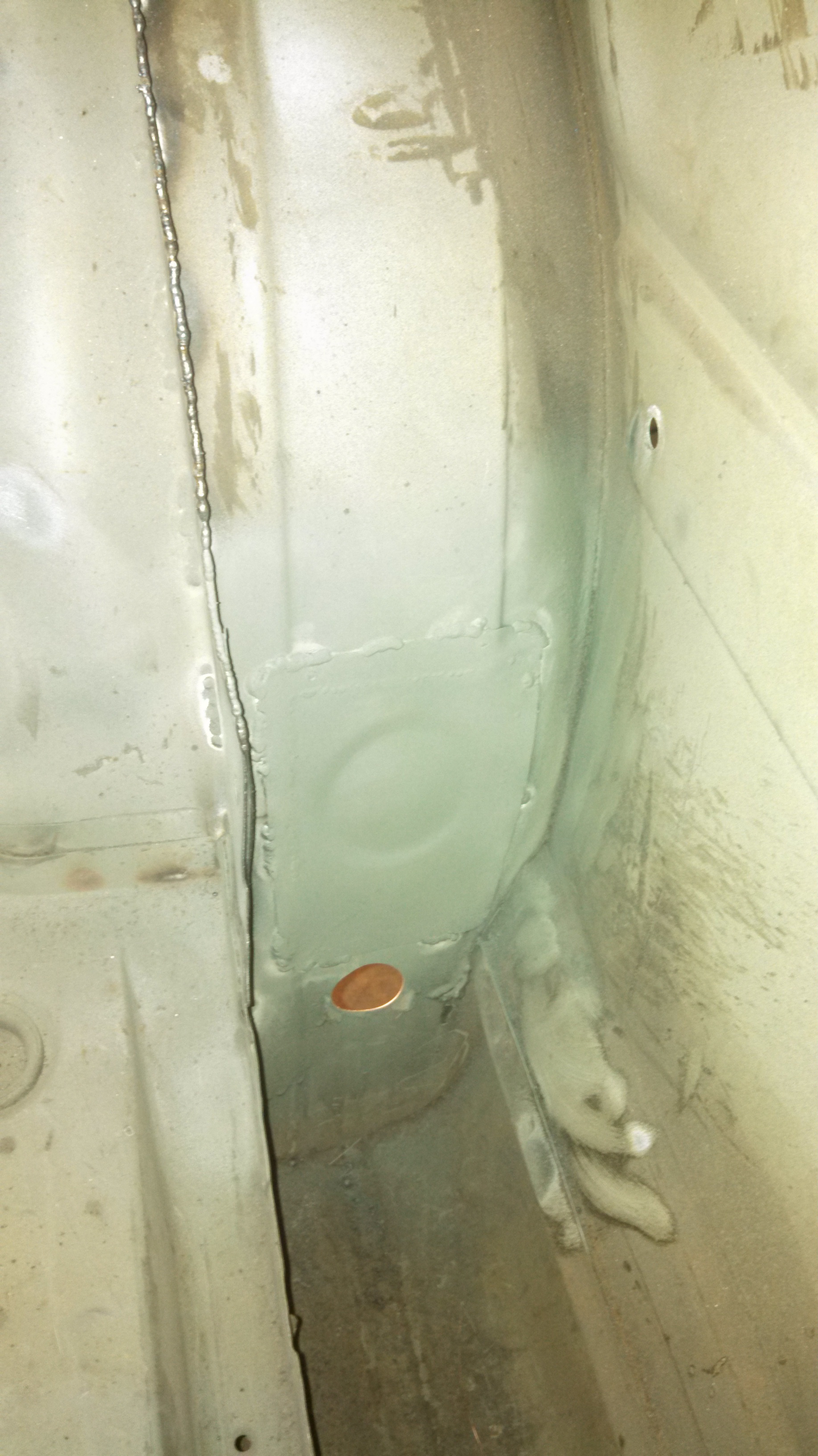

UPDATE!!!

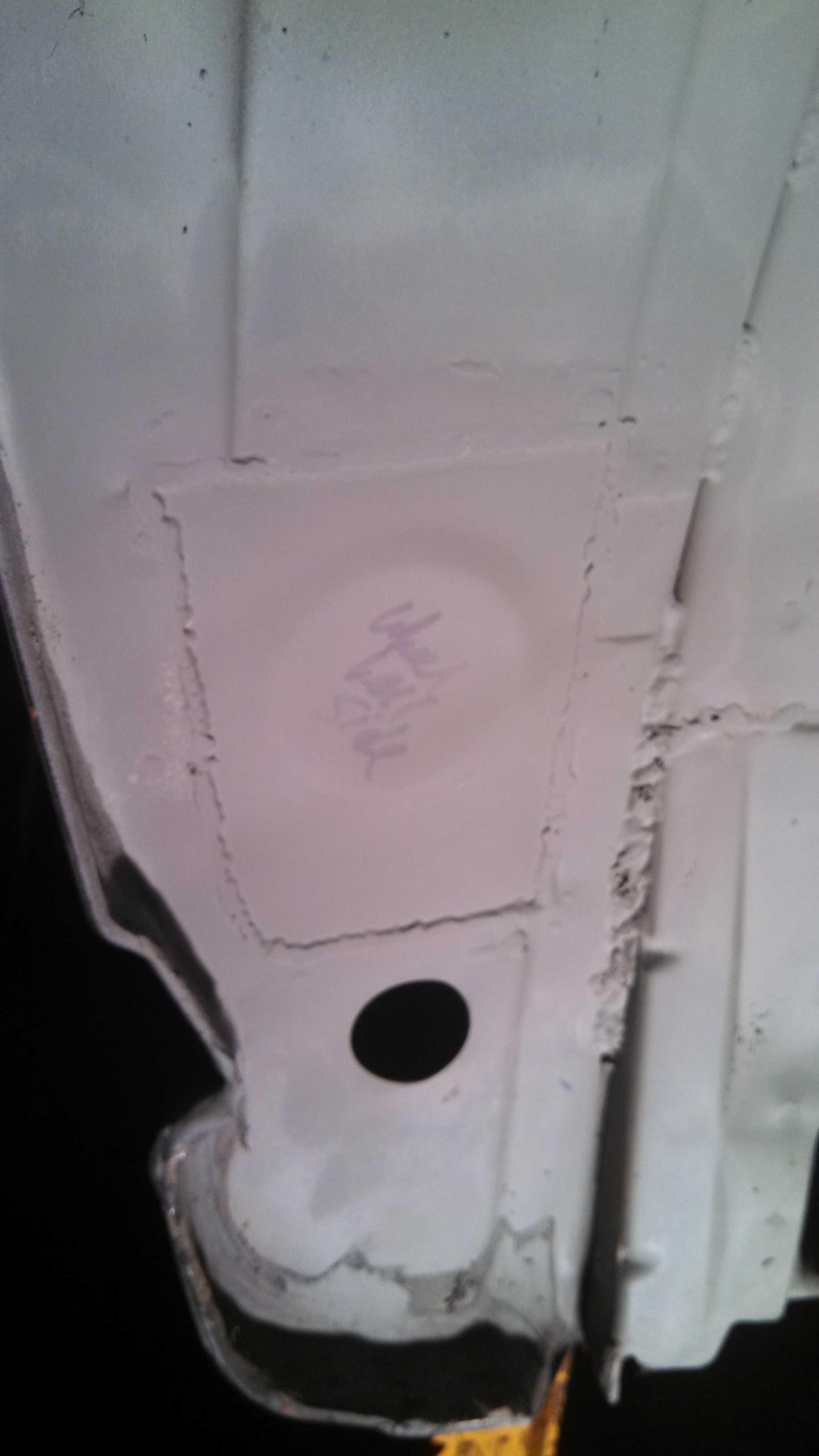

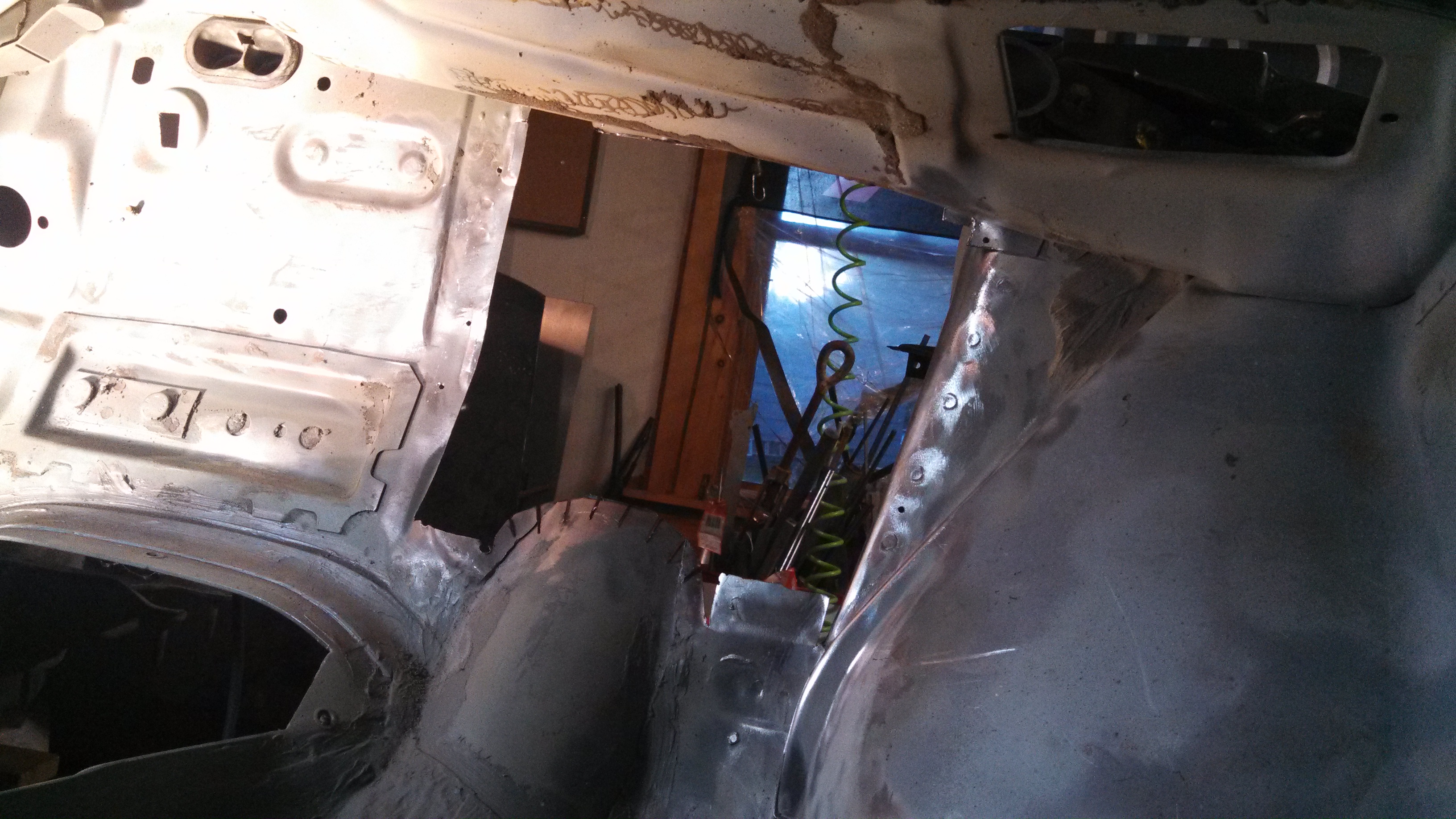

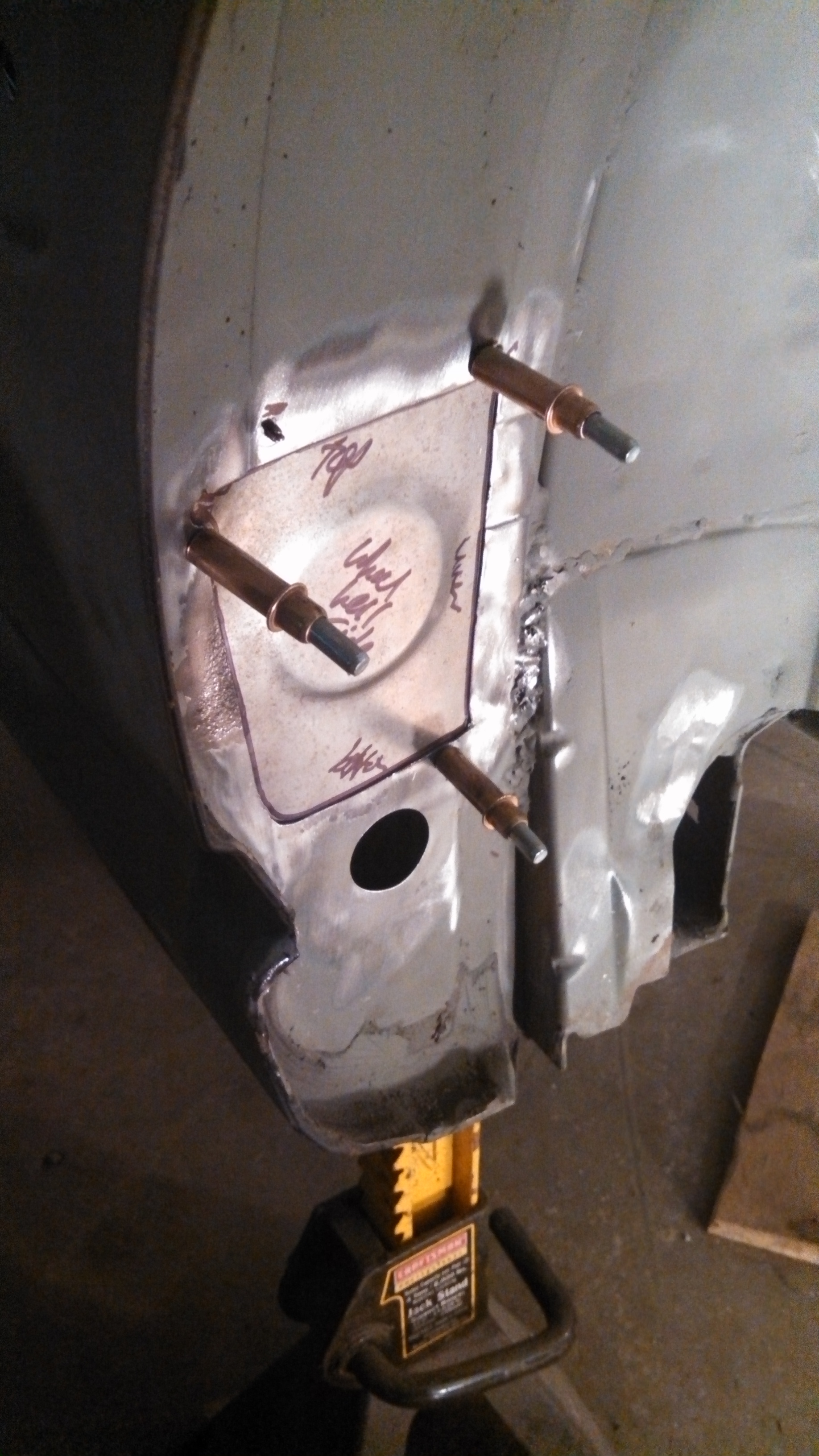

I had a few small rust patches in the rear wheel well area so I set to cutting it out and replacing the sheet metal.
Here it is all cutout and cleco’d in place.
driver rear wheel well patch cleco'd in.jpg (1.38 MiB) Viewed 39018 times
Seam welded in place and primed. It will get seam sealed as the rest of the chassis works gets finished.
drivver rear wheel well patch.jpg (1.28 MiB) Viewed 39018 times
dr rear wheel well patch primed.jpg (1.14 MiB) Viewed 39018 times

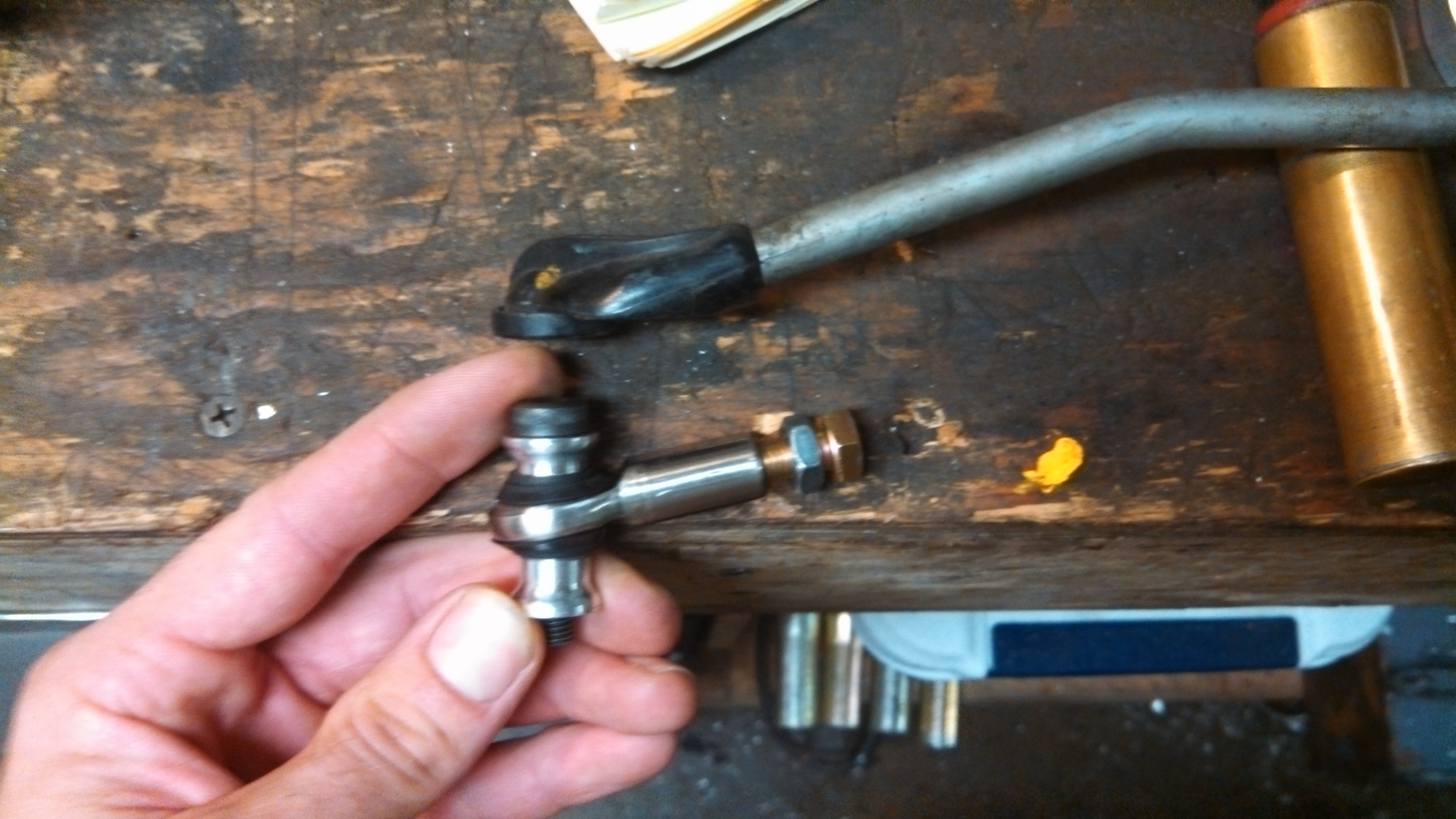

I also started collecting a bunch of small rod ends, spacers, seals etc. to convert the 01e b5s4 shifter x-rod to a small spherical joint. It will use rod end seals and some alu. spacers to give it correct height and articulation. More on that later
o1e crossrod spherical in the works.jpg (972.62 KiB) Viewed 39016 times

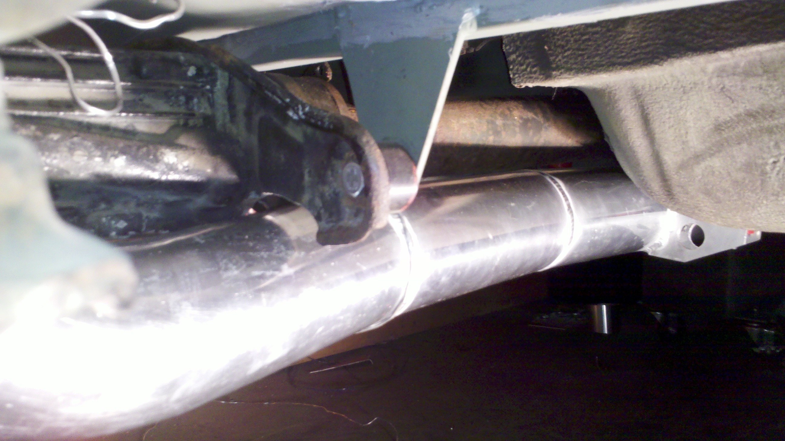

I had originally relieved the t44 rear diff mount bracket for exhaust clearance (see pic)
But that just wasn’t up to my standards for the rest of the car, so what to do? BILLET!
exh clearanced v8 dif mount.jpg (1.07 MiB) Viewed 39016 times

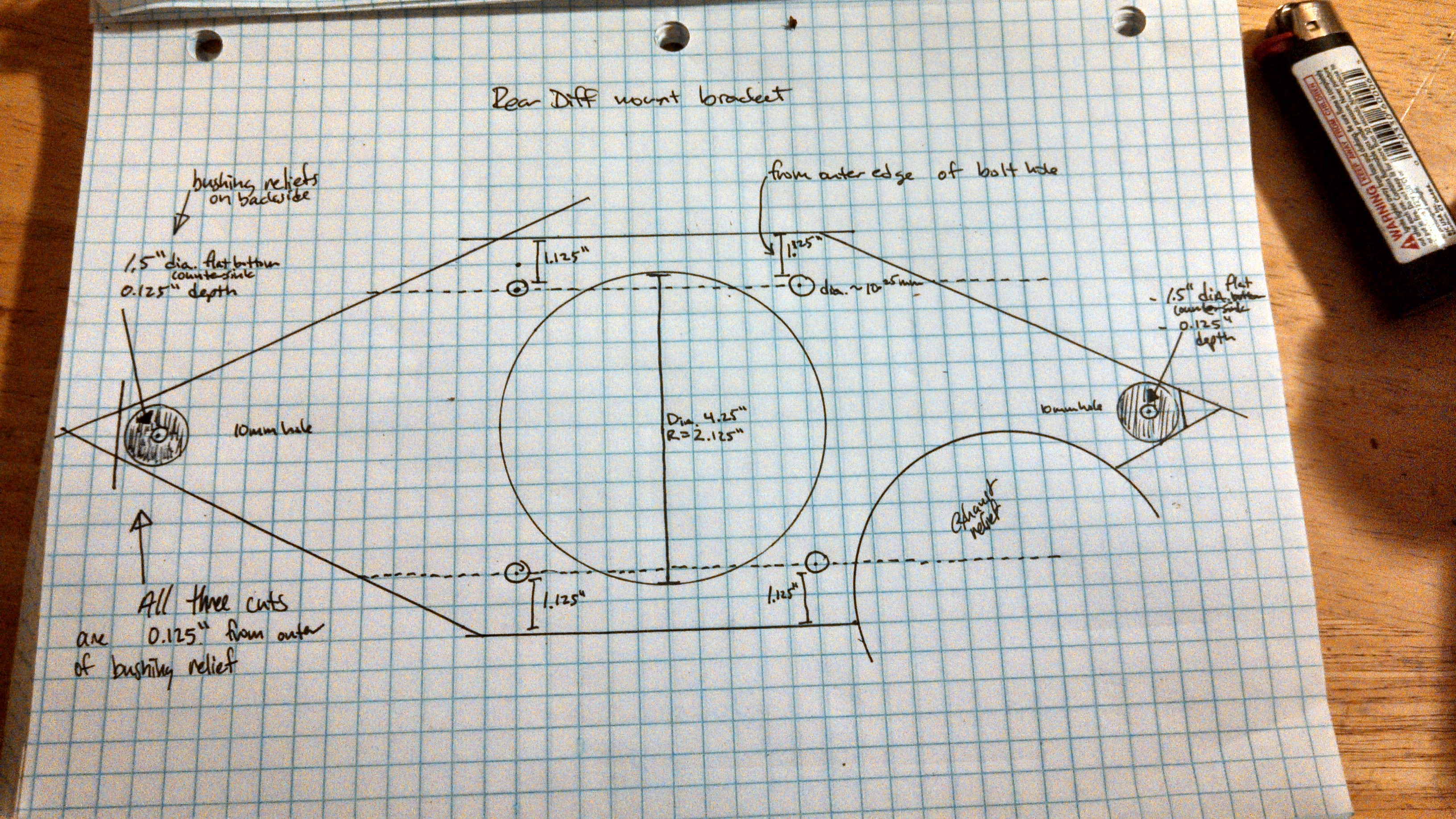

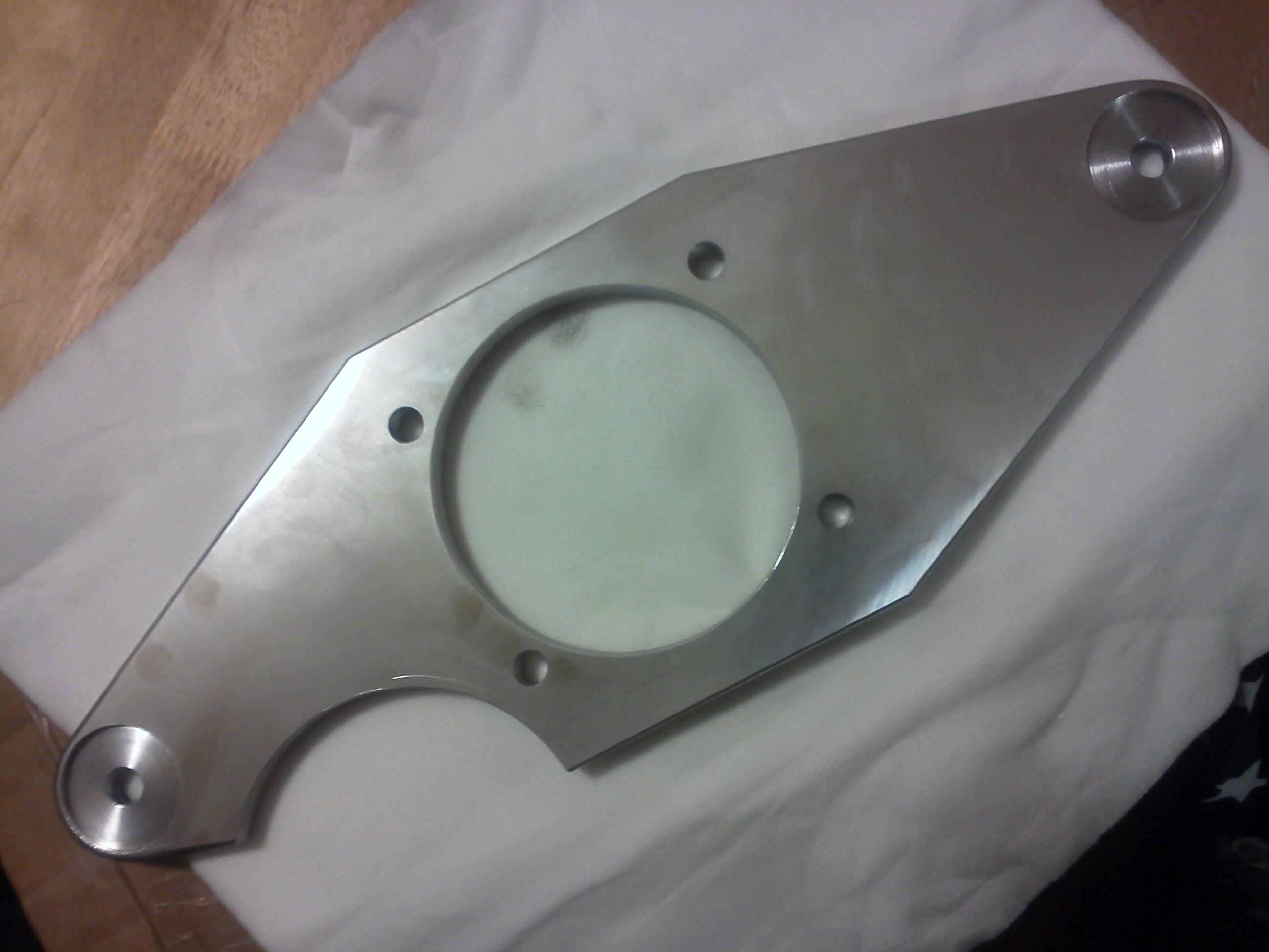

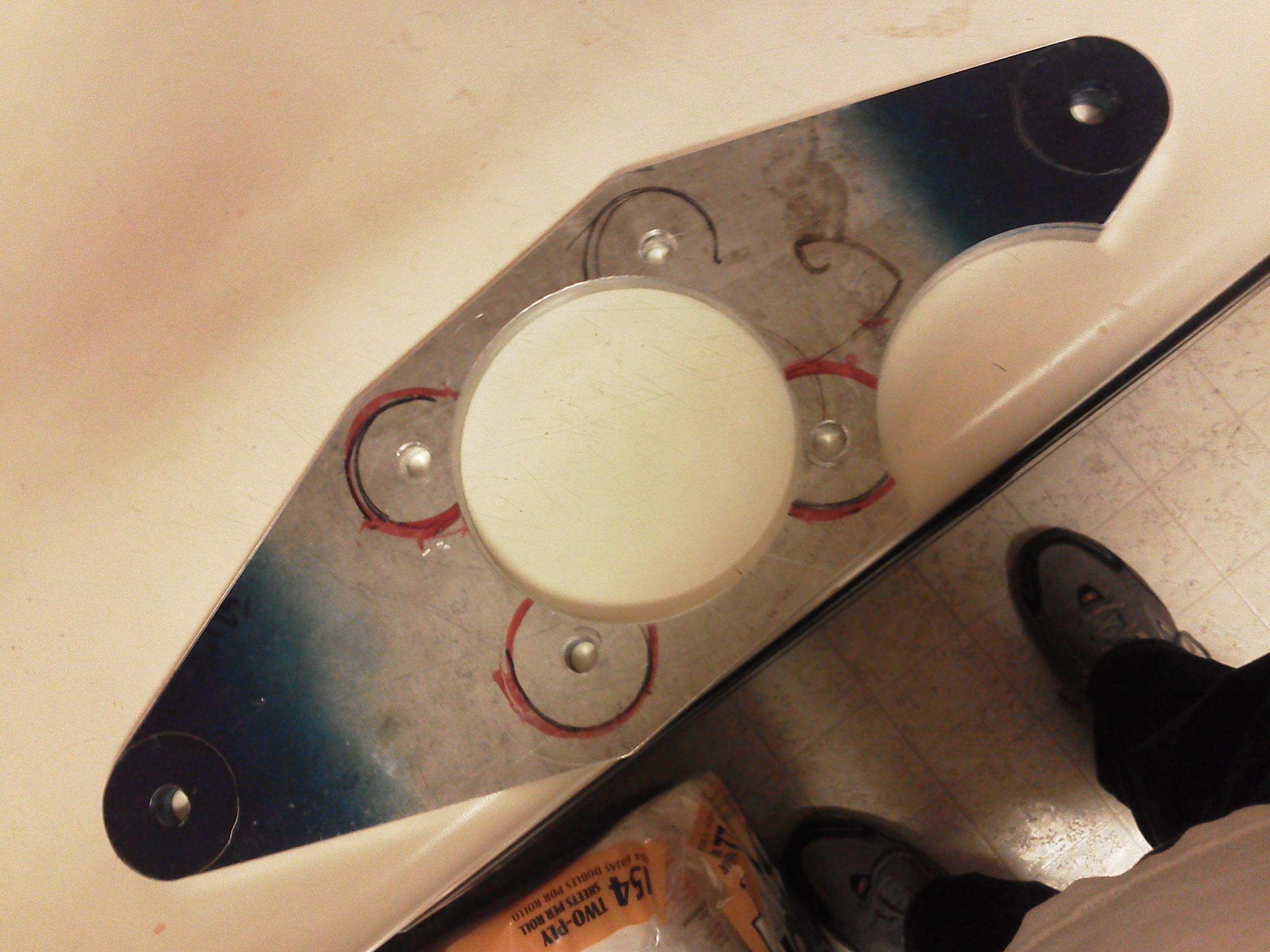

Yup, so I grabbed a piece of ½” 6061 plate and dove right in!! I diligently marked all the holes on the mount first. Then I took a hole saw to the diff. input cup hole and also to the exhaust relief. And that’s it, haha not really. I sent it off to my buddy who works at a machine shop. Its going to be milled down along the edges, have a radius cut along the edges, the diff mount bushings are being recessed to make up for the oem vs billet mount plate thickness, and lastly a light fly cutting for sexiness. It should be here in plenty of time to go to the first round of anodizing. Pics!!!
rear diff mount bracket roughed out.jpg (1.56 MiB) Viewed 39016 times
rear diff mount bracket drawing.jpg (2.17 MiB) Viewed 39016 times
UPDATE!!!

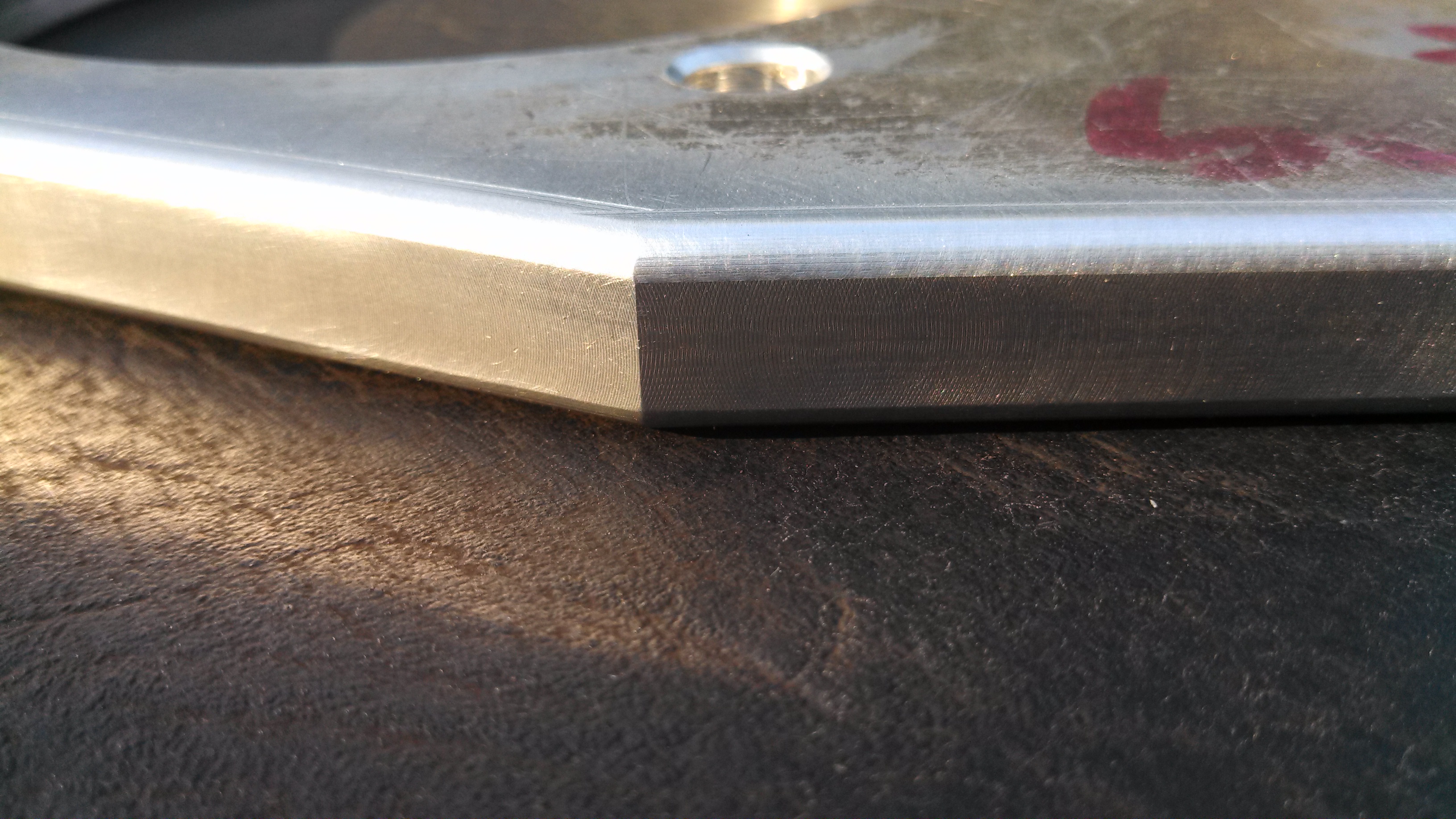

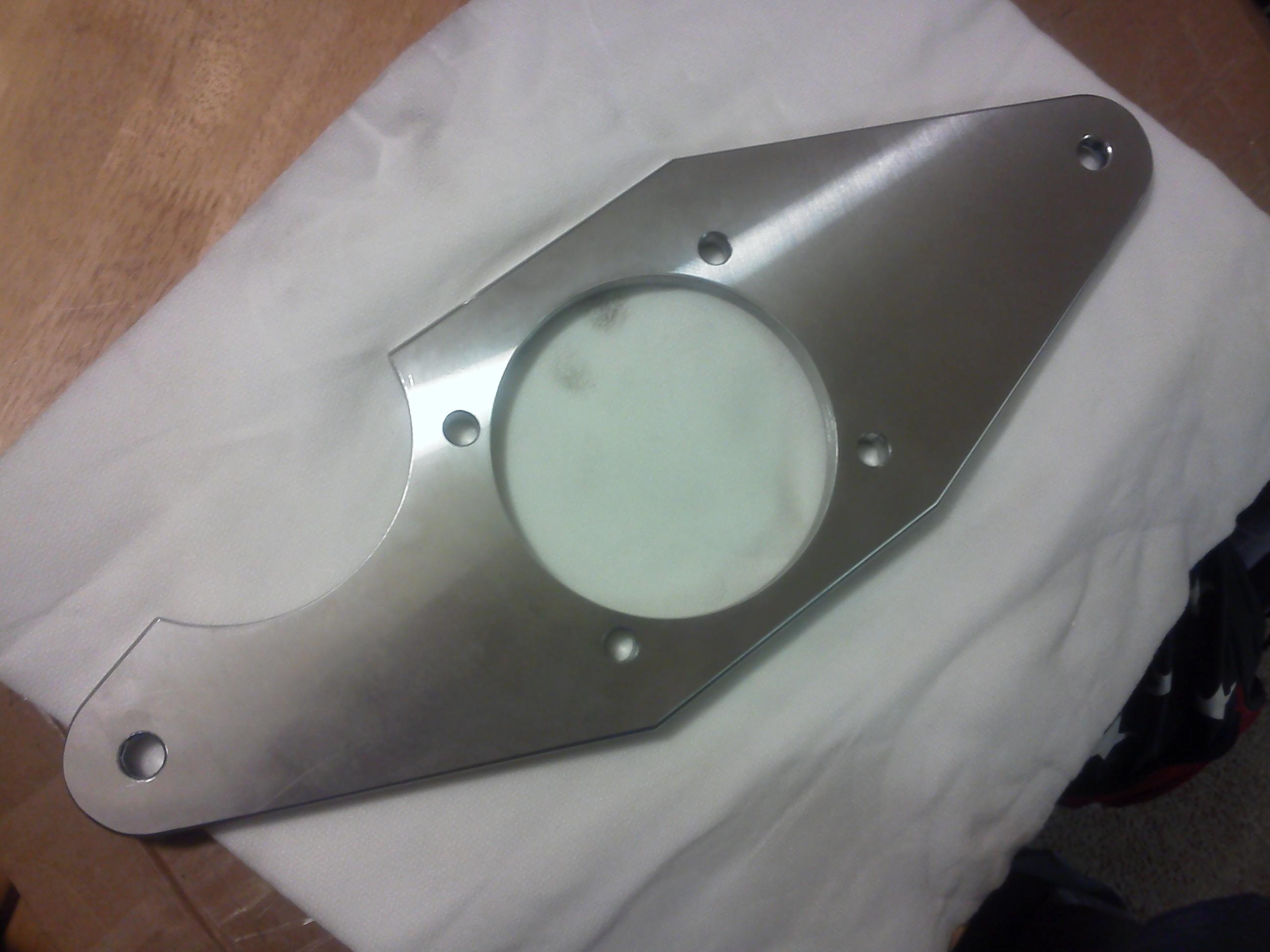

The diff mount plate has been finished by my machinist :) I had the outer edges radius’d 1/8” and the mount bushings have been recessed into the plate as well.
rear diff plate outer trimmed.jpg (399.27 KiB) Viewed 38940 times
billet rear diff mount plate radius'd.jpg (1.66 MiB) Viewed 38940 times
billet rear diff mount plate radius'd2.jpg (1.68 MiB) Viewed 38940 times
rear diff plate finished back side.jpg (251.72 KiB) Viewed 38940 times
rear diff plate finished bushing side.jpg (238.52 KiB) Viewed 38940 times

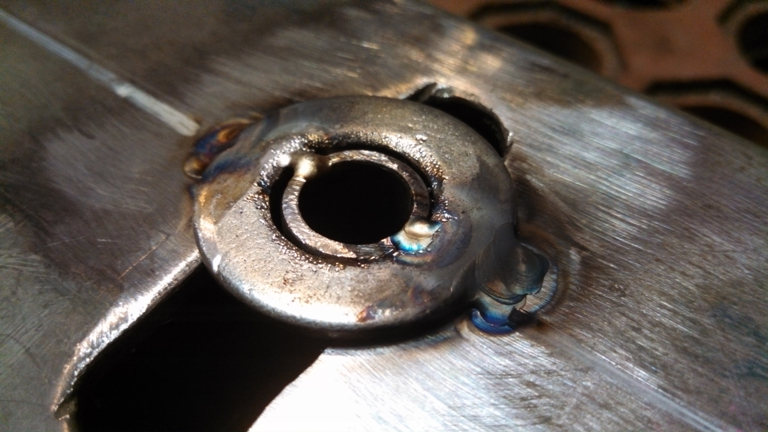

I also added a jack point on the bottom of the rear subframe, this makes it sooo much easier to jack car up and move it around garage etc.
SF jacking point.jpg (1.26 MiB) Viewed 38940 times
SF jacking point 2.jpg (1.39 MiB) Viewed 38940 times

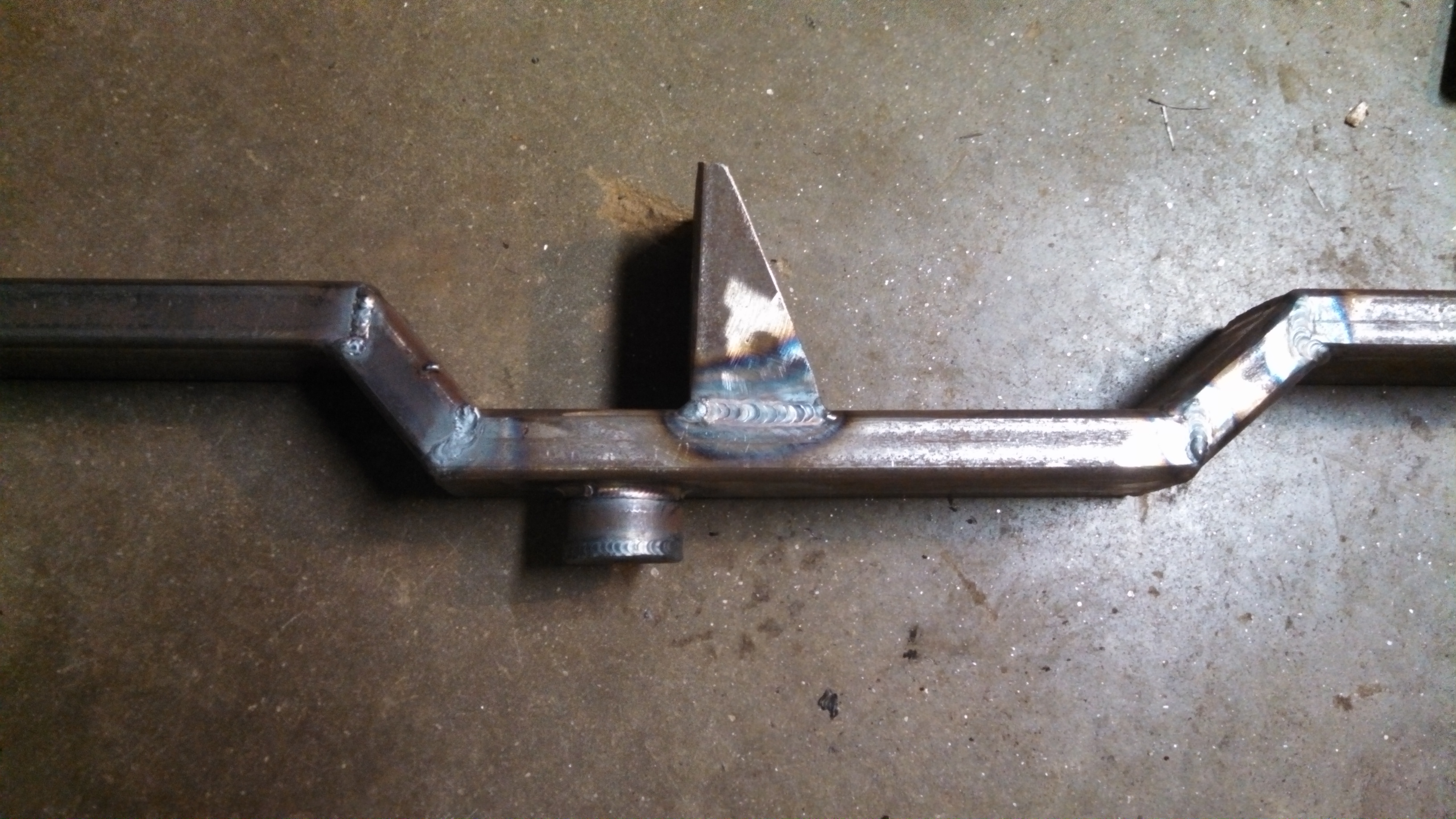

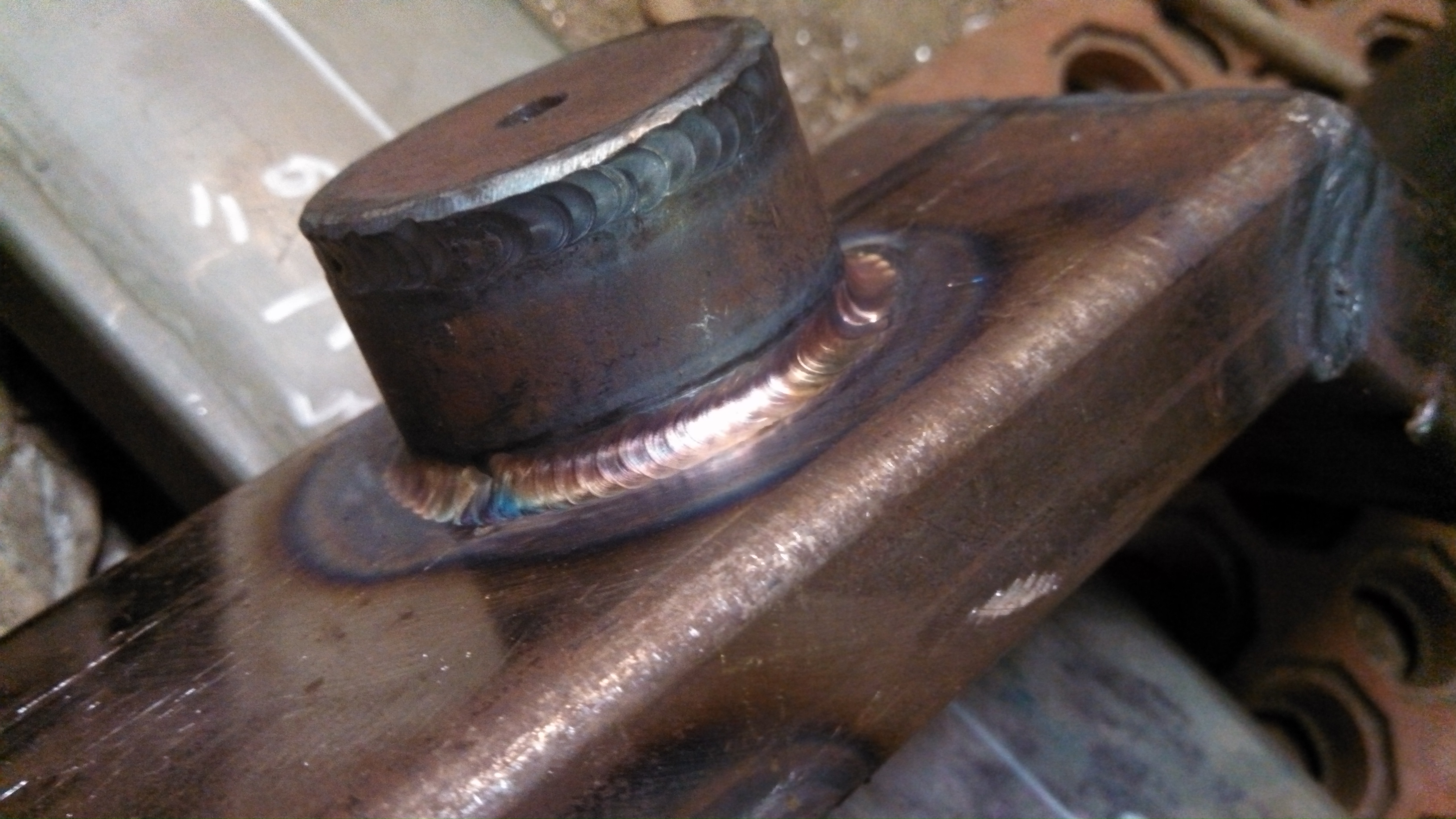

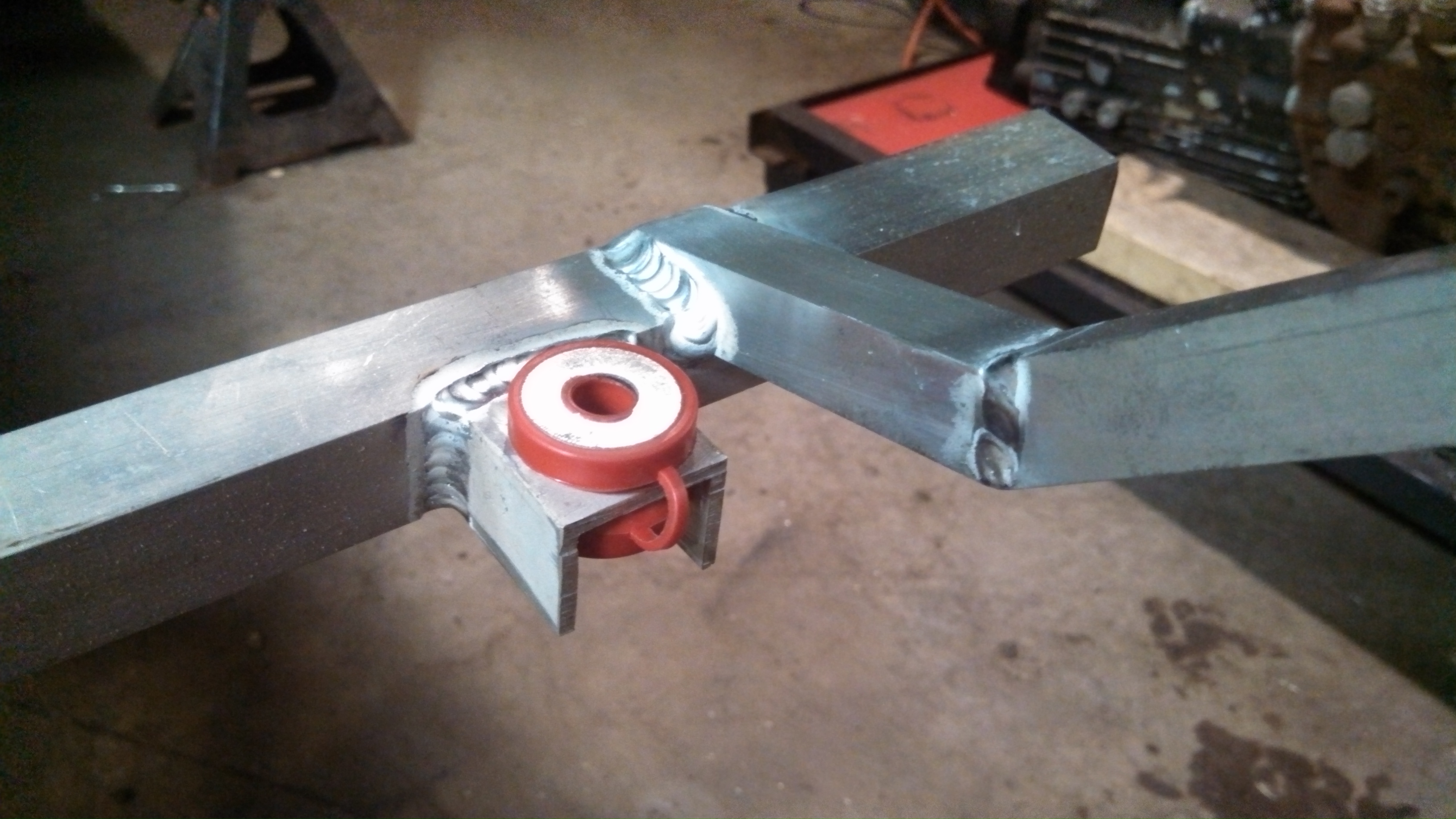

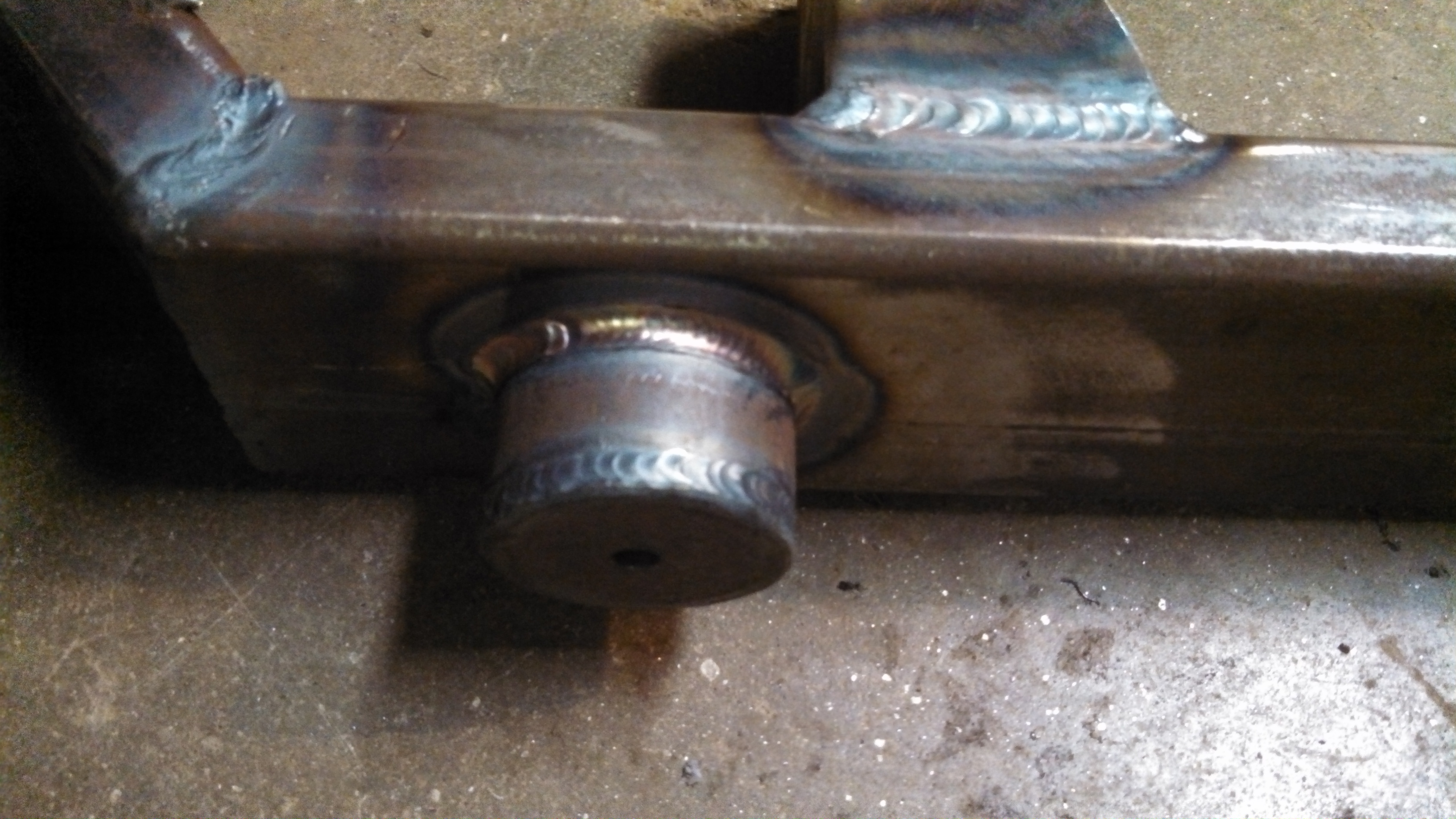

I also added some anti-crush sleeves to the trans support bar, tacked them in just to double check it all before seaming.
trans bar crush sleeves.jpg (1.78 MiB) Viewed 39034 times
trans bar crush sleeves-washers.jpg (1.53 MiB) Viewed 39034 times

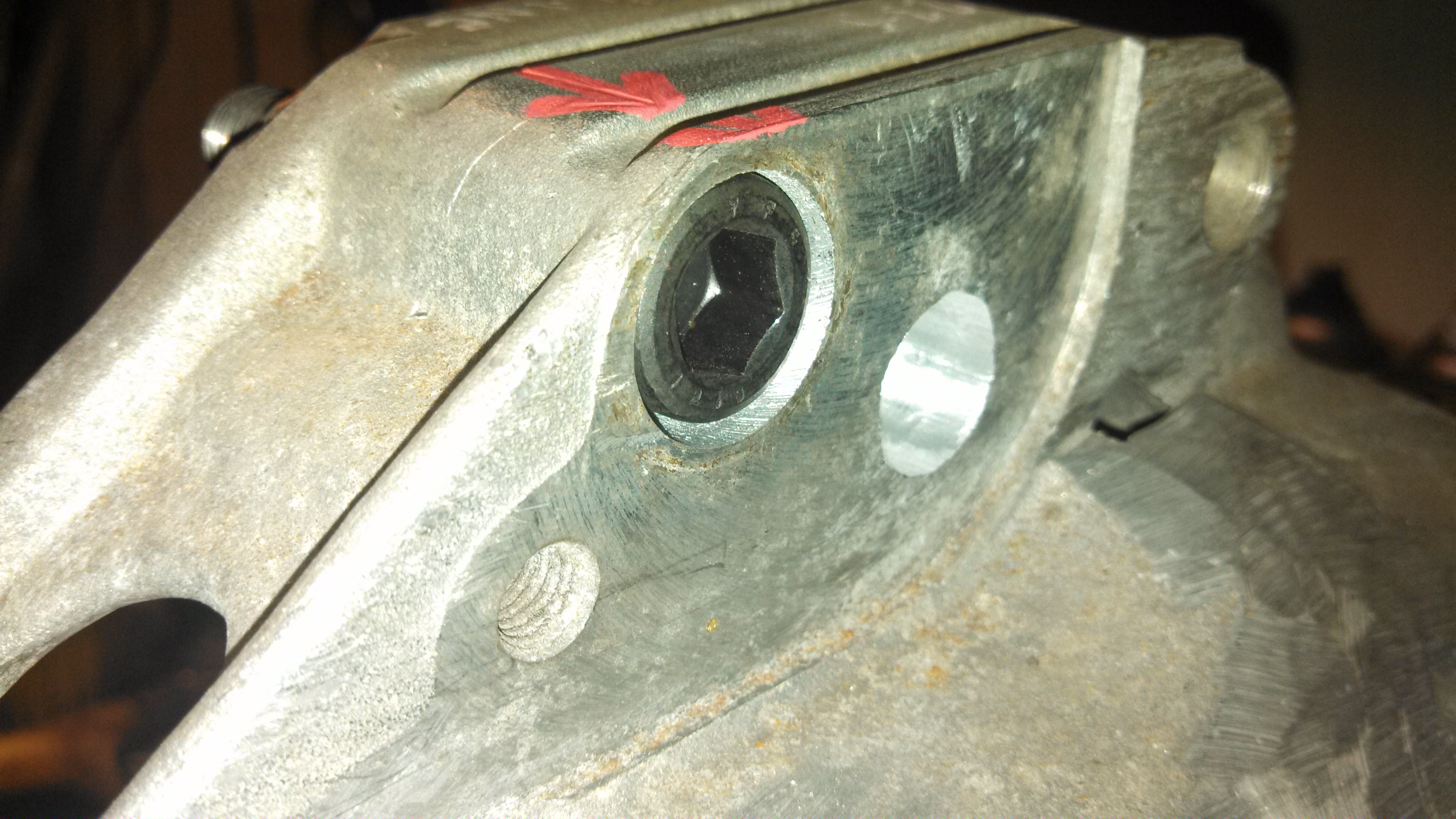

With the motor pushed back, there is very little clearance for the steering arms bracket to the bellhousing. So I got some m12x 1.75mm allens and counter sunk them into the upper bellhousing. This gains me a lot more room.
countersunk upper bellhousing bolt.jpg (1.62 MiB) Viewed 39033 times
countersunk upper bellhousing bolt upclose.jpg (1.75 MiB) Viewed 39033 times
I also added another bolt hole for the motor mount through the adapter plate.
motor mount through hole, added nut clearance.jpg (1.54 MiB) Viewed 39033 times

highlander69 wrote:
Mcstiff wrote:Word is Audi Sport shaved those bosses off so it was easier to pull the transaxle.
They sure did.
Looking great. Lot's of fabrication going on...........brilliant. :beer:
Craig.
I don't get it, how does this make it easier to pull the gearbox off the engine? Any pics?
Sent from my HTC One X+ using Tapatalk
kieron_32v wrote:
They sure did.
Craig.
Shaveing the top of the bellhousing removes 2 (or 3) bolts and makes clearing the rack easier.
kieron_32v
Posts: 70
Joined: Mon Aug 26, 2013 9:49 pm
Post by kieron_32v »
Fair enough, so just having the remaining bolts is enough? Did they run any more dowels like that?
