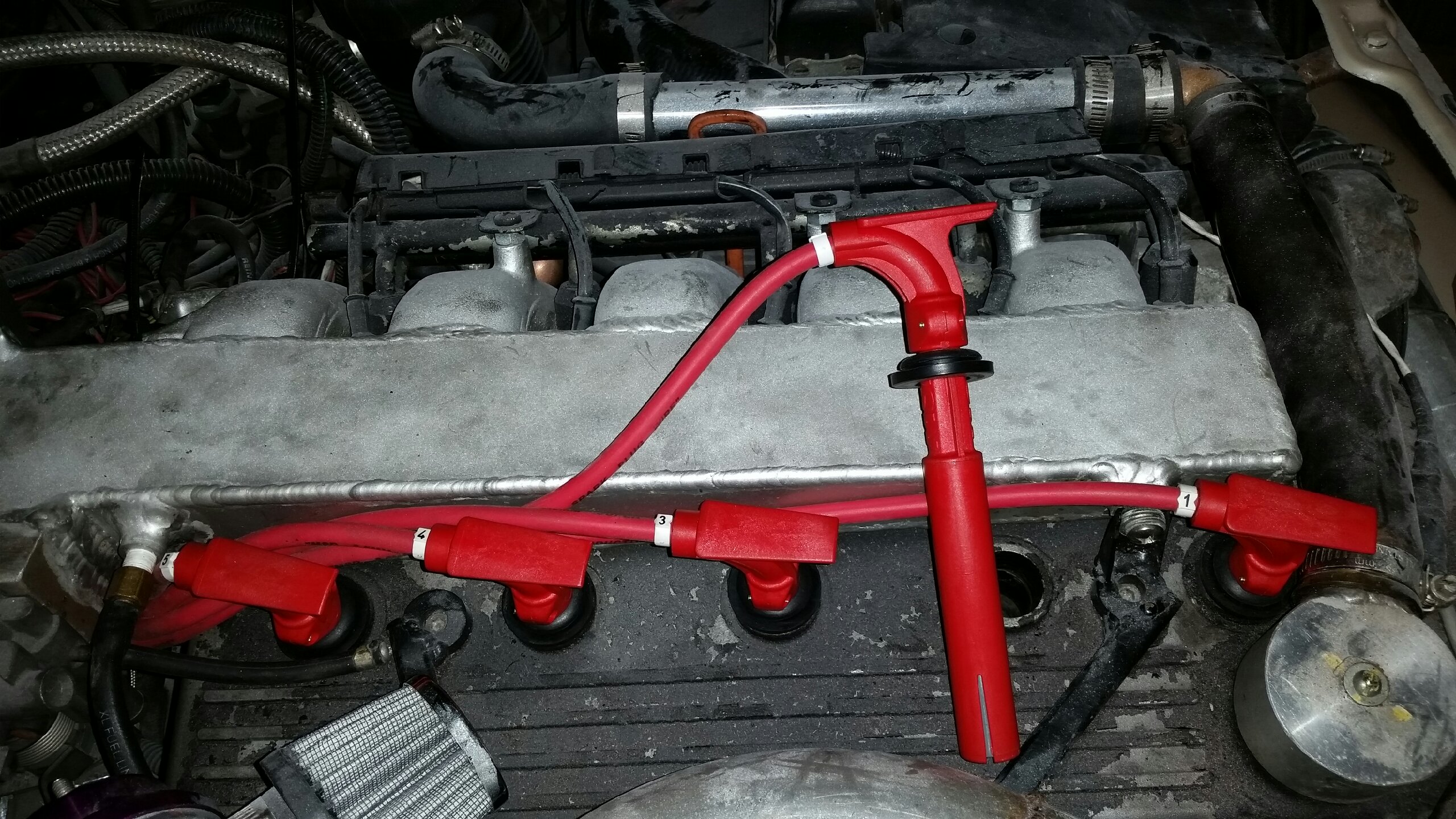

msd hemi wire kit plus five autozone 5/8" pcv grommets for dust covers.

Awesome thread, nice work all around.pkw wrote:msd hemi wire kit plus five autozone 5/8" pcv grommets for dust covers.
Any specific information on this? Ie, part number haha!
Re: MSD universal hemi wires....nice red ones
msd #31539
autozone pcv grommet #42066 to use as a dust cap x 5
summit racing's pic is incorrect but it gives you an idea.
wires come with hei ends and they worked fine for my 034 dis coils

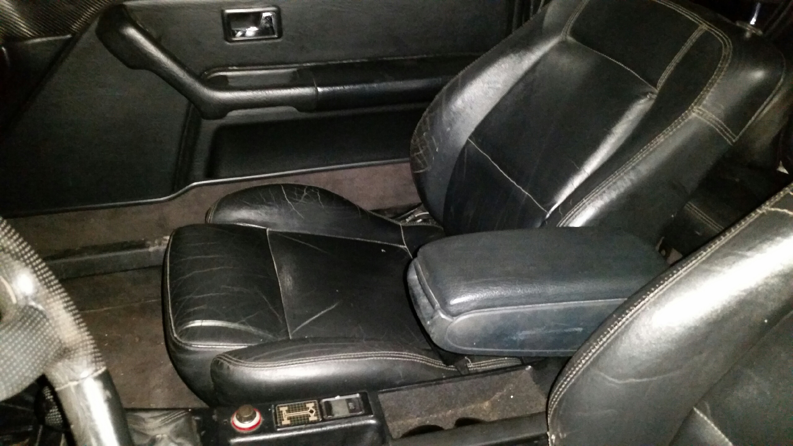

Installed an armrest today because I love to lean my right arm on something during long drives. Works well.
