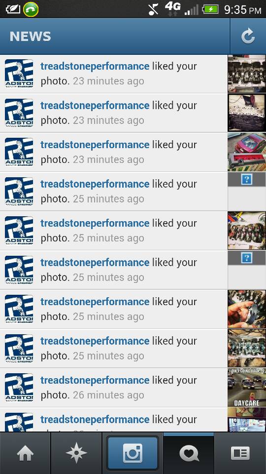

Someone at Treadstone has definitely taken notice of Rubi's build on my instagram... Pretty cool I guess...
SO it's done now right?
chaloux wrote:SO it's done now right?
LMAO... Oh Matt
it must be done if you have time for instagram

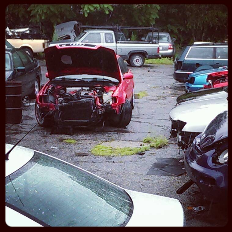

I blast instagram and TPP pics at the same time... Todays post will be more meaningful... Buildwise... I promise...

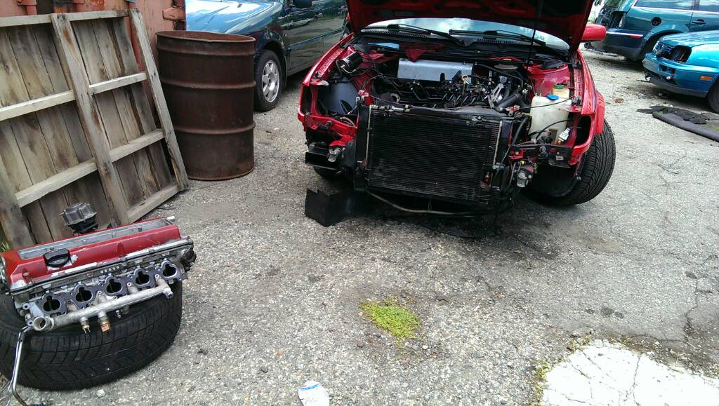

Head, intake, downpipe all unbolted ... Just need to pull it off then came the rain delay...

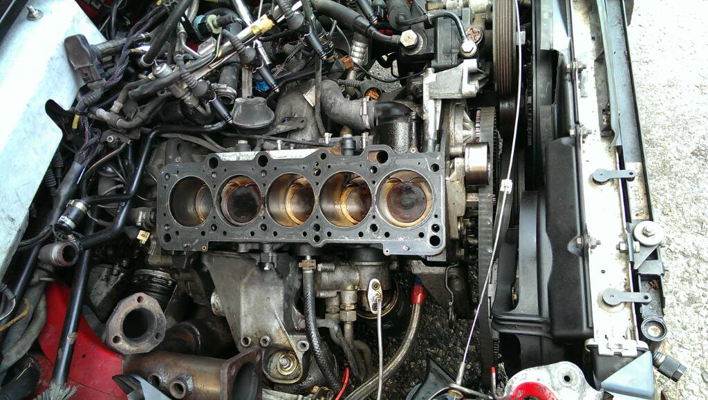

Actually I will... I just threw the 7a cam gear to time it up against the valve cover...
Cylinder 4

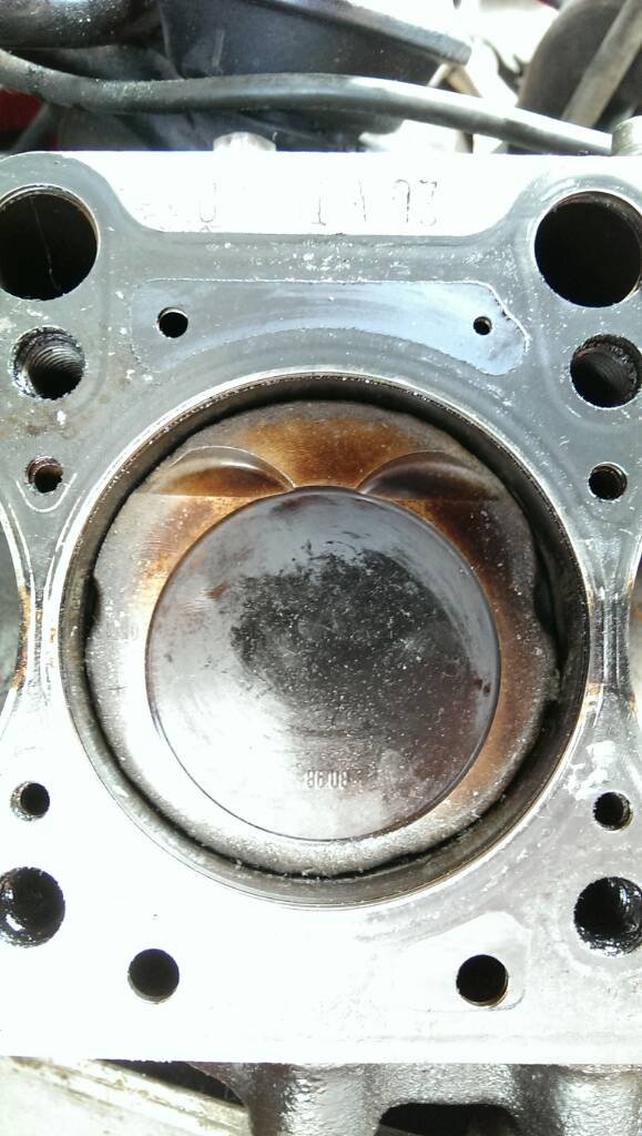

HEY THAT LOOKS LIKE DET, JUMP ON THE DET TRAIN WOO WOOOOOOOOOOOO
Or did the hg fail through cylinders? Can't see shit on my phone.
Sent from my Nexus 4 using Tapatalk 4 Beta
That is some bad detonation. Whatever you do, don't run that same tune on the new motor.
What do the rest of the cylinders look like?
ouch! I bet that t04e was scooting around.
