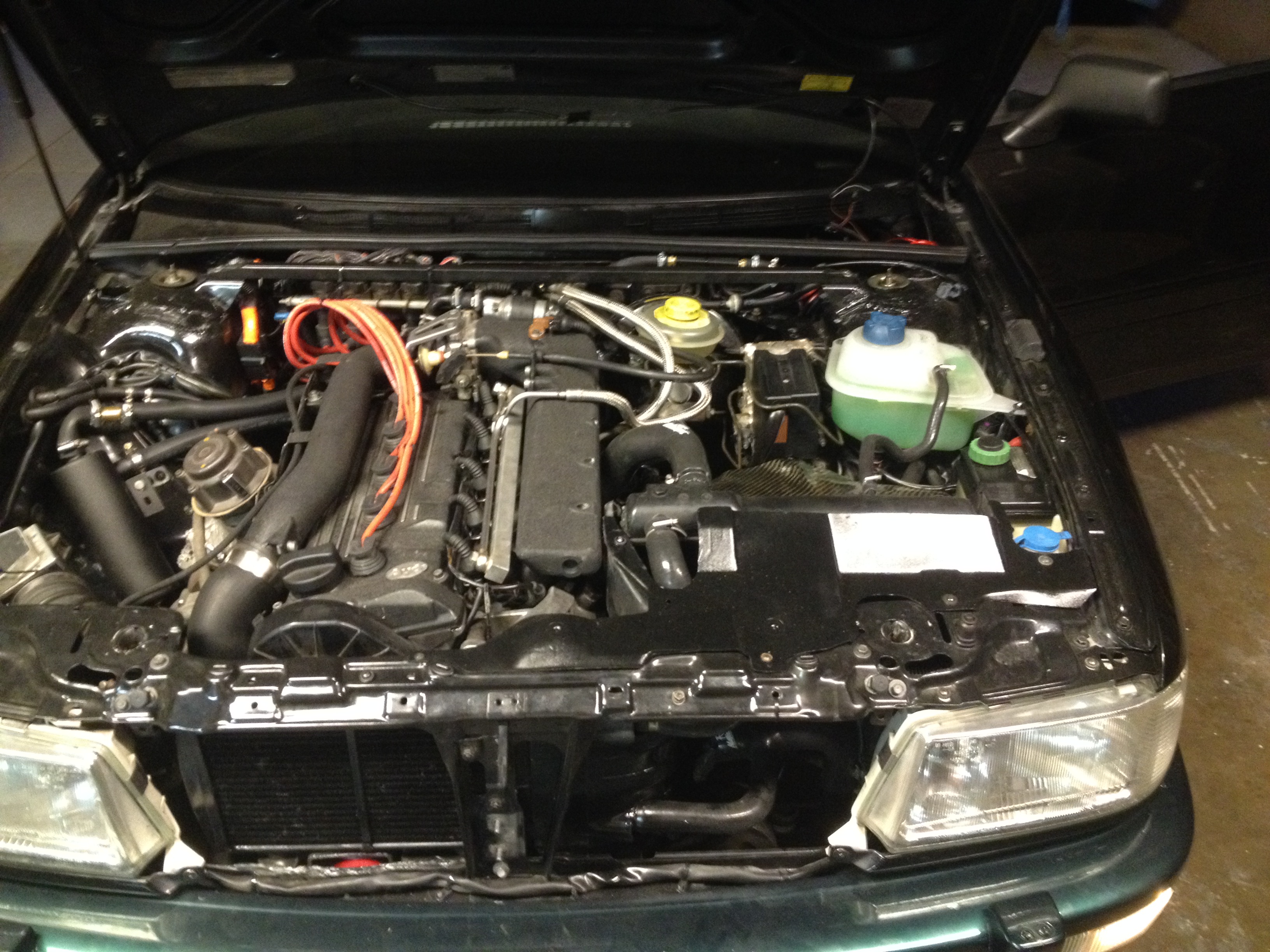

I couldnt get the car ready for BBQ5 however we made it there, and it was super!
Car is running.Electrical problems (gauges, rogue connectors, etc) are fixed, Finally I have illumination, changed almost all the bulbs...
It has 3" exhaust all the way, a highflow cat and a magnaflow rear muffler. It has a nice tone i think, exactly what i wanted, not too deep, or laud
Fixed the vacuum issues too (didnt have enough), I had to tap in 1/4 NPT fitting to the intake manifold and run a hose to the vacuum distributor

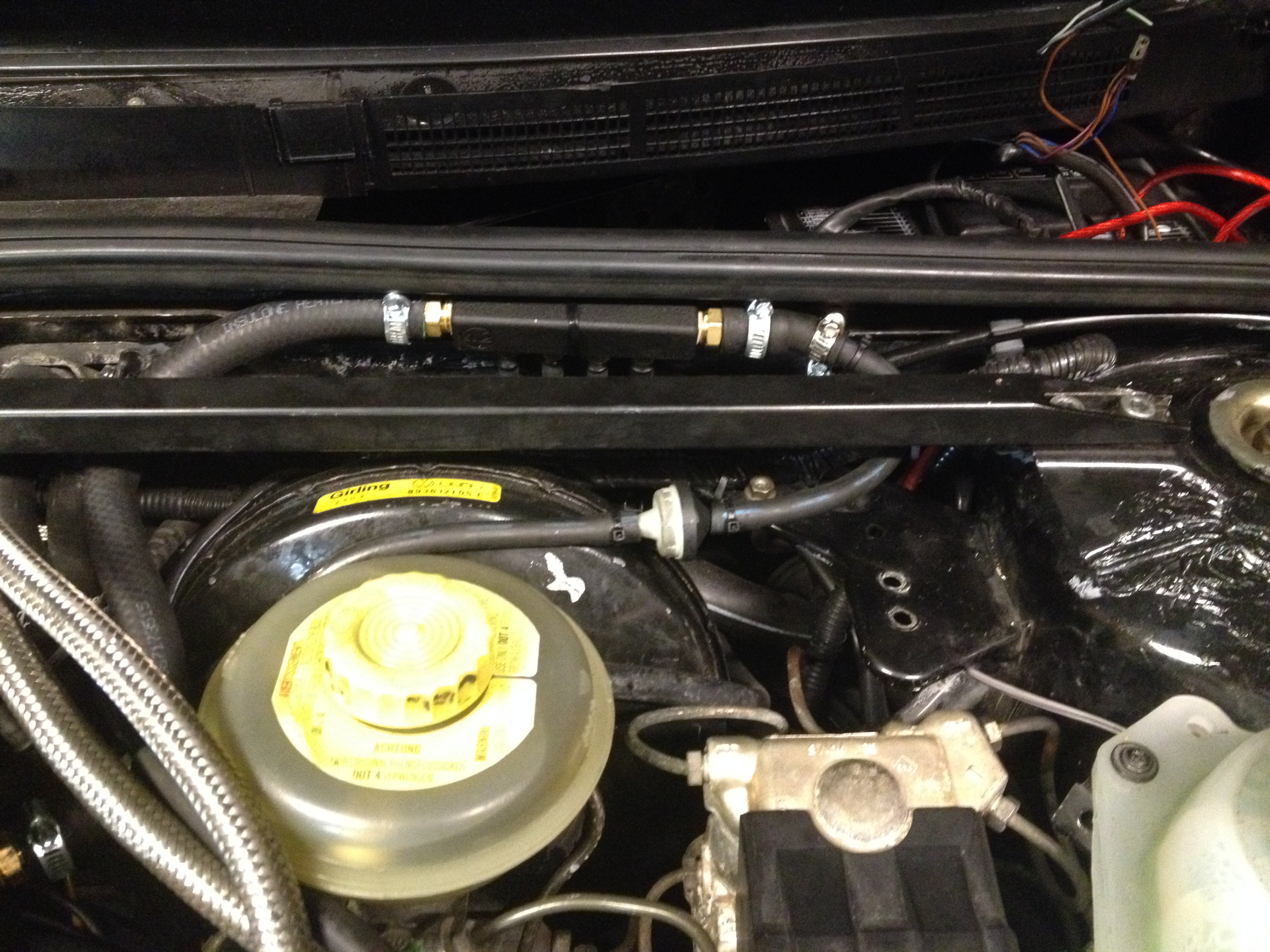

No worries, I should be able to get the PN for that one... The AAN block I have does not come with a sender for the Aux gauge, only a
single prong open/closed switch (pictured on your block below the 2prong).
I purchsed an LHD S2 Harness from germany and it showed up and was just the same harness I had, so I wired the AAN harness into my car, I have to tie up a couple loose ends, one of them being the oil pressure light is on.
How do you like the vacuum brakes?
I also purchsed a B4 90 booster but it was just too big to fit in there, even the 4000 Booster was tight!

#035919561 is the 7A oil "pressure gauge sender"
B4 booster is an inc bigger, thats why i went with one from a B3
Vacuum brake is weird after a good PS brake. Our 1997 A6 has it still, not the same
My brake pedal is firm, but i just dont feel the stopping power, Im not sure if its the booster, vacuum or something else (and my brakes are big)
Maybe i will just install a vacuum pump and call it a day.

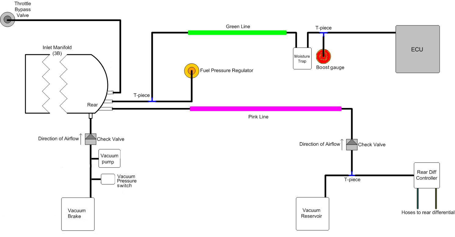

Installed the vacuum distribution log:

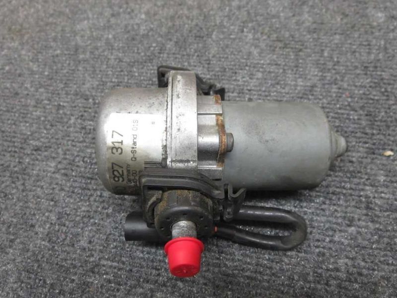

ive got rid off the power ass. brake (bomb) system on my cq. Now I have vacuum booster from a B3 80/90
I re-done my vacuum lines like 3 times, because i think i dont have enough vacuum.
This is my current sutup:
I will modify it, installing a vacuum pump from an later a4, with a pressure switch (first i though i will trigger it via the brake light switch)
8E0927317 2001 a4 vacuum pump.JPG (83.92 KiB) Viewed 41582 times

I use that vacuum pump on my TDI and its been working great for last 3 years... I used a VOLVO vacuum switch, much better than some of the aftermarket crap.
Unless you get a large vacuum accumulator you will hear that pump on each time you press the brake pedal.
HTH

ralleyquattro wrote:I use that vacuum pump on my TDI and its been working great for last 3 years... I used a VOLVO vacuum switch, much better than some of the aftermarket crap.

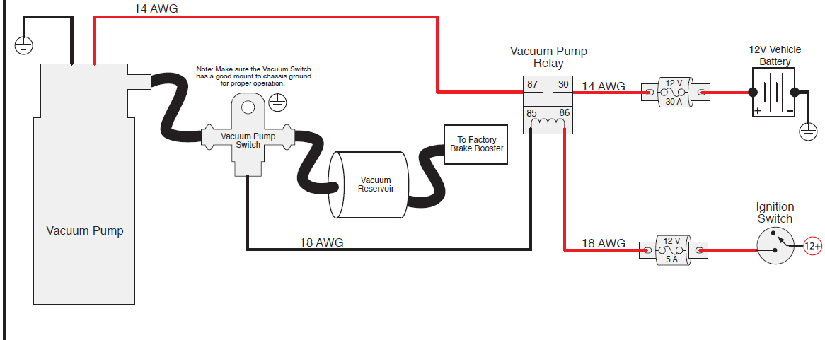

Thank you Martin again! I think i can do the vacuum lines.
How did you wire the volvo vacuum switch?
ignition +12 via 40Amp fuse, to the volvo vacuum switch then to the pump?
Thank you

Vacuum switch is just that.. a switch side (low amps) for the relay.
The power side goes via the relay to the pump.
Remember a 40A fuse in line before the relay.
HTH

ralleyquattro wrote:Vacuum switch is just that.. a switch side (low amps) for the relay.
HTH
got it. I just wanted to know because my vacuum switch has 3 legs, and adjustable
but i just ordered this volvo switch (its much simpler then mine was) , so i will wire it like this
Thank you again!

just found this:
2 build in check valve, 1 end goes into the booster, 1 hose goes to the pump, 1 hose goes to the IM
very simple, i like it
