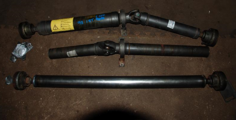

I eneded up working a deal with a friend of mine. we took my car to his shop and he made me a moly 1 piece shaft. I still have to make him a vems harness and tune his shit for life.. but I like to make cars faster. especially on their Dime..

something like this. i gotta get pics of mine in the car. i forgot to when it was on his lift getting done..
