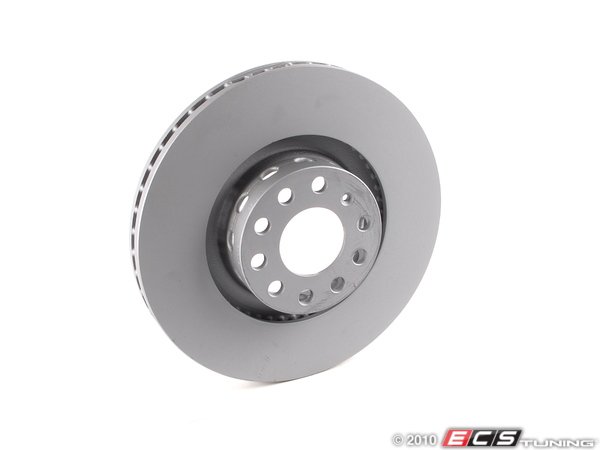

Rotor update, I am going to be about $1200 into a set of custom two-piece floating rotors from Coleman. 336x32 is what I ended up going with. Tough when A8 Rotors are $80 each, but I am hoping to get more consistent brakes out of the deal. The A8 rotors are really poorly vented.

audifreakjim wrote:Rotor update, I am going to be about $1200 into a set of custom two-piece floating rotors from Coleman. 336x32 is what I ended up going with. Tough when A8 Rotors are $80 each, but I am hoping to get more consistent brakes out of the deal. The A8 rotors are really poorly vented.
Thanks for the update Jim. If you look at the A8 rotor, is there enough meat to drill out the vents bigger? and is there also room around the inner part of the vent to clip on a simple fan to push a larger volume of air through it? I know drilling the vents may not help as the drill will smooth out the porosity and abillity to cool better. I dont have those rotors so I cant see what they look like. can you take a few pictures of the rotor off the car, and on the hub showing how much room there is on the inside over the hub to see if a fan could even be an asset to help?
Posts: 2142
Re: BIG brake options
That is the problem, the venting is on the outside of the hat, so it's impossible to run brake ducts.

those can be covered pretty easily.
Posts: 2142
Covered?

08+ E350 rotors are 322x32mm and rear vented, but the rotor centerline is ~5.8mm deeper than the A8 rotor. You could space your caliper adapter off 5-6mm from the rotor to account for this. You'd also have to machine the center bore from 67 to 68mm. If your calipers can fit a 32mm rotor this might be worth looking into.

yeah, sorry Jim. I wasn't thinking when I saw that picture and thought the holes next to the hub were the problem. It didn't dawn on me until I was headed somewhere that the vents were on the outside, and not the inside. we need a Brainfart emoticon. 1200 is pretty hard to justify for me for just rotors.
If that other option can work, that may be a good reason to build the adaptors to the correct dimentions. thanks for the option Alex
