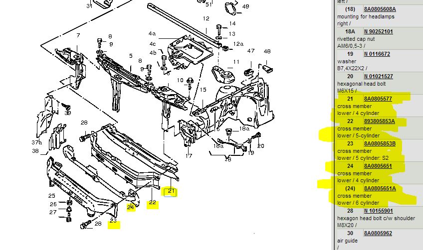

Not true. Without the bumper support ("rebar") there is nothing forward of the engine to distribute load across the chassis in the even of a crash. European cars got a bumper support, it was just fixed directly to the chassis rather than to gas struts (**Edit** - I think this is the same as the NA b3 80/90 front bumper support). You can see the exposed steel bumper support in this picture of a wrecked european Audi 80:
Image[/url]wrecked Audi 80 B4

That's a cross member (the one in your pic looks like #21 below), all B3/B4s came with a version of one depending on engine; independent of the extra North American (Canada seems to have gotten "US" spec) impact bar housed in the unique non-"euro" bumper.
As seen here:

Alas you are right- that is the cross-member. :hammer:
That said, I still wouldn't run without the bumper support... but I'm rather fond of being alive and having the ability to walk so maybe I'm an outlier here. ;)
