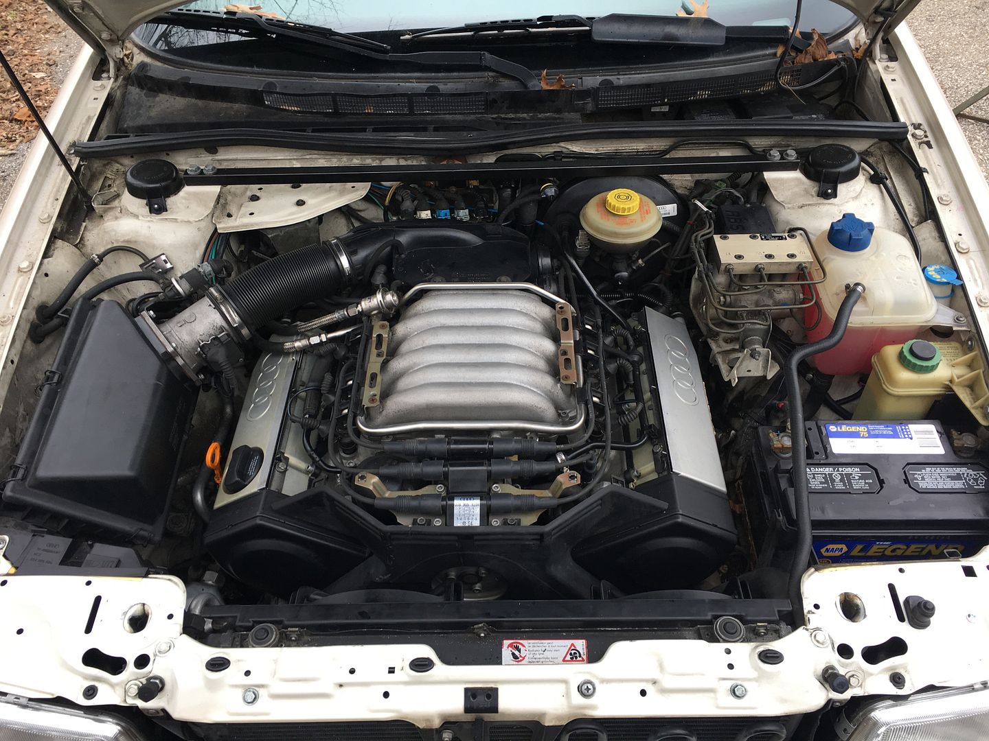

Re: Ben's 95 90 Quattro

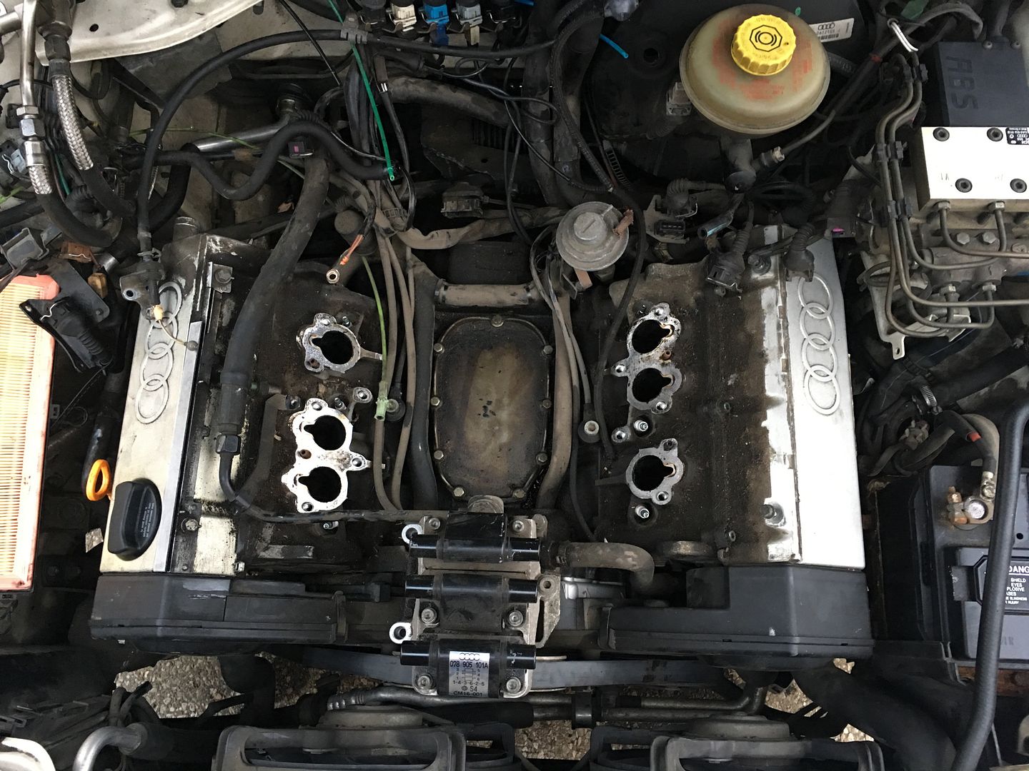

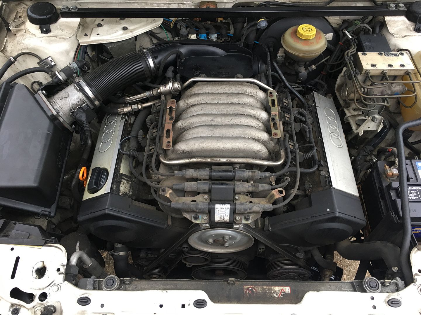

Started some things to get the V6 in good shape for the short term this weekend.
Got the Timing Belt changed yesterday and I think it was a really good thing I did it too. Found a few things in bad shape. The TB roller and tensioner were both really in poor shape.
the bearing on the serpentine belt tensioner was shot too. Found a replacement for that at Autozone since I didn't plan to replace it already.
The other issues are that the coolant was yellow (prestone?) and the engine bay is super dirty.
the new TB is in and working well. the engine is SUPER quiet now with all the bearings on the rollers in good shape.
I was looking at the engine and the only possible explanation I can find for such a broad swath of dirty oily mess is that the PS pump is spraying a little bit. It does have a wet spot around the seam on the pump so I ordered a rebuild kit (https://www.amazon.com/Edelmann-8842-Po ... 90+quattro)

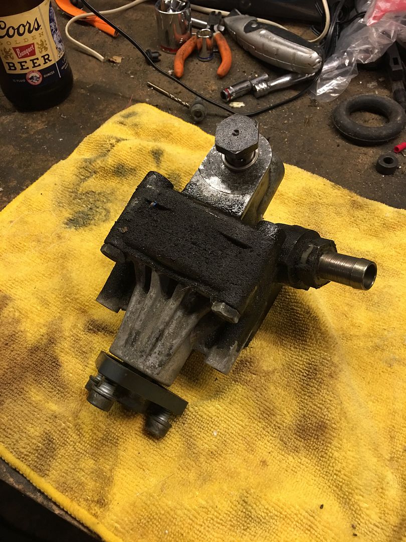

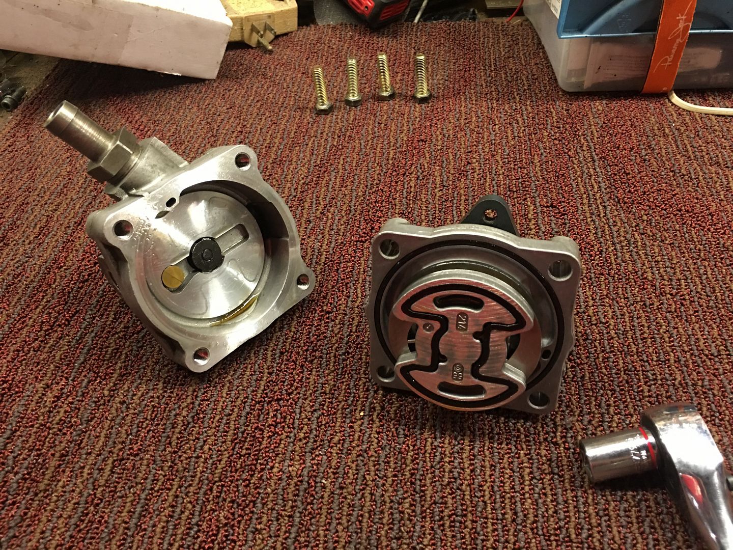

Got it all taken apart and it seems like I'm right about the PS pump being the issue:
Also, I had no heat before the TB job and still don't. when the car is running there is no flow at the bleed point to the heater core. I'm hoping it just needs a better bleed but I'm going to flush the old coolant out of it tomorrow too.

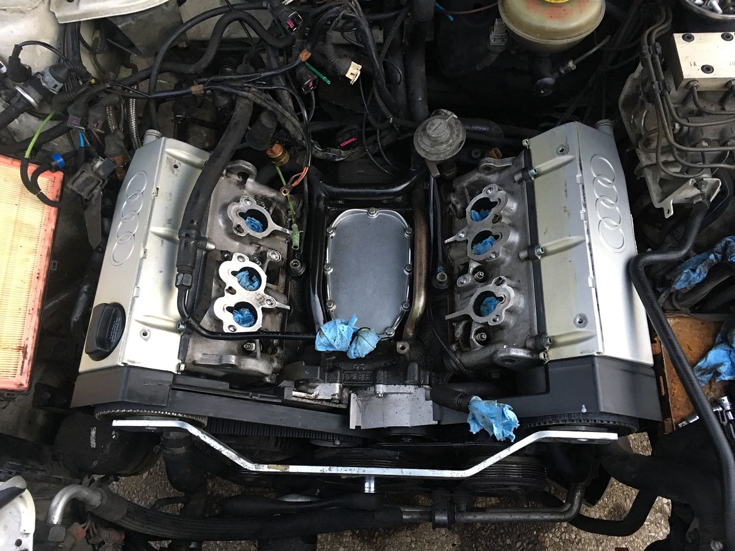

That gunk in the valley could also be engine oil squeezing out of the gasket between the block and the valley pan. A common oil leak spot in the V6. When I had my AAH, that is where the biggest leak came from if I revved it over 4000.

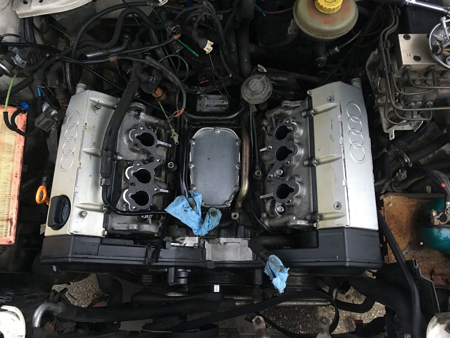

More progress...
The heads have now been gasket matched:

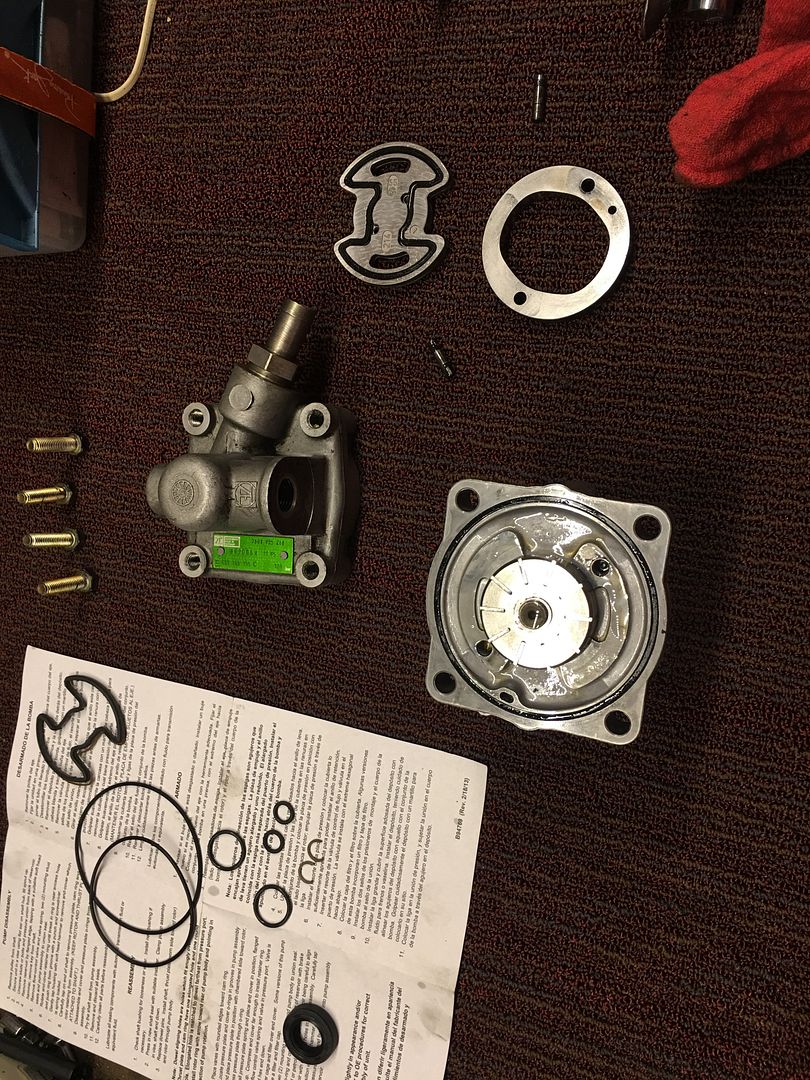

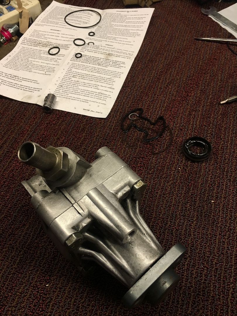

The Power steering pump has been taken out and a new seal kit installed. I bought the Edelmann 8842 per everything I could find but the main shaft seal was too small. I found that the 8841 had the correct seal. I did the disassembly and in wasn't that tough. I believed the leak was from the main big o-ring but the metal seal helper inside was broken.
All Cleaned up:

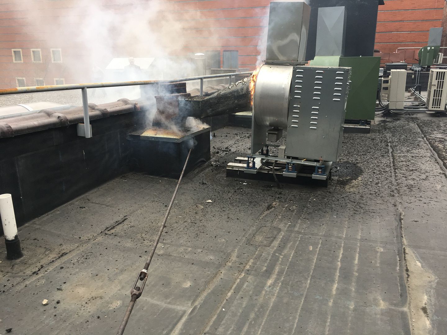

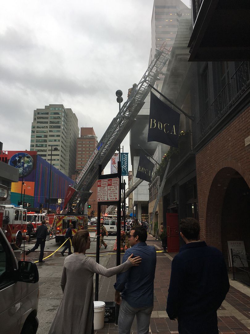

In much less fun news, I found out what happens when one of the restaurants hoods catches on fire:
All Cleaned up:

oh dear.
hope that wasn't too damaging. guessing some water and smoke damage?
Fire dept was remarkably restrained. They only used water from the roof into the duct so none got into the restaurant.
The fire was in the hood from the wood fired grill in the basement which is in "Sotto" restaurant. The hood duct goes up through two stories of "Boca" restaurant which is where the walls got ripped apart a bit and all the smoke damage was. Lots of holes in walls to get to the duct but not much else. We got really lucky.
No sprinklers or kitchen ansuls.

You get creosote and grease in the hoods in a restaurant, just like build up of creosote in the chimneys in a house. If you don't have them cleaned out now and then, they will catch fire.
A fire waiting to happen.
Greg W.
Greg W.
90quattrocoupe wrote:You get creosote and grease in the hoods in a restaurant, just like build up of creosote in the chimneys in a house. If you don't have them cleaned out now and then, they will catch fire.
Greg W.
The hoods are cleaned once a month. I can only speculate that they've been doing a poor job.
That's had to be the source of the fire.

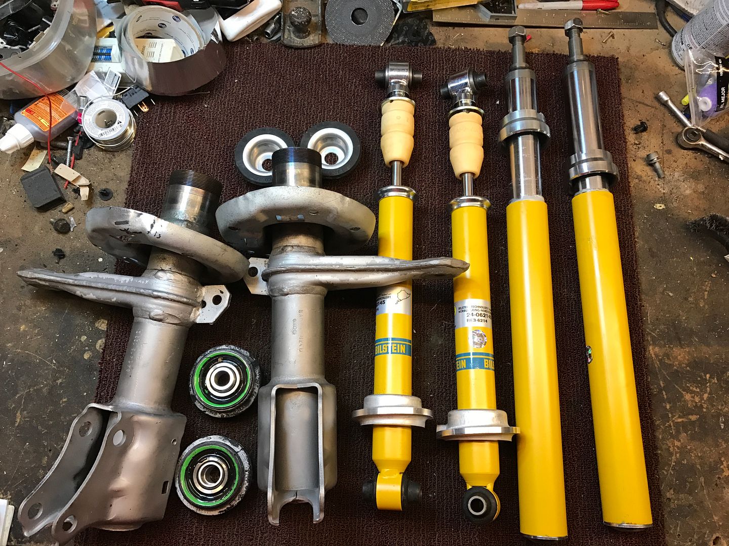

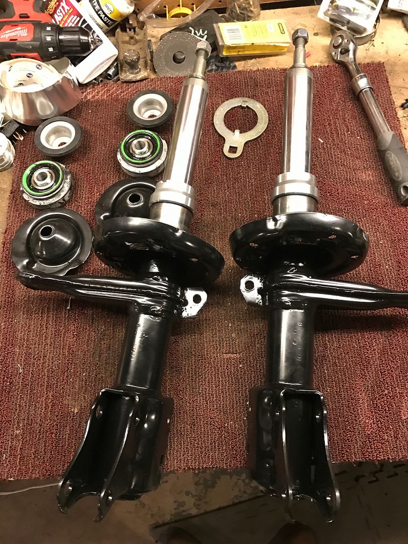

Bought an unused set of Mance Pro-Mounts along with the BBSE (Big Bore Strut Extenders) so I could use URS struts in the front. I upgraded to B5 S4 struts in the rear which are supposed to feel like the URS fronts.
Part numbers are:

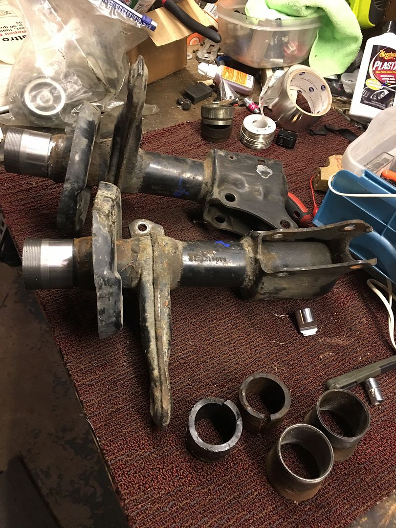

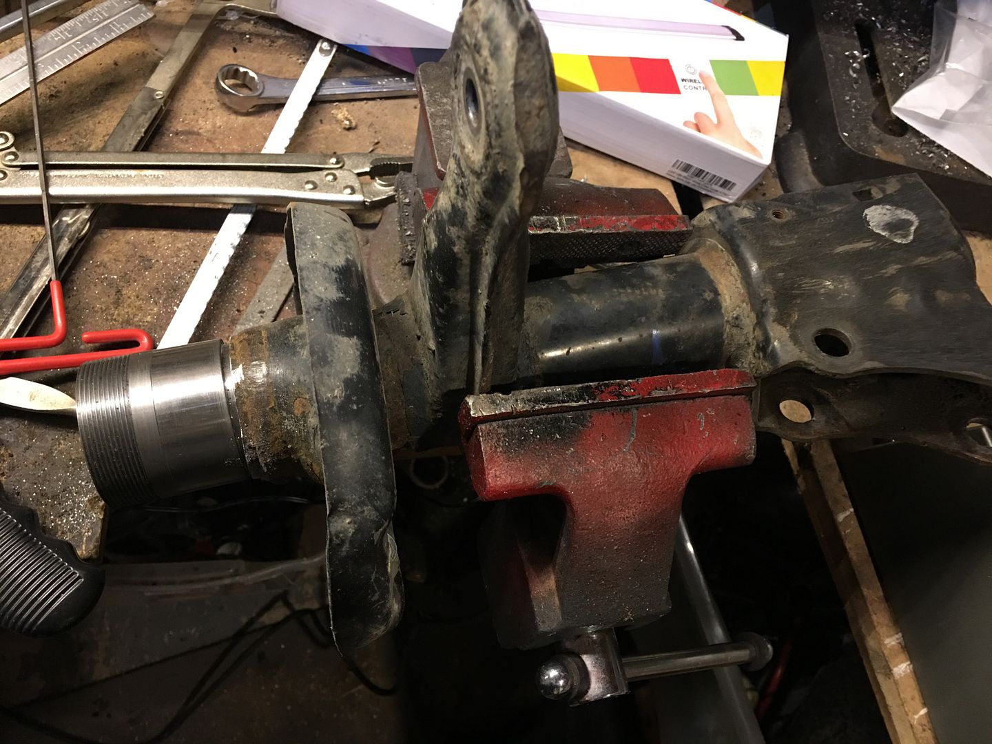

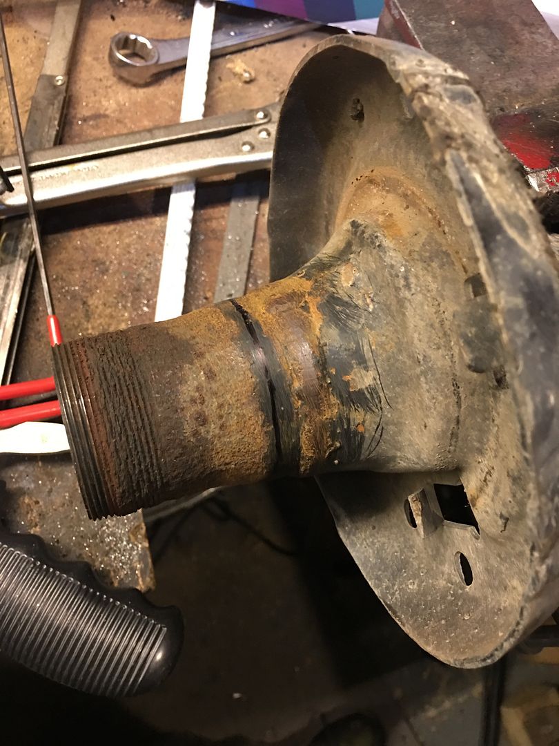

I grabbed the front strut uprights off my old car at the junkyard (which is now gone and crushed) and did them up.
Cut off 2" of old narrow strut tube:
Put in the BBSE's and made sure they were the same 14" depth as the old setup:

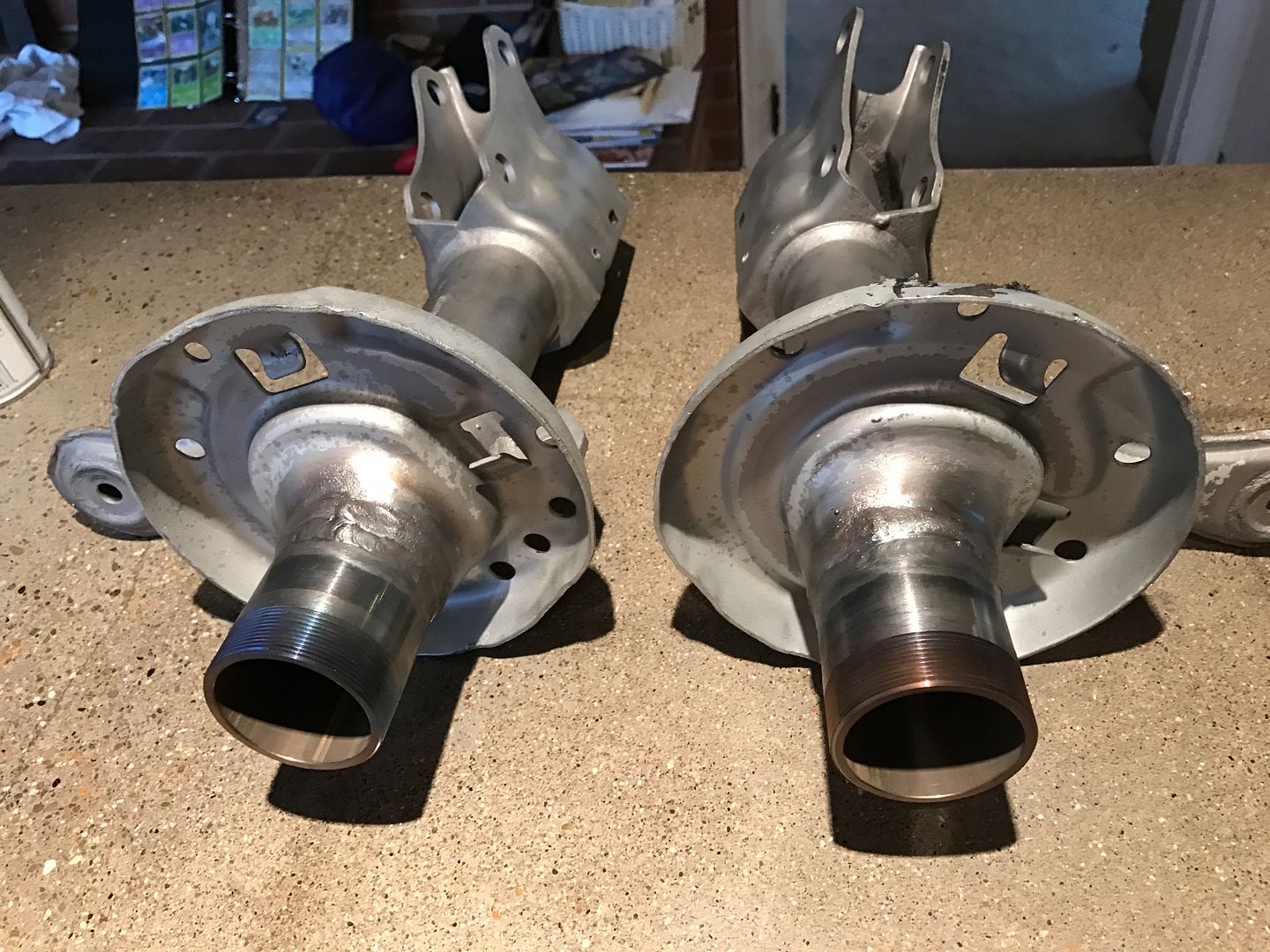

I sent them off to be welded by a guy here locally who also sandblasted them so I could get them powdercoated:
I ordered new spring hats (part # 893412113 - http://www.midatlanticaudiparts.com/p/C ... 12113.html) because I forgot to take those to get blasted and I'd rather start with good ones for the powder coater.
I am hoping to get this all installed in the next couple weeks. I'm out in England/Ireland for the next week or so but after that it's my first priority. I'm also still working on 5 cylinder swap parts and some other fun stuff.
Part numbers are:
