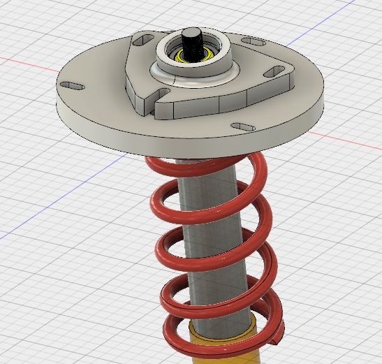

I may be picking this project back up again on my end. I have what I think is a good design for this. I came up with it a few years ago but never got to test it after the first attempt. I am purchasing a CAD suite, and my motivation for this has been rekindled a bit now that I have another T44. I may need some volunteers at some point to test fitment, take measurements, etc. If I get started on this again soon, I will make a thread about it.
Re: UrS4/UrS6 camber/caster plates for coilover setups...

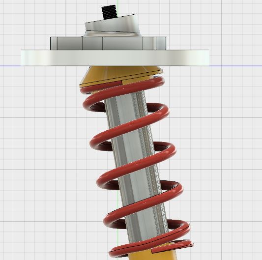

Here's a preview of what I was working on before. These are geared toward suspension travel as a priority. I may make some fundamental design changes to increase adjustability and fail-safe mechanisms. One of the most important aspects of the design is the angled spherical bearing mount. That helps keep the bearing in the middle of it's travel for proper loading and maximum adjustment range. When making a "straight" mount for a spherical bearing, the bearing will be almost at it's full range of motion while sitting at stock camber position.

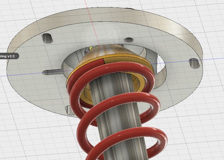

This is the advantage of this mount. I still have to model lower profile hats, but you get the idea.
