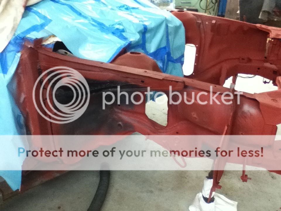

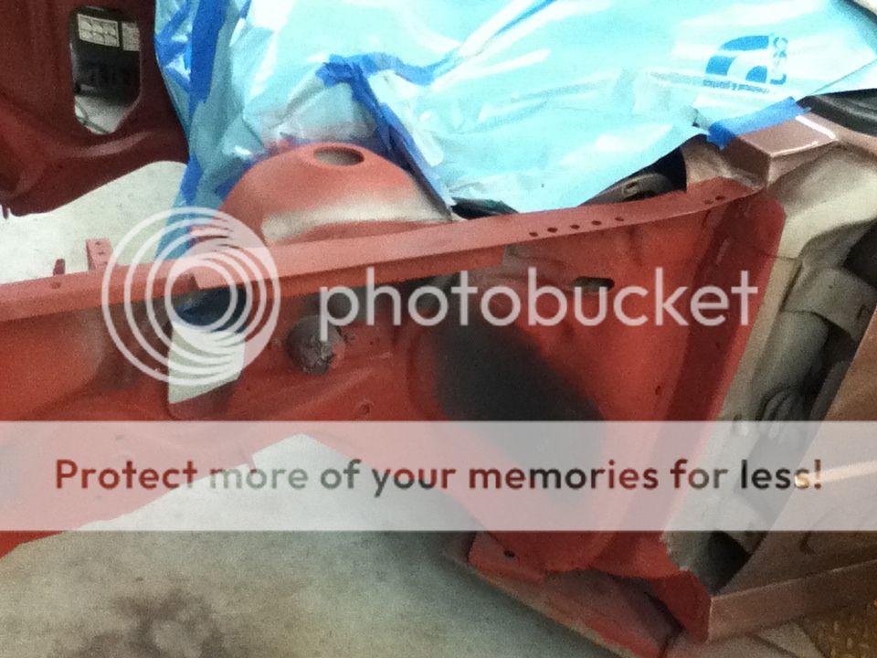

Do yourself a favor and pull the fenders. I thought my car was rust free in the front end and was advised by someone to pull the fenders(I was like meh why? This thing is clean!!!) and found a lot of rot on the braces.
Ended up pulling both sides and sand blasting/cutting the rust out and repainting the entire engine bay(and installing an AAN). Makes it easier when I repaint the entire car, dont need to pull the engine again.

Yeah, I've pretty much come to that conclusion and will be pulling the fenders and fixing what's underneath, even if I don't repair the fender itself until down the line.

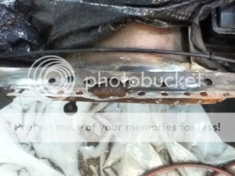

Pulled the fenders after work tonight. The passenger definitely seemed like it had been pulled before...probably because of the accident it was in at some point on that corner.
First glance things definitely looked a lot better than I expected.

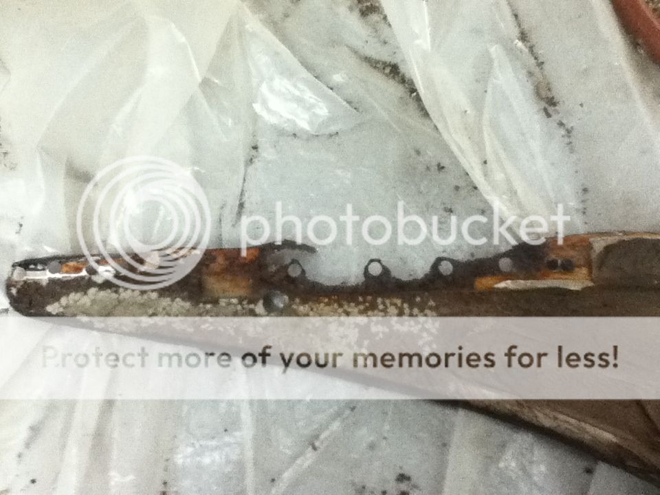

Scraped off the seam sealer and knocked away some of the metal to expose more rust. Still, overall I am happy that I didn't find more! It's all very fixable.

And of course I knew the driver's fender was shot due to the giant bubble. That broke loose during removal. I plan on picking up a replacement fender though.
