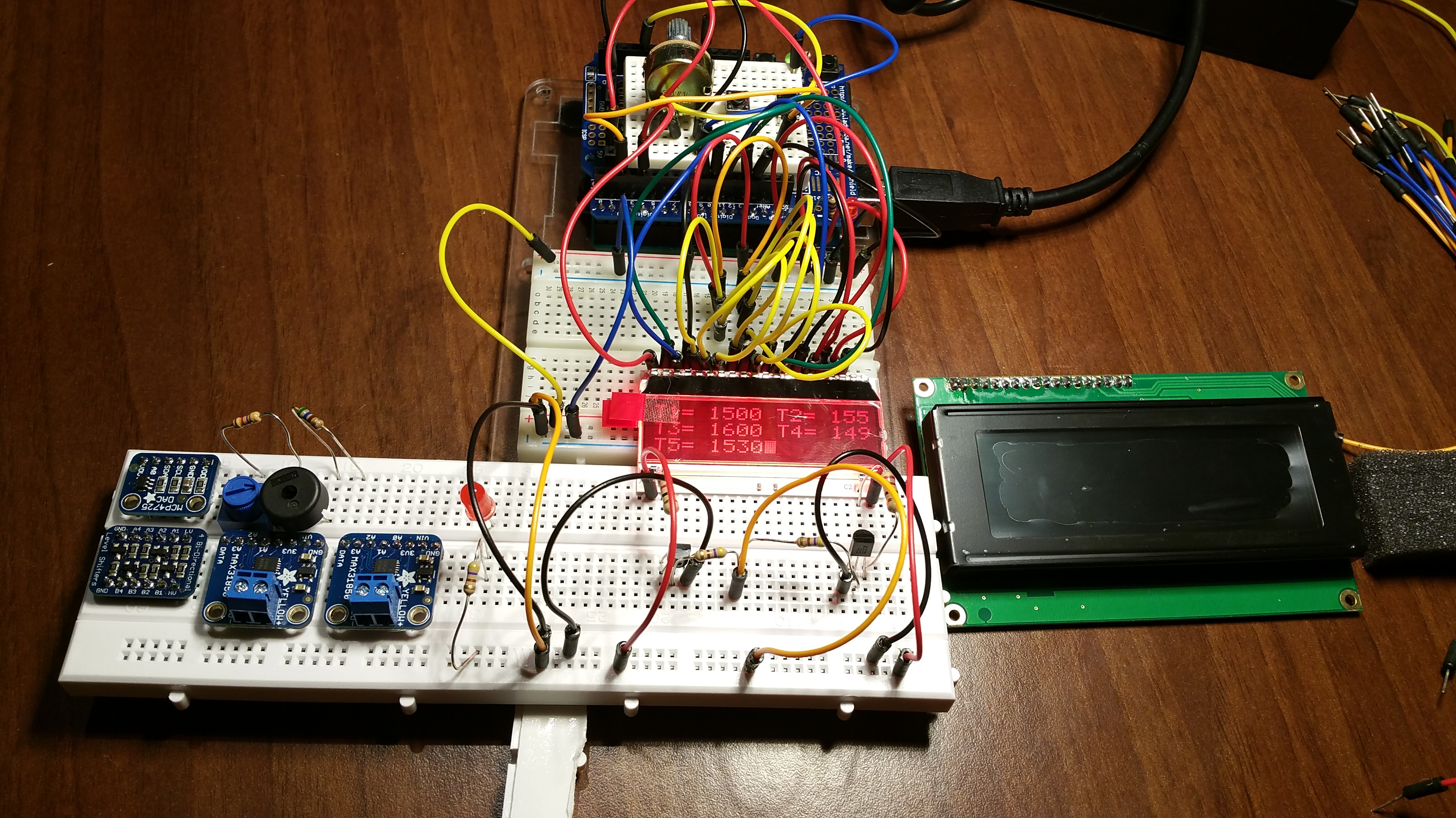

It has taken me a little while to get this thing figured out becuase the documentation is awful, but now I believe I've come up with the smallest possible solution for the display while still retaining all the features I want.
More than 6 channels will require the 4 line screen or will require switching the display between two sets of sensors periodically.
This screen will require some kind of small board behind it just for an interface to a connector, and for mounting, but the package will still be waaaaay smaller than a normal 4 line LCD.
Now I need to denounce the buttons used for menus and settings and add the ability to save settings into memory.
Oops, I just realized the temperatures are getting cut off in the picture haha. Too much spacing.

The first 5 channel amp was completed and sent to me this week. I will be able to take delivery of it in a few weeks (I'm currently in Houston). I hope to make some more progress on the code tomorrow. The program runs on the smaller LCD now (that's what I did last Sunday), and now I just need to refine it for use with menus and settings. I hope to knock most of that out this weekend.
I'm posting in celebration of FINALLY figuring out how to debounce the buttons and create settings menus on the LCD. With normal push buttons, the button will register the initial press, but then will register several more presses due to the springiness of the internal mechanism. So you can actually have the button press register many times in the code when you only pressed it once. That sucks! It makes for a program that seems really buggy. But I've fixed it now :)
Now I have to figure out what settings I want to allow and how to store them into memory. Also, how to adjust each setting. I'm fairly certain I'm just going to use two buttons to control everything.

Very good progress made today. Software-wise, all I have to do is:
-figure out how to put and get settings into and out of memory
-program the peak and hold function
Everything else is in and fully functional! No bugs!
I also tested out the alarm functionality. I bought a bunch of piezo buzzers at Radio Shack and MAN did I find a loud siren one haha. I figure we need as loud as we can get with our open downpipes and stuff since we are such hooligans around here. You can use any buzzer you want though.
