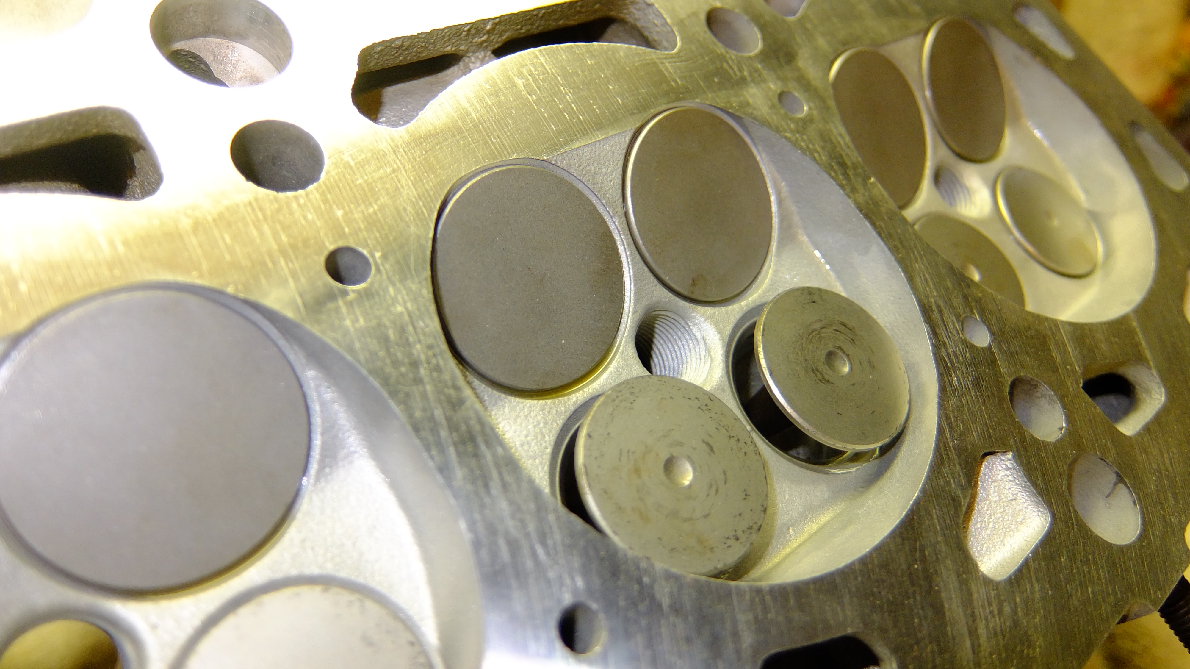

Just had a valve job done, removed some valves to look at the ports..
How come there's pitting on the backside of the intake valves???

Numero dos,
Should I remove the substantial lip that surrounds the intake valve seat?
Is this normal? Is there a ridge because the seats were cut deep because of wear?
I tried to grind some of the lip off on the left side intake valve, I need to get a smaller bit and use a Dremel.....

normally not a problem unless it occurs on the seats. But i would change it since it out, happens all the time cos those are not stainless steel valves.
and for the head, one of my aan head looked like this. so i think yours sitting a little bit deeper
