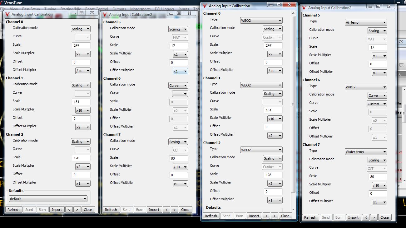

I really like the new, from 1.2.9, boost PID options so I'm going to try and stick it out. My MAT seems to be acting up as well, not sure what setting could have changed there. Still trying to figure out what settings to use for the wideband.
:EDIT: What should Analog inputs look like the new version has a function drop down (Old left & New Right):
Re: Firmware Update?
VEMS Support forum says to use heater ri target of 180 and the standard wideband settings for everything else for v 1.2.x.
http://195.159.109.134/vemsuk/forum/ind ... 55.15.html

In same boat for wideband, readings not working atm, not sure why, still haven't tried recal tho. I do have a narrowband connected also in aan harness maybe that doesn't help.

I started playing around with the newer firmware in VEMS Tune (not loaded on the ECU yet) and I can't even choose the correct ignition outputs. There's no option to choose stepper output push/pull. Am I missing something real simple here?

I got wideband working today with that new firmware, turns out the brand new sensor was no good.
