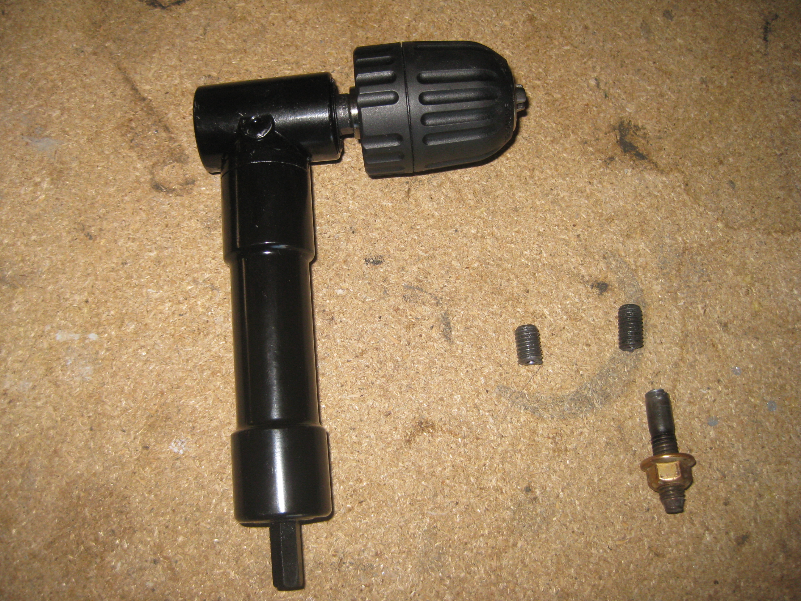

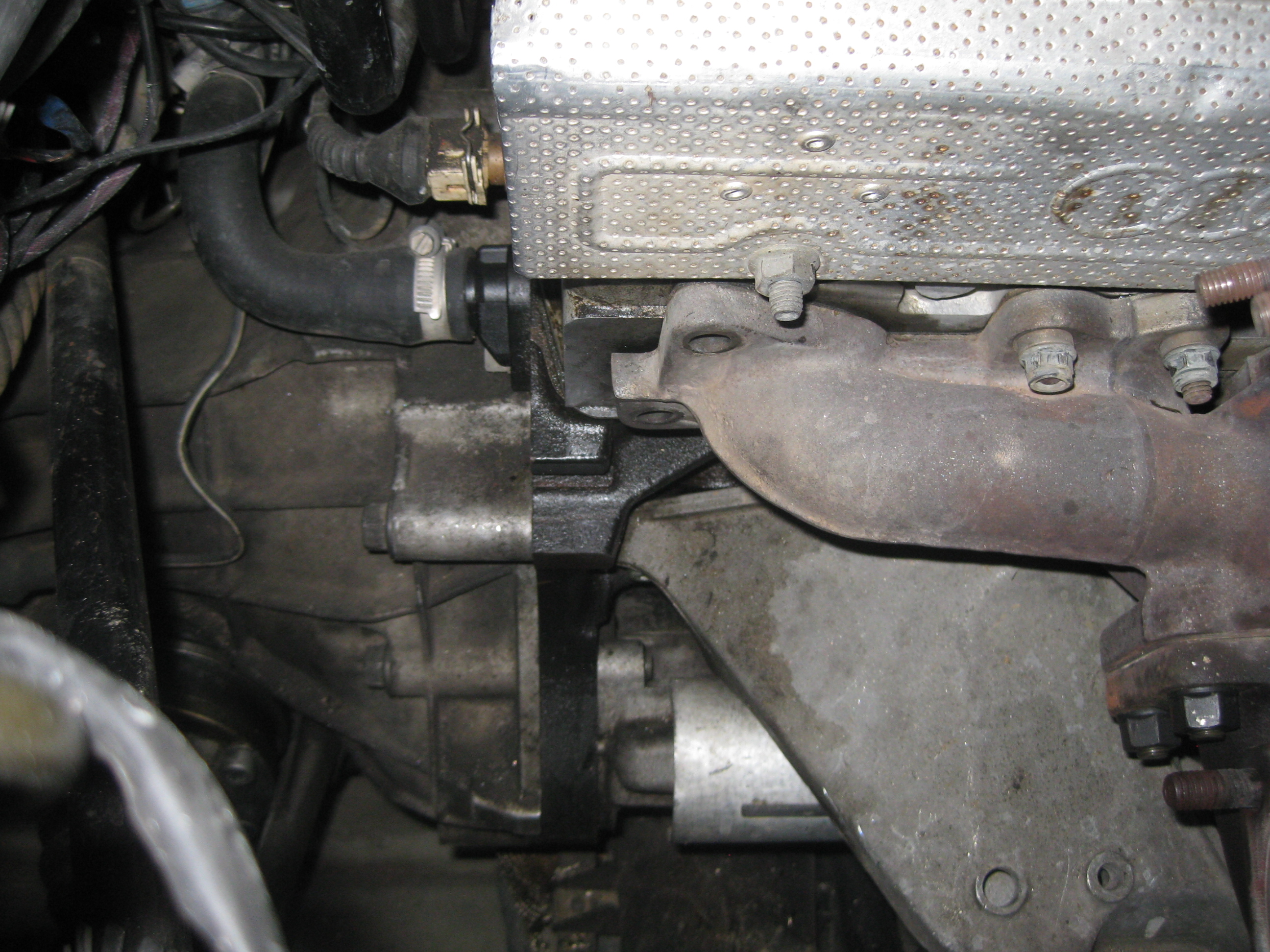

Re: Andy's 95UrS6 Broken EM studs..
Post by A20V200 »
So I had a second EM stud break off in the same area. Decided to take a shot at drilling them out while the head is still in the car. Against a lot of people that said " hell no...I wouldn't do it"....I did it anyway with success on both broken studs. The biggest PITA was removing the DP to get better access to drill. They came out rather easily. With a 90 degree drill from HF and a borrowed set of drill extraction bits...15 minutes later and some helper hands from the wife...done deal!!!
