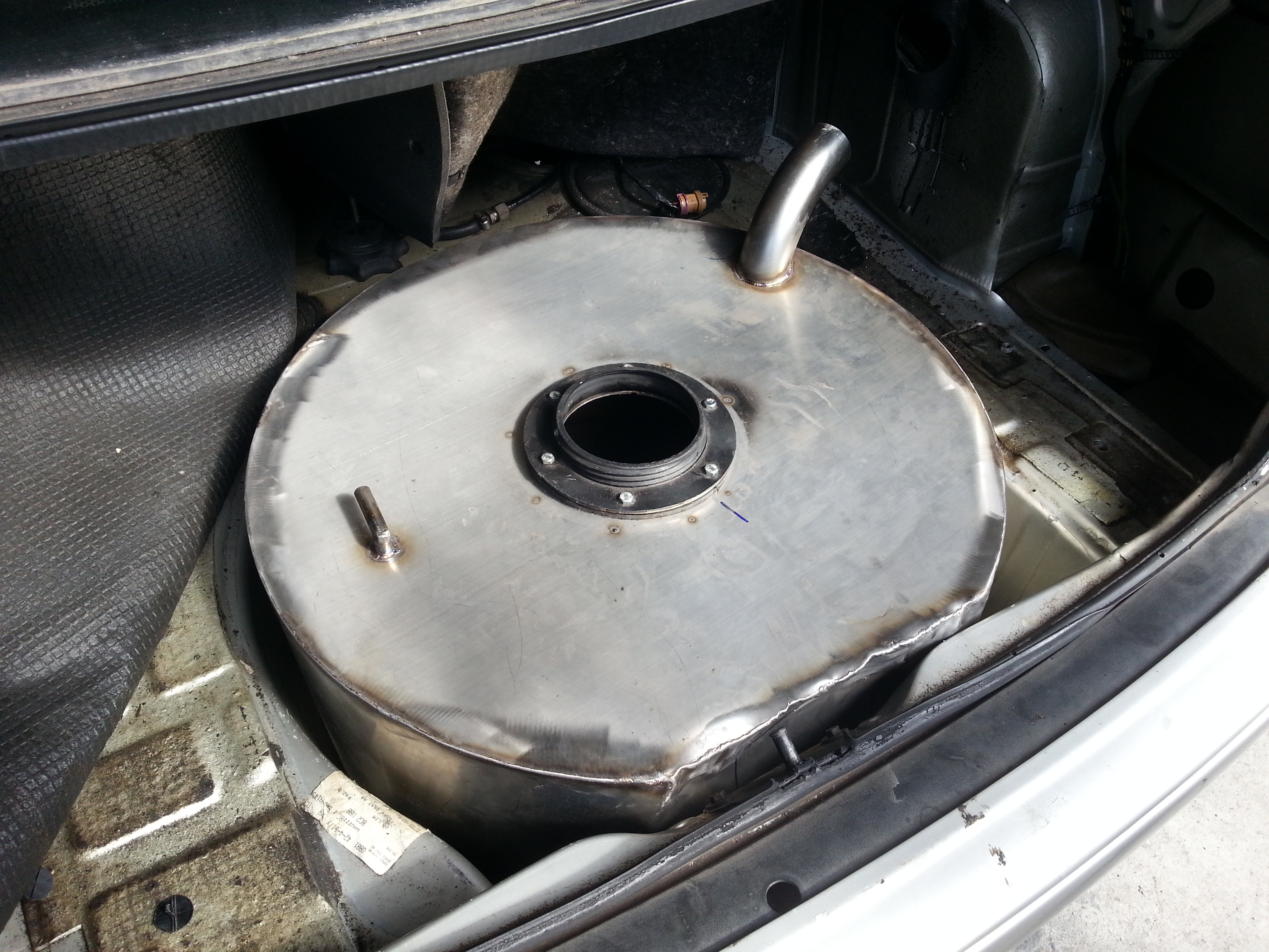

Went to start the fuel tank work today. My buddy and I butchered my old FWD tank for the fill nozzle, the access hatch with the thread and the basket inside was cut out/off.
The exhaust shop will make a round SS tank which will sit in the spare wheel well. Should be about 59 liters...
EDIT: Oopsie, got my Volume formula mixed up. Tank will be round with a diameter of 63cms and 30cm tall. So, not 59, but 93 liters!
That's about 25gals American... Is that too much?
Right after I put it in 5ht, there was a very nasty noise from the right front wheel. Could not brake as that made it worse.
After rolling to a stop I looked, but could not see any thing. I thought a pad or something had let go. Turns out it was something. The bolts for the caliper were loose and one had worked itself out. That was easily fixed.

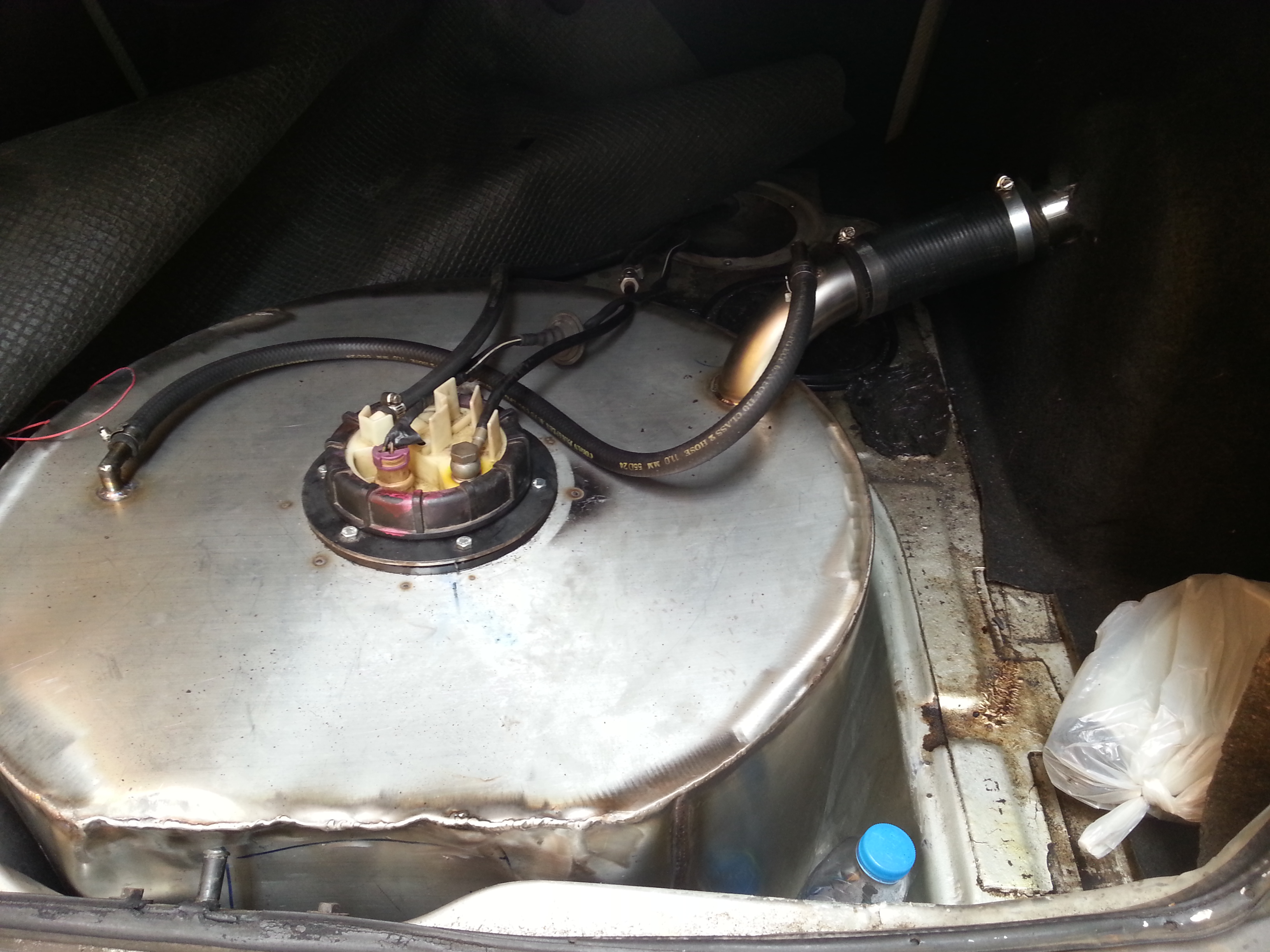

Re: B4Q 80-AEB> Fuel tank in, Stage 1: done
SS fuel tank is in! What a job...
Will post up some pics later.
Oh, its LARGE alright.pilihp2 wrote:That is a LARGE fuel tank. I thought my 18.5 gallons for my 5000 was big.
- 20140924_112515.jpg (1.64 MiB) Viewed 68010 times
- 20140923_152034.jpg (2.49 MiB) Viewed 68010 times

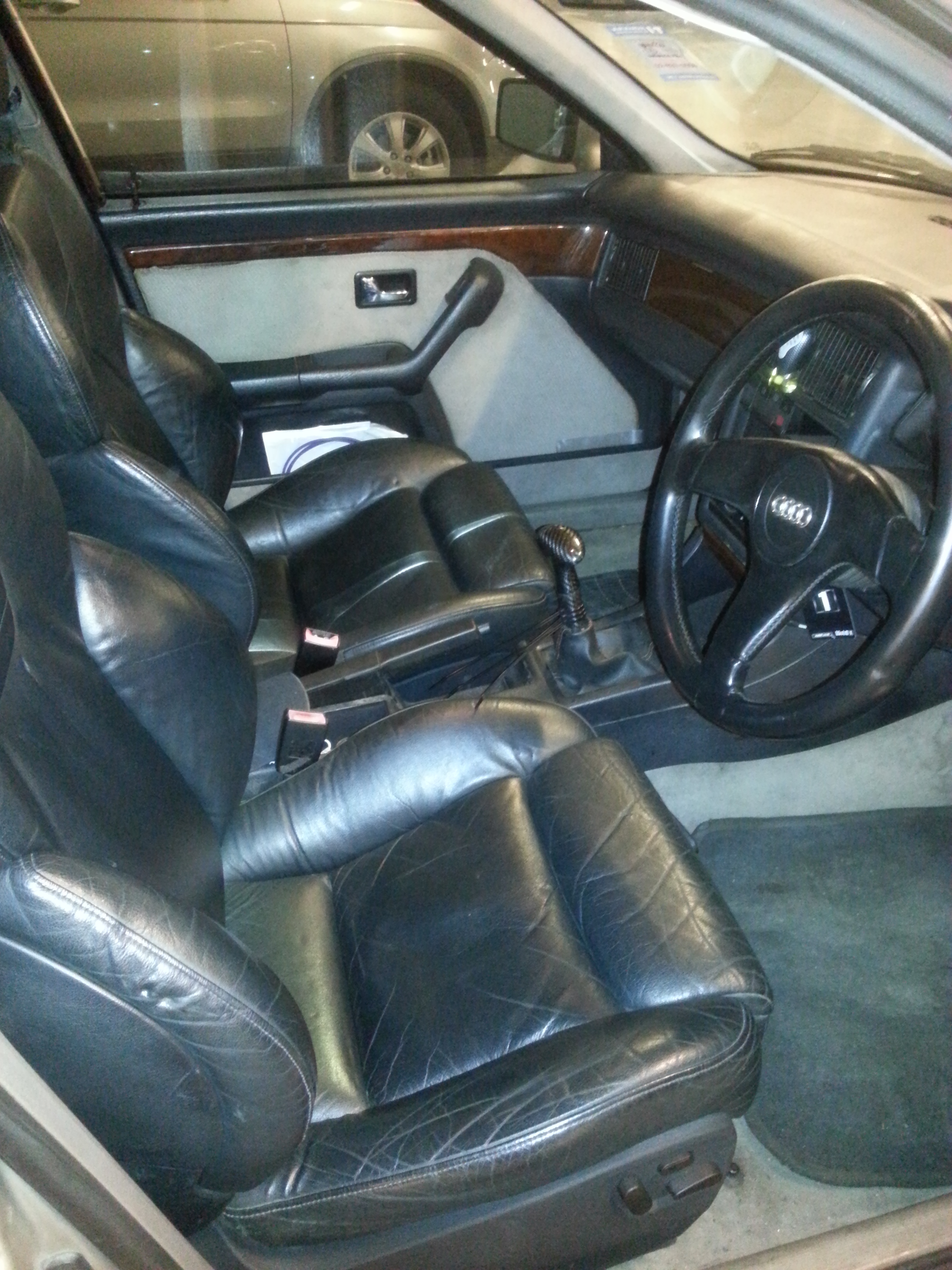

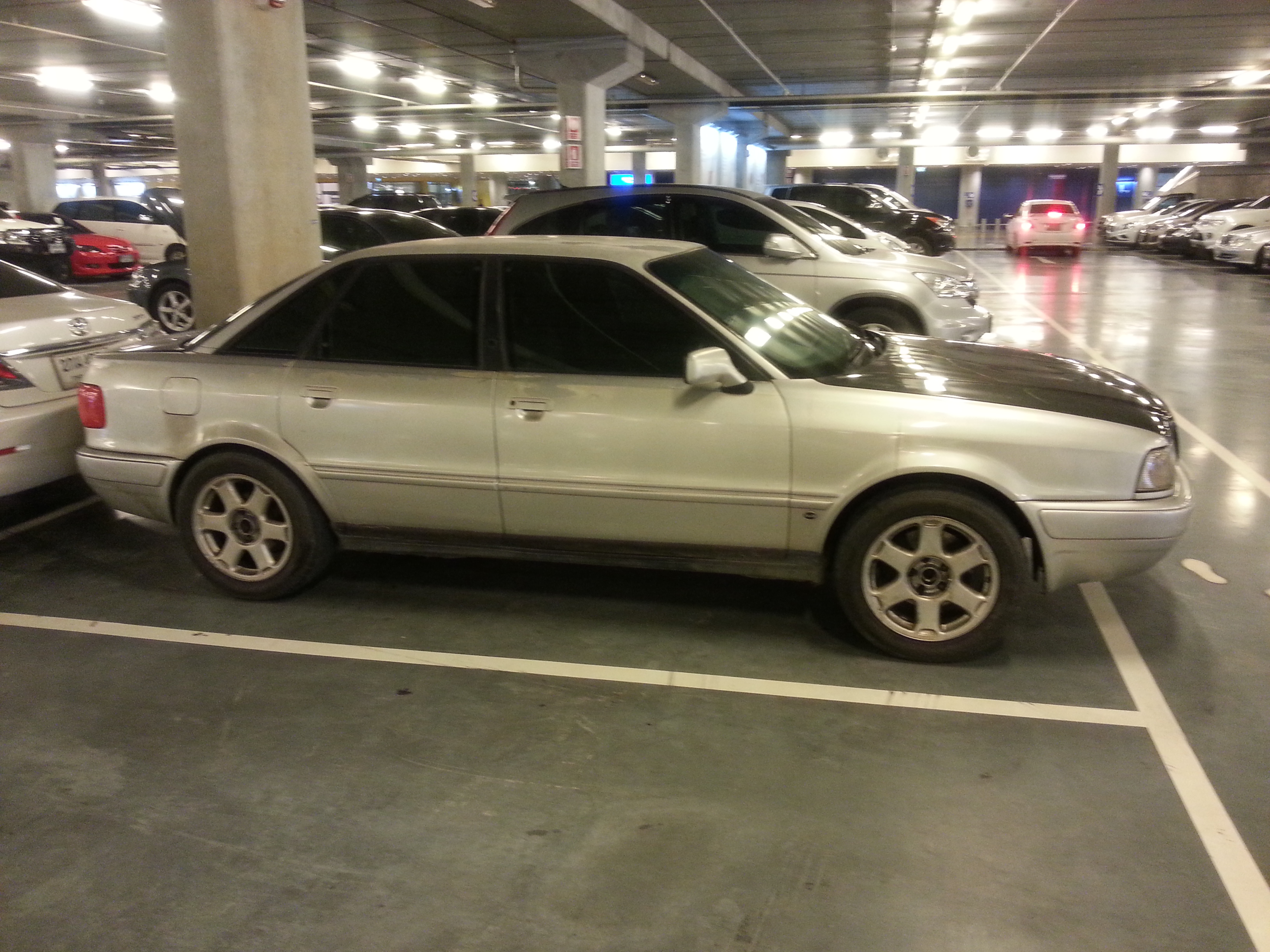

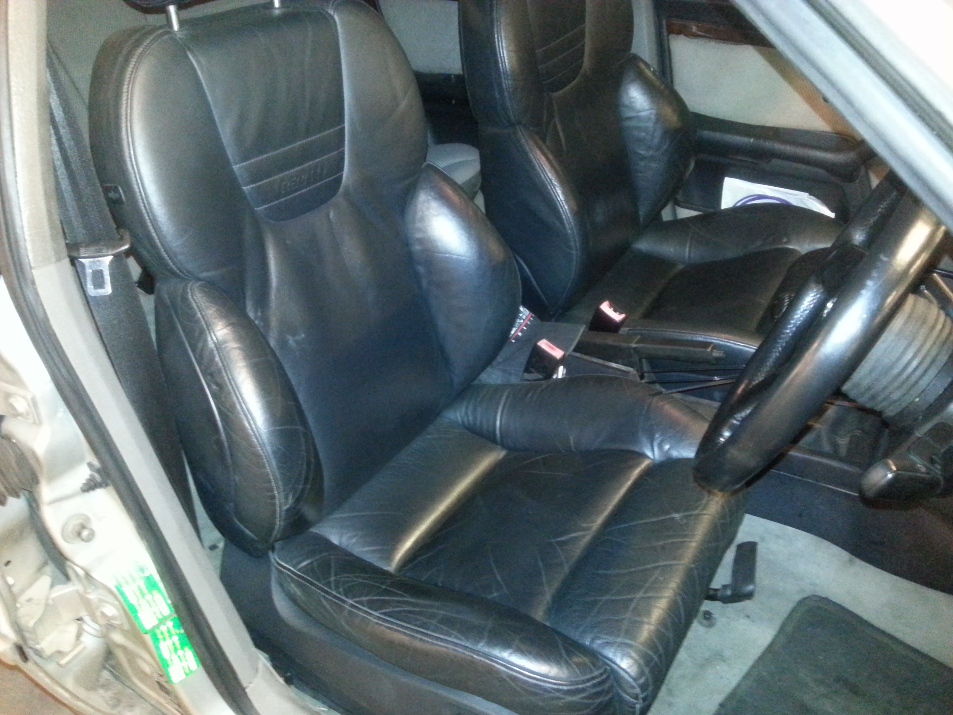

New steering wheel is in. Took the first long test drive yesterday to Ikea. Had all the brake discs cleaned up and new pads on the front calipers.
The brakes are from the B5. Still need to be bled again. I searched some and it looks like it might be a PITA.
K03 is leaking oil, clutch is slipping a little, but it runs real nice on the highway. Wife approves of ride. Not too loud. Love the 4.111 gears.
Next is new clutch.
Stage 2 will be VEMS install, another turbo and IC. Thinking to go with a TD04 15T and a Chinese EM. Those are plentiful here. Getting a K04-15 is just not worth it.
Gratuitous pics as she now sits.
