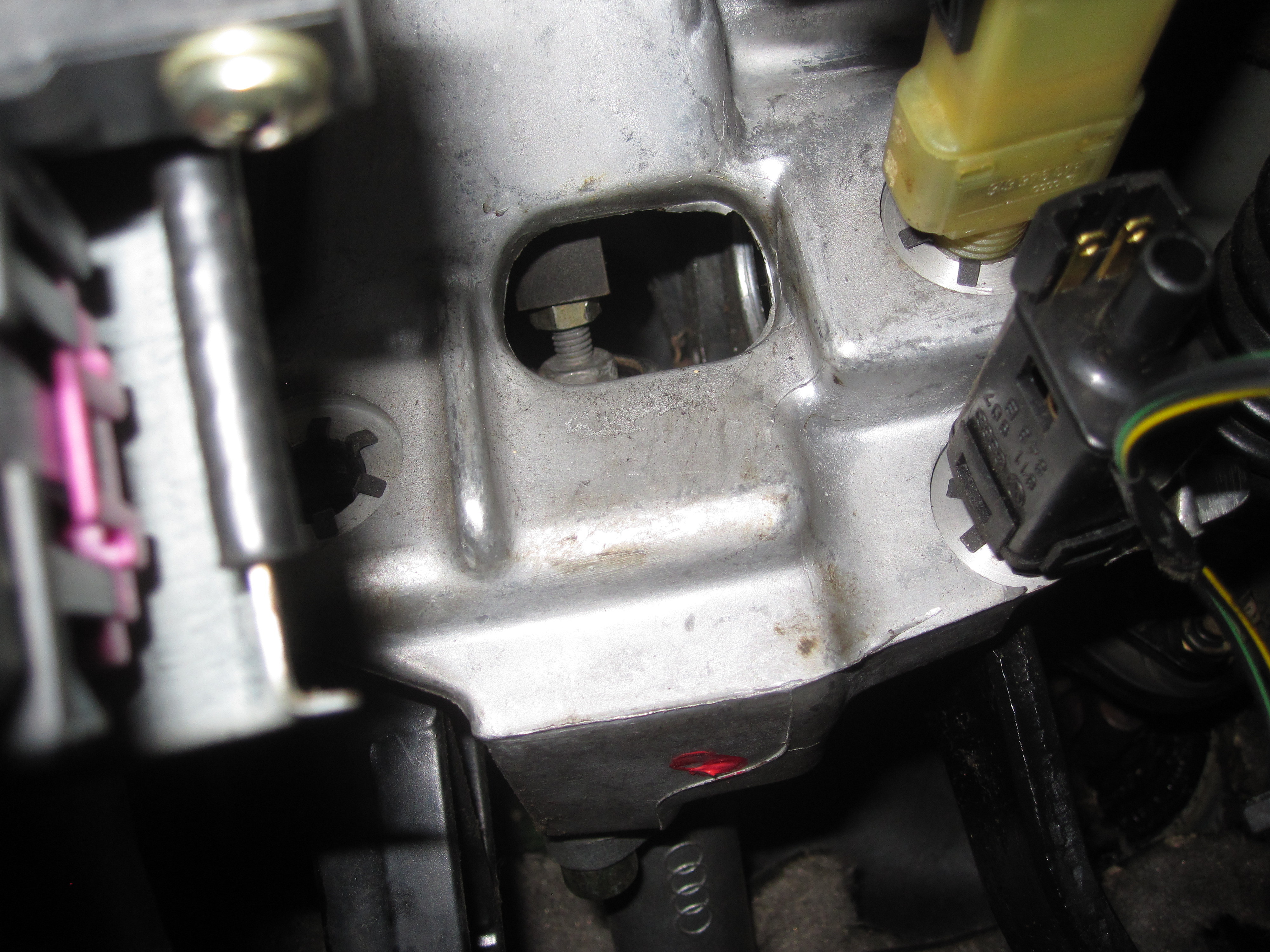

Also stupid question, i'm sure it's somewhere but can you explain in good detail how you went about adjusting your clutch grab point?

How to adjust clutch engagement point
Post by Aktapod »
themagellan wrote:Kevin(Sven) 100% go with the HPR stuff, the build quality is impeccable and they are powdercoated to boot!
Not a stupid question at all! In fact, when I first asked on MG, I was told it was not possible.
Start out by taking off the panel in front of the driver's knees (not sure what it's called) - the same one that's covering the relays. There are a couple of allen screws around the whole thing keeping it on, including two on the side underneath the cover on the left side that's against the door.
I'm sure if the next part is necessary from memory, but it'll help to gain access if you take the vent tube for the driver's footwell and rotate it out of the way or remove it completely. There are two phillips head screws that hold it in, on one either end of it. The left one just needs to be loosened and the other removed.
Now you just have to disconnect the vacuum lines leading to the clutch and brake switches, or remove the switches completely. They should be in the big metal assembly that the clutch MC is attached to. That should be it for disassembly!
On that same metal piece, you should see a little window between the switches that shows the a part of the pushrod from the master cylinder. It looks like this:
The top bronze-colored one is just a lock nut - loosen it in order to be able to adjust the pushrod. I think it's a 10mm. Then you just turn the lower grey nut (11mm?) to move the clutch. A little goes a long way, as it's pretty close to the axis of rotation. From the perspective of the picture, counter clock-wise will lower the clutch, and vice versa. There's not much space in the window, so I had to take my open-end wrench to turn part of the way, flip it over to get the rest, then rinse and repeat.
Then just lock the nut and reassemble.
The only problem I ran into is that my clevis (the dark thing it screws into) has a little play, so about 1cm of the clutch travel doesn't actually do anything to actuate the pushrod, so even though it looked just like I wanted it, I brought it back out 1 cm so it felt like I wanted it to. I'll problem tighten that up when the time comes for a new MC.
Anyways, that's that! Hope this helps!

Damn thanks dude - clever!

And to add to the clutch adjustment, there should be about an inch of play from the top of pedal travel to where it hits pressure. Dont adjust the play out of it or it will be under constant pressure, wearing the clutch prematurely. I was an automotive tech for 18yrs, so you can trust that info is accurate.

Sorry, I realize now the ambiguity of what I said. What I meant was to clean up the slop in the linkage from the clutch pedal to the master cylinder. It has a little play independent of the MC, both in the direction of travel and even some side-to-side.

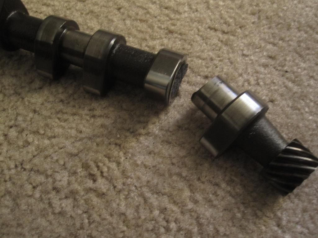

I've had an internal debate on whether or not I should even post this, because of how dumb I'll look. Then I realized: Oh wait; I'll only see some of you once a year, so who cares? Here we go.
I finally got a free moment to install my 7A cams! But when I threw it all together, I just could not get the timing to line up on all counts. There was a huge series of cause/effect stemming from one central problem, but it's a veeery long detailed story, and, to be honest, not very interesting anyways, so I'll skip the specifics.
Initially, I missed a HUGE red flag when the cam pulley had play with respect to the exhaust cam before tightening the bolt. I figured it was normal. Afterwards, though, I could not line up the dots on the camshafts and the pulley's TDC mark at the same time. I got it as close as possible and chalked the difference to my bad perspective, so I buttoned it up. No start. :shame: Pretty sure it's the dizzy, so I went back in to fix the timing.
After far too much trial and error doing the timing again, I took the cam bolt back off and found this:
Wowwwwwwww, I am so glad I caught that. I used a spare pulley from the new cams and everything lined up! With everything lined roughly to TDC, I walked the cam caps down in the specified sequence. And then - hmmm... do I admit this?
I forgot to change the distributor to match the slight change in cam timing. :bangshead: Hardly had a warning. There was no extra resistance from the nuts until the end. It got slightly tighter from palm-turning a ratchet and I figured the bearing was binding. I flipped the ratchet to reverse to back it off and suddenly BANG! Didn't know what it was at first, but I thought I'd ruined my engine.
I should never be allowed to touch a car again. Now running on stock intake and 7A exhaust cam and immensely frustrated with myself.

Don't get too down about it, we've all been there before. I destroyed a CV joint when I first got the car on the front passenger axle. It was a stupid mistake on my end and it cost me $250 to fix. I almost sold the car I was so frustrated.
Don't let it burn your desire for large amounts of boost :rofl:

Hey my first 200 I picked up I didn't tighten the lugs on after a brake job and the driver side wheel fell off at about 20 mph. Things happen!
God I made so many mistakes with that car. Sometimes I wonder how I made it through high school with the stupid shit I did. Wow I was dumb. Thinking back is embarrassing. Jeeze.
oh right.
I'll admit. I have not seen that happen before. That's hardcore. The exhaust cam is the more important one though, I believe. So could be worse!

Wow Seven really sorry that happened. Keep your chin up and keep at it. At least you didn't trust someone else with your motor and watched them drop it and destroyed two valves right in front of you. I find it better to ruin my own car instead of letting someone else do it lol. Enjoy the cams and the least important one broke anyway

Wow, that's a good one! Those things are hardened and thus don't like bending much. Just chalk it up to another lesson learned.

chaloux wrote:Shit son, shoulda got an AAN
Lol, there was more than one time I was thinking the same. Especially after disassembling the intake tract 5000 times to fix a mysterious oil leak that sprung up. Turns out it has nothing to do with the cam seal as I suspected. Looks like the crank seal is leaking pretty bad when it's running. Not sure how I managed that, but it started right after I did the cams. :nuts:

Oh well. At the time, I wanted to push the car off a cliff, but retrospectively, it's kind of funny. Plus I have a cool paperweight. I'll have to be a good student for once and wait until after finals to tackle the (probably) crank seal.
