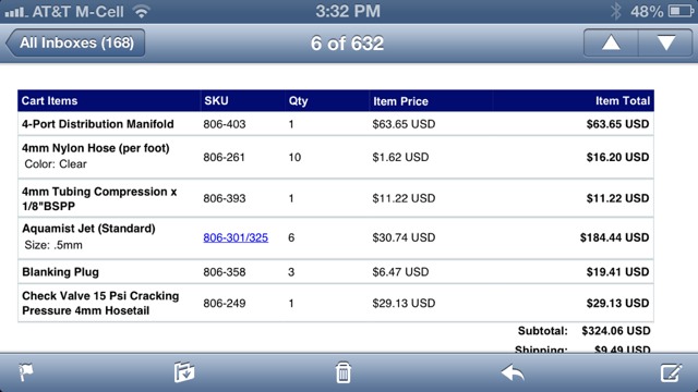

I am hoping that what I come up with put everthing to shame in those links :)
The Howerton manifolds look nice, and are reasonably priced when you take into consideration the fittings they have included. I am thinking of ordering a 4 port, and adding another fitting to the end to make it a total of 6 ports.
Here is what I think I am going with. .5mm aquamist nozzles, in each port, and one .5mm nozzle pre-compressor. The port nozzles will be hooked to the High Speed valve, the pre compressor nozzle will be a simple on off solenoid to avoid large droplets hitting the compressor. This way I can control each one independently which is always nice to have. The port injectors will be large enough to satisfy injection needs alone, but will be scaled back a touch to make room for the pre-compressor injector.
Right now I am injecting about 5000 cc's of injector capacity, so this will net about 1200cc's which is 24% and about the max you will ever want to go. Aquamist flow rates are here

Did you have a valve or solenoid in your system or were you just kicking on the pump? I am running a PWM high speed valve, so no chance of draining the tank. The nozzles are about 4-5mm deep.
Buy the adapter specifically for what you are trying to do. There is not enough meat on these nozzles to pinch them into a hose.
