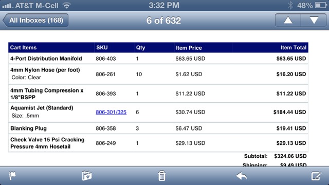

The Howerton manifolds look nice, and are reasonably priced when you take into consideration the fittings they have included. I am thinking of ordering a 4 port, and adding another fitting to the end to make it a total of 6 ports.
Here is what I think I am going with. .5mm aquamist nozzles, in each port, and one .5mm nozzle pre-compressor. The port nozzles will be hooked to the High Speed valve, the pre compressor nozzle will be a simple on off solenoid to avoid large droplets hitting the compressor. This way I can control each one independently which is always nice to have. The port injectors will be large enough to satisfy injection needs alone, but will be scaled back a touch to make room for the pre-compressor injector.
Right now I am injecting about 5000 cc's of injector capacity, so this will net about 1200cc's which is 24% and about the max you will ever want to go. Aquamist flow rates are here

Re: Jim Green's 90q 20vt - Newish Exhaust
Those nozzles are spendy with the check valves! They are more than most new injectors per cylinder!!!
You don't need a check valve unless you have pre and post TB injectors being feed from the same valve. At first thought people think you need the valve to keep the vacuum from draining the lines. The issue is, that same check valve would also keep you from injecting any meth at all.
Did you have a valve or solenoid in your system or were you just kicking on the pump? I am running a PWM high speed valve, so no chance of draining the tank. The nozzles are about 4-5mm deep.
