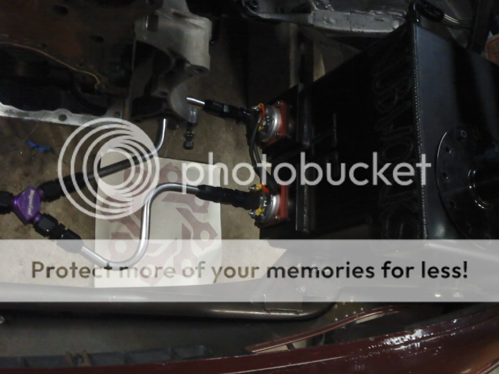

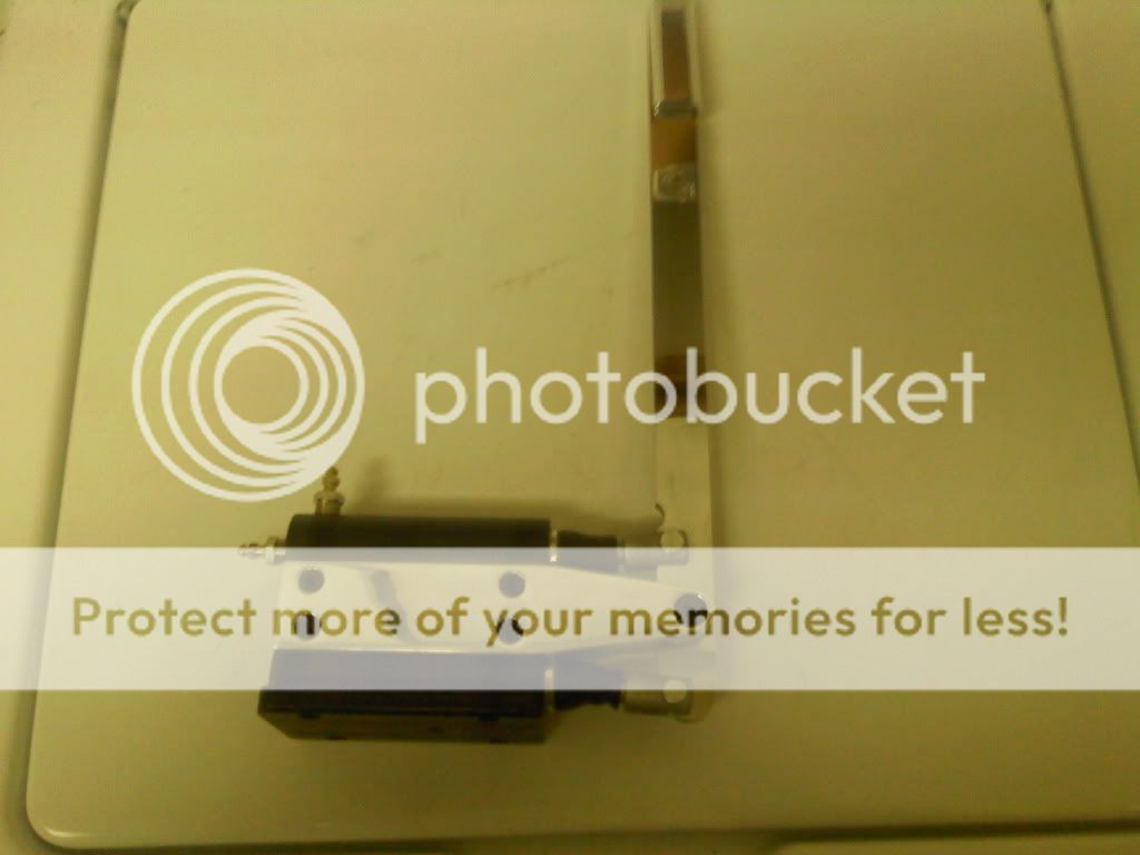

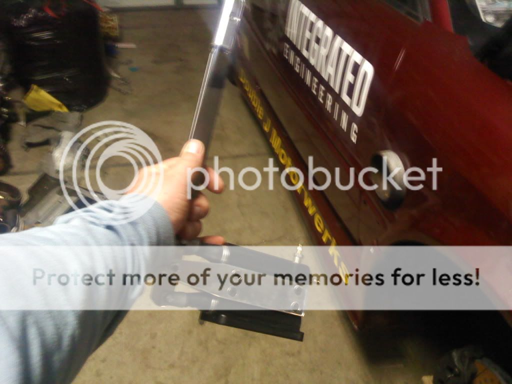

and now i gotta plumb this inline to the rears, as well.
yes it is a double, no i wont be turn-braking with it. i will only use one side of it.....

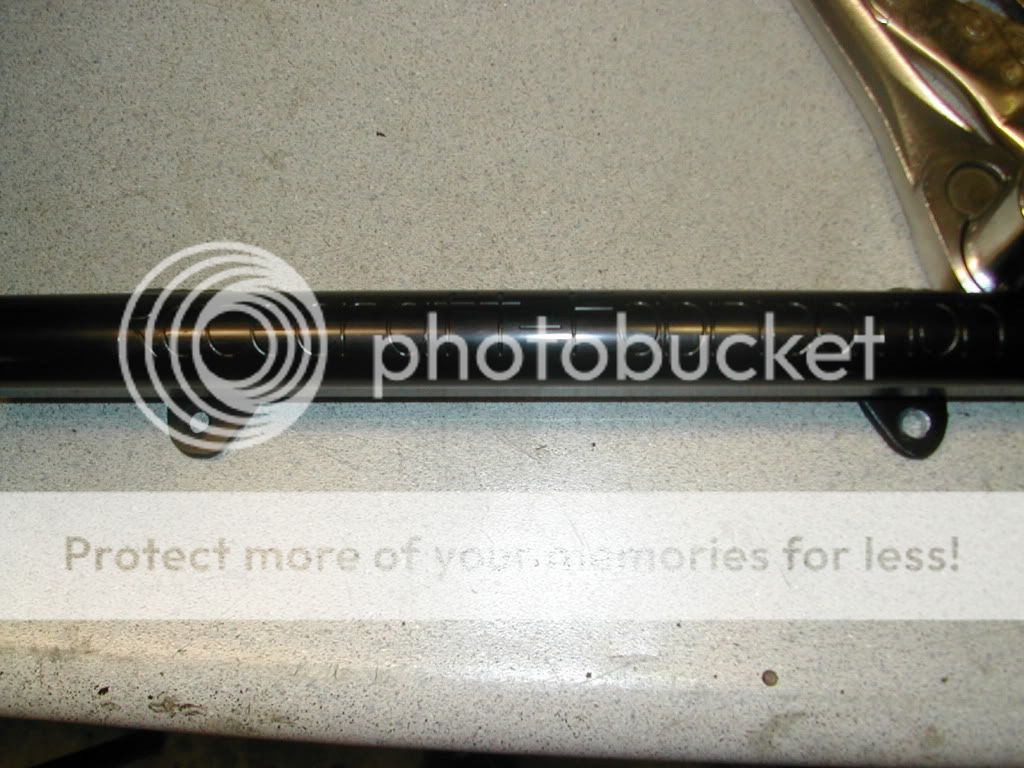

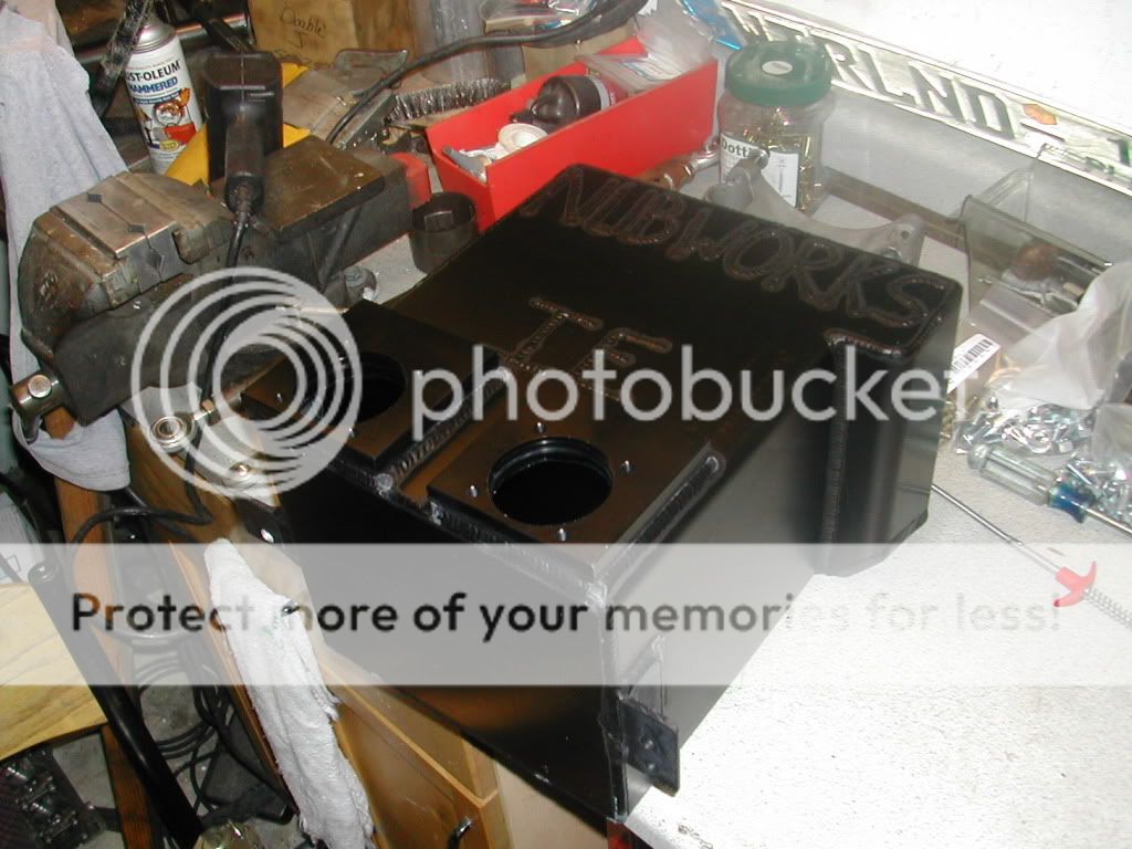

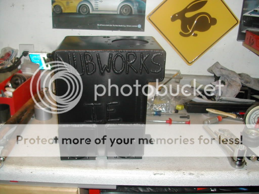

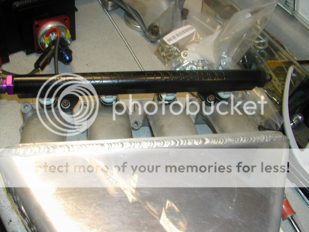

oh yeah, i also picked up the fuel cell and rail from the anodizers.... nice..... i had a stupid thought to do all that shiny aluminum under the hood, but there is so much that it would look weird i think.
i like how the Racecraft fuel rail looks now. i think i am going to clean out the letters of dye so it can be read easier...

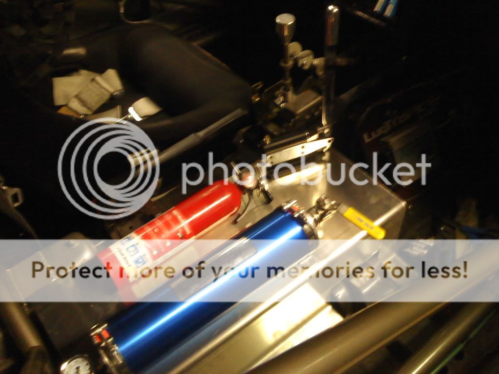

i had my main aluminum guy brake me up a sheet of aluminum, and i mounted the Accusump and the staging brake. plumbed it in, and had the pit crew (wifey) pump brakes to bleed .
i worked some on a shorter shift setup. i think it will work.

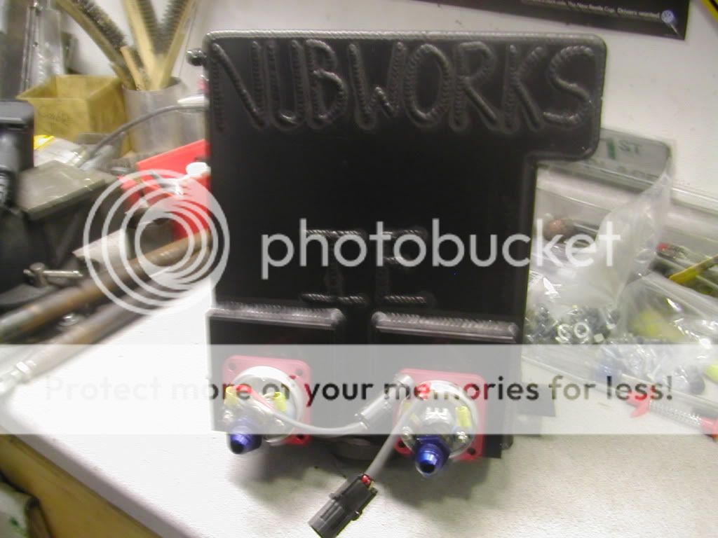

i also finalized my fueling setup. now just to add some screen mesh to the pump inlets.
