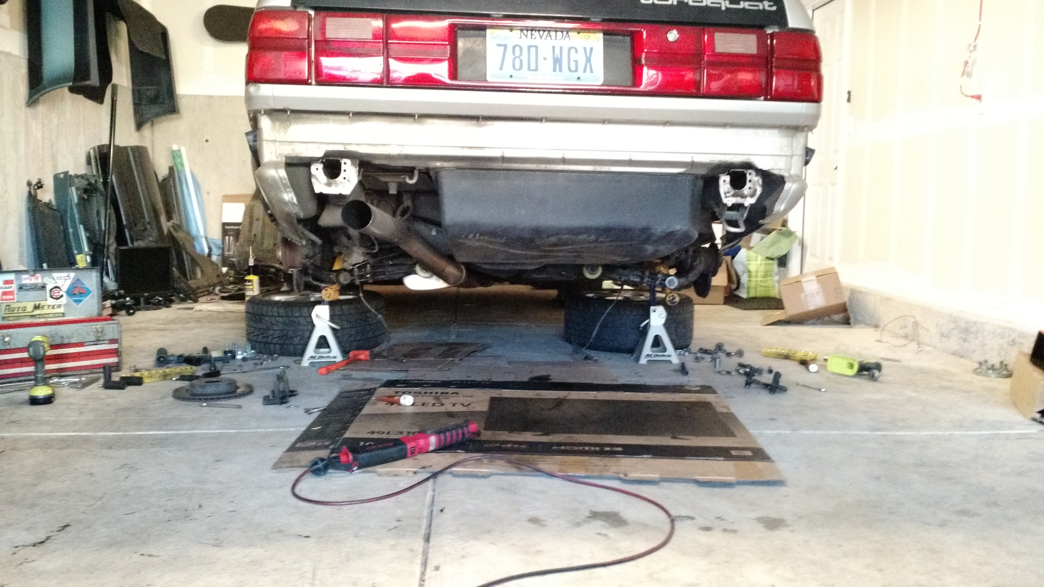

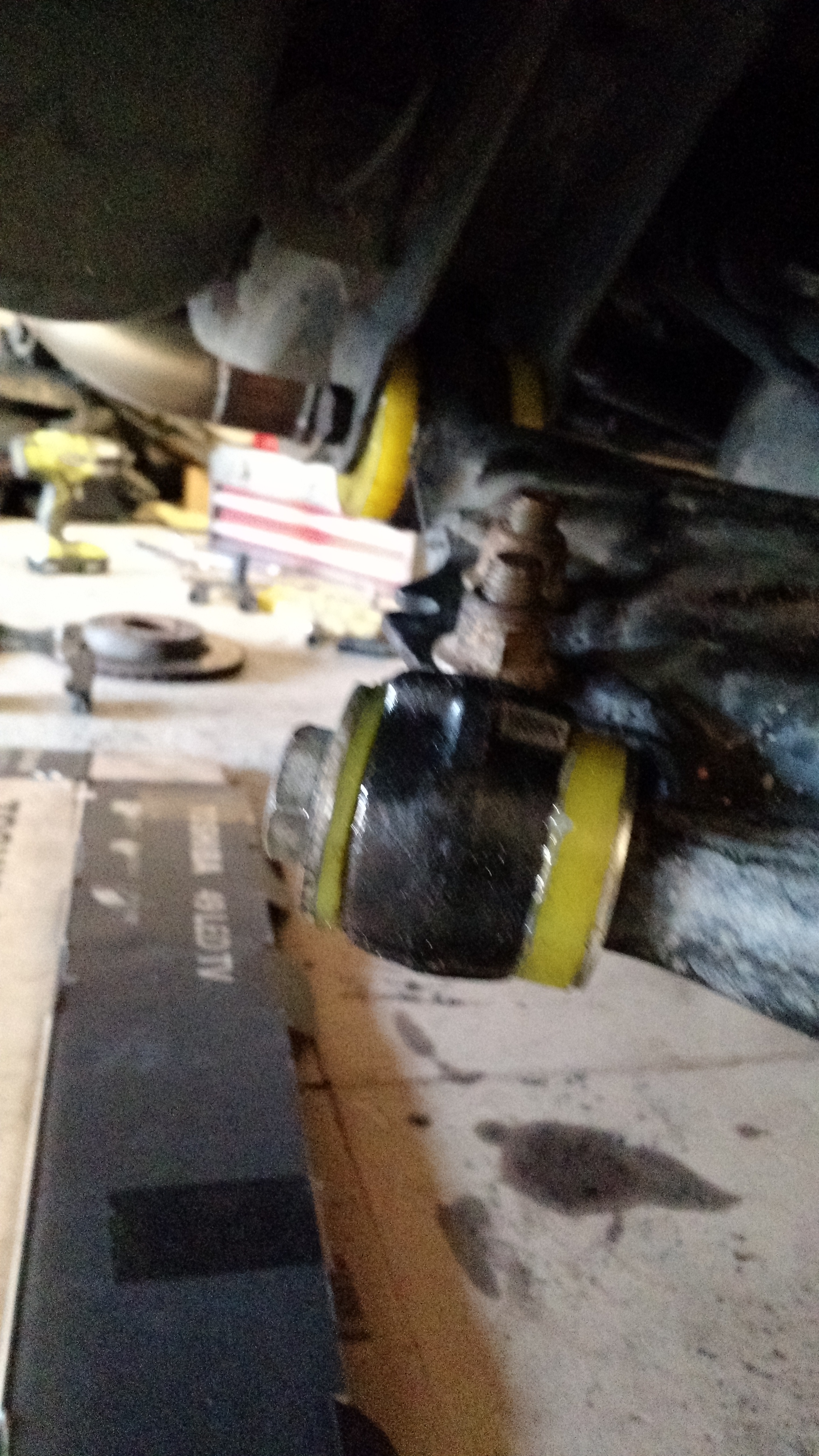

Re: Phil's 20vt 5ktq, clutches and trannies oh my.

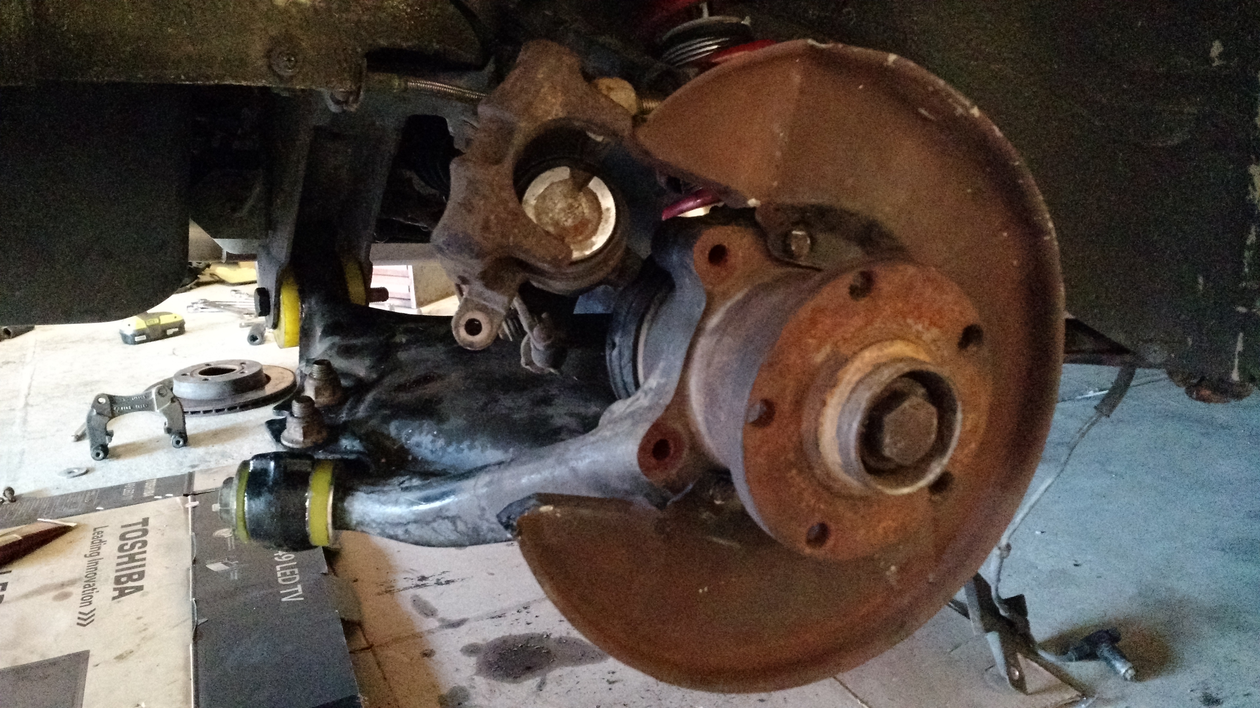

Some dumb fuzzy phone pictures.
Gotta order some V8 rear rotors because these brakes are 20020v rear brakes which fit onto 5ktq hubs, but not v8 hubs. Offset of Rotor is different from V8 and 200 it appears. V8 is same stuff as Urs4 from everything I've researched and what ETKA tells me.
Ugh more money to spend
Re: Phil's 20vt 5ktq, gettin BBQ ready
Nice, you get those knuckle bushes fitted? Or at least that one that didn't fit? No more ttrs turbo?
Nah, I showed Albert the size of these ones that I was sent and then had him send me correct dimensions and they're about 4mm off like I thought. He originally sent me the wrong ones, he's now sending the correct sizes. Depending on when they get here I might take the hubs back off to fit them, but I wanted to get them on there to make sure everything fits right. And fitting them today made me realized I have the wrong rear discs, so it was a good idea to put them on there.

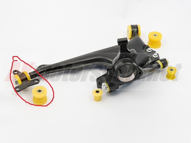

Also have some 48mm bushings for the front bracket, trap, arm, thing. What do you even call it? the circled thing in the attached picture. Urs4/20020v is 48mm. 5k/90v8 is 44mm. When I ordered these back in January he only had the 48mm kit.
So if anybody with a 20020v/urs4 wants some, I gots some.
And yeah, goin bigger. Will post when it comes in.

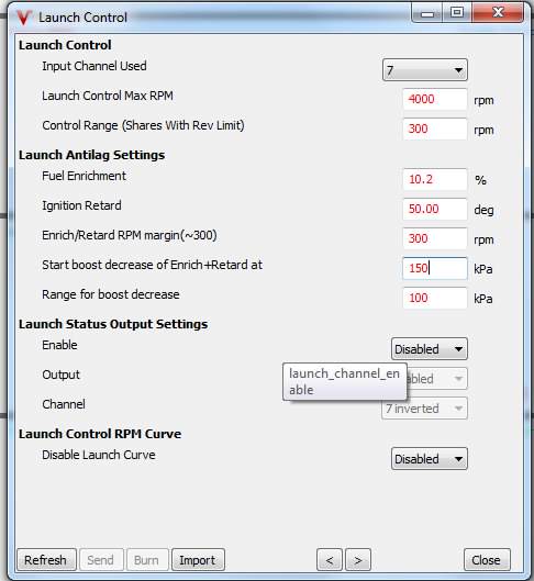

Would it be against the rules for you to share your LC settings por favor? That was badass! I've lost confidence in my settings after the engine failure :(

I guess I'll revert to these until I hear from you
Re: Phil's 20vt 5ktq, Donuts are Delish
Why do you have that boost decrease setting so low?
88a5tq
Posts: 1553
Post by 88a5tq »
The holset takes forever to spool for LC but these are the settings from efiexpress.com's help section :)
My settings were at 220 kpa iirc
You should be able to get it spooling fast with lc. You don't want to limit that number on a big turbo like that. Just let it build boost.

My lambda during LC always had me perplexed. Apparently stoichiometric is safe at full LC boost levels?
Afr readings don't really apply during lc because of the inefficiency of the combustion events and all the excess fuel. Trust me, being lean is the last thing you need to worry about during lc. That's definitely not happening! Doesn't mean it doesn't get hot though.

I run meth injection during LC all the time because I'm worried about cylinder temps. Thanks for the explanation man
Forgot to save the config to my laptop so I dont have it off hand
If you change the control range from 300 to like 100, it will be louder and more badasserer
if you change it to 20, it's like gun shots.
Mine is at 20
