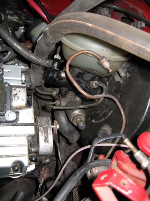

Things are VERY tight around the brake master cylinder. I'm thinking I'll need to tweak that upward a bit.
That looks different than mine :o ...uh oh :( . My M.S is much closer to the valve cover. [/quote]

Alloutofdonuts wrote:That looks different than mine :o ...uh oh :( . My M.S is much closer to the valve cover.
well, what master cylinder are you using?

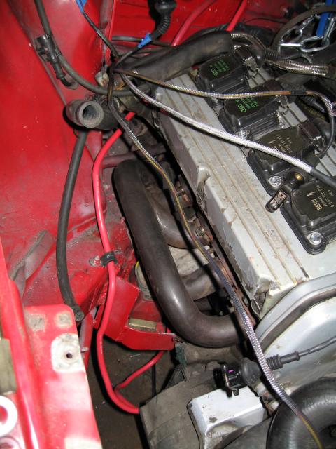

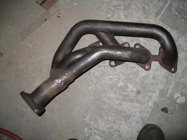

Re-routed the passenger side header to clear the subframe, wired up the starter and alternator, and uh.. I guess that was it for today

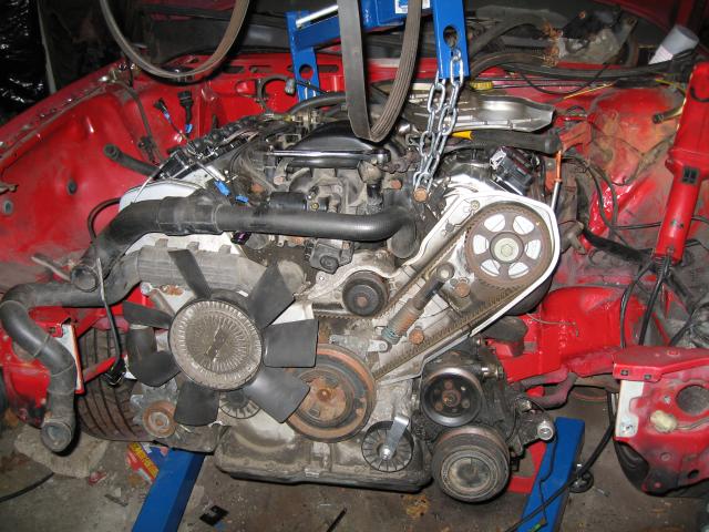

Oh yeah, so how the hay do you remove that viscous fan assembly?
Derracuda
Posts: 264
Post by Derracuda »
you need to unbolt it from the idler bearing assembly. i can't remember if it's standard or revers thread.... :bashtard:
Marc
Posts: 1586
Post by Marc »
derracuda wrote:you need to unbolt it from the idler bearing assembly. i can't remember if it's standard or revers thread.... :bashtard:
meaning I start with the 4 or 5 bolts on the reverse side of the fan or the 2 bolts that I could see on the idler bearing assembly?
The two on the bearing assembly didn't seem to want to come off lefty loosey so that might have been the bit I was missing right dar...

mark, your headers lack flanges for t3's????
jk, looks good man
Looks like a good excuse to ditch the vac-assist and head into a full dual-MC set-up ;)
-Dave
More work than I want to put into this car at the moment. I'll make the vac. assist setup work, even if it means cutting off the breather nipple from the valve cover and relocating it.
owdlvr
Post by owdlvr »
*cough* I'm sorry, who are you and what have you done to Marc!?! lol.
I completely understand. I might go the dual MC route...but I'm definitely considering just keeping the stock MC/Vac set-up.
-D

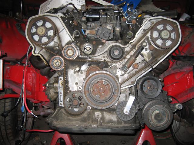

Nother day at the shop yesterday.
I pulled the timing covers off in preparation for a t-belt job (waiting on the tools and such which I scored off ebay). Judging by the copper paste on the bolts and the relative fresh looking of the belt it looks like its been done before somewhat recently...
I also put the fusebox back together after taking out the stock engine harness, put the fan blower box back in place after ripping out the AC core (I routed the 034 wirinig where the AC lines used to live).

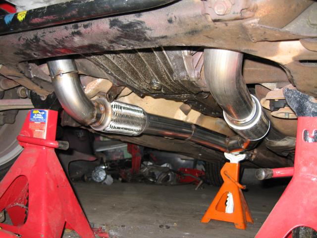

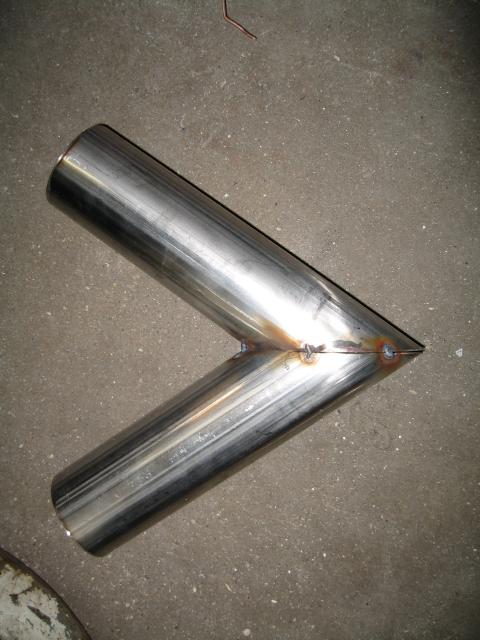

Lastly I tacked up the front section of the exhaust. For now I'm just going to run it through the stock exhaust system but I'll change this when the car goes off the road again for the turbo upgrade.

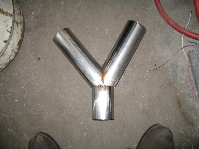

'V' for victory?
No.. 'Y' for, uh.. y-pipe ;) (yes, I know.. I cut it a bit short.. a 3" pipe would fit better on the end there..)
And the rest of the system on the car
