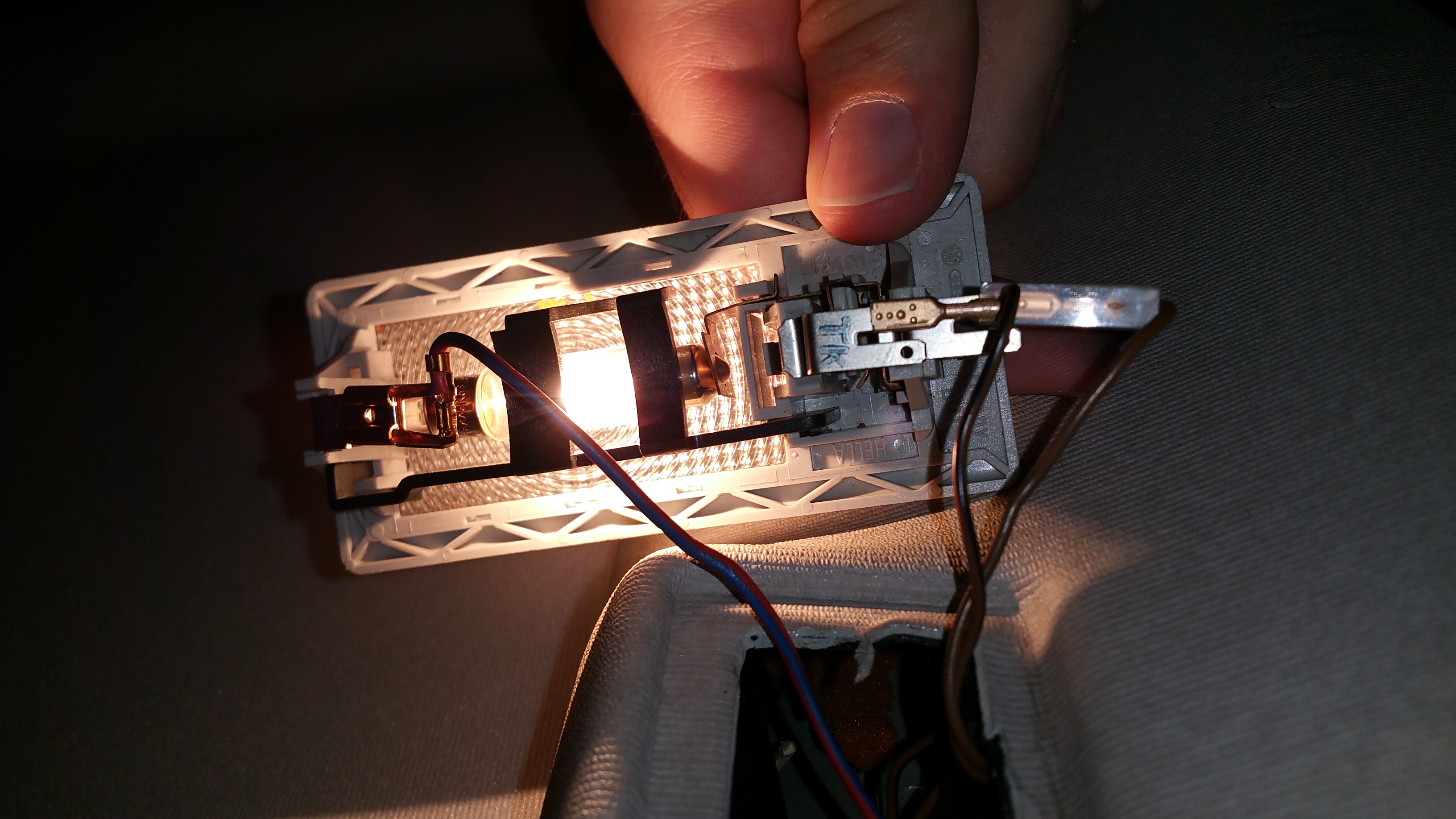

Can anyone tell me where this switch is located?
My luggage compartment light only works with the wire that goes straight to ground. The black/brown wire doesn't do anything. The wiring diagram makes it seem like there is a separate switch in addition to the one that the light is on. How is the luggage compartment light supposed to operate? Does it come on when the latch is released or something?
Here's the back of the switch the light is attached to.

Apparently other people have wondered the same thing... does anyone have a luggage compartment light which comes on when you open the hatch? I'm thinking it is integrated into the latch somehow. Can't find any documentation on this though. Not in the Bentley or parts diagrams anywhere.
http://forums.quattroworld.com/v8/msgs/13464.phtml

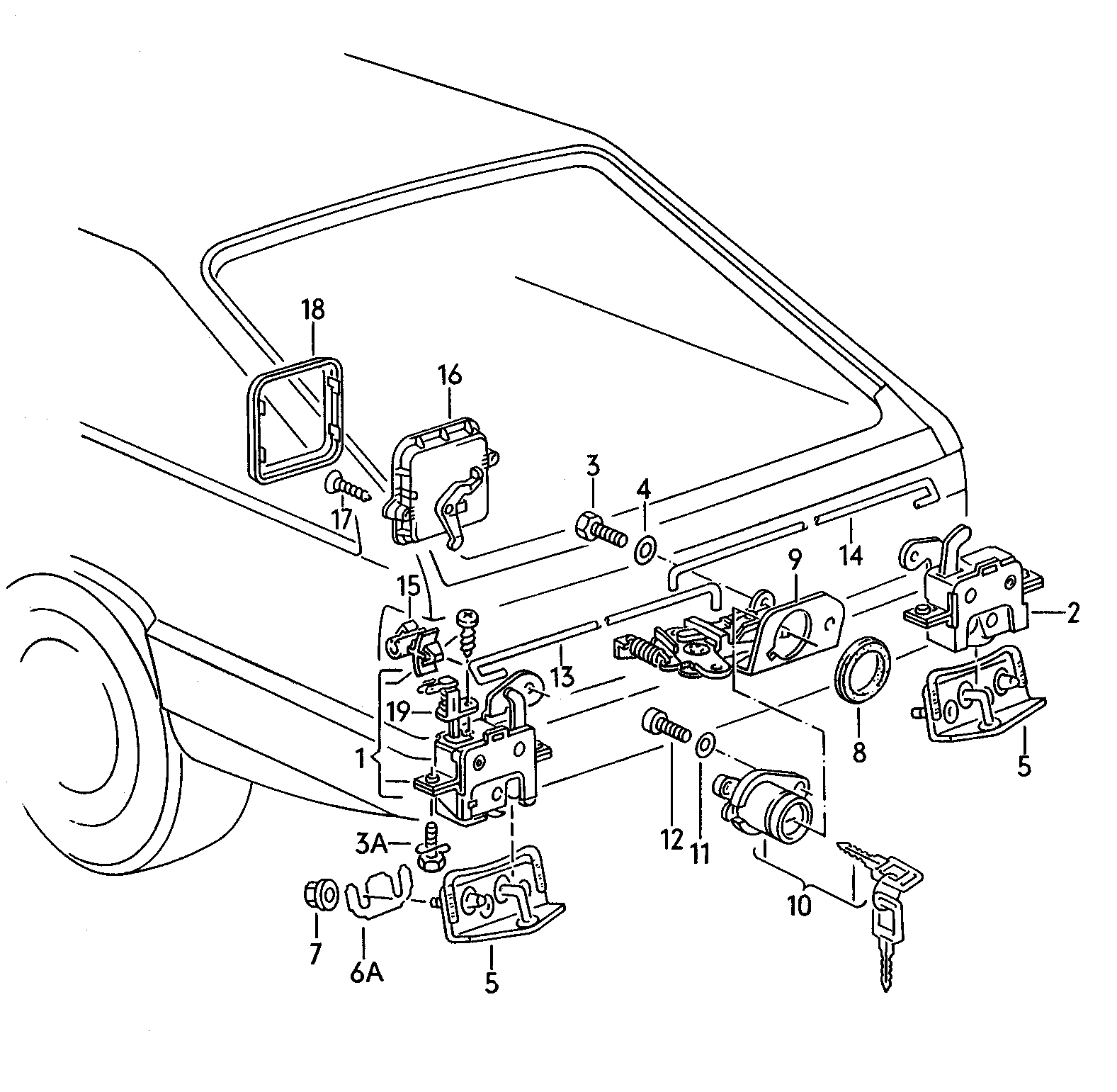

*Edit* FOUNT IT!
Number 19 in the diagram below. Part number 443947561C. I will order a new switch and hope that fixes it. If not, then wiring is next.

*Edit* FOUNT IT!

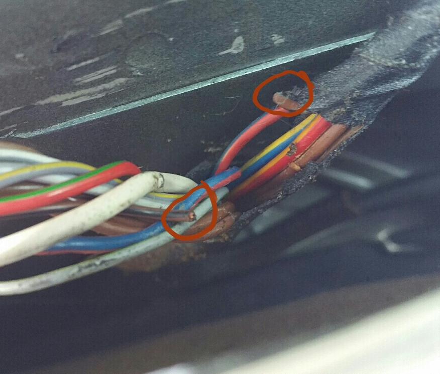

And we have progress!
I suspected this all along. I was able to get to the hatch latches easily yesterday. They come right out readily and the switch is so simple it really isn't worth even testing. So I took the wire in question off of it and grounded it straight to the chassis. No light. At that point, I had to face the fact that this was a wiring issue.
So I thought to myself, "If I were a wire, where would I break." Of course, the obvious answer is at the hatch hinges. Sure enough...
Almost all of the wires in that area and by the other hatch hinge have their insulation cracked and probably wires nearing failure from fatigue. Time to spend some time with the soldering iron and rebuild this part of the harness! Or get a new harness?

I rebuilt the hatch wiring completely on my UrS6 avant, took a couple hours tops...
I used some techflex, counted, gauged and labeled all the wires and then cut that section of the harness completely out. Soldered inside the main cabin and well into the hatch itself. Not sure if the harness itself is available.
Yeah, I agree cutting out a large section is important to make a repair like this last. At least one version of the harness is still available, altgough I could buy a mighty nice Metcal soldering thing for the price. I'm still trying to figure out if it's for a specific model or what...

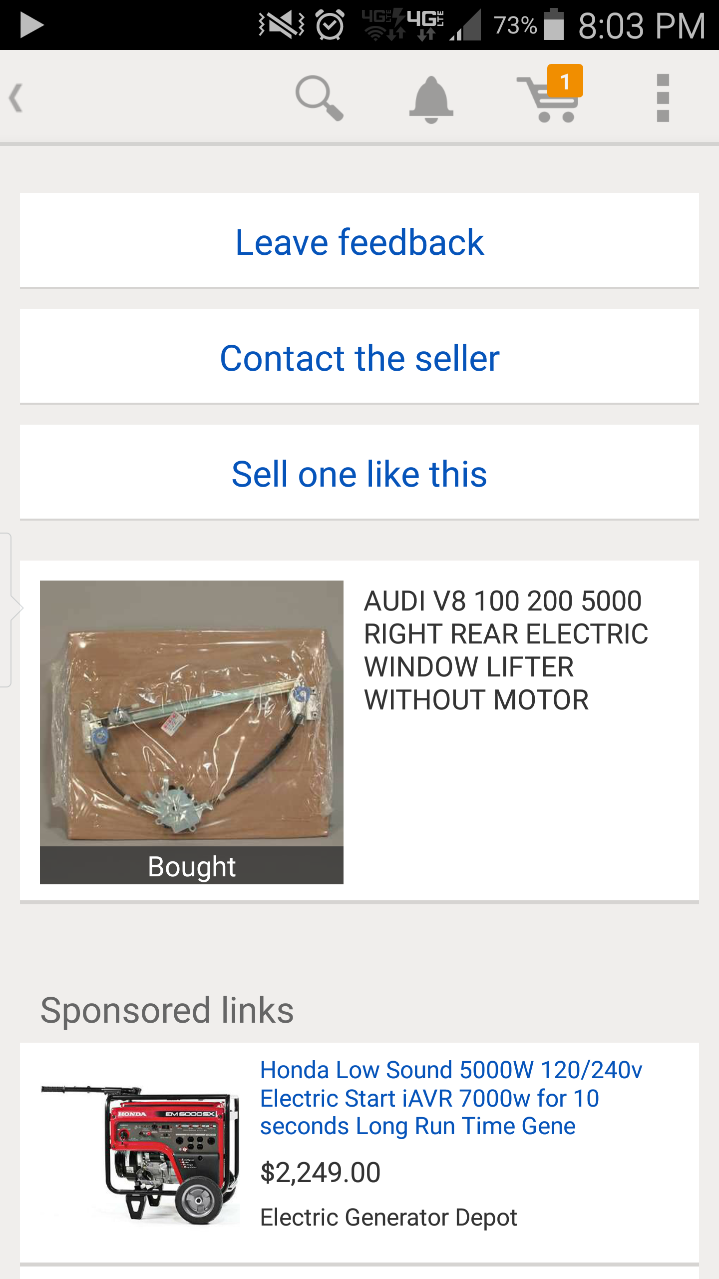

Just scored two brand new genuine vw/audi right rear window regs for $45 a piece. Hell yes!
- Screenshot_2015-08-18-20-03-29.png (575.15 KiB) Viewed 31410 times
You didn't need the motors?
Just a thought, should be fine either way.
A ways back diagnosticator on AZ referenced a TSB that strictly recommended staggered crimped butt connections with heat shrink to cover versus soldered connections.
YMMV.
YMMV.
I trust my dad with the electronics. He said soldering was completely unnecessary. Pick up your butt splices from an electrical supply store rather than home depot or whatever, and you'll be totally fine. Heat shrink if exposed or permanent.
Better yet, get the marine butt splices that have the adhesive shrink wrap built-in!
