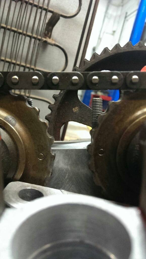

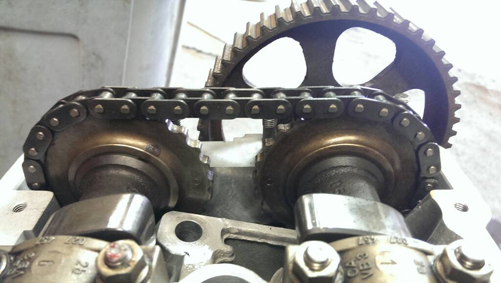

Take a wider photo so we can see the top of the cam sprockets and the chain.
If you count 7 teeth up on each cam from the marks (teeth with marks being #1), there should be 10 links between those two teeth.

Awesome!!! Didn't wanna search for that with dirty fingers on my phone, I know I had seen this before and a conversation regarding the possibility of having to time 7a's a but differently in an AAN application... I think it was a thread started by Dave in QW. I haven't seen mention of it since so im assuming it was more of a theoretical post...

Spot on?

I believe I have it like soo
EDIGREG wrote:picture is worth 1000 words
Re: A tale of Rubí... Bottom End Assembly Commences w/PICS
Posted: Mon Jun 10, 2013 9:04 pm
by Mcstiff
Right, that is the stock alignment.
I am saying, is this as simple as phasing the exhaust +-180* to make into a, properly performing, intake?
Posted: Mon Jun 10, 2013 9:10 pm
by mushasho
Oh I think you're under the assumption that I mix and match my cams... I went 7A Intake and 7A Exhaust in there intended location.... none of that "AAN Exhaust Cam as the intake & 7A Exhaust" stuff... Ain't got time for that right now... lol

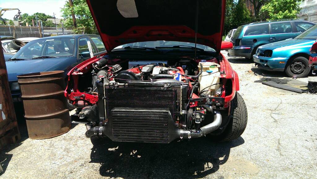

A little dress up...

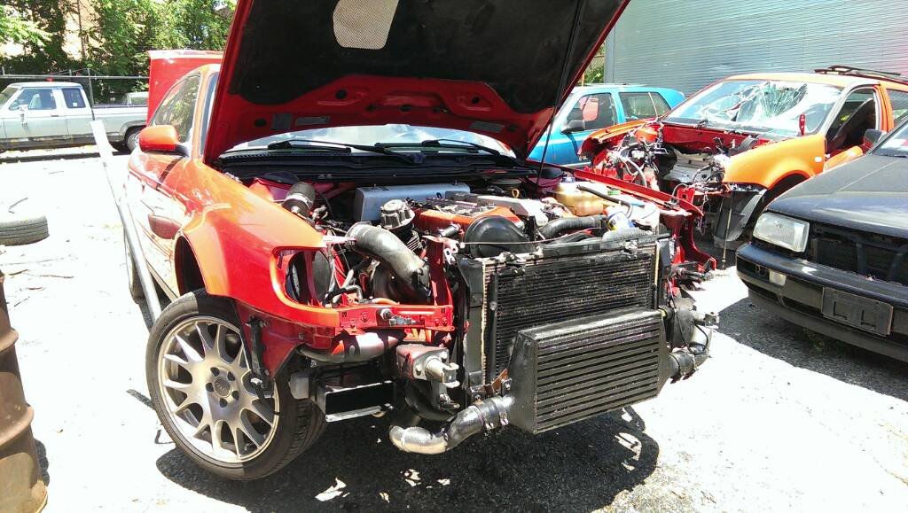

Posted: Tue Jun 11, 2013 6:59 pm
by 85oceanic
Looking really sharp man?

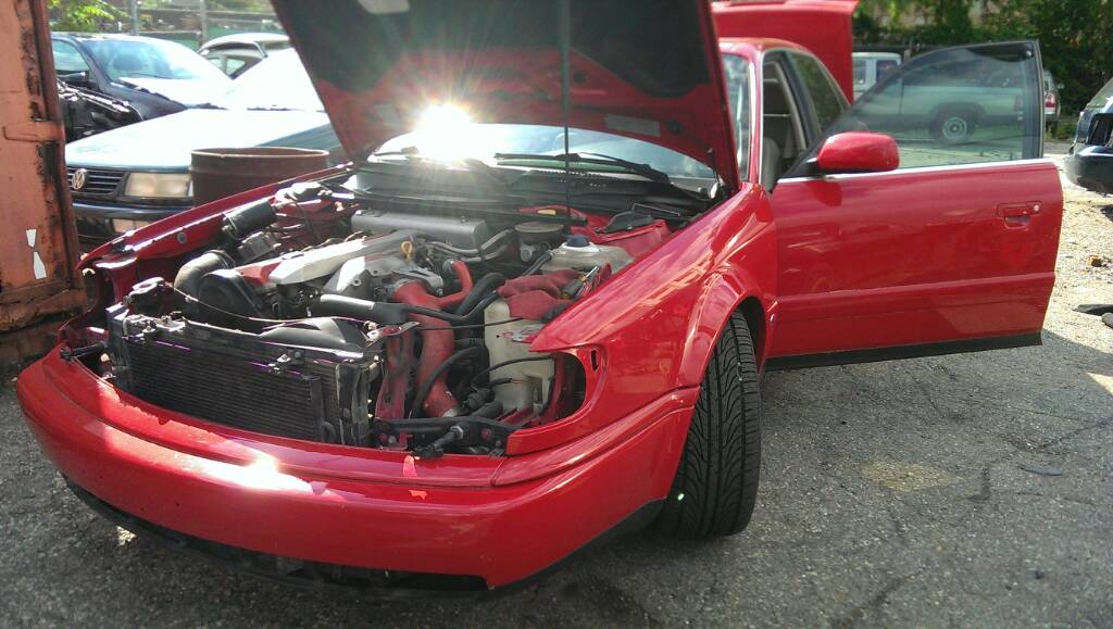

Placed behind shop...
Commence break down...
