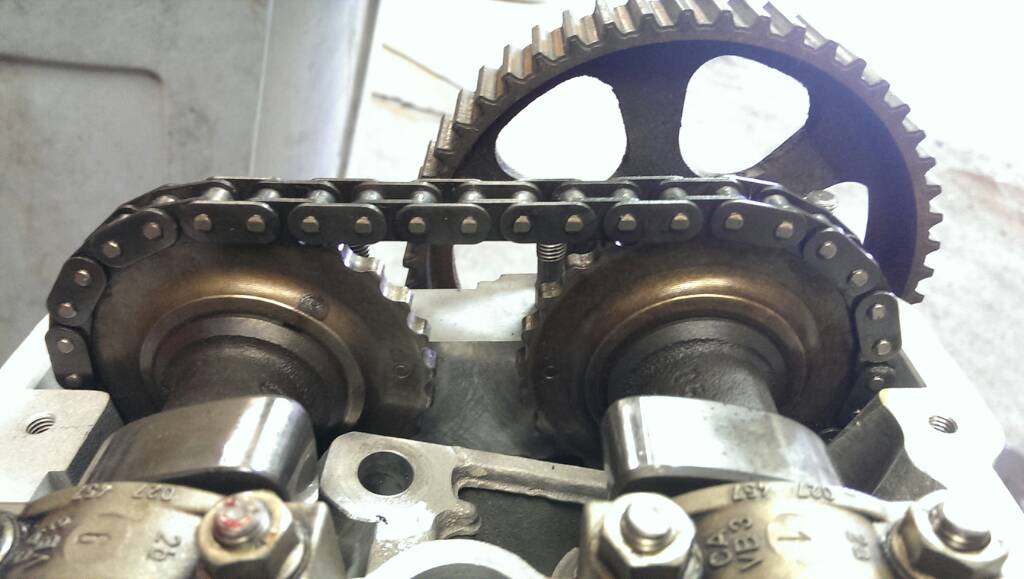

Take a wider photo so we can see the top of the cam sprockets and the chain.
If you count 7 teeth up on each cam from the marks (teeth with marks being #1), there should be 10 links between those two teeth.

mushasho wrote:7a & 7a it is... Assembling now..
how many open links should there be an on chain now?
Hold on, how are you setting the cam sync? I don't think, may be wrong, that it is as simple as 180* off.

I believe I have it like soo

Right, that is the stock alignment.
I am saying, is this as simple as phasing the exhaust +-180* to make into a, properly performing, intake?
Oh I think you're under the assumption that I mix and match my cams... I went 7A Intake and 7A Exhaust in there intended location.... none of that "AAN Exhaust Cam as the intake & 7A Exhaust" stuff... Ain't got time for that right now... lol

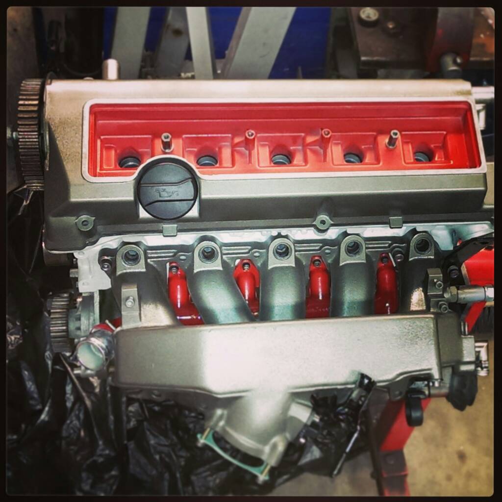

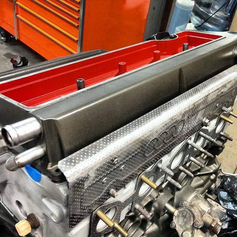

A little dress up...

Looking really sharp man?

85oceanic wrote:Looking really sharp man?
Thanks!

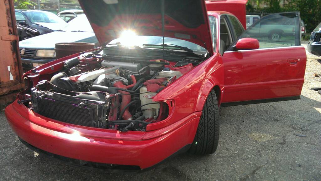

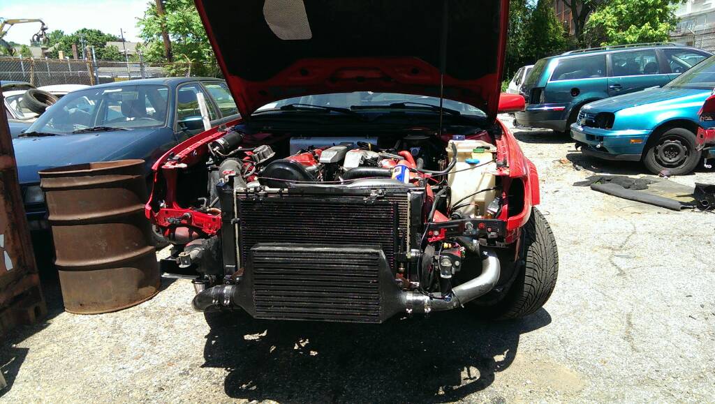

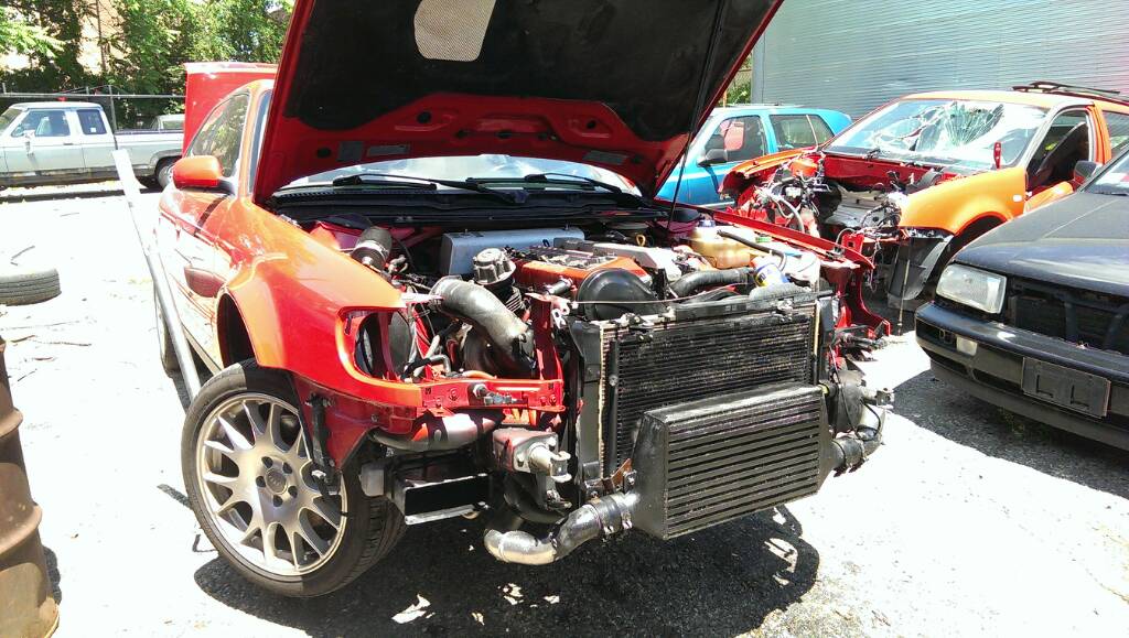

Re: A tale of Rubí... Break down w/PICS
Quick rinse out of hibernation..
Placed behind shop...
Commence break down...
