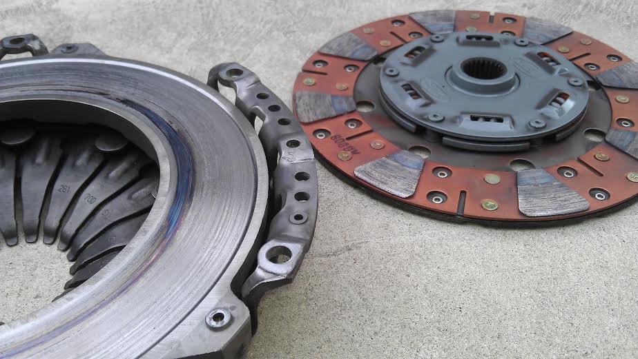

Well, since everybody else is updating their projects, I guess I will too.

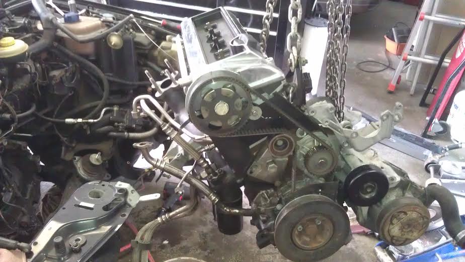

I finally found the time to pull the engine back out again hopefully for the last time.
Once out, found a very good reason why the clutch would not hold E85 power. the puck side they replaced had a pretty negative affect on the pressure plate. this is less than 5k miles since I installed it.

So now the engine comes apart for machine work to install the ARP mains, new rings, coated rods and main bearings. The last of the go fast parts.
