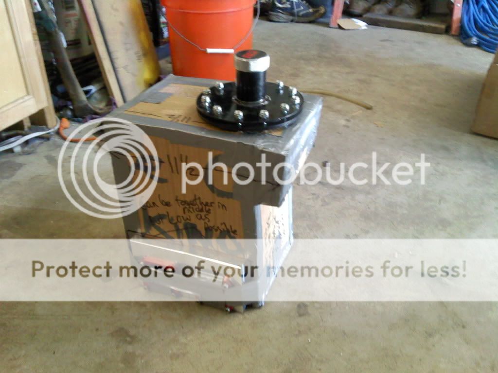

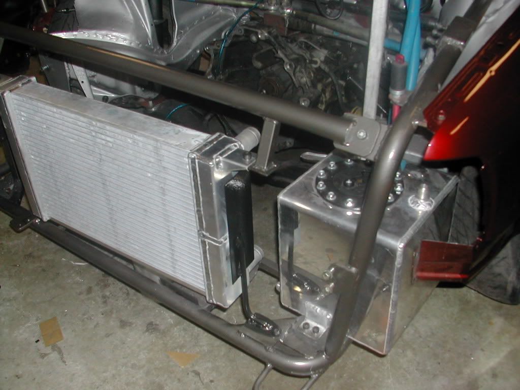

so, i got these pretty cool plates from Pete @ Integrated Engineering. i got them while in development for a surge tank setup. they are for mounting the Bosch 044 pump into the fuel cell, thus reducing fittings and also submerging the pumps to keep them quieter and cooler.

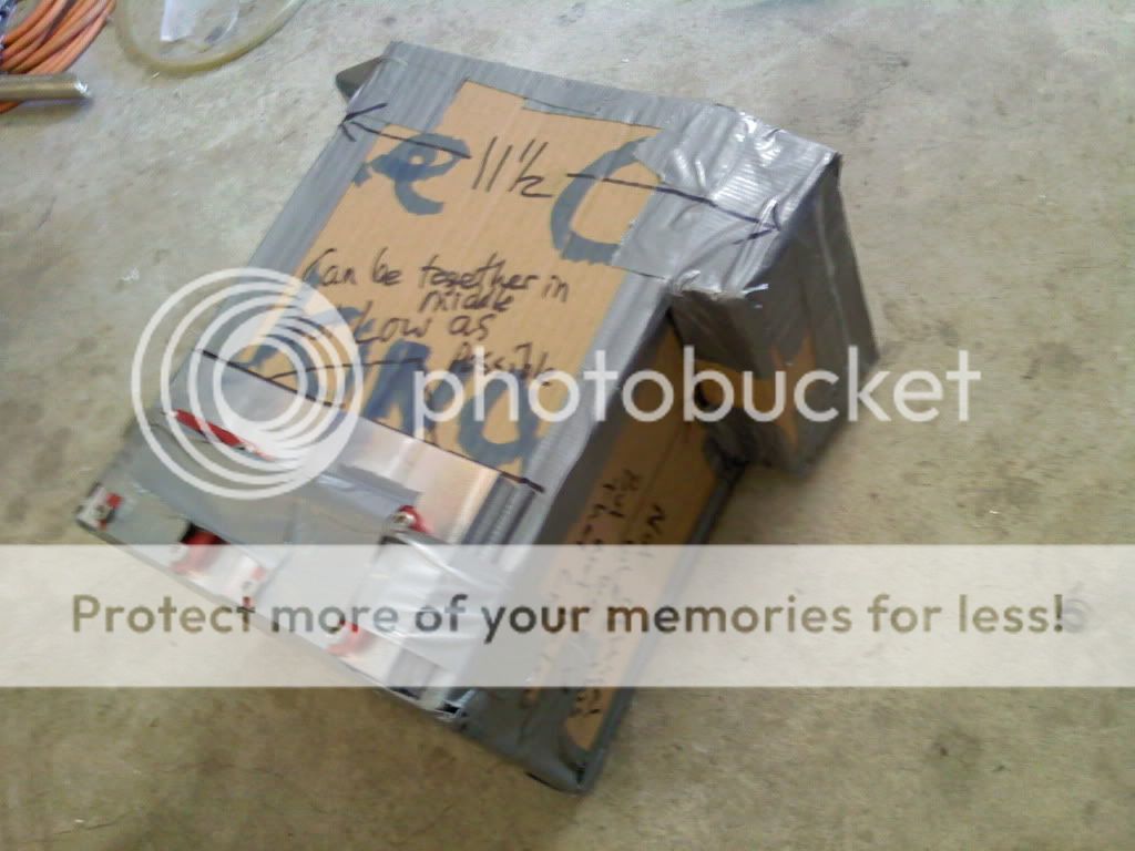

had them for months now, figured i have a couple days yet so its new fuel cell time. the reasoning is that i want to sink the pumps, and to make it easier to fuel the car at the track. i really like the cap i have now, but it is sometimes a pain to operate, and it is lower than i would like. it will be easier to fuel this way.
the template; i will hand this off to my master welder, and i will have this replicated in aluminum shortly.

fuel cell in the front? seems like it'd hurt the weight distribution.
are you going to weld up some aluminum? or what other material?

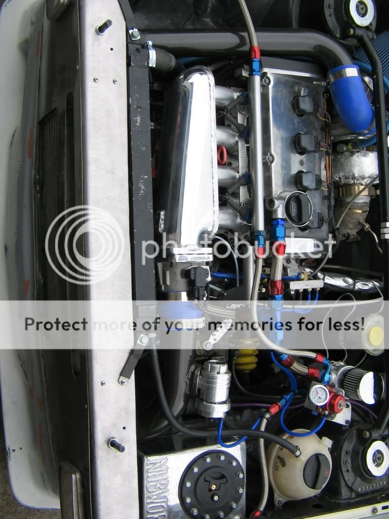

fuel cell has ALWAYS been right there. on both drag cars, its been driver side front corner. and yes, i have them made out of aluminum always. see, out this way, we make as much as we can
what is weight distribution? this car weighs ~1600 front and ~1000 rear. and it lifts the front right up trying to clear the ground on the launch. i think it would just try to lift even higher if i move the cell to the rear.
here is the other fuel cells..... but they have always been in that corner. short fuel line runs.

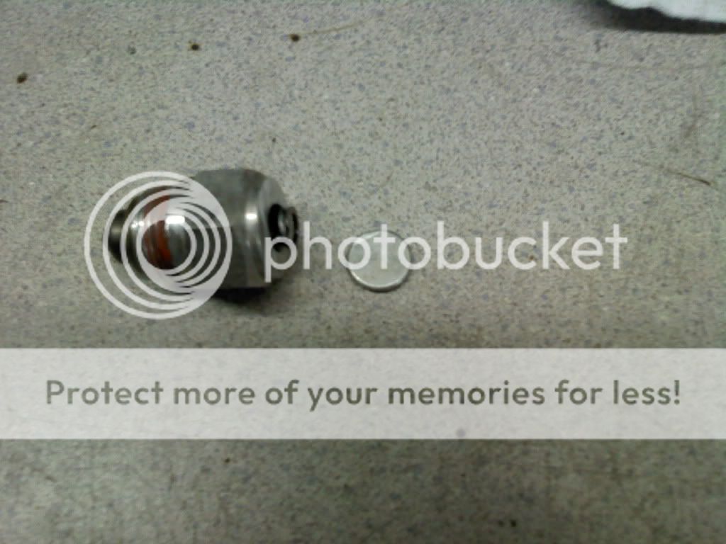

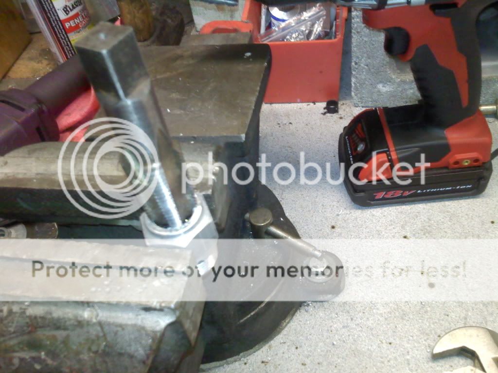

i did a formal DIY for the shifter detent thingy. here is that posting;
side to side detent firming up. help snap back that shift lever to center. and this is a revision on the first one i did, there is no need for how i did it initially. a plug is just fine for overall, and no spring is replaced. just cut, drill, tap, done.
it starts with an aluminum bodied detent from the 01E. doesnt work with the steel bodied one for the 5spd, i tried.
you cut the top of it off....
pull the spring out.
drill the hole out to get the plunger out. notice the plastic caged needle bearing inside. i went and watered it down right after cutting, its hot and i didnt want to melt that thing.
tap it for 1/2" NPT.
finished product.

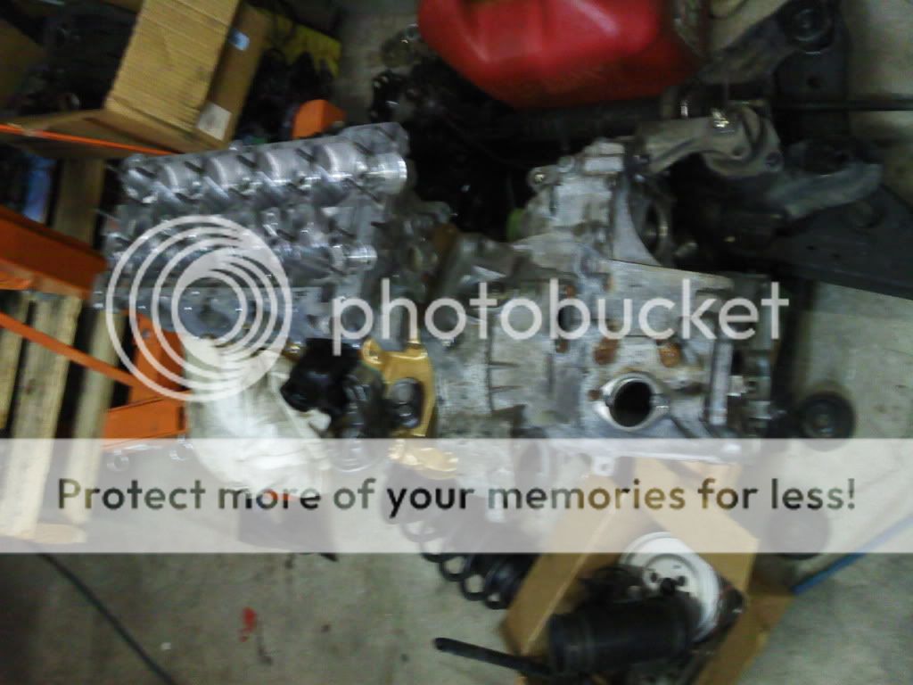

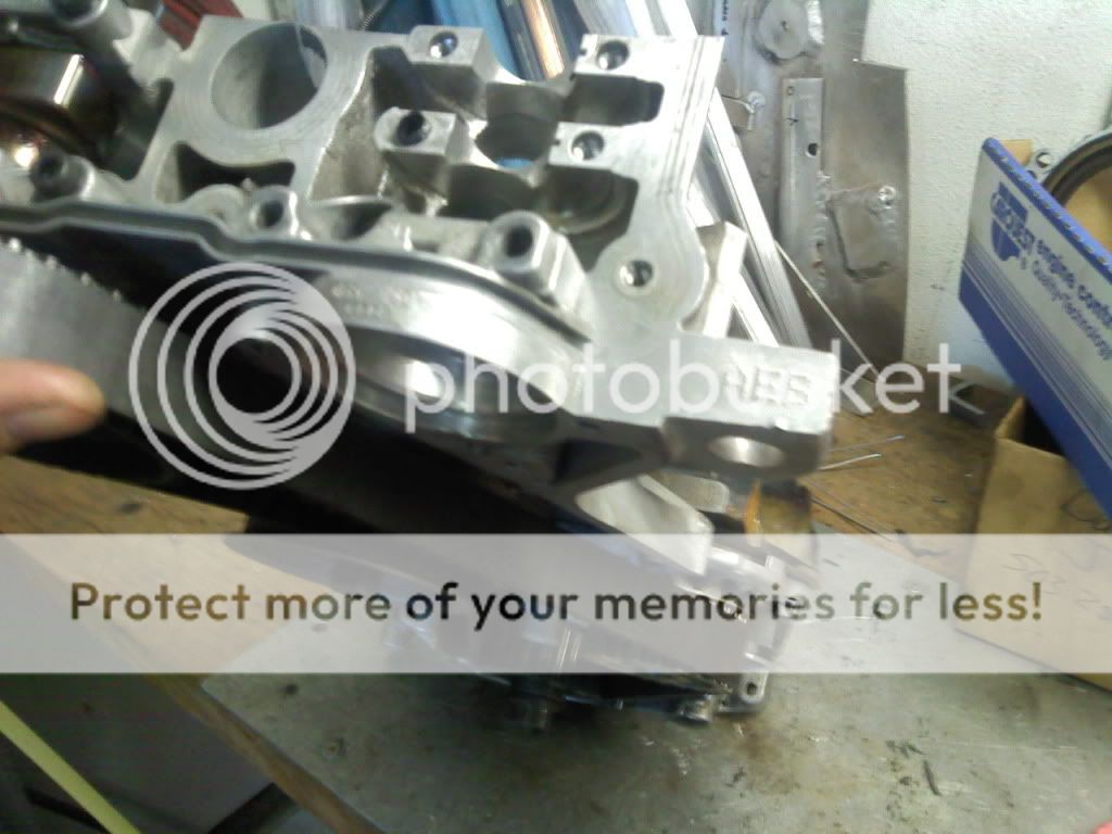

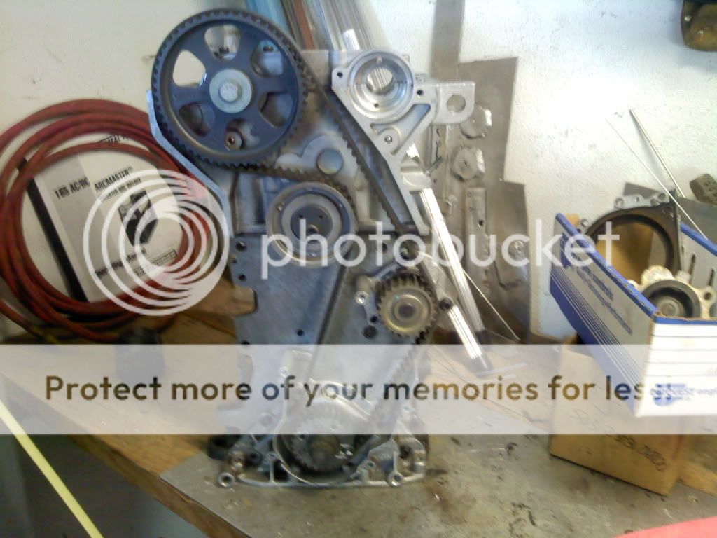

so i am still bored here.... and did some more cuttin on this motor.
me on VWKotex AKA Richard_Cranium wrote:[/quote]yup.
the AEB OEM cams are hollow.
just real bored, learning stuff along the way.

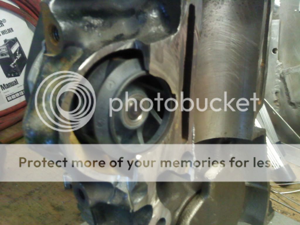

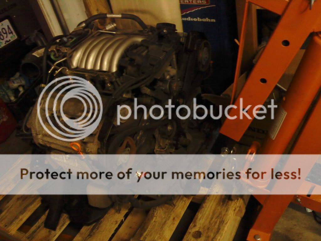

cut up a head, for "the experiment". and an exhaust cam. oh yeah, thats an AEB, baby. its just how i roll.
ever wonder how the internal water pump motors look inside? how they interface inside the motor? ok, here ya go.
[/quote]
thats another project though.
[/quote]

us TT guys frown upon you for destroying an aeb head. that is a common swap so increase flow for out motors. lol
but if it was scrap then idc. (i haven't touched my TT performance wise in quite a while... all I5 now... darn you)

i made more power with a smaller bore motor and ported small port head (with a little less torque) than i did with a larger bore motor and non ported AEB head.
ported AWP with 3652's, 82mm bore, 592/434 IIRC.
nonported AEB with 3652's, 83mm bore, 557/480 IIRC.
i attribute the increase in torque to displacement, all other parameters were the same.
and yes, do you REALLY THINK I WOULD WASTE A GOOD HEAD? that head was beat to shit, and cost was $350 to rebuild the bad cyl to normal. not worth it.
'sides, i got a couple more
(sorry, none FS, i use them ya see)

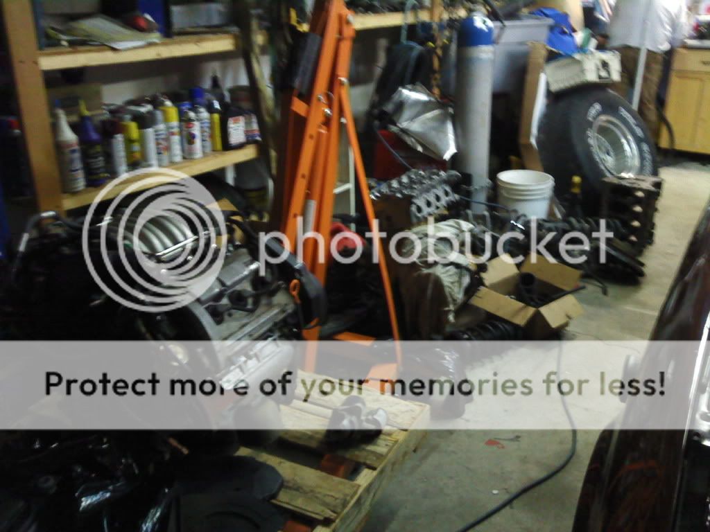

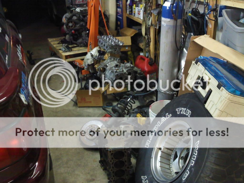

ya, got some stuff layin about.
06A block.
ABA block w/16v head and complete subframe and suspension.
ATQ V6 Audi 2.8L 30v large port motor.

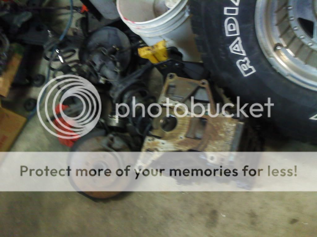

spare 35" 12.50 x 15 tire on Centerline for the 4x4.
spare CQ/20v B3 front suspension.
spare 01E 6 speed. and this is just junk layin around here at the house. got other stuff in the storage.
06A block.

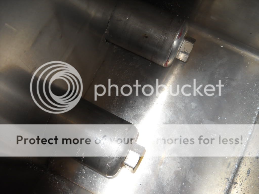

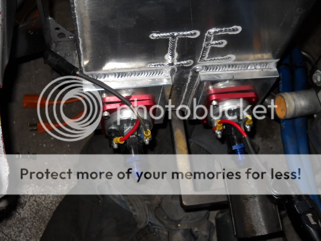

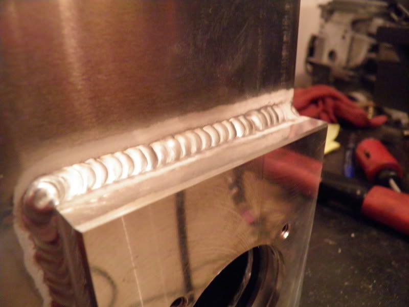

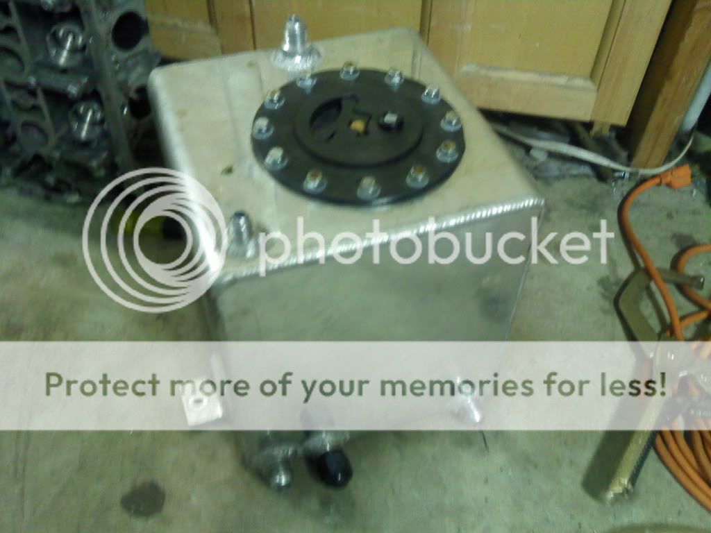

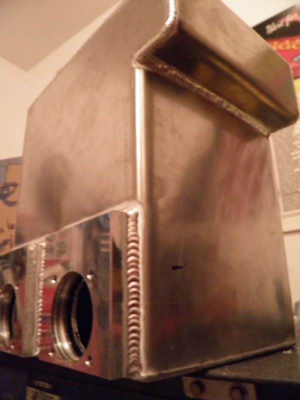

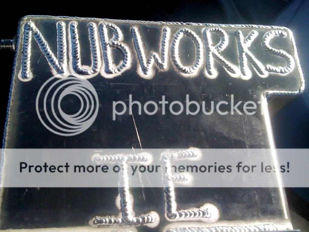

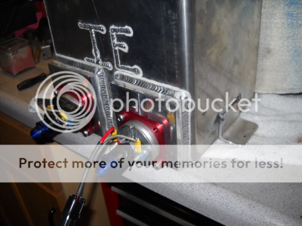

some updates..... and props for my master aluminum fabricator.
here is the fuel cell, almost complete.
and the last pic i got....
nubVR wrote:Done with 2 pieces of .125 aluminum......
zerb
Re: Aarons Drag CQ: 10-15 fuel cell updates
mmmmm..... weldssss
derracuda
nice adverts!

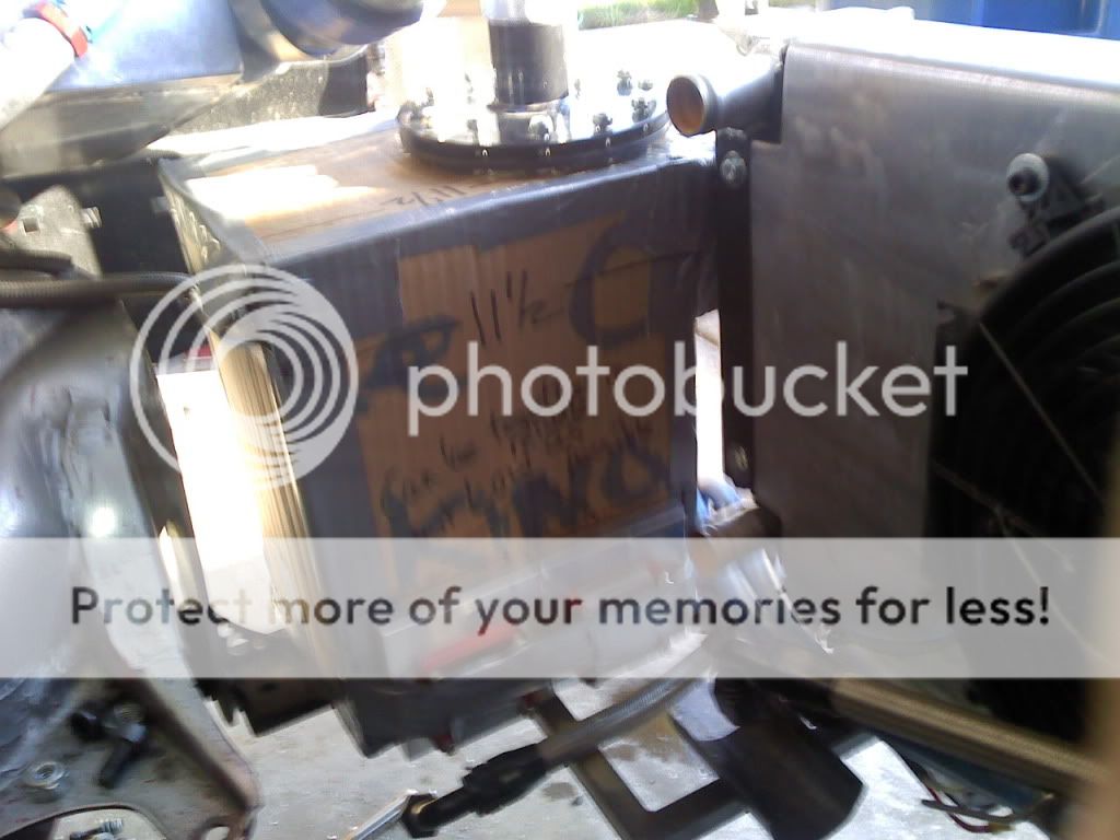

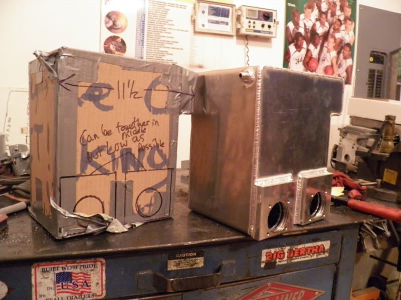

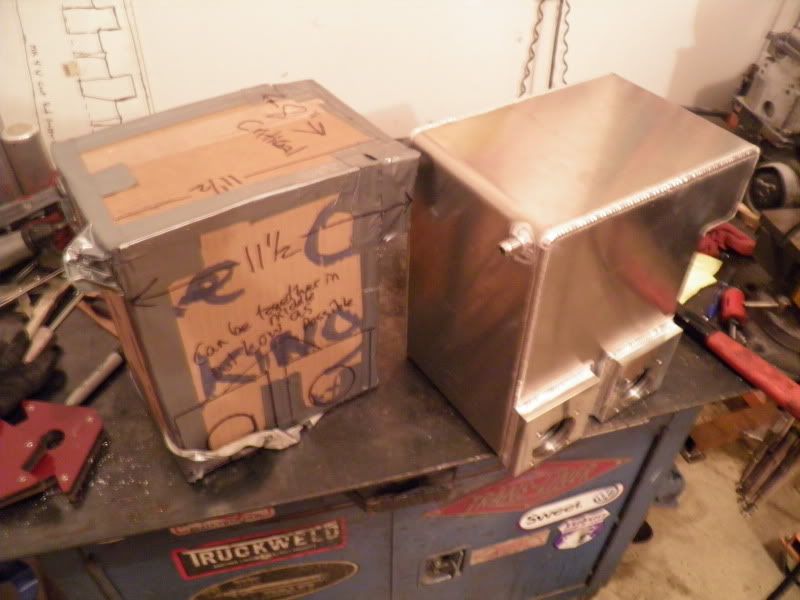

it looks great in person. some final fitting, tabbed it, and back to the welder it went. seems the product in aluminum may be a bit more squared up than in cardboard LOL.
Re: Aarons Drag CQ: 10-19 fuel cell pix
It looks really good Aaron, but doesn't look like it's going to give you much range......maybe a quarter of a mile if you're lucky.
- speeding-g60
- Posts: 2152
- Joined: Fri Mar 01, 2013 10:46 am
nah. my other one was squatter but wider. it had a 5+ 1/4 mile capacity
this one is about the same capacity.
pretty nice how it is just two pieces, broke in the right places to fit each other.... the guy is good.

greasemonkey

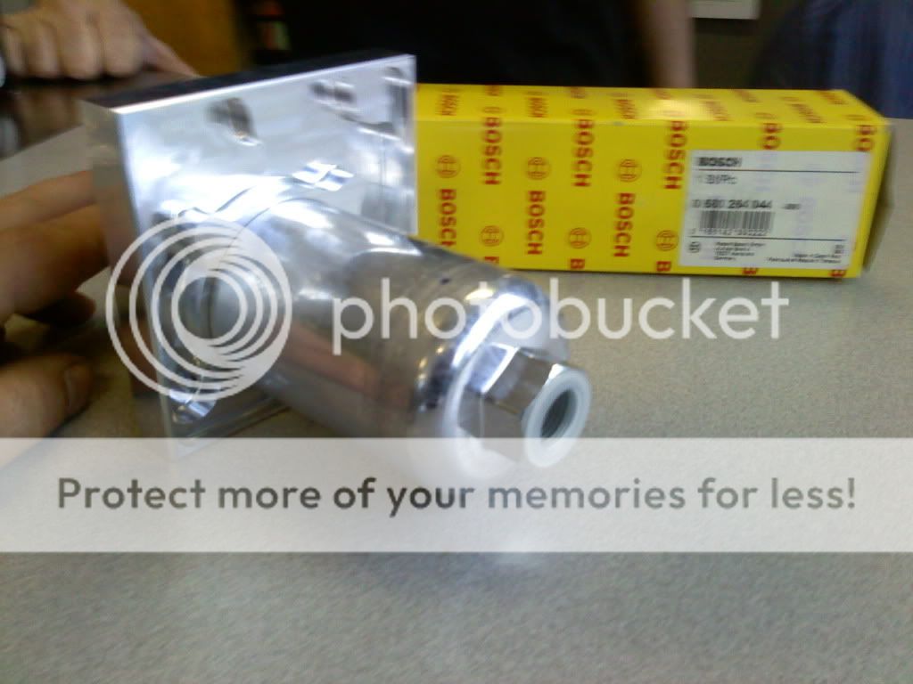

nice cell, you gonna put some pre-filters on the pumps?
