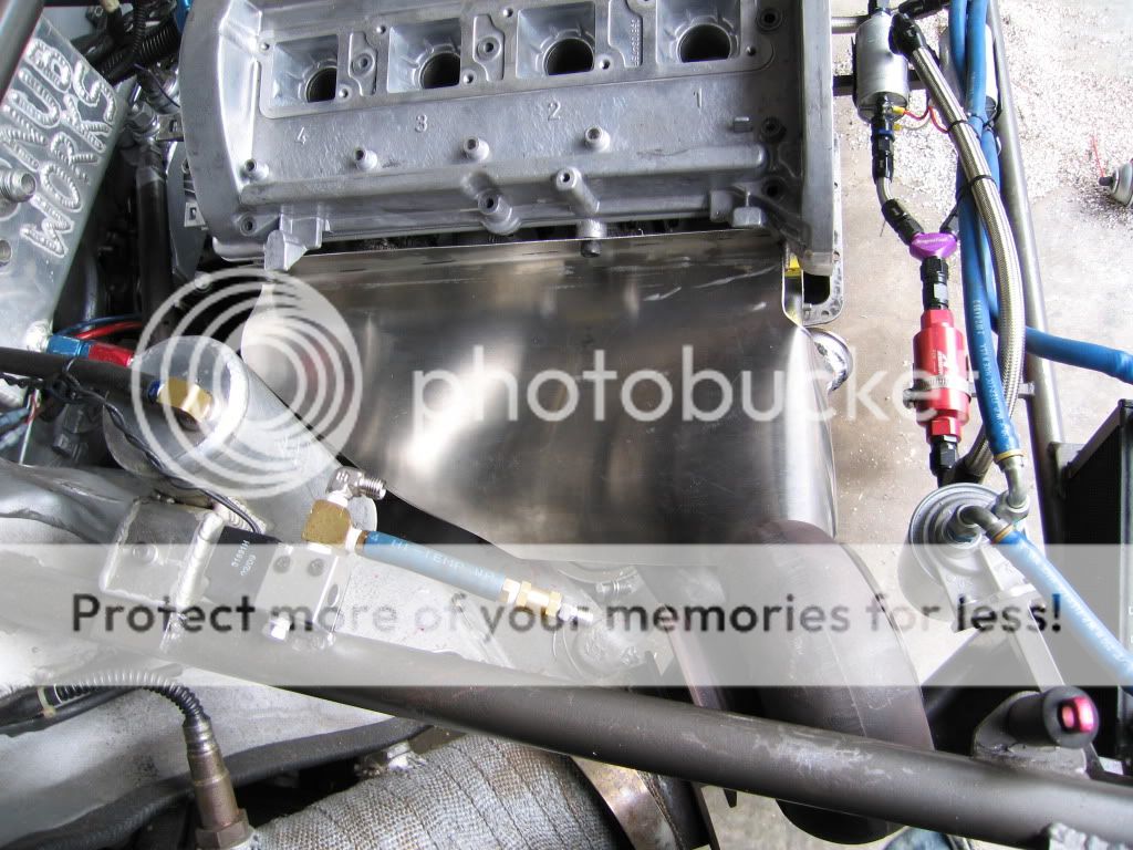

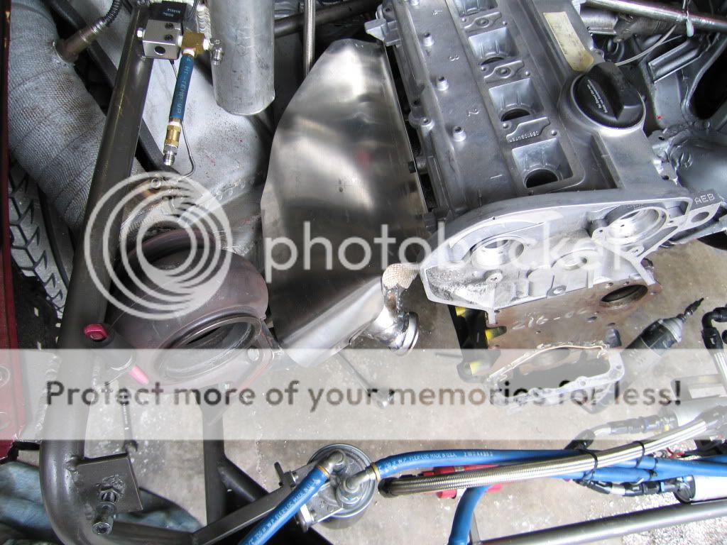

lets see, what else have i done.... OH YEEAH, the heat shield for the manifold.
SS 20ga plate. tried it out of 3/16" alum, cant bend it. tried it out of some other SS plate i found at work, thinner than the Al but still cant bend it. just went to the Metal Supermarket and browsed til i found what i wanted. traced my shape, tweaked it here and there, and VIOLA. its on and formed and shaped, but not finished. now i am going to make strips around the perimeter and then i am going to use some of my handy dandy heat resistant wrap stuff, and wrap the underside....its cool looking, maybe i do the top. i dunno. but rivet it to the plate and its done.

oh yes, and i have been researching HARD about the next project. do not worry, it will be built here LOL. its gonna be a fun one as well.
naudi1
Re: Aarons Drag CQ: 9-07 random maintenance stuff
Do you need a heat shield for a drag car?
- speeding-g60
- Posts: 2152
dunno. it'll help under hood heat. help keep that heat off my beautiful CF hood....
