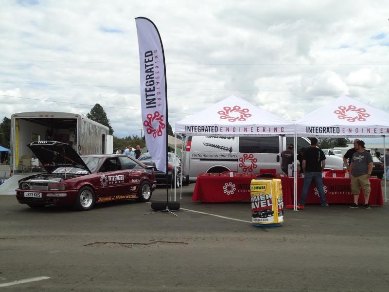

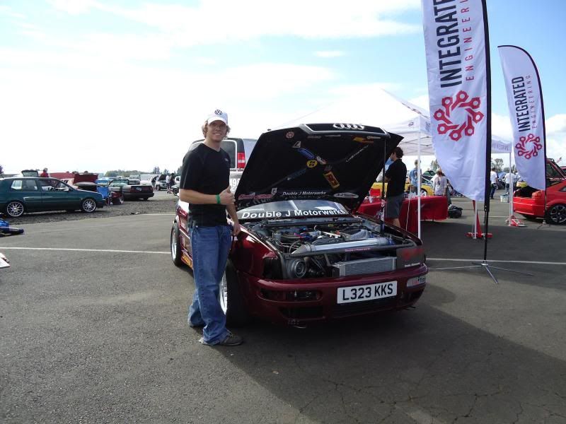

Damnit, Aaron better not give up! Not after his booth looked so bad ass. By far the best looking at the show!
This thing is way to awesome to give up on now!
