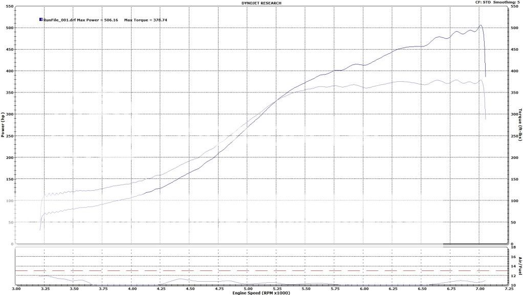

506/378 for the base pull, 23 psi and 17 degrees to 7k rpm in 3rd gear.
three more pulls, and then we want to turn it up. but there was a noise on shifts, a rattle sort of, so we pulled the plug.
better to quit early and save it instead of total waste like normal.
had alot of ears there this time, at least 4 people heard the noises....
but still, motor runs good other than what sounds like a rod knock or something. and without time to tear it down, oh well. car still goes to show anyhow.
i swear someone out there has a voodoo car doll on me. i just feel it. someone hates me and wishes ill will upon me....

Aaron those are still numbers to be proud of!!! I hope the noise turns out to be somthing simple! Are you still going to run it at the show? Anyways, I gotta go to bed. We are out of here early tomarrow. So I will be seeing you at the show man! Even if you don't get to run, it will still be great to meet some fellow MGers in person!
Re: Aarons Drag CQ: 8-20 dyno done. heard noise and stoppe
A rod knock? That loud that you could hear it above the dyno noise? Did it get louder with each pull and was it there on the first? I have to say you have had your trials with this car. Hang in there. It's still pretty impressive that you have it not only put together, but even have had it on the dyno, and all of this in time for the show. Awesome!!!!!
