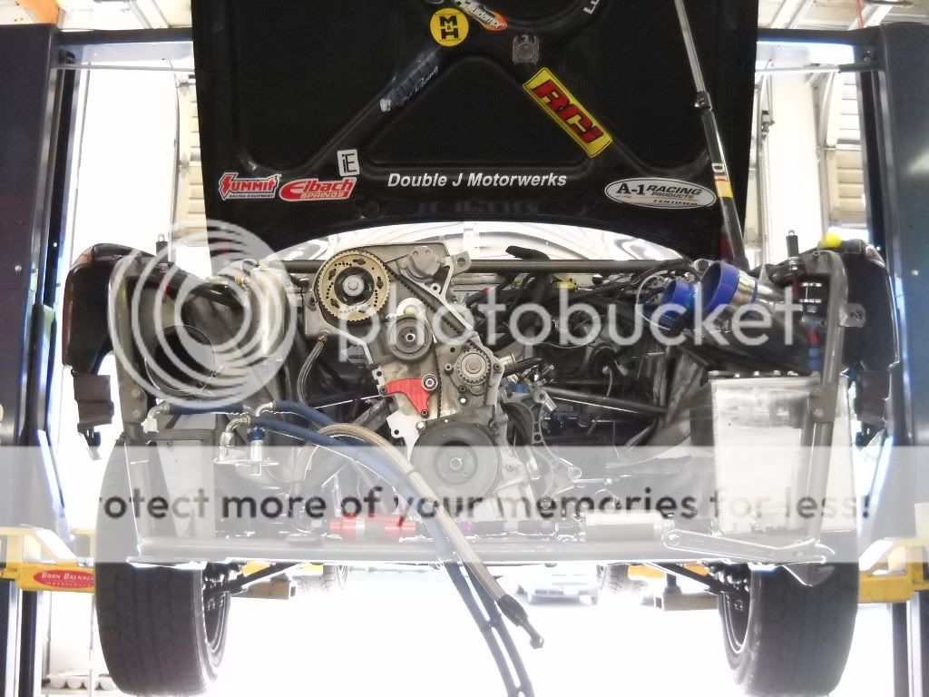

so it was a long day. and it didnt end the greatest, either. nothing major.... just the head is off the car again as there was alot more leakdown on cyl 4 than we like, after initial run it time. but that is fixable....
motor is in and fired up first try, like it should. warmed it up, fixed one leak in an oil line.

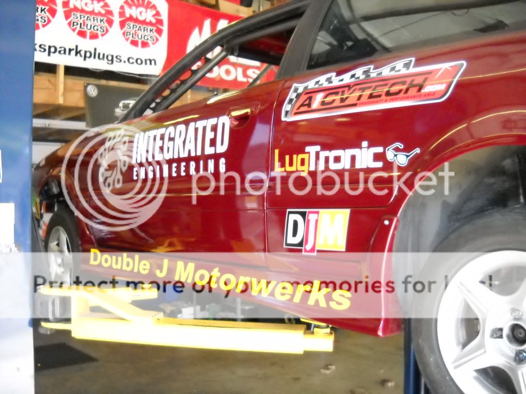

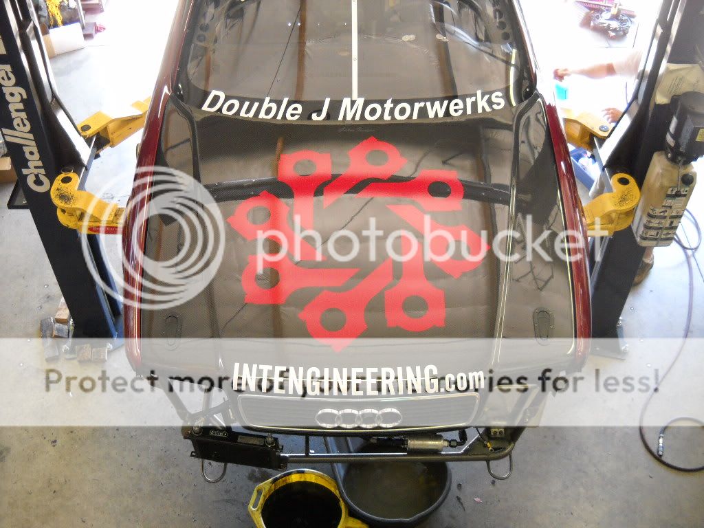

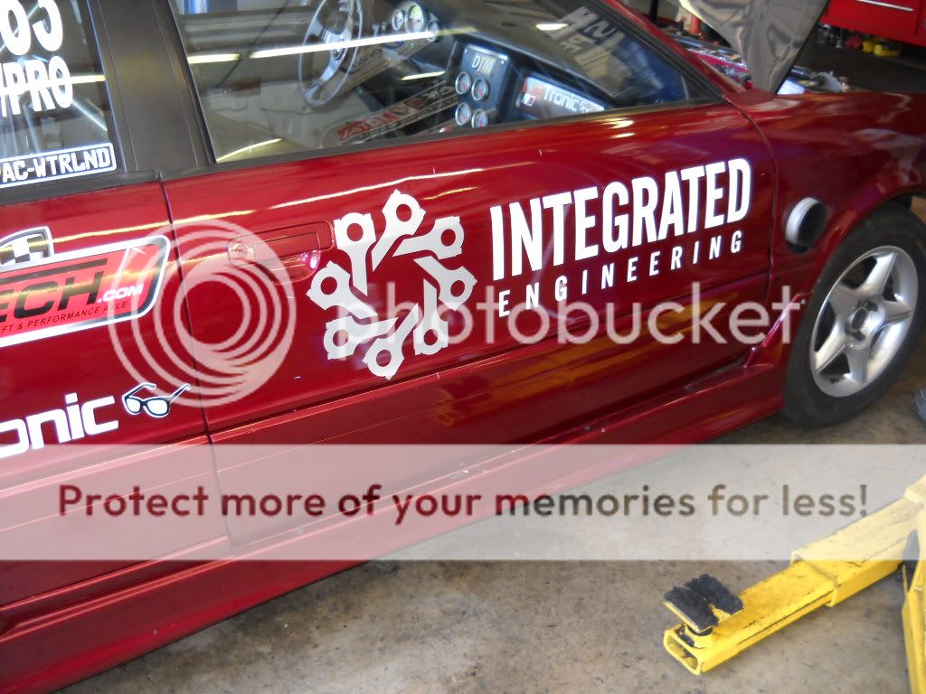

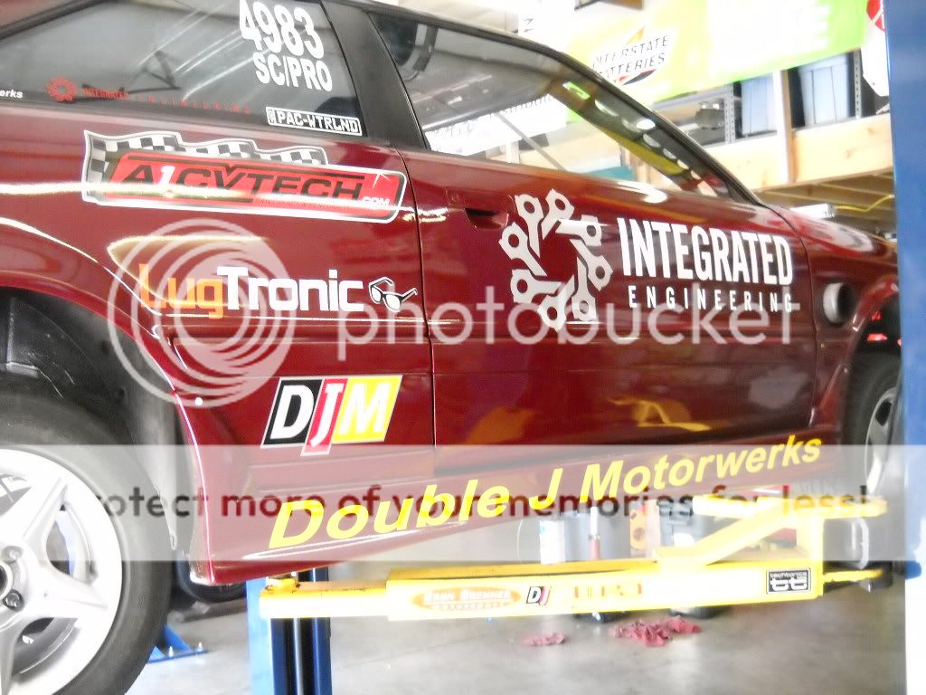

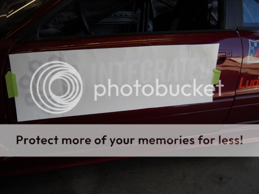

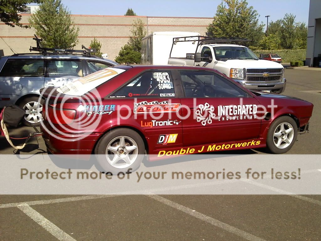

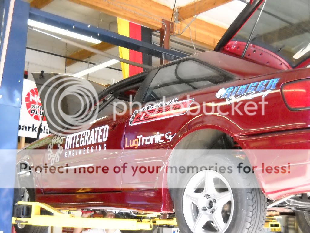

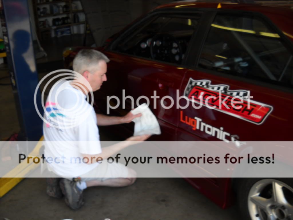

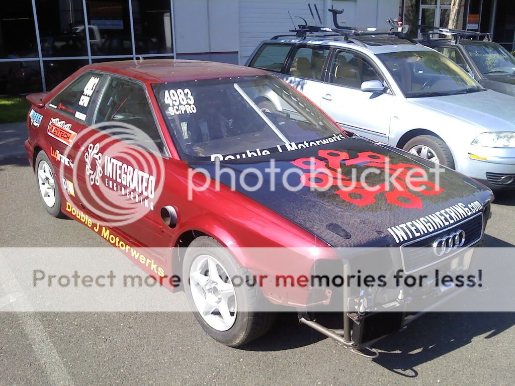

and somehow, Joey had some stickers made for the car, and they look VERY GOOD. the ring-of-rods logo is Silver and the lettering is White. red would not have showed up on the car....
seems the guys next door to his shop do this work. MOSO Graphics..... and they do some outstanding work. and Steve is a really nice guy, easy going, and totally into what we are doing with this car....

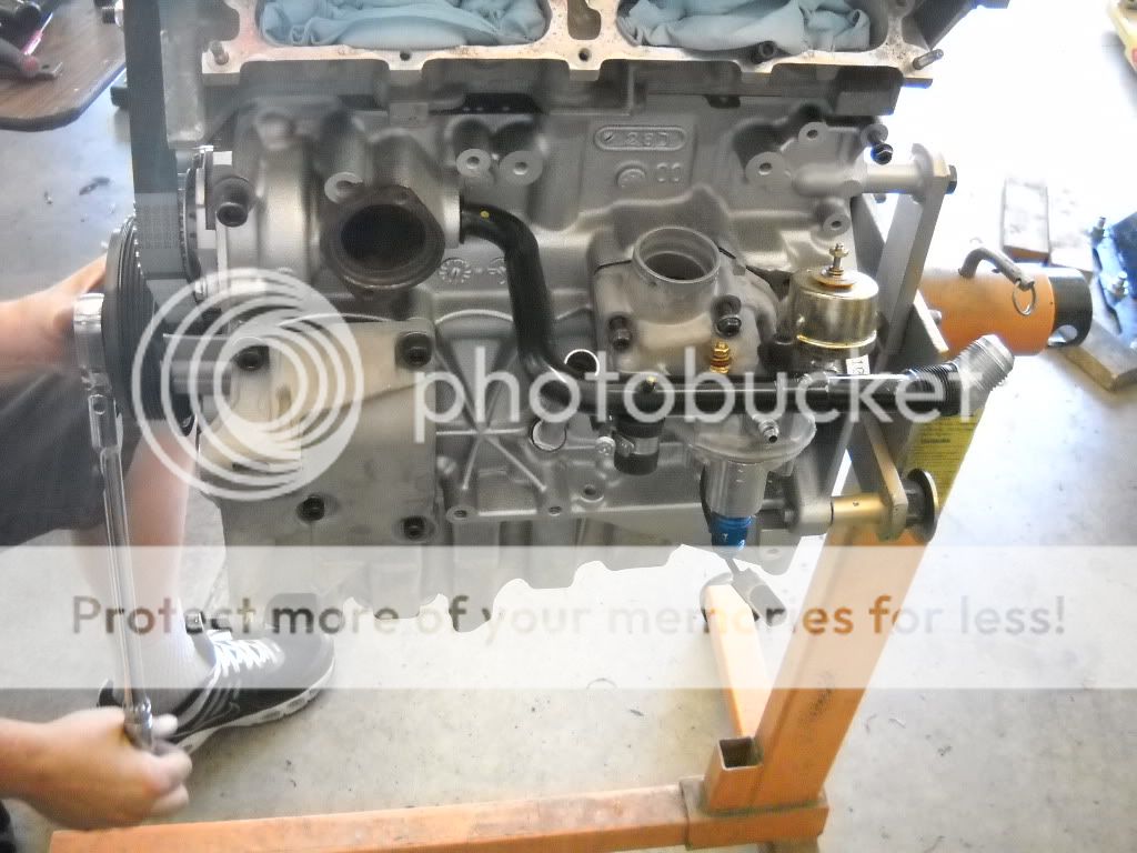

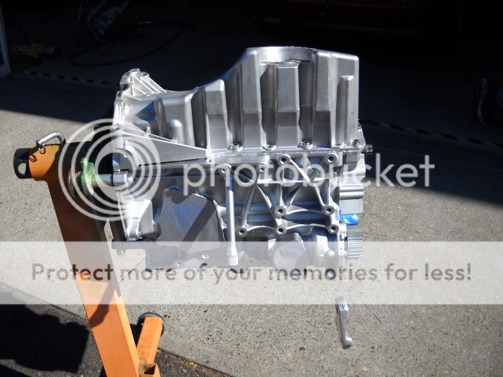

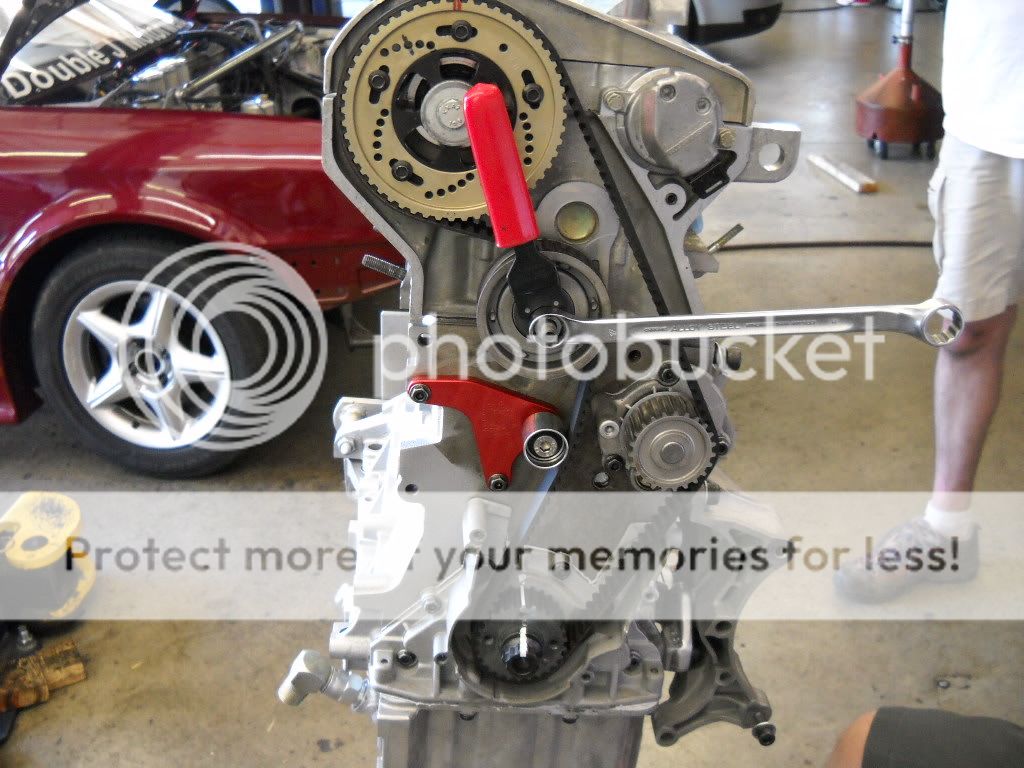

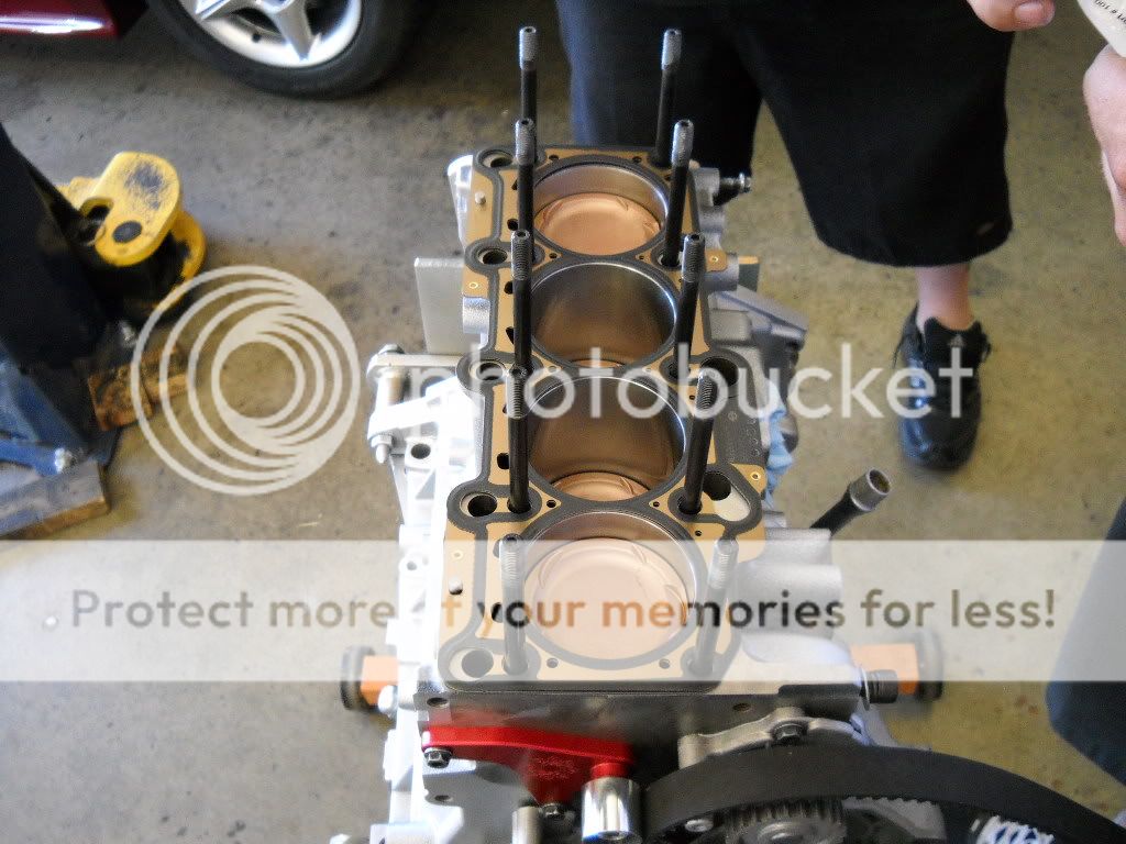

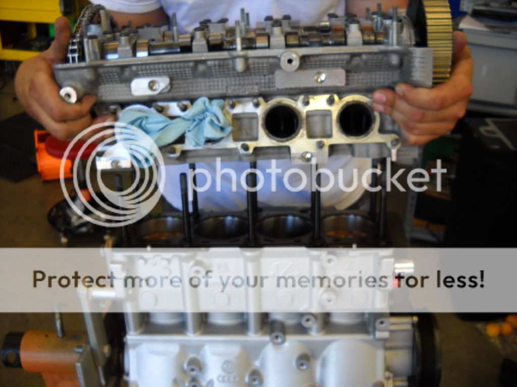

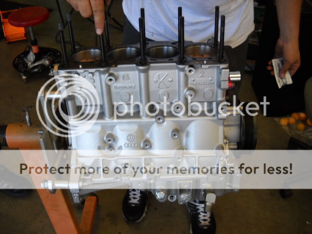

painted the block, a nice silver to match all the base aluminum stuff.

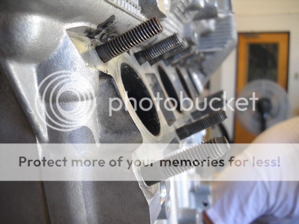

and getting the head gasket and studs in.
next, installing the head
putting all the lil stuff in place

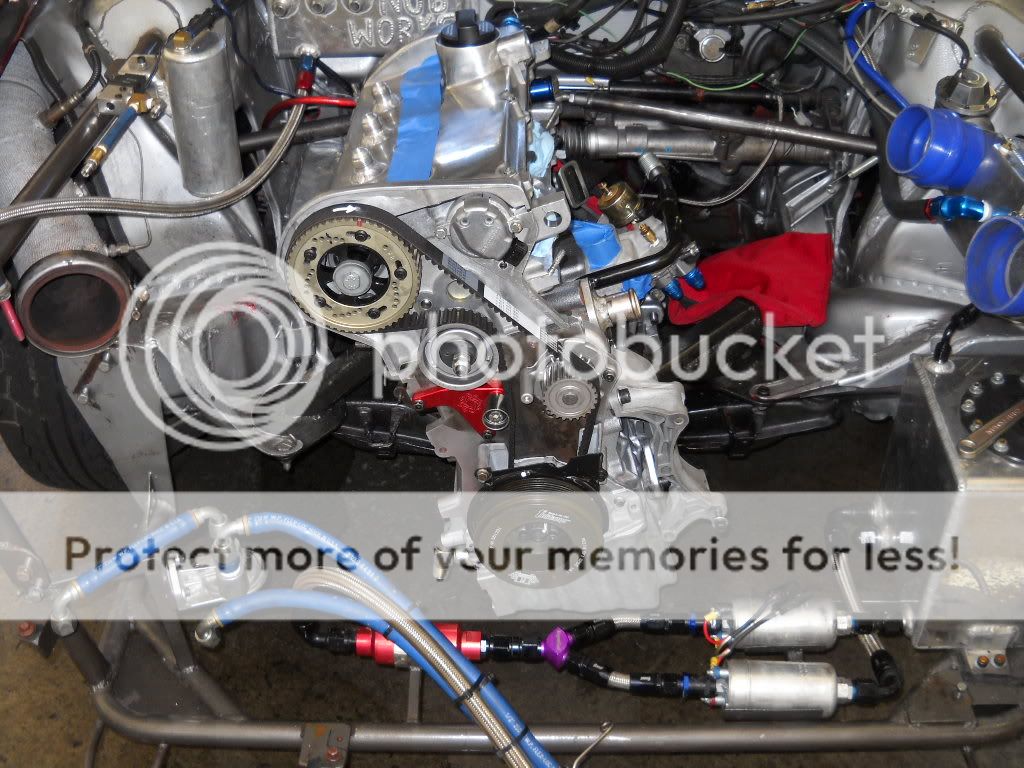

tensioning the TB after dialing in TDC and marking all that needs marked.

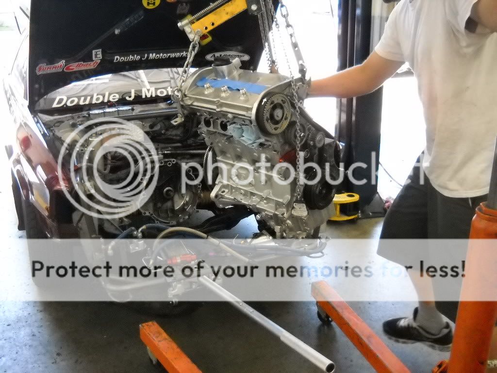

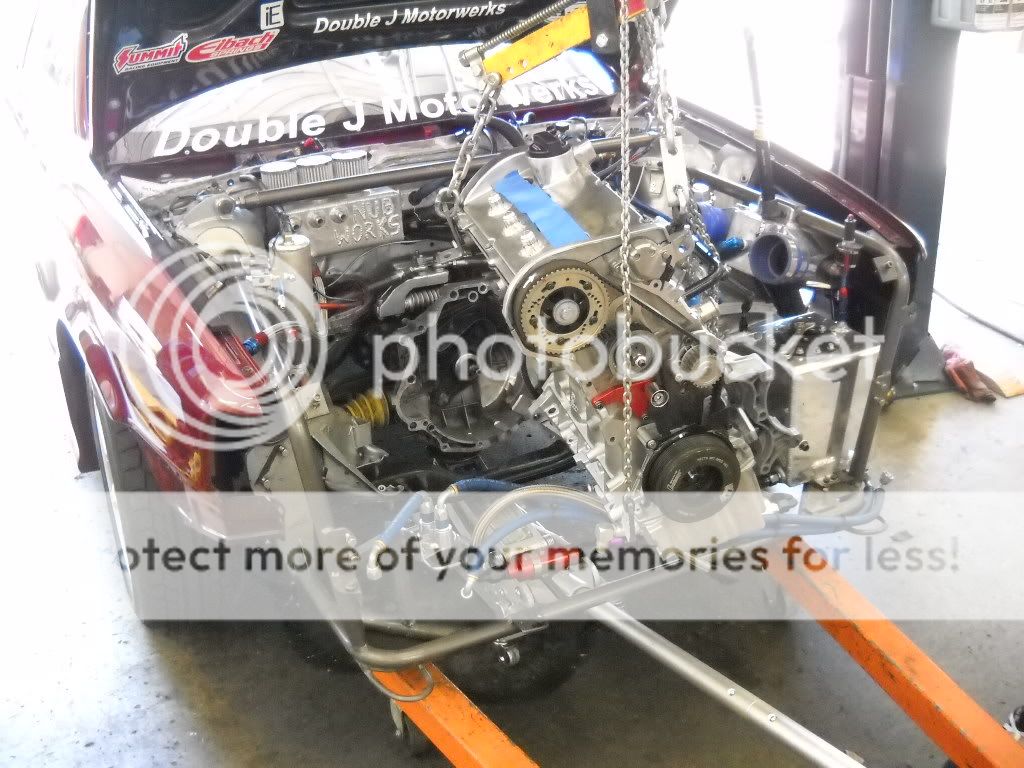

and now on to installing this thing.

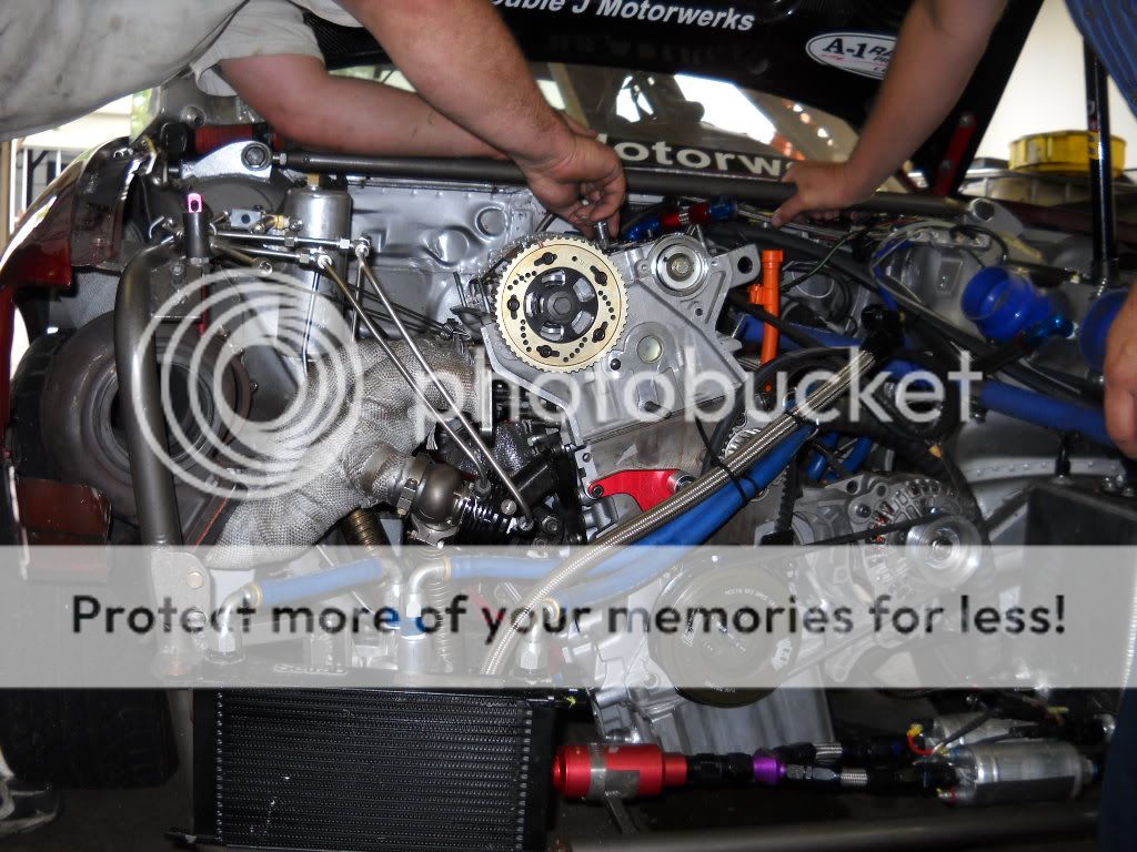

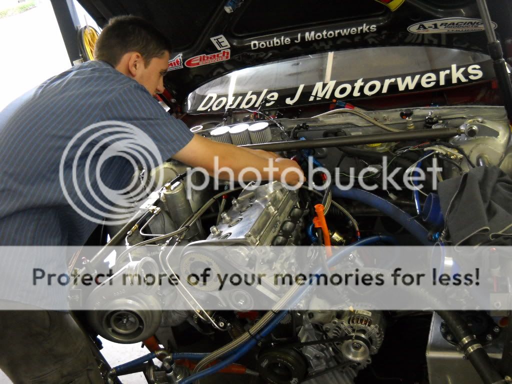

and just because, here are the start up vids as per my usual. the first is dry cranking to build oil pressure. this took 3 trys before we saw pressure, and i even filled the filter. it could be because the oil was sitting in the sun, and the Delo 400 15w-40 was as thin as water, i dunno. but it got pressure finally. when doing this sort of thing, you want the injectors and coils unplugged, as well as no plugs in the motor. makes it easier to spin over....

what tensioner roller is that? its pretty awesome
Re: Aarons Drag CQ: 8-14 motor in and running vids
lucas13dourado wrote:what tensioner roller is that? its pretty awesome
Integrated engineering
speeding-g60
Posts: 2152
Post by speeding-g60 »
yup. what he said. IE makes it, but not for the 058 motors yet.

Joey had some custom vinyl made up, it looks good to me.....

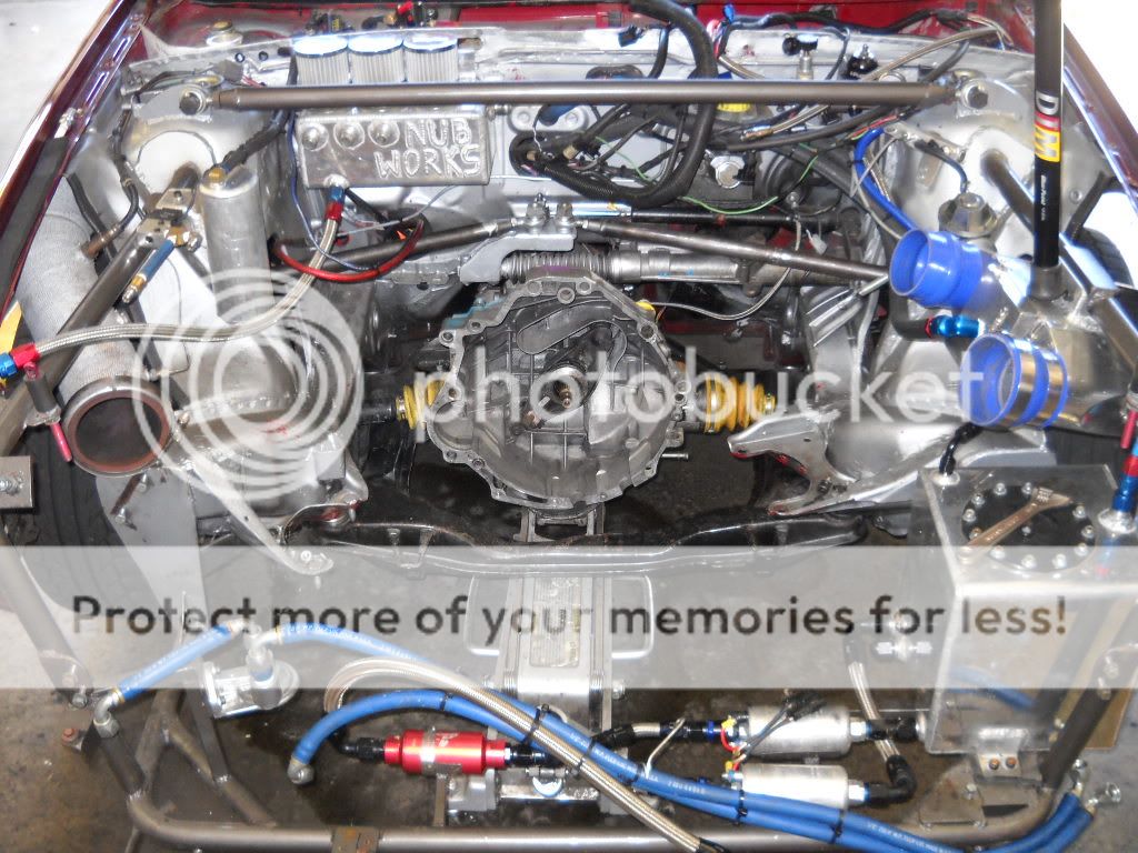

sooooo. another long day. got it all back together, prime for oil pressure. crank over for fireup. running, getting warm, notice something. HMMMMM. the front wastegate tube is LOOSE?
shut down, tear off the wraps. the WG tube off the merge is broken about 3/4 around!!!!! WTF OVER????? time to get the glue gun. spent about an hour or so MIG'ing it all back together. this manifold is officially a write off now. its only gotta last one day, and thats Sunday. seems the 16 ga experiment is concluded LOL. the welds did not break, rather the material right next to. dunno why, and today it dont matter..... will plan that out with a different manifold. same style, will probably leave the turbo where it is to lessen the work involved with the exhaust, dunno and right now dont care.... all i wanna do is run the livings out of it on sunday.
head is back on, car is running fine again. dyno tomorrow night.

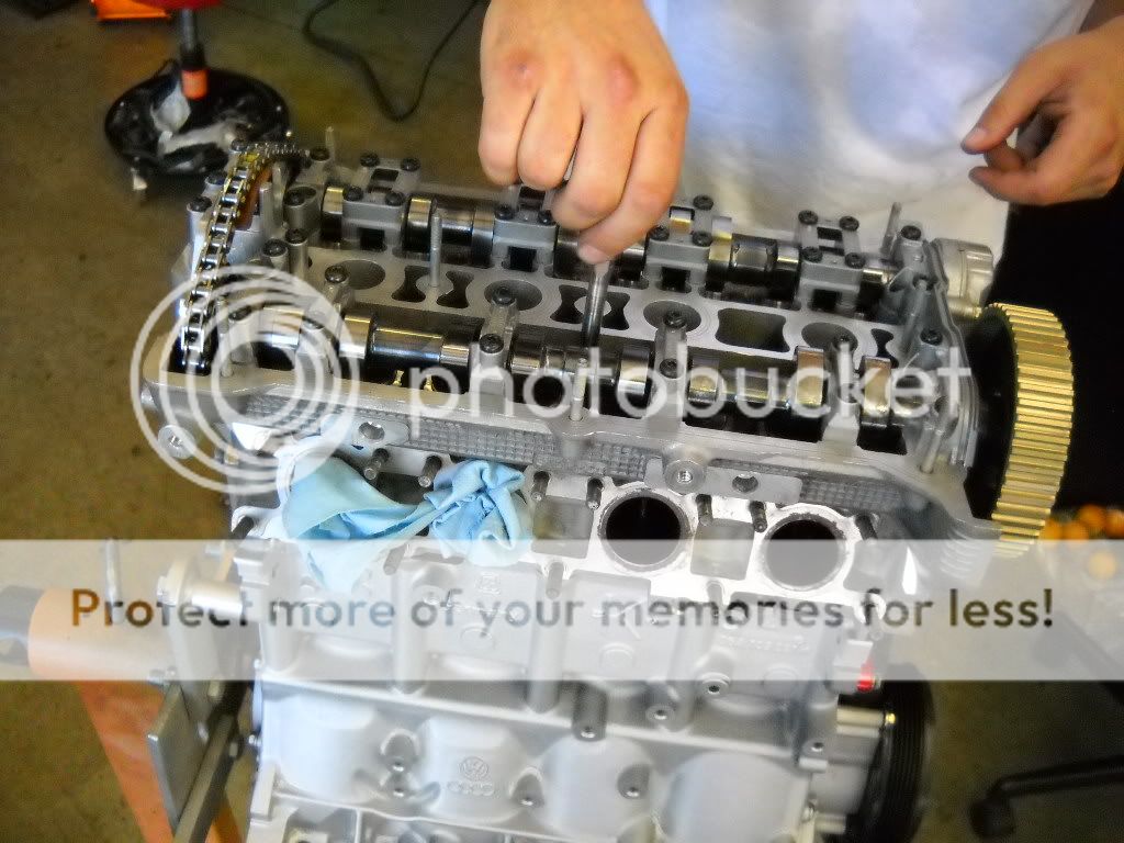

a couple pix, just cuz thats what i do. spent a substantial amount of time cleaning and cleaning.... and i even got the inter-cam timing SPOT ON THE FIRST TRY!!!!! one shot deal YO!
head stud row..... mmmmm. nice and ARP'ish.
lucky Joey just HAPPENED to have another IE large bore gasket around. this one was for the red 20/20 R32 swapped car he is building. STOLEN! i will replace it, as that car is a long ways from needing it yet. we already ordered the replacement. also of note, ARP assembly lube aplenty.
and the head on and putting stud nuts on....
