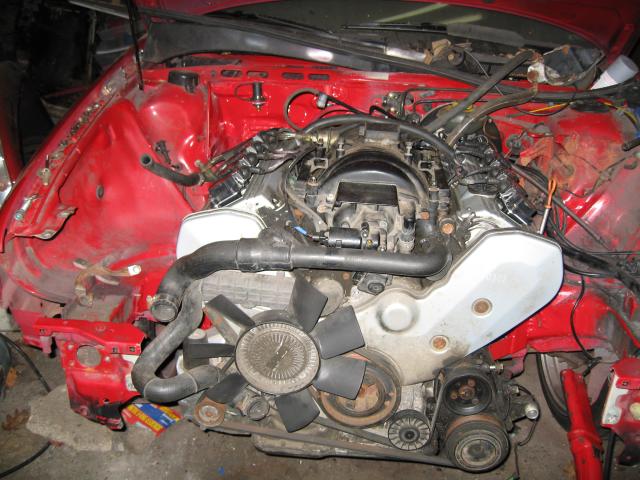

Yeah I may end trying to find a cheapy aluminum rad.

Looking good marc! :woowoo:

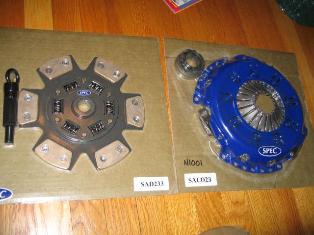

The Spec stage 3+ clutch and PP arrived today, now all I need is the pilot adapter and I can finally bolt up the motor for the final(? lol, yeah right) time.

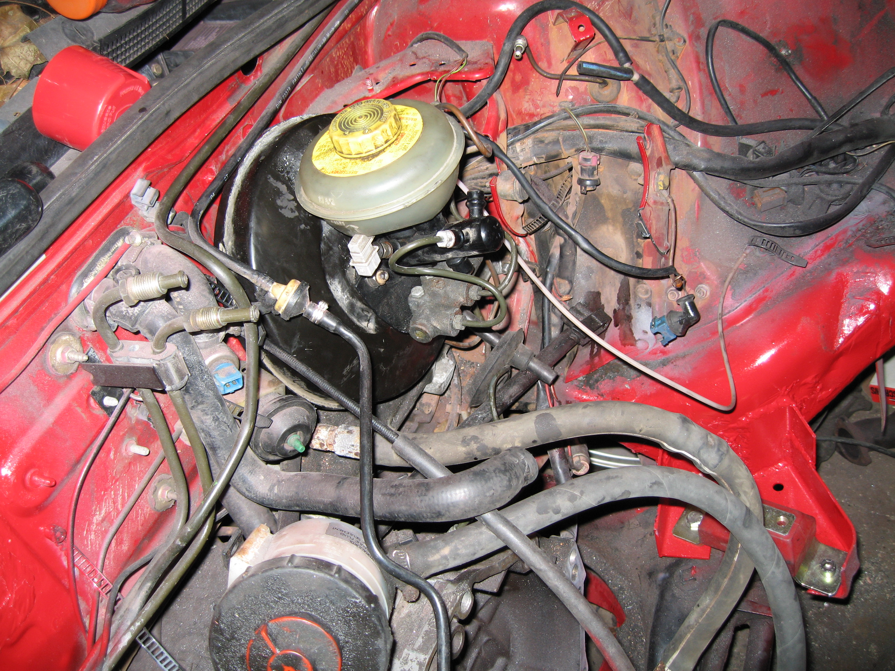

Hey Marc,
Can I get a better photo of your brake line set-up at the MC?

owdlvr wrote:Hey Marc,
-Dave
Hmm, not really, especially since I've done zero line routing yet. If you're trying to determine stock routing this (obnoxiously large) photo _might_ help:

owdlvr
Post by owdlvr »
I'm still trying to wrap my head around the routing for eliminating the ABS module.
Not sure why I can't picture this in my head...
-Dave

owdlvr wrote:I'm still trying to wrap my head around the routing for eliminating the ABS module.
-Dave
ETKA helps out here..
looks like the fender side of the proportioning valve needs to go to both rear wheels, while the opposite end goes to the right front wheel and the other two ports are connected to the master cylinder. The furthest out port on the fender side of the master cylinder goes to the left front wheel.
Corrections anyone? Looks right from the diagrams I'm looking at.

Post by audifreakjim »
Here's a few pics that I made when I deleted my ABS

Post by Marc »
hey, I guessed right! (well, got front right/left swapped, but I dont think that matters).

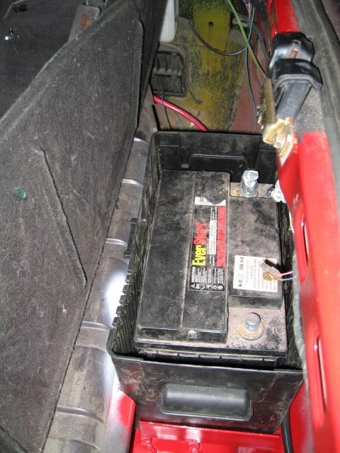

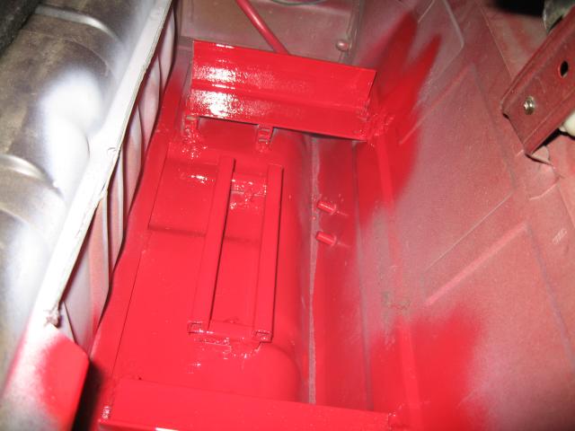

Last weekend I mounted the battery in the trunk. I think I'd prefer an under-seat mounting much like Myke did on his 90 but this will work fine for now:

Alloutofdonuts
Post by Alloutofdonuts »
a4kquattro wrote: I think I'd prefer an under-seat mounting much like Myke did on his 90 but this will work fine for now:
You don't happen to have any pix of his do you? I was going to do that but seems like it is too tight(ground clearence, Clarence), even though the Urq get's away with it... :?
At this rate you'll be done with this car before I finish mine! :o 8)

Post by Marc »
No, dont think so. I'll snap a few at the shop today.
There is actually plenty of room. His battery box goes plenty deep yet still stays above the bottom of the frame.

Alloutofdonuts
Is Tox's battery box on the passenger or drivers side? I guess I should wait to see the :pics: instead of asking all kinds of questions on your project thread :oops:
Shawn M.
Post by Shawn M. »
should be on the pass side for weight distribution

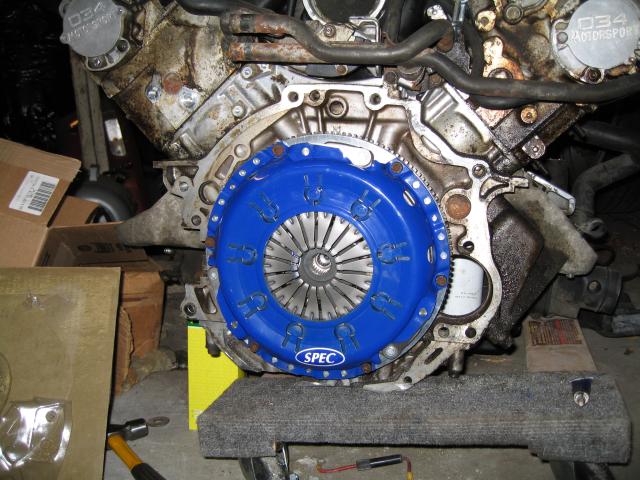

Update! Finally making some progress here, installed clutch and pressure plate:
And now that the important bits between the engine and transmission are all set I can start putting stuff together :woowoo:
Things are VERY tight around the brake master cylinder. I'm thinking I'll need to tweak that upward a bit.
