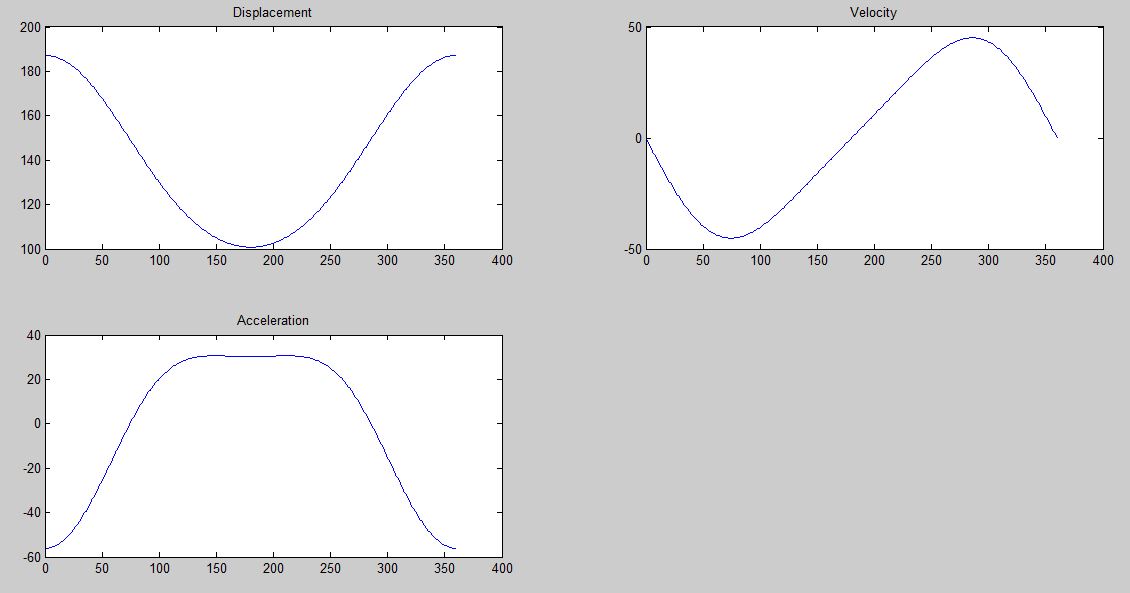

As usually happens when I get to thinking about this kind of thing, I started applying some math and stuff to the situation. I'm curious about how the acceleration of the piston is affected in all of these setups. I'm feeling super smart about working through the equations on my own to come up with these plots. I thought they looked wrong at first, but then checked them against similar plots from others and they are correct! 8) The values in the plots are arbitrary for now, but take a look and try to understand the relationships. I will post overlays of different rod ratios later and will add some engine speed context.
This is for a stock AAN or 3B engine (86.4 mm crank and 144 mm rods)
Piston Motion Plots.JPG (48.95 KiB) Viewed 49806 times
Kevin, I have homework for you. If you have the time, see if you can come up with the equation of motion for a piston in an engine. Then you can get it's velocity and acceleration at any point in the rotation. I had fun doing it :shrug:

loxxrider wrote:Kevin, I have homework for you. If you have the time, see if you can come up with the equation of motion for a piston in an engine. Then you can get it's velocity and acceleration at any point in the rotation. I had fun doing it :shrug:
Haha, joke's on you! I actually did that last year sitting in some class! :P
But really, I was idly sitting in lecture, and a thought popped into my head as to what the top speed of my pistons was. Did some trig to find the position and derived with respect to crank position (I was also pretty proud at the time). Of course, this led to my next quest, which, despite my extensive research, remains unresolved. So, your homework, if you have the time, is to help me determine what gives different engine configurations their distinct tones, and why. The "why" is the important part. :)

Aktapod wrote: So, your homework, if you have the time, is to help me determine what gives different engine configurations their distinct tones, and why. The "why" is the important part. :)
The answer, young padawan, is firing order.

That's funny, I found that last night when doing some educational reading and searching for topics on rod ratio.
Kevin, this is a question I've often asked myself too. I think he's got it right about firing order. That is the major determining factor in the way an engine sounds. HOWEVER, that isn't the final answer. As you probably know, the same engine with the same exhaust and same everything can sound much different with varying cam timing and even ignition timing. An engine with not enough timing in it can be audibly "flat" compared to the same engine in proper tune. 7A cams make for a higher pitched sound than 3B cams for example. Ultimately, these things all change the way the sound waves combine to create the overall sound. Some cancel each other out, sometimes they combine, other times they may form a "beat" phenomenon, etc. To get into the details of it would probably require a vibes analysis! This is the most I've ever thought about it though, and I think it is pretty logical.

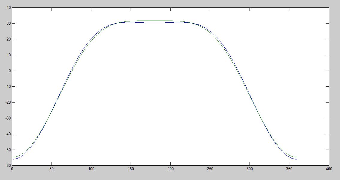

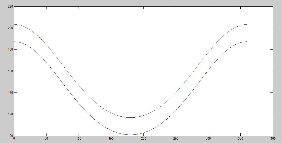

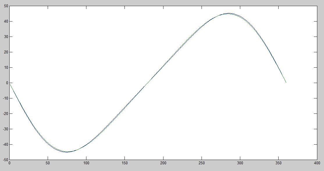

Here are some comparison plots. Green is 160 mm rod in a tall deck with 86.4 crank. Blue is 144 mm rod in a normal block with 86.4 crank (I know the color choices are terrible, will change that on the next go). Note that peak acceleration and therefore peak stress is at TDC, not BDC. The plots are all in the angle domain. I will convert them into the time domain later (it's just a matter of scaling) to give you guys some palpable values of accelerations and therefore forces. I think the important thing to note is that in this particular case the difference in stresses will not be that much for a given RPM. However, that small difference in stress may be a big deal if the hardware is close to it's physical limitations.
Also quite noteworthy is that funny looking hump at bottom dead center on the acceleration graph. That is something that occurs in most engines and is dependent on the rod ratio. Increasing the rod ratio minimizes or completely eliminates that. The reason this is important is because this can cause some secondary vibrations. I have to give this part some more thought.
Overall comparison
144 vs 160 mm rod.JPG (52.41 KiB) Viewed 49753 times
Position - Blue 144 mm rod in regular block with 86.4 crank vs Green 160 mm rod in tall deck with 86.4 crank
144 vs 160 position.JPG (43.12 KiB) Viewed 49753 times
Velocity - Blue 144 mm rod in regular block with 86.4 crank vs Green 160 mm rod in tall deck with 86.4 crank
144 vs 160 velocity.JPG (39.96 KiB) Viewed 49753 times
Acceleration - Blue 144 mm rod in regular block with 86.4 crank vs Green 160 mm rod in tall deck with 86.4 crank
144 vs 160 acceleration.JPG (40.67 KiB) Viewed 49753 times

OK, better plots have arrived. My MATLAB skills are constantly in development lol
For the nerds out there, you can take the max value on the acceleration plot and multiply by mass (what mass to use depends on where you want to find the stress) to get force due to piston movement (does not account for cylinder pressures, friction from sidewall forces, etc). This is still quite relevant however if we assume that all variables other than those affecting rod ratio are the same. This is a good assumption too, especially at TDC where peak stress due to piston dynamics is located. Then, you can use mechanical properties of the component in question to calculate the stress in the component (due to piston acceleration).
I will probably do a first order approximation of this with respect to rod bolts. For example, you can just take the mass of the piston and rod without the big end cap and multiply by acceleration to get force. Then multiply force by x-sectional area in the region of interest. The fact that peak stress happens at TDC makes things simple! - no angles to deal with. This way it is possible to know the delta in stress induced by RPM which will be useful for determining if one combo will be significantly better than another. If I can determine that the difference is acceptable for the worse case (the short rod), then I will elect to use that due to its superior torque/spooling capability.
The next thing on the horizon is looking at what that funny "M" shape at TDC does to engine vibrations. That could be a bit too much to get into for now though. We'll see how bored I am... or how hard I want to try to figure it out. :idunno:

To respond to your last point first, I would say it probably isn't worth it. 99% of Audi enthusiasts (even the craziest ones) are happy with the selection of stock cranks. There might be one or two in the US, but most of the people interested would probably be in Scandinavia. Those guys do seem to be happy with stock cranks though. I think the market would bare 10 cranks max.
Jeff, I totally understand what you're saying here. I fully grasp the complexity of the system, as I have some background in vibes analysis in jet engines. The analysis I just did was merely a single component of a big force sum. I didn't mean to say that max stress is at TDC, just that the component of stress due to piston acceleration is at the maximum there. At (and near) TDC, the rod (for example) sees tensile stress from the piston motion, but also sees compression due to compression ratio and, more significantly, rapid gas expansion as the mixture explodes.
After approximately 90 degrees, the load on the rod goes into compression due to piston motion AND due to expansion of gasses, etc. as you mentioned. I agree, that the overall max stress on the rod is not at TDC for this reason. I don't agree that this occurs at BDC though as by that point the piston gets to BDC, the pressure has been relieved a bit due to volume increases. I can also make a first order model of this for an interesting approximation of the situation. It's all in good fun anyway. This is more of a learning exercise than anything, and I've learned a TON in the last day. If it leads to some information that helps us make a slightly more educated decision on what combination to go with (or helps me understand your educated decisions), then that'll be icing on the cake :)

That's awesome. What you are after with the model makes total sense to me now. Certainly the maximum BMEP force is at or near its maximum at 13 to 15 degrees after top dead center - IF the ignition timing is correct for the octane / burn speed of the fuel being used.
However the piston "weighs" the most at direction change BDC / TDC dependent on in cylinder dynamics
The point of max piston Velocity is between 71 and 73 degrees after top dead center dependent on the rod ratio involved. One HUGE key to torque production (through cylinder filling of course) is to have cam profiles and install points which have the intake valve open to the fat part of the head's flow numbers just before the point of max velocity. Here again is where shorter vs. longer rod ratios make notable differences in the operating characteristics of our play toys!

Yes, I should correct myself that the load reversal point (and therefore max velocity) of the rod is around the low to mid 70's as you just pointed out. I don't know what I was thinking when I was typing that, but I was working at the same time. It looks to be closer to 74.5 degrees on the stock AAN as opposed to about 75.8 degrees on the long rod tall deck engine.
Good info Jeff, especially on the intake valve opening close to max velocity. It all makes sense when you get into the nitty gritty details! So we will spec the cams once I/we decide on the rod ratio, eh?
