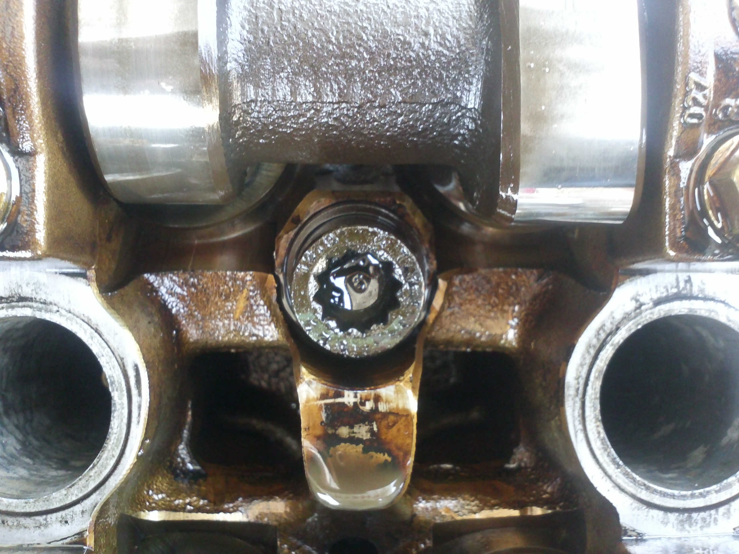

The standard head bolts are triple square not reverse torx. M12 xzn. Fat chance of getting vice grips in as the books are recessed into the head. $10 socket or hours of potentially fucking something? I know what I'd choose...
Birthday Beer!! this rolling rock has been hiding in my fridge since late 2013. Lunch... Right so 3 x 4 corners per a square seems legit. It's 12 points in the stud head. Maybe my mechanic friends have the bit

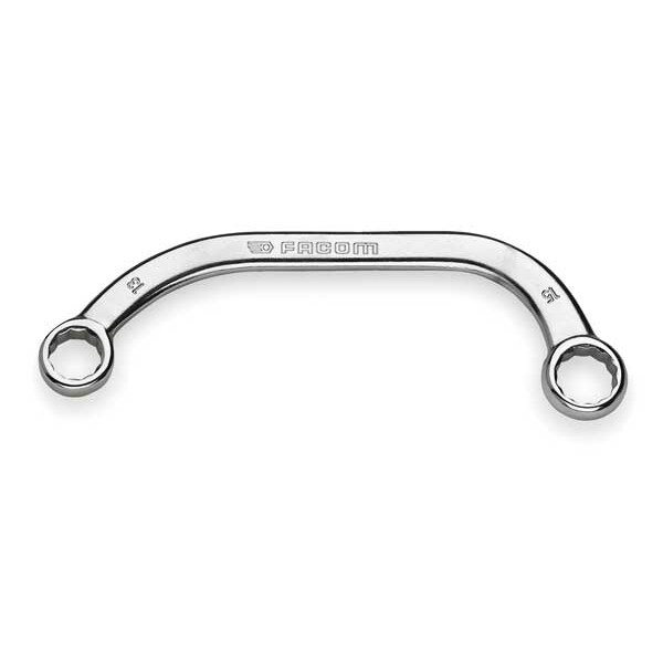

Sven, what type of wrench did you use when you replaced the turbo to downpipe gasket?? I got the one pointing toward the starter barely loosened up and off after monkeying with a 15 mm wrench today. Of course before I found out it was 15 instead of 17 mm, I had already cut a 17 mm wrench in half lol. What a waste! did you use one of the half moon shaped box wrenches like this:

kieron_32v wrote:The standard head bolts are triple square not reverse torx. M12 xzn. Fat chance of getting vice grips in as the books are recessed into the head. $10 socket or hours of potentially fucking something? I know what I'd choose...
He said studs so I assumed exhaust studs. You really think I don't know the headbolts are a triple square design or that you couldnt get vice grips in there? I've done quite a few heads fyi. Forgive me for not reading "studs with crazy star design" as "stock headbolts"

I didn't imply anything of the sort sir. Just stating the facts. Fwiw I've never seen exhaust studs like that on a 20v either.
Just go to oreilly or napa, or whatever and ask for "triple square" tool pack. It's like $5 for 4. Comes with the size you need for your CV axles too.
I have before, but whether they are factory or not beats me. Going off of the words 'studs' and 'star', I only assumed exhaust studs. Lot of domestic vehicles use that style with a reverse torque, especially Fords. I tried converting my studs over to a chevy style stud that had that design but it didnt work out the way I planned.kieron_32v wrote:I didn't imply anything of the sort sir. Just stating the facts. Fwiw I've never seen exhaust studs like that on a 20v either.
Haha, to be honest, when I got to that part, I found that particular nut was missing. I was quite pleased, because it looked killer!
The others came off fairly easily with a socket. From a performance standpoint, I'm not actually losing anything from a leak there (technically gaining, actually), and it had been sealing fine without it, so I just left it off, since I didn't have a replacement. No problems so far!
