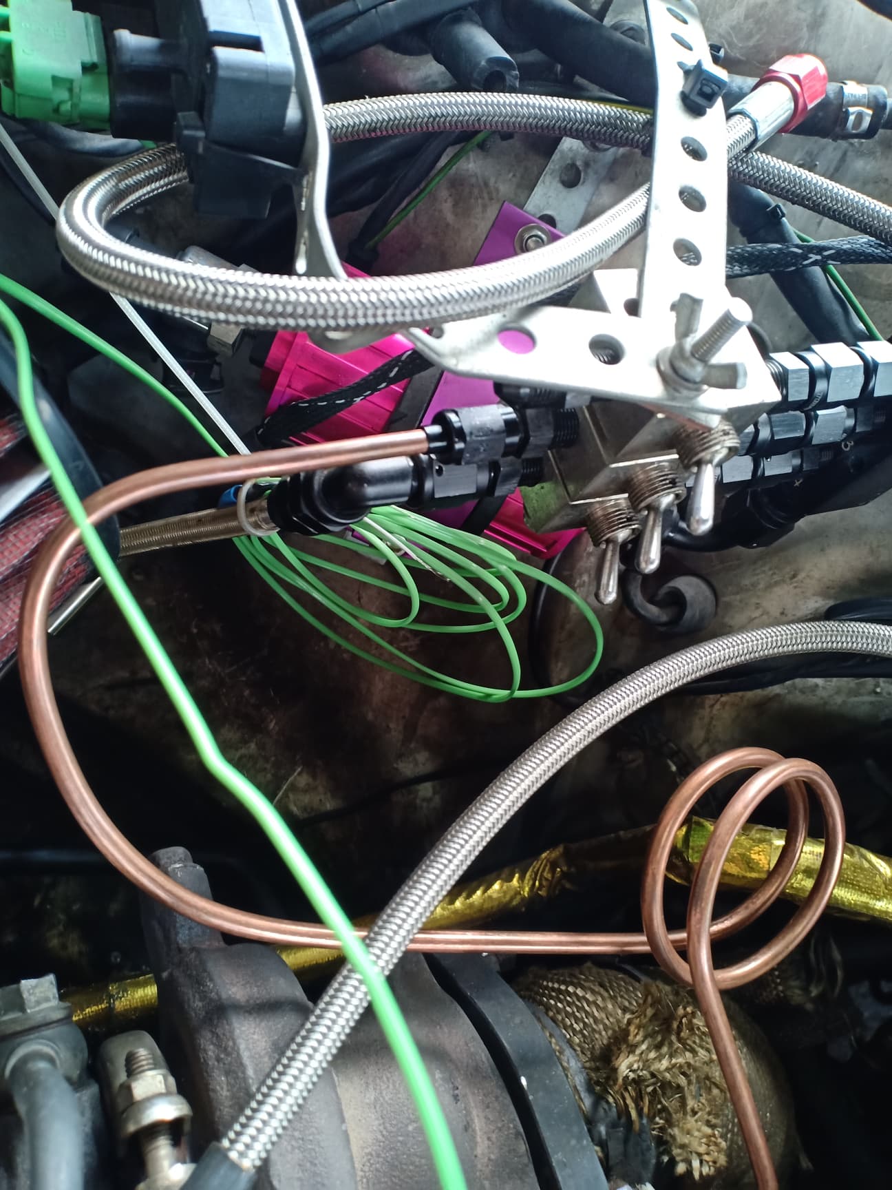

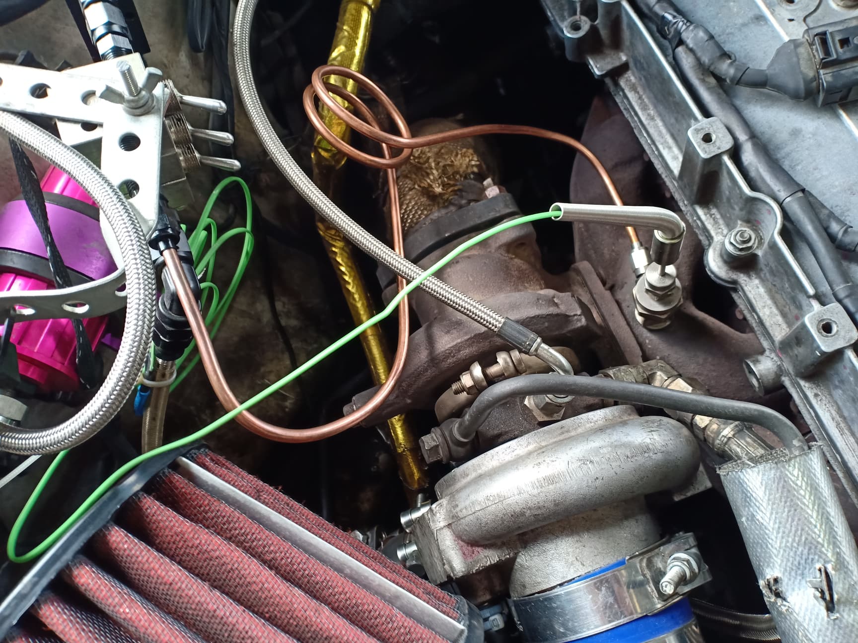

Wow, it's been a long time since an update. The COVID thing gave me lots of time to work on stuff.

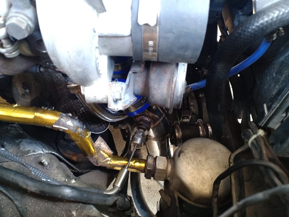

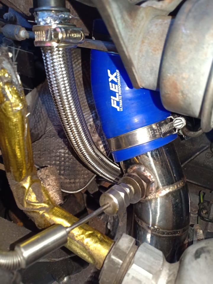

The back pressure sensor and EGT sensor in front of the turbine are finally in. Haven't hooked up the new EGT yet because I want to integrate it into the current sub-harness. The BP is working now. And yes, the turbine is restrictive. Have a EMAP/IMAP ratio of 2.5:1. No bueno.

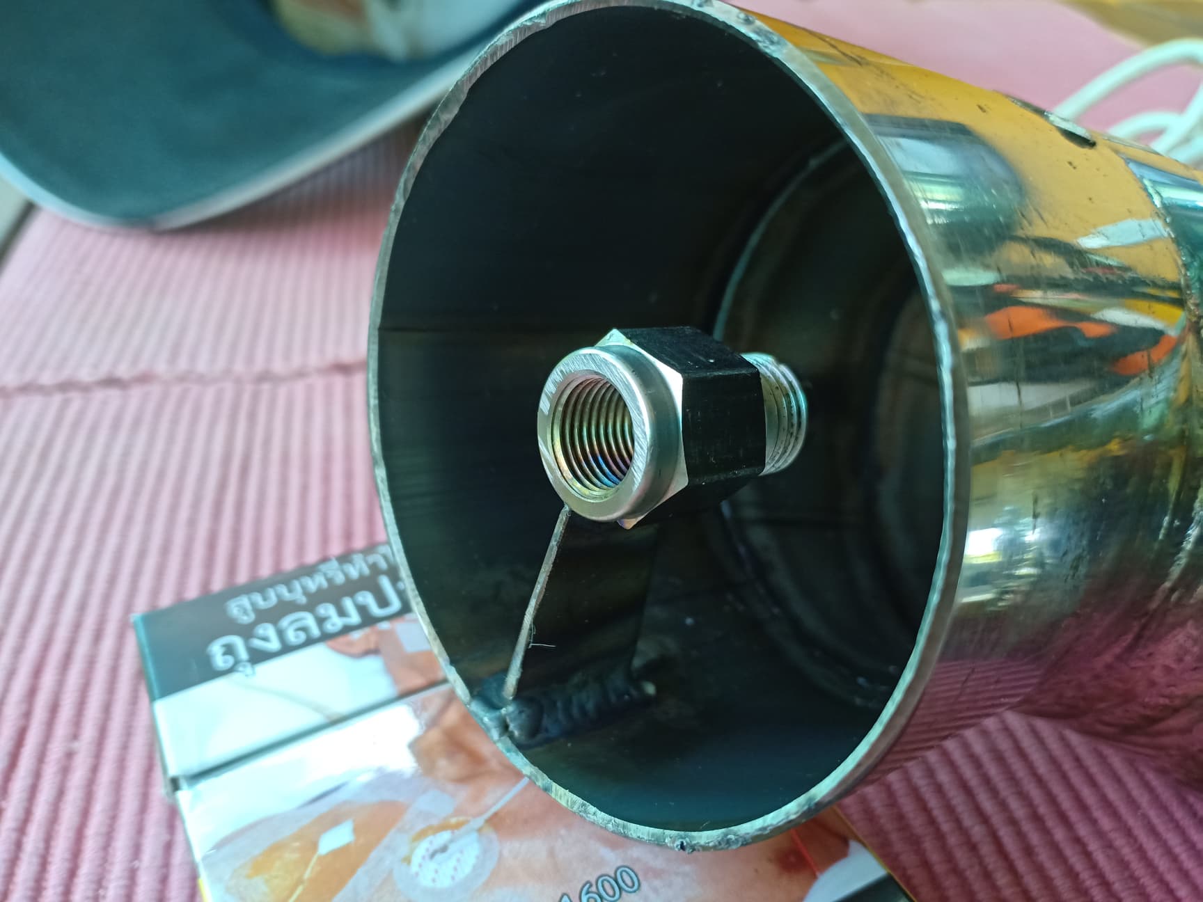

Also installed the water injection stuff, but with less success. Found I cracked the top of the pump and some funny things happen PWMing the DO solenoid with VEMS. Solenoid is connected to EC36-34. The nozzle holder is in, but I'm not happy with how I mounted the hose and solenoid.

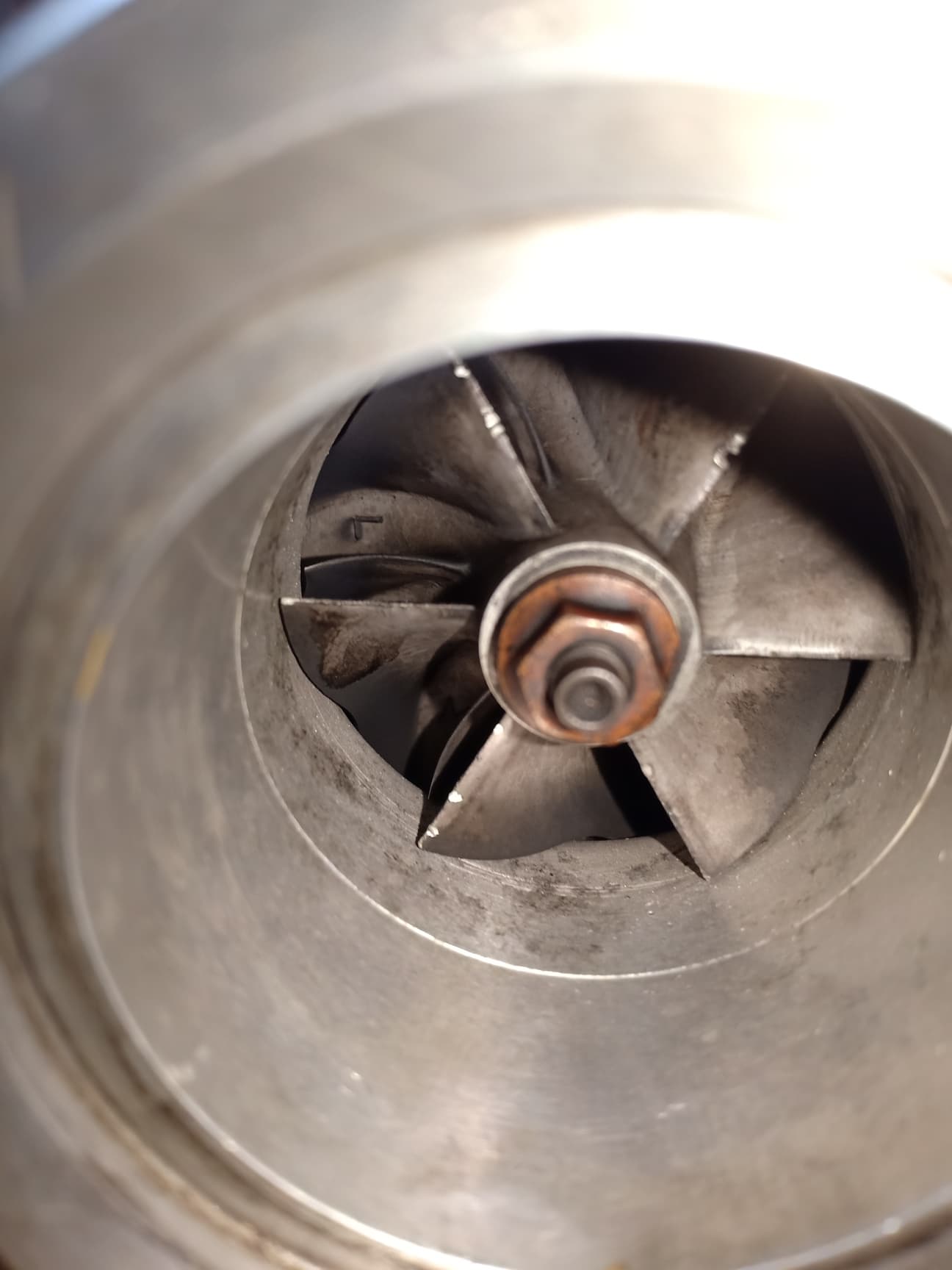

Oh and managed to damage the compressor wheel with my dumb ass.
Pictures.

- BP and EGT fitting 1.jpg (285.02 KiB) Viewed 13835 times
- BP and EGT fitting 2.jpg (234.02 KiB) Viewed 13835 times
- WI nozzle holder 1.jpg (139.93 KiB) Viewed 13835 times
- compressor wheel damage.jpg (88.48 KiB) Viewed 13835 times

That's a pretty nifty injection fitting you've fabbed up. Can't wait for more results with the w/m injection project.

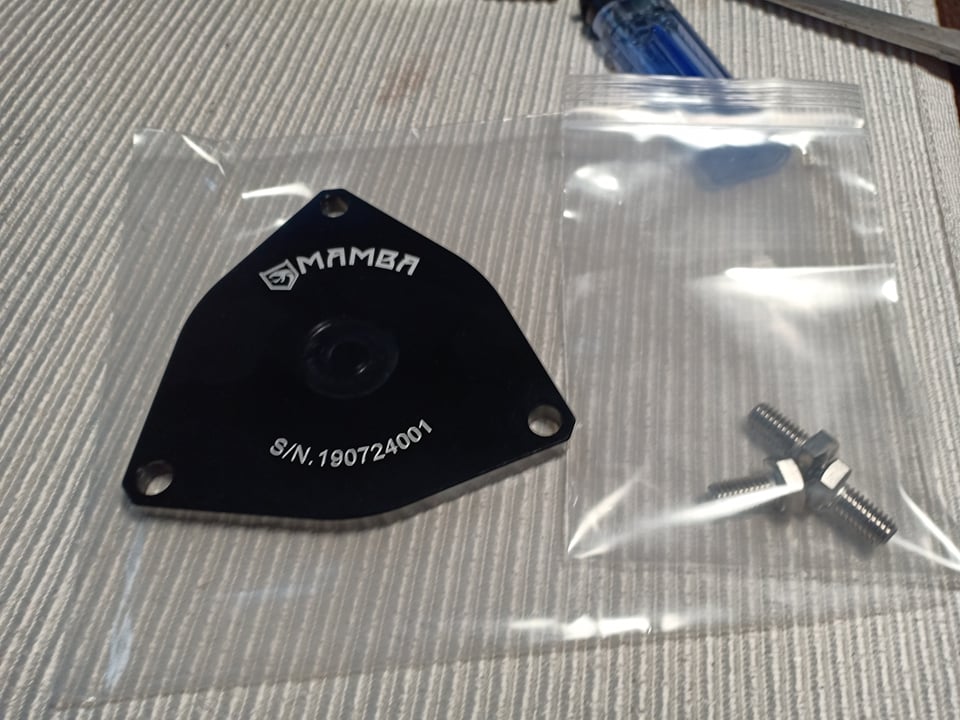

Tech tip: If you ever use a TD04HL with stock oil drain, an AN-12 PTFE hose slips right on, just tight enough. Also, the stock Volvo turbo has a Compressor Bypass Valve. The diaphragm might be K, but the seal ring is not. Got a block off plate from Mamba and now it doesn't leak! Yay.

- 16T CBV block off.jpg (96.78 KiB) Viewed 11252 times
