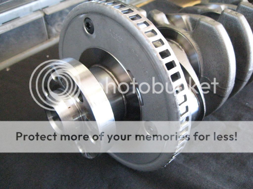

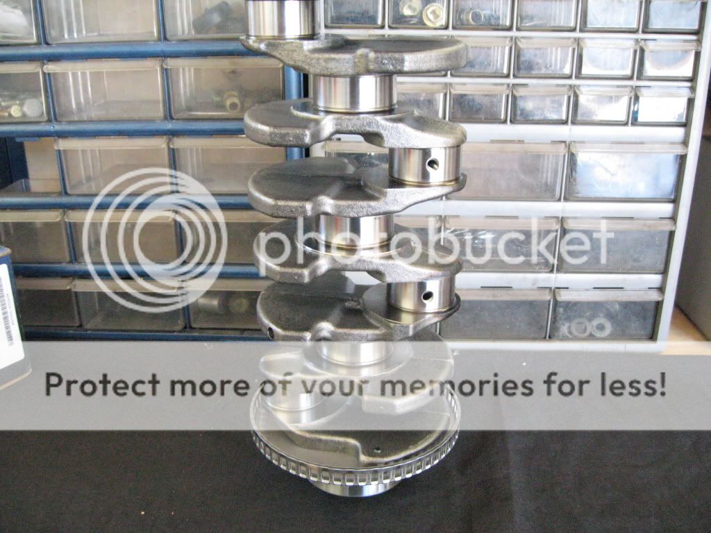

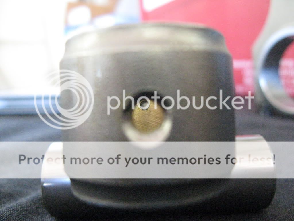

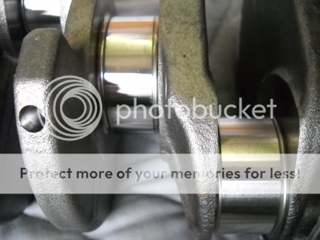

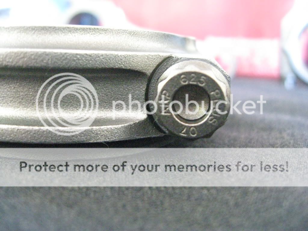

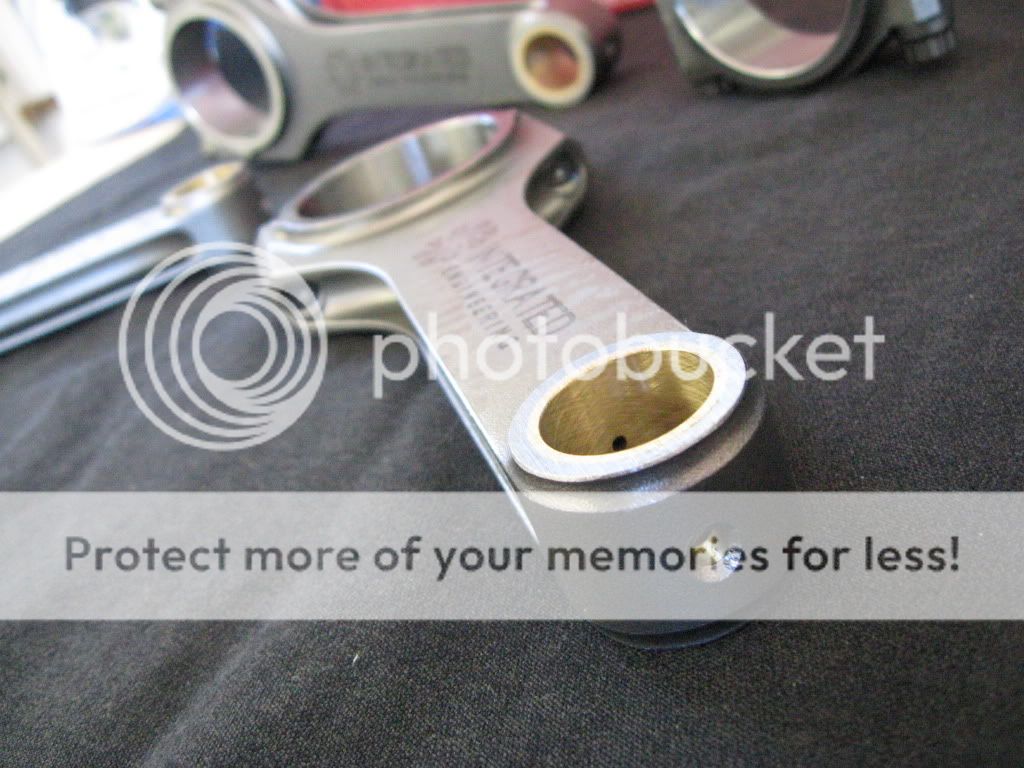

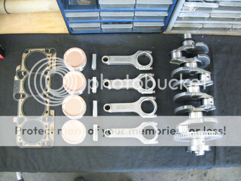

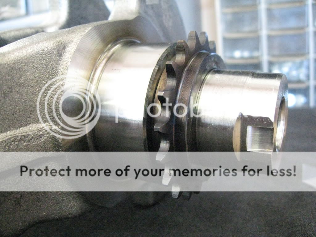

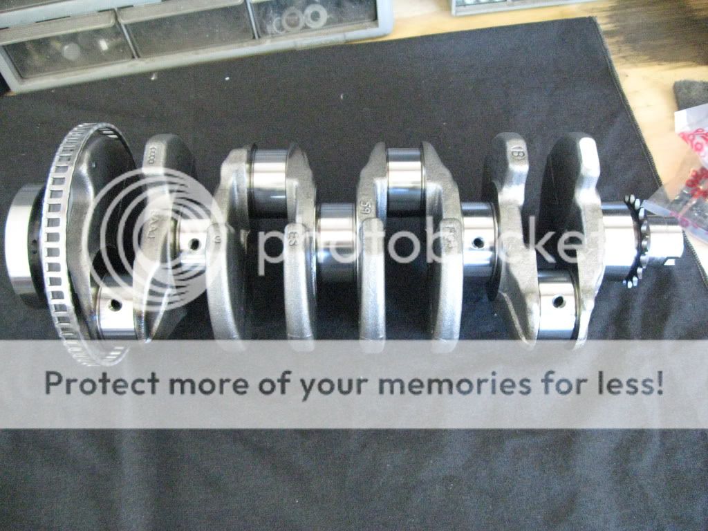

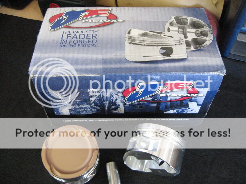

so here are some parts to look at, because around here pictures make things more better.
the crank;

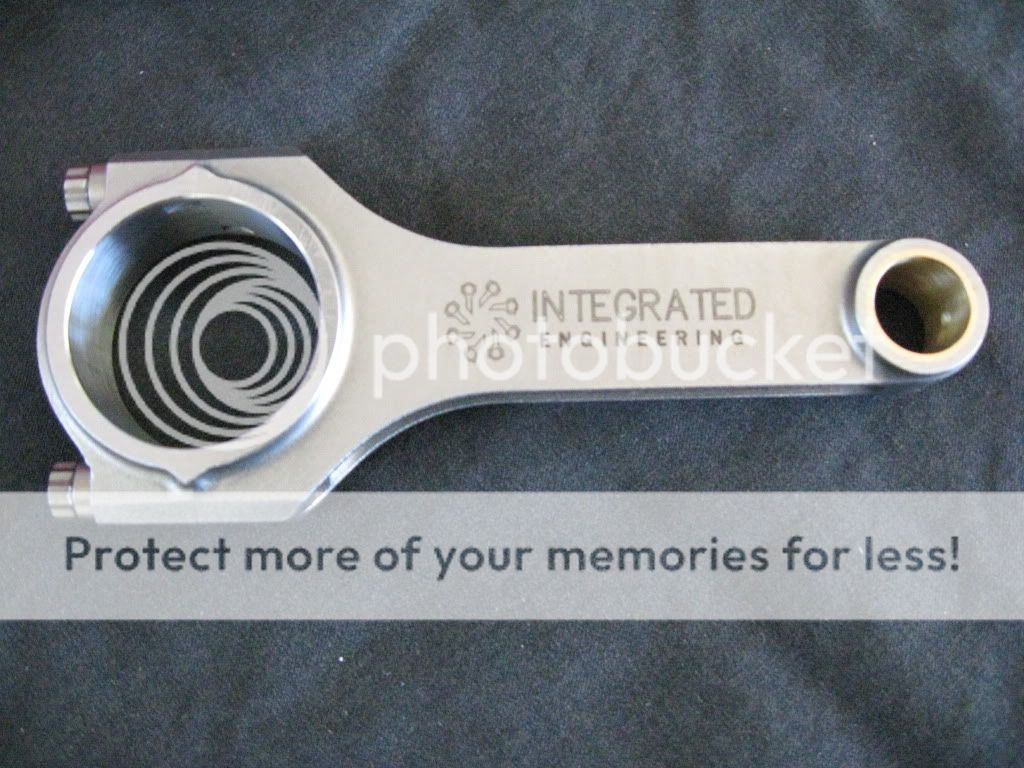

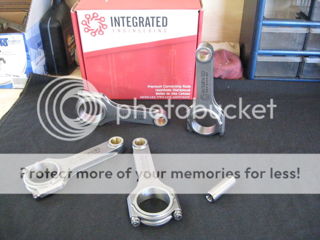

the rods;

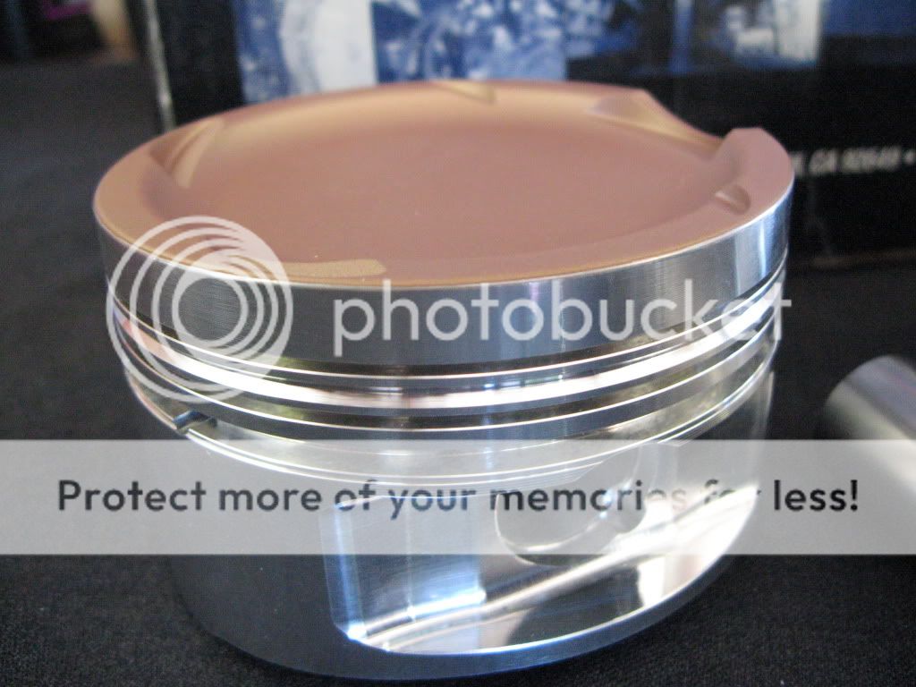

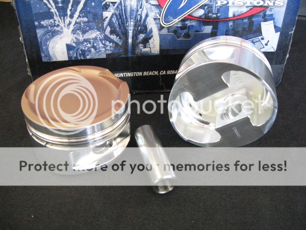

the pistons;

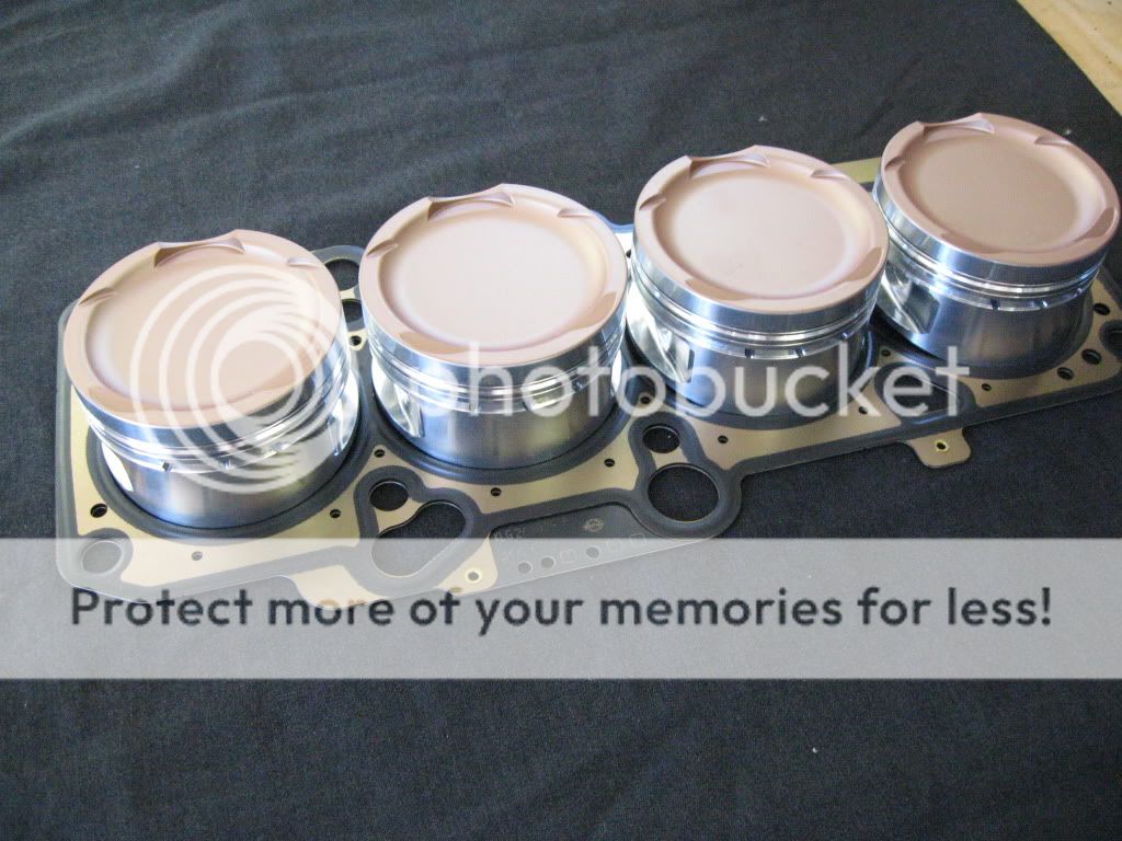

headgasket;
and stuff all layed out;
the crank;
the rods;
the pistons;
headgasket;
Re: Aarons Drag CQ: 8-03 NEW PARTS PIX PRON!!!!
:woowoo: :woowoo: Looks like nice new shiney money!!!! You gotta love new parts.
Wow
that was fast
that was fast
how many times we done this? LOL.
i had these SAME PARTS in the gold motor minus the 625's and FSI crank.
VW cranks are beautiful.
Is that Swaintech coating on the piston crowns? They do good work.
Looks like it will be a solid bottom-end for sure.
Brendan
Brendan

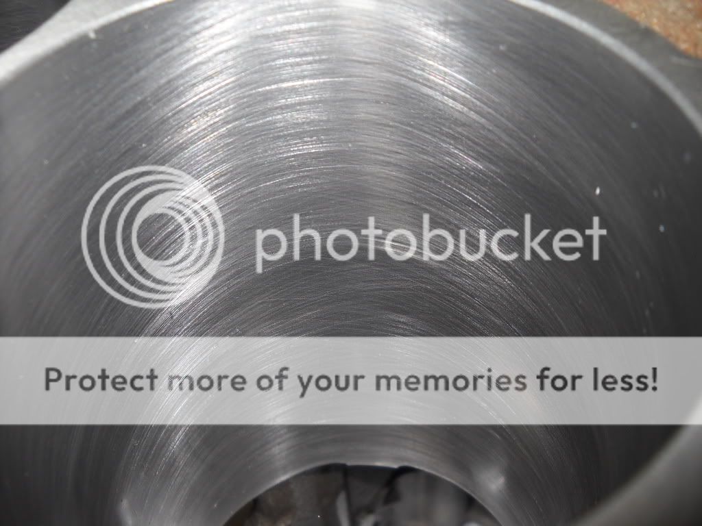

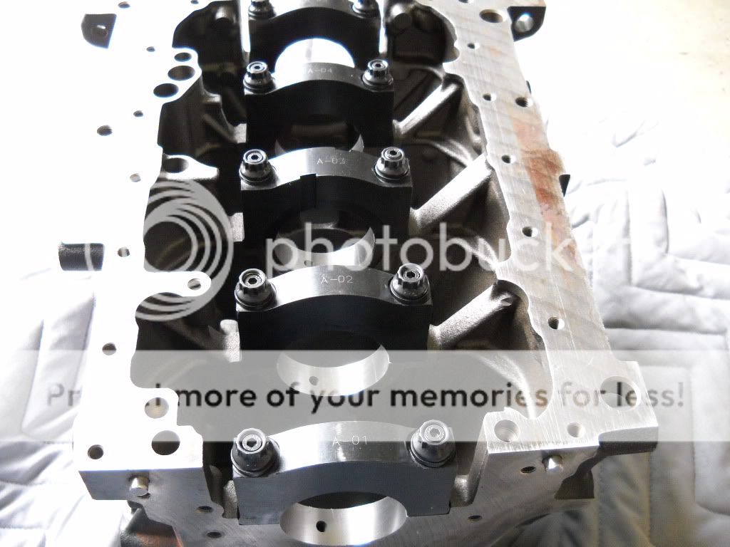

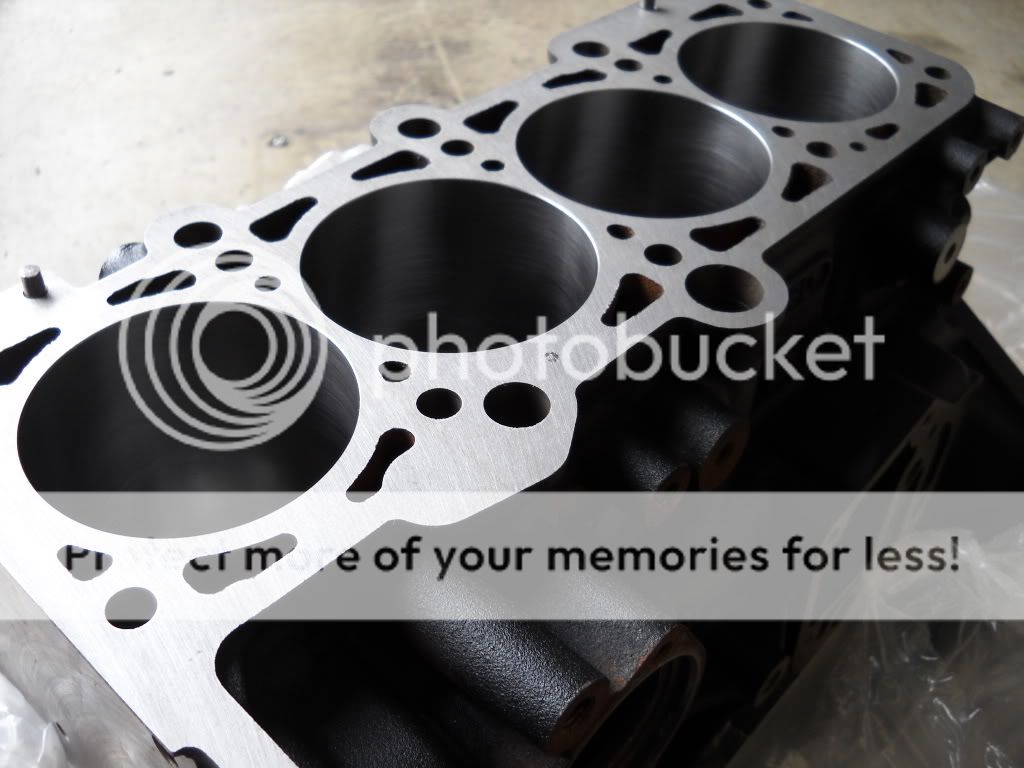

some machine work pix.
lets see, do fitting work to the billet mains, line hone the main line. mains were from previous motor so some welding and machining had to take place.
bore/hone block with torque plate.
polish crank journals and rod journals.
check and fit crank/rods/pistons/wrist pins.
balance entire rotating assembly.
hot tank, magnaflux, deck block surface.
cost was $800. and the bulk of it was fitting and welding the billet mains. $250. the mains were in the other block, and took a little work to make fit this one.

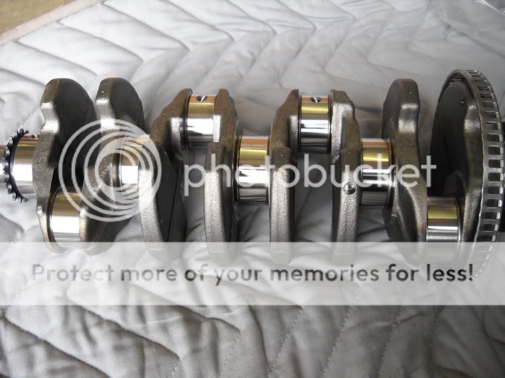

Is that your bed where your crank is shown?

Re: Aarons Drag CQ: 8-10 machining PIX!!!
failure appears to be 11.5k rpm related. ARP 2000 rod bolts in # 1 seem to have stretched and eventually (after three 10 sec passes) failed. the other three rods do not show this signs.
the solution is to run the strongest bolts. ARP New Age 625's in this case.
and try not to mis-shift!!!!
i did make a slider to not get into 5 or 6 gear, so i can be much more aggressive on the side movement on the shift. another thing i am going to try out next time is pre-loading the shifter to the side before i go 2-3. it works for my friend Bernd with his setup.
and playing with it and watching the linkage when wifey did it, seems like it may work. gotta test it out on the running setup @ speed though.
so in other words, while in 2nd gear, push shifter to the right. then when it comes time to go into third, you just push forward. in practice it works. and with BA's rado and 02A its working for him.
