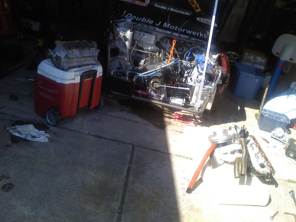

Re: Aarons Drag CQ: 7-27 carnage pix...
Don, i think we got all the hard parts. we have cranks and block. IE is supplying the rest. thanks
this is a scene i am getting altogether too familiar with. LOL

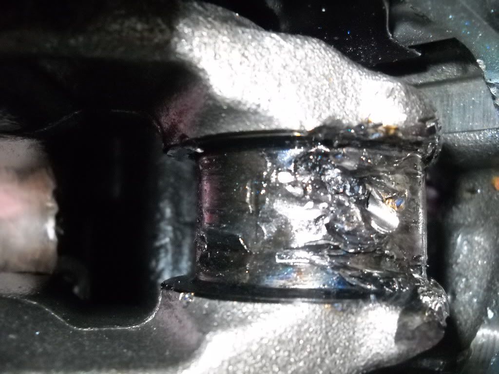

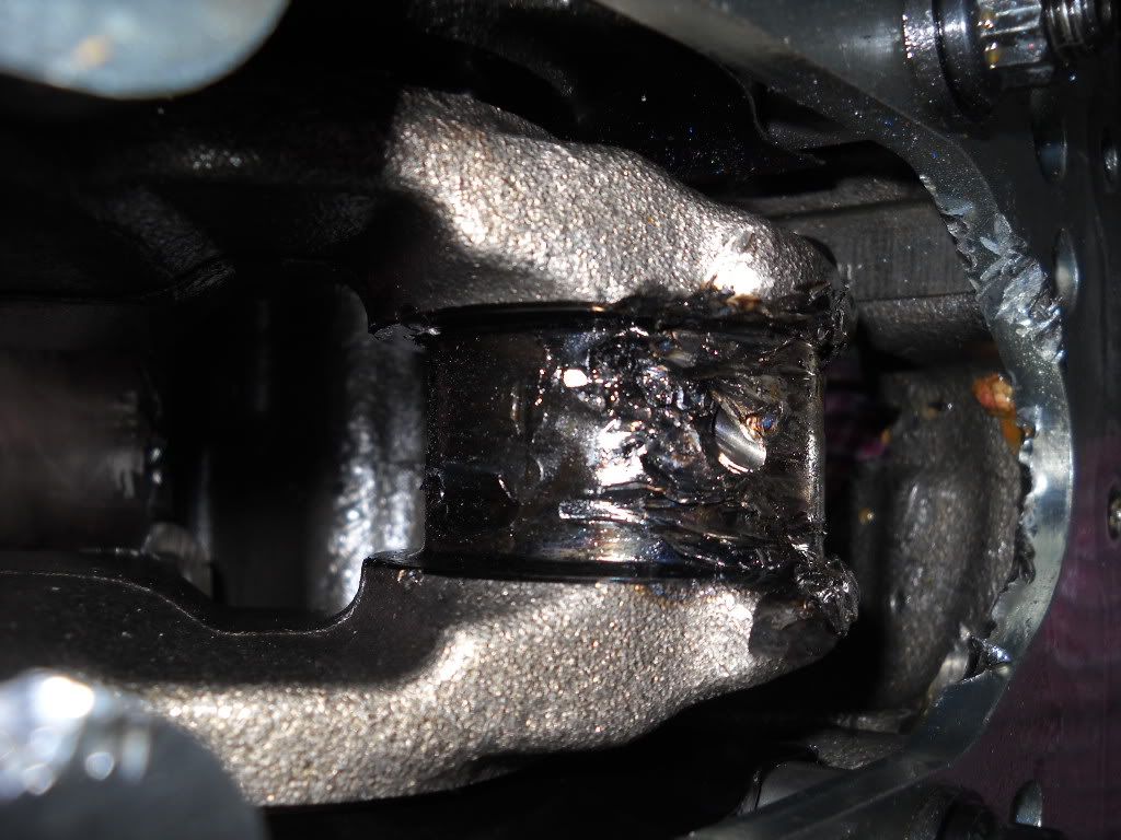

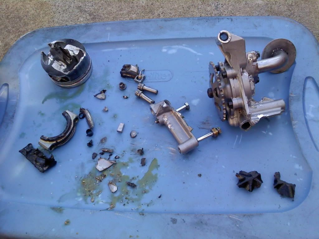

oldsklaudidub wrote:ouch. what caused the failure? or did I miss that explanation already, if so im sry.
i think that started it. looks as if the ARP 2000 rod bolts stretched or broke. will know more tomorrow when we disassemble the bottom and end see just how tight the remaining rod bolts are.speeding-g60 wrote:i shifted from top of second gear back into first instead of third. so a mechanical over-rev. 11,495 rpm i saw on the log![]()
oldsklaudidub
11,495 rpm yep that might do it.
- speeding-g60
- Posts: 2152

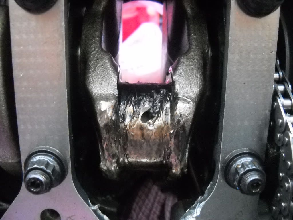

that crank dont look savable to me.
it has a pretty good gash on the inboard face of the journal as well, that i cant get a good pic of while its still in the block.
looks like we may be able to salvage the girdle, and just maybe have the Billet mains moved to the new block and line-honed in. gotta get it all to the machine shop to see about that.

the crank is just a forged 1.8T crank with the rod journals machined down to work with the one-off custom rods and pistons. definitely not do-able in 2.5 weeks. highly doubt it could be done this year, replicating that setup. not worried about it, goin off the shelf always available parts.
