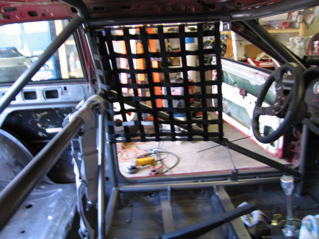

did a different window net, and made it much more user friendly. followed the destructions the first time around, and then i have made my own setup.
before you had to locate a tab to slide the top rear bar into, then line up the net, etc. no more. the rear top mount is a heim end on the rod, and it stays put so its a lot easier to operate.

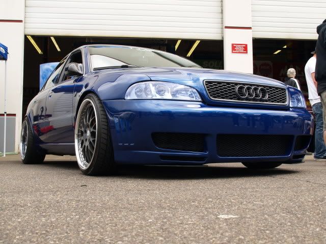

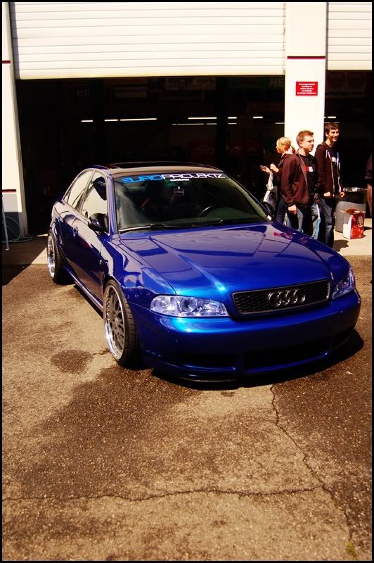

Autowerks Detailing.... nice guy, sweet car... so many subtle mods... like the pulled fenders, the hood mods, it is just really nicely done. guy in the middle of the first pic, its his car. forgot his name, met him there at the BBQ.

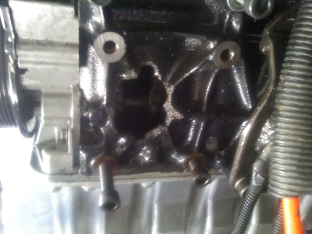

come on..... do you not have faith? it WILL RUN @ Waterlands....
even though preliminary reports are that this motor is a complete waste, head and all, you must have faith in me.
here are some parts i fished out of the window.

John, it has limiters in each gear. and they are all set differently. what happened cant be protected from with a programmed setpoint for RPM. it shifted from top of second gear back into first instead of third. so a mechanical over-rev. 11,495 rpm i saw on the log :o
