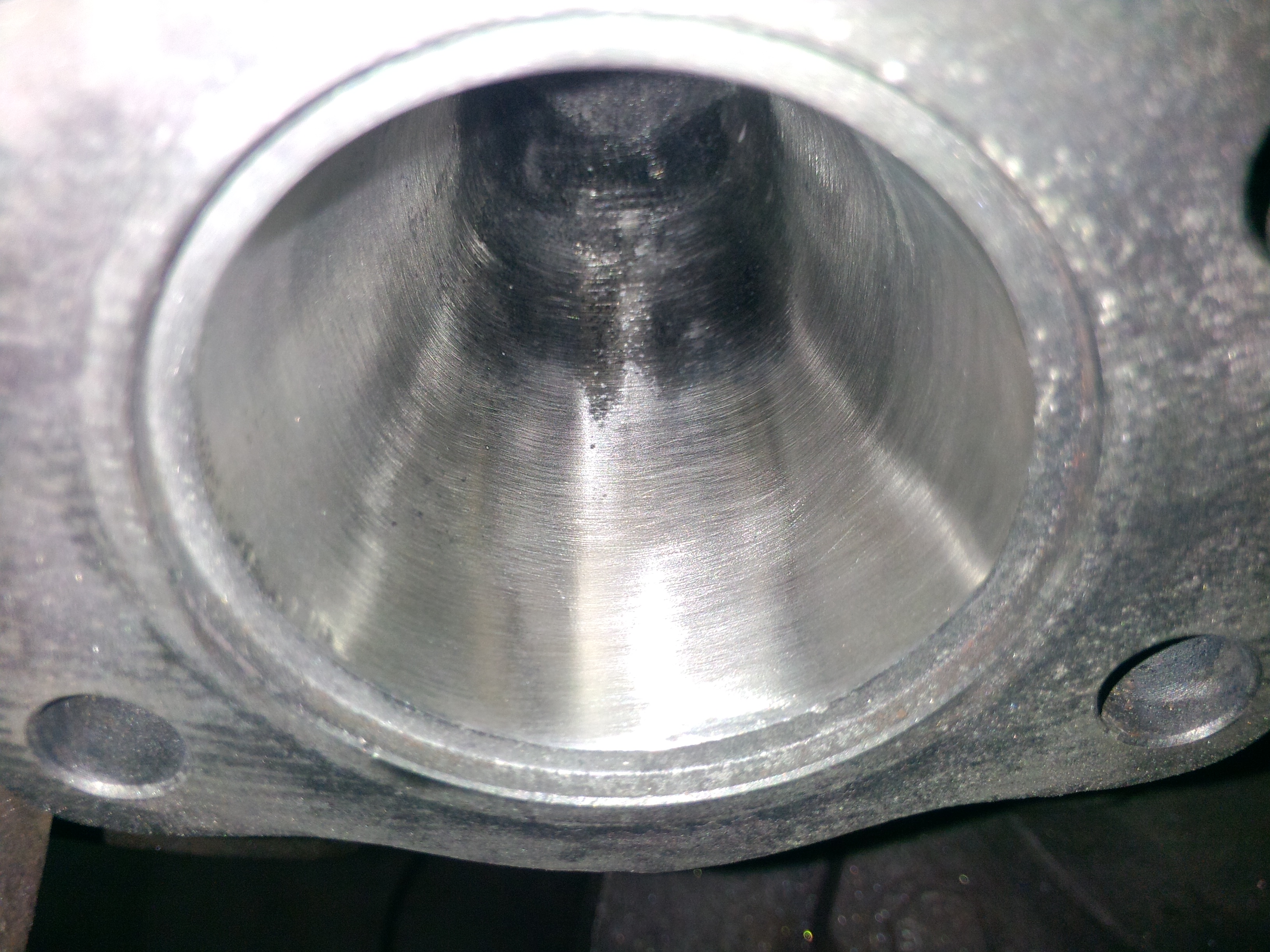

did you already finish the polish?
AngryTaco
Posts: 2657
Location: Hayden Lake, Idaho
Re: Taco's 4KTQ 20vt Swap: The Red Baron - DEATH TO CIS!!!
Post by AngryTaco »
No, didnt get around to it yet. I'll figure out some time to get at it. I can always do it after the ceramic coat anyways.

What did you use? Or did you just hand sand it?
scubadave
Posts: 496
Post by scubadave »
6 inch long shank (flame) cutting burr. 60 grit tapered sanding cones, and 120 grit flapper drum. thats not done yet either. it will be a mirror if I have the time to do so. I got maad skills.

Well took hotside to the ceramic coater this morning. Wanted like $100 for the damn thing. Screw that Ill just polish it completely. Ex manifold was $115. Bleh.

Well the other thing I dont like is they dont polish theceramic after coating. From I have been told by a family member who owns a powdercoat shop, they are suppised to pokish the ceramic for durability. Well see
