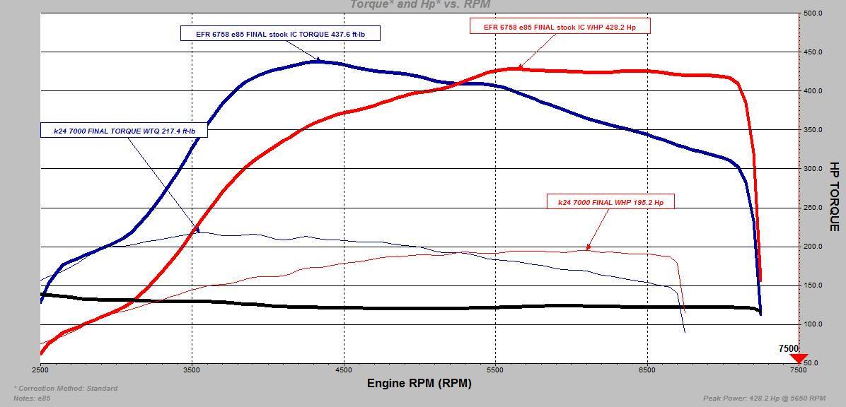

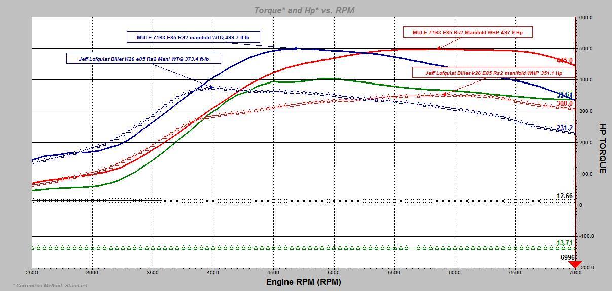

Re: Phil's 20vt 5ktq, Get Bent
Posted: Wed Feb 04, 2015 11:19 am
by pilihp2
Mule on 6758
and currently mule on 7163

Posted: Wed Feb 04, 2015 11:49 am
That is hilarious. Hank is going to have to get a new dyno that reads below 2k at the rate this is going.

Definitely made a lot of progress this weekend on Phil's car! Could have gotten more done probably but Phil wasn't down here that long and birthday celebrations and hangovers put a dent in motivation. Plan at the moment is a 6758 on the 5K. I've got almost all the parts to start putting it back together, just need to do it! And swap new trans and diff in aswell but that's a one day ordeal.
Dyno numbers were stock IC, The Mule has an FMIC now. (That is probably much too small, but way mo' better than stock)
Destroying the 335I was hilarious. He came up on me at 100+, I was going about 75, he went for the pass and by the time he was half a car length ahead I pulled him like a freight train to ~140. I think The Mule should just be renamed the giggle mobile, because that's what I do every time I drive it...

If I had kept the 4k I think it would have seen an efr with qsv eventually. Damn I wish I had the money to buy that car back lol
Those graphs are awesome. So the 6758 spools like a k24 and the 7163 spools very similarly to an rs2. I would really love to see some pump 93 dyno pulls.
Posted: Wed Feb 04, 2015 7:54 pm
by Colin2750
Spools nearly the same, transient response is (far) superior on the EFR. Especially the 6758.
